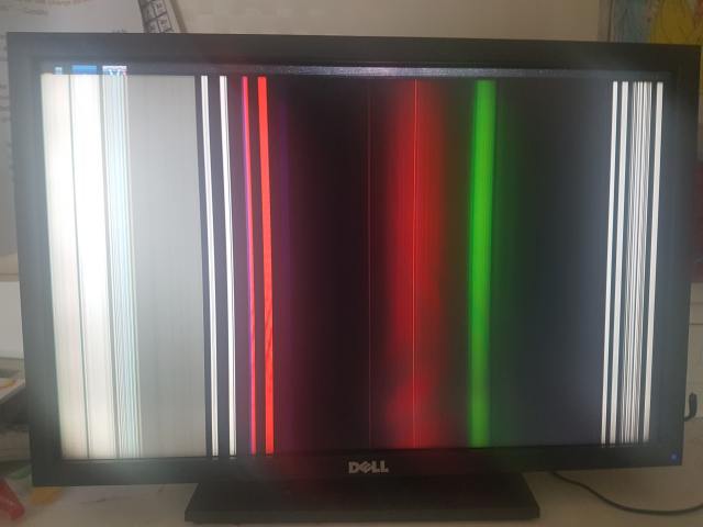

    Hi Folks

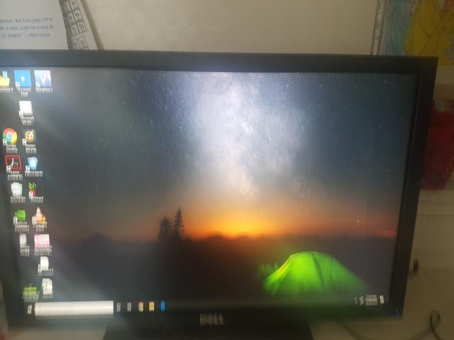

    Facing a weird problem with my monitor. I have attached two images. When i switch on the monitor i see image 1 as shown in image 1
    Now if i leave the monitor on for about 15 minutes it becomes proper as shown in image 2 as shown .
    Is this a repairable issue or is the panel dying. I opened up the monitor thinking there were some bad caps causing this issue, but could not find any damaged/leaking caps. The monitor is about 8 years old. Any ideas ?

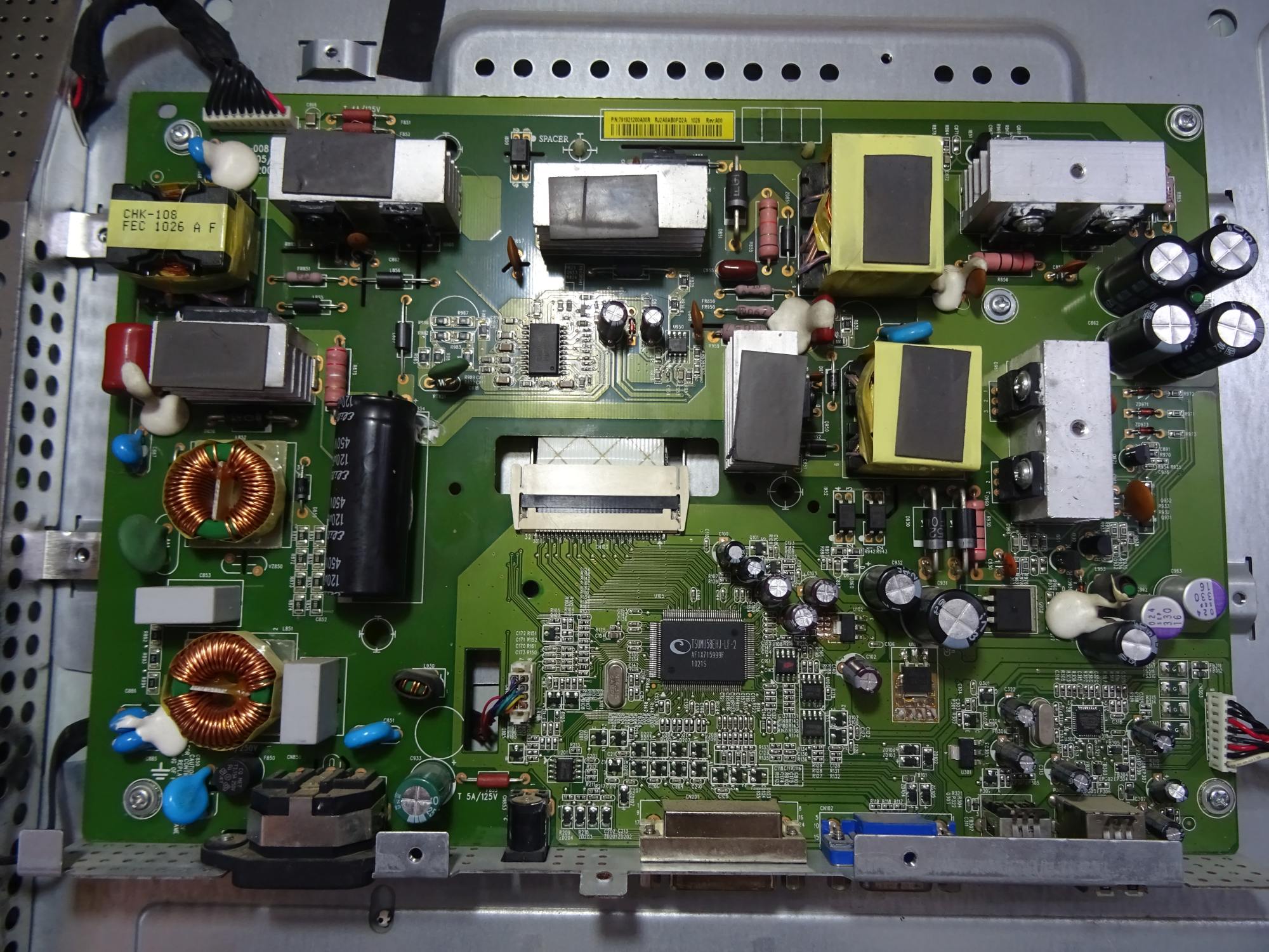

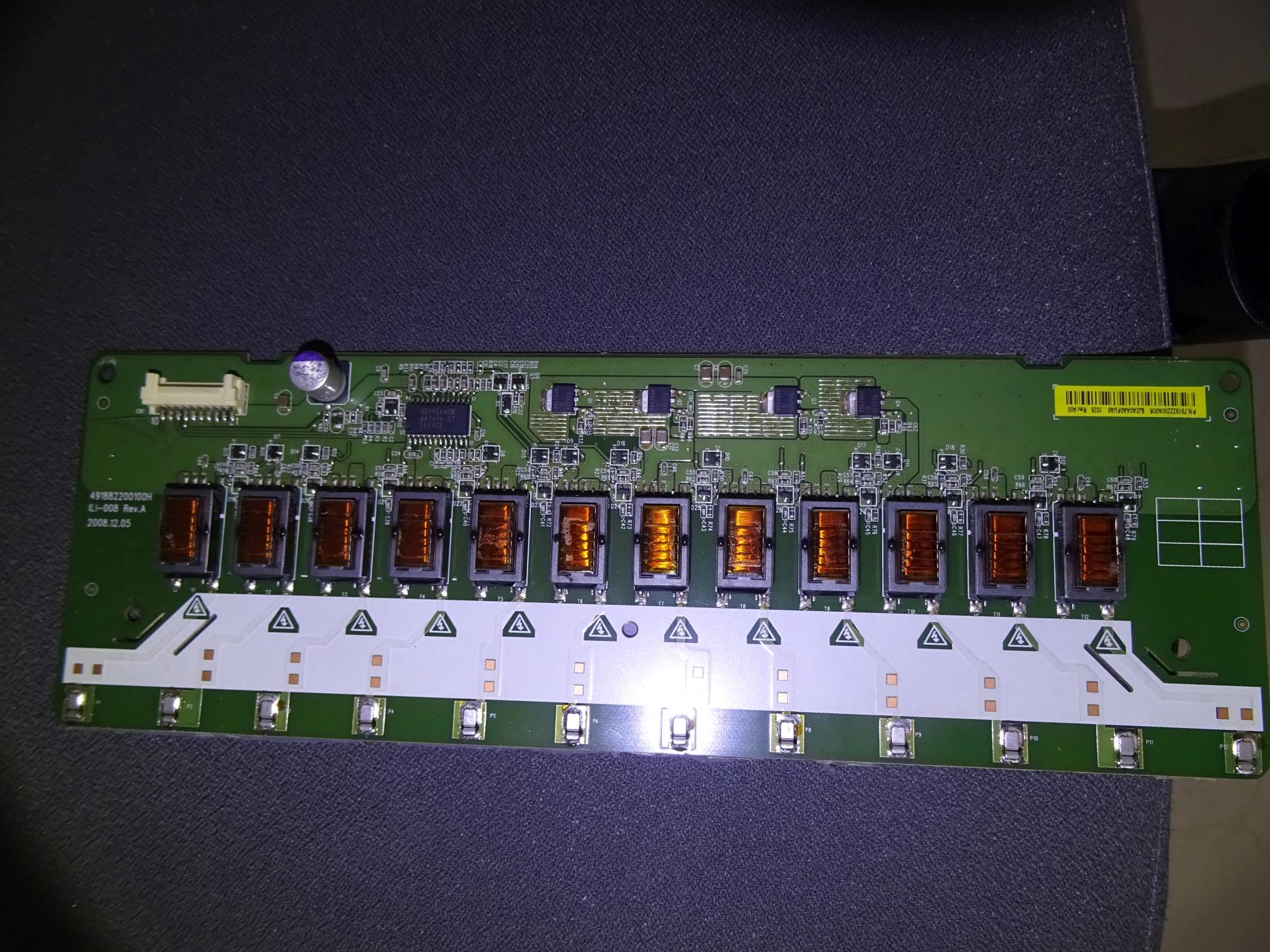

    Re: Help required with DEll 2209WA monitor
    Posting some more pictures of the main boards
    Main Board
    Side board
    I cant see anything burnt or damaged. So what is possibly causing this behaviour.

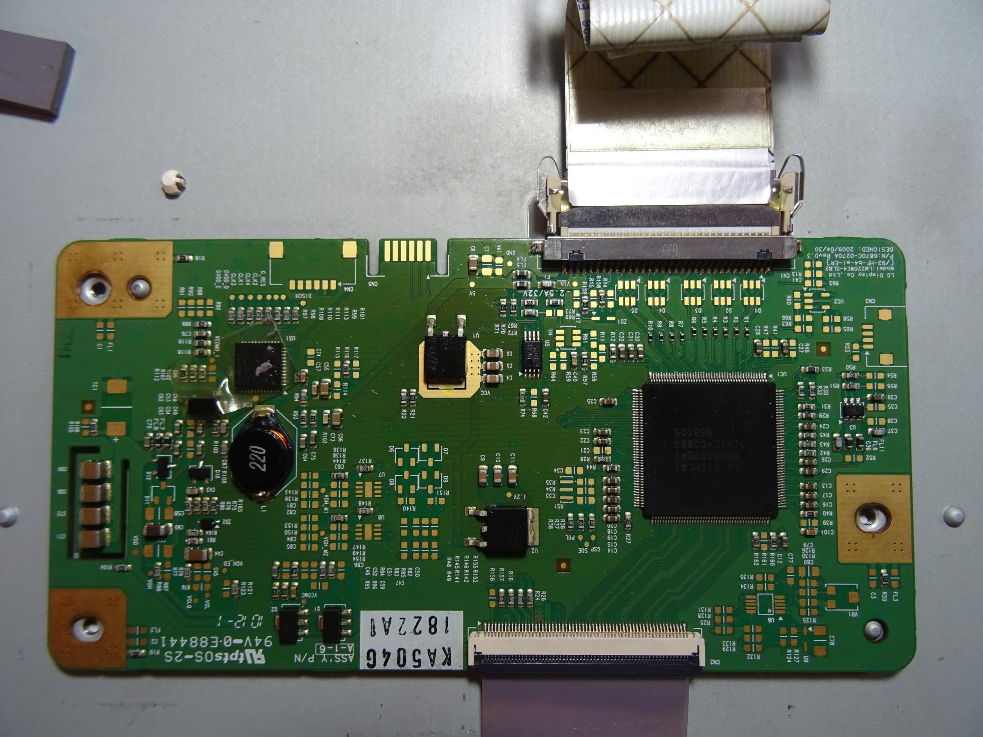

      Adding the image of the TCON Board. Again no damage visible.
        Try reseating the plug connections on the t-con board and see if that helps. You cam also use a heat source like a hair dryer and heat sections of the tcon or main board to see if you can speed up the return to normal picture. The power supply section and the inverter board are not likely the cause of the problem. but the fault could be on the lcd panel board itself (CN2 cable connects to panel board)
          Thanks for the response. I tried reseating the plug connection on the TCON board. Also heated the the TCON board using a heat gun, but made no difference. So guess the panel board is failing and that cannot be changed or modified.

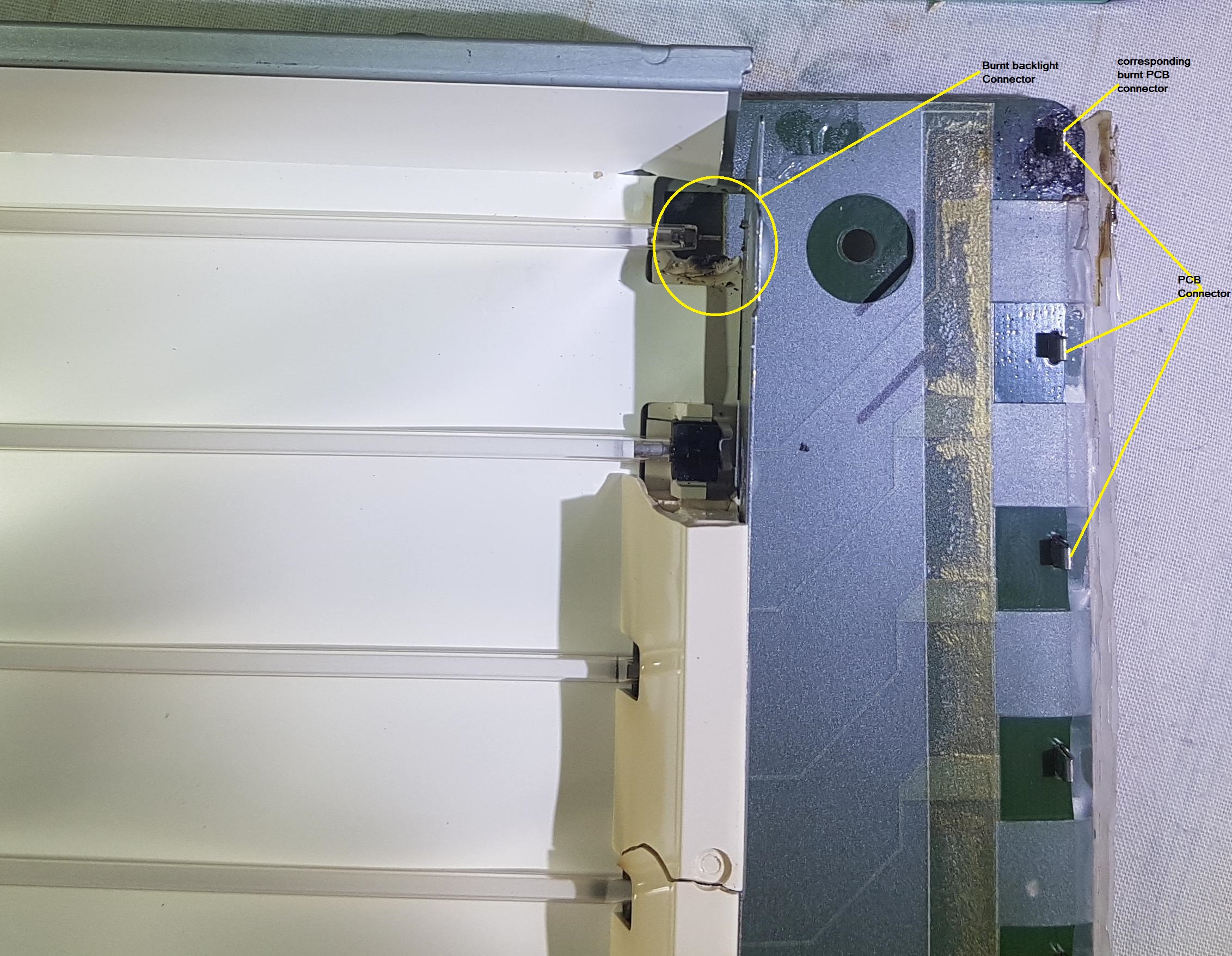

                Ok figured out the problem with the hissing/crackling sound. one of the connectors to the backlight is burnt to crisp. so much so that the rubber padding that was holding it is completely burnt. Not sure why this happened.
                See image
                Question i have is can i directly solder the backlight tube terminal to the backlight connector on the PCB ?
