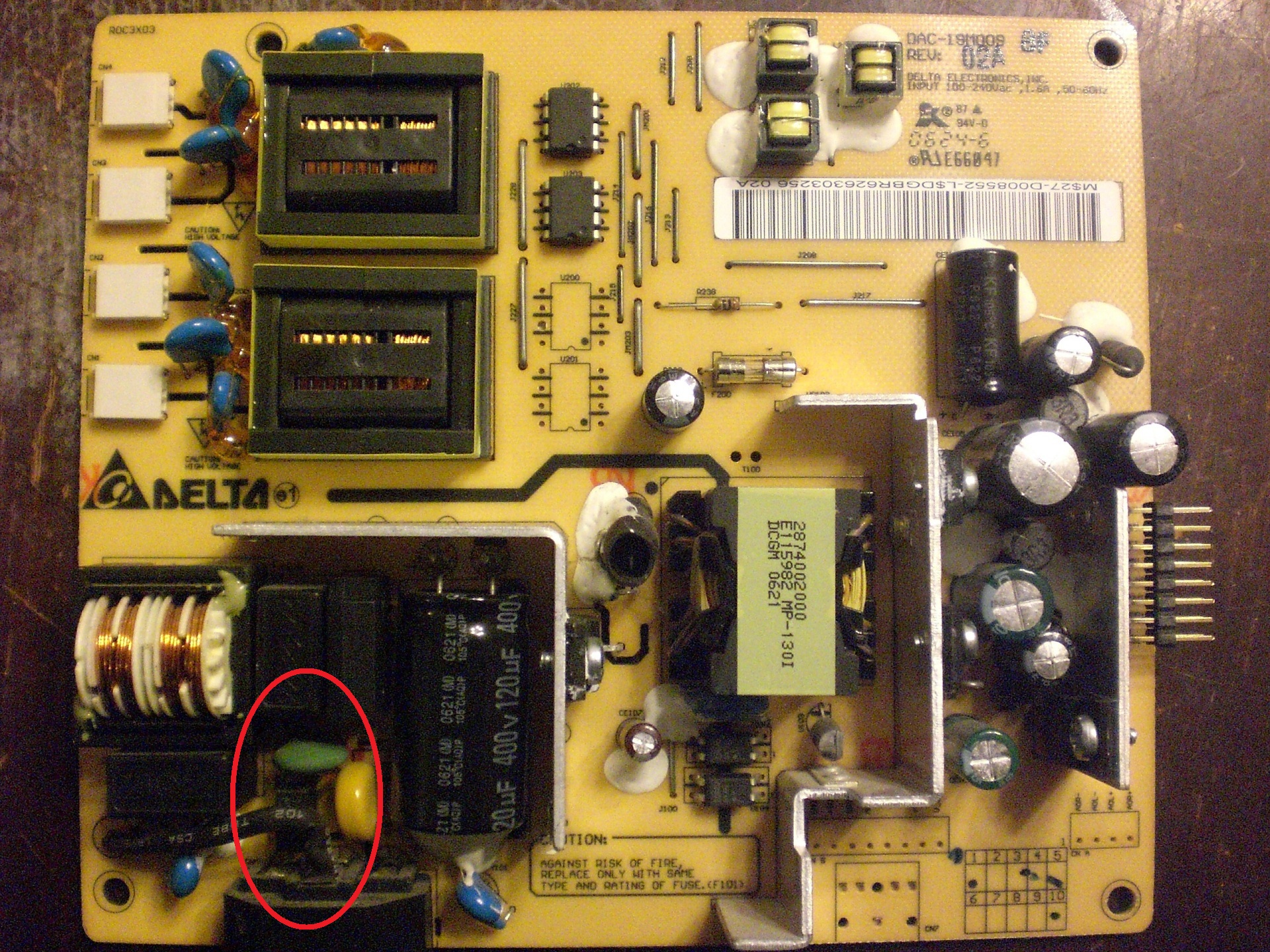

              Hi, first post here.
              Fascinating reading this thread so far that it has prompted me to ask a question:
              I have the same board that has been discussed on here - image attached, but it's one borrowed from another post because I don't have a camera to hand.
              My monitor has no power at all. Replaced the biggest capacitor because it had clearly burst but still no power.
              I then checked the fuse F101 for continuity and got nothing, so clearly blown. However, I then noticed that the little green capacitor next to it (circled in red) has a big black hole in it and requires replacing.
              My question is, what do I replace the green capacitor with? There are no markings on it at all, although it's possible that the blown hole has obscured any previous markings. So at this point I have no idea what size capacitor to buy.
              Cheers,
              Avocado.

                #107
                Re: Chimei DAC-19M009 Power Supply problems
                Its not a cap But a Power Thermistor,SCK037 is a common one used in Monitors as below :-

                  #108
                  If the main capacitor spoiled then there could be other components there that have failed. Check the MOSFET first especially. Also noticed a number of bulged capacitors there..
                  That's a thermistor, not a capacitor. You can find this very commonly used in SMPS power supplies.

                    #109
                    Hi, Thanks Rtech and lexwalker.
                    So this thermistor is a SCK-037.
                    I don't know anything about thermistors. Do I have to get an exact part match or is there a generic thermistor that will suffice?
                    Been looking on eBay for thermistors but nothing comes up with that search string so I'll contact some of the sellers for a bit of advice.
                    lexwalker, the bulging capacitors in the photo are not actually from my board - I borrowed the photo from an earlier posting on this thread because my board is the same type, and well it just seemed easier. I've checked my other capacitors and none are bulged or look anything other than perfect (apart from the main one which I've already replaced).
                    What is a MOSFET and how do I check one?

                      #110
                      Why not try online electronic stores. Here's an example from RS Components: Passive Components > Variable Resistors > Thermistors >Type S237 NTC thermistor,ICL,1R 170degC. Lots of other examples there also (including other places like Farnell, Digikey, Mouser, etc), just pick the one closest to the original part's specifications.
                      The 3-legged transistor that's on the heatsink near the big main filter/smoothing capacitor. If this part becomes faulty, then it will usually become shorted thus causing the fuse to blow (again).
