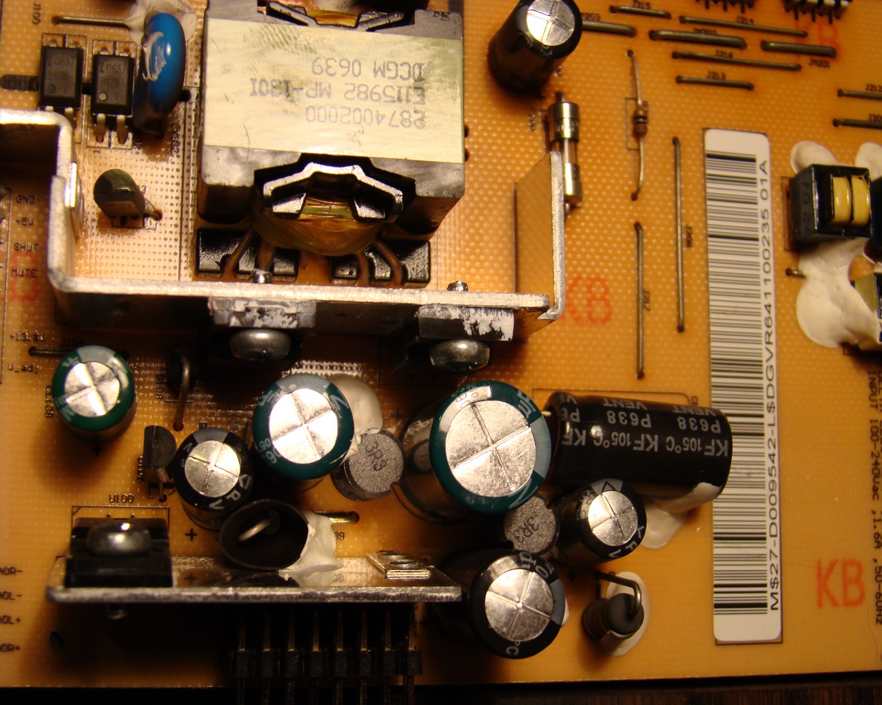

              Hello all,
              Bringing back the same post with somewhat the same problem...
              I own a Viewsonic VX2245wm and guess what! The screen went black. Only the blue power indicator and an instant (less than a second) flash without any image whenever i try to connect it to my PC's video card.
              My question is simple enough. How do i know it is the PCB and not the inverter? All capacitors seem fine (see the attached pics) or i think they are.
              And one more... Is it possible to replace the 19M009 with the 19M010 that i found on eBay? Does it lack the soundboard or is it the same with a new design?
              Thank you all and thumbs up to you all, this is a great forum!

                Thanks for the photos because they really help in the diagnosis of the problem. It looks like several of the caps are bulged at the top and need to be replaced. The ones I'm referring to are the black ones (Capxon?). The green Taicon ones should also be replaced. The large 450V can be left alone. That leaves 9 caps that should be replaced. Suggested replacements are Panasonic FR, FM or FC series from digikey.com.

                  Wow! This is what they call "Fast Reply"!!! Thank you for your remarks and advice.
                  These Capxon capacitors are really crap(xon). A lot of people are having the same problem. Such a shame that they pick these for building a nice LCD with a lot of features that eventually will fail (in shorter time than usual!).
                  Would you suggest me to go for the 19M010 board? I am not that experienced in soldering...
                  I have found one on eBay that is relatively cheap. Is it ok to post the link in here? I hope i will not violate any rules...

                    Honestly, I personally don't recommend subbing the 19M010 for the 19M009 because there could be enough of a design difference between the two that might cause problems. The recommended procedure on this forum is to try and repair your existing board. And the first order of business would be to replace those caps before going any further. Total cost should be around $10-$11, shipping included.

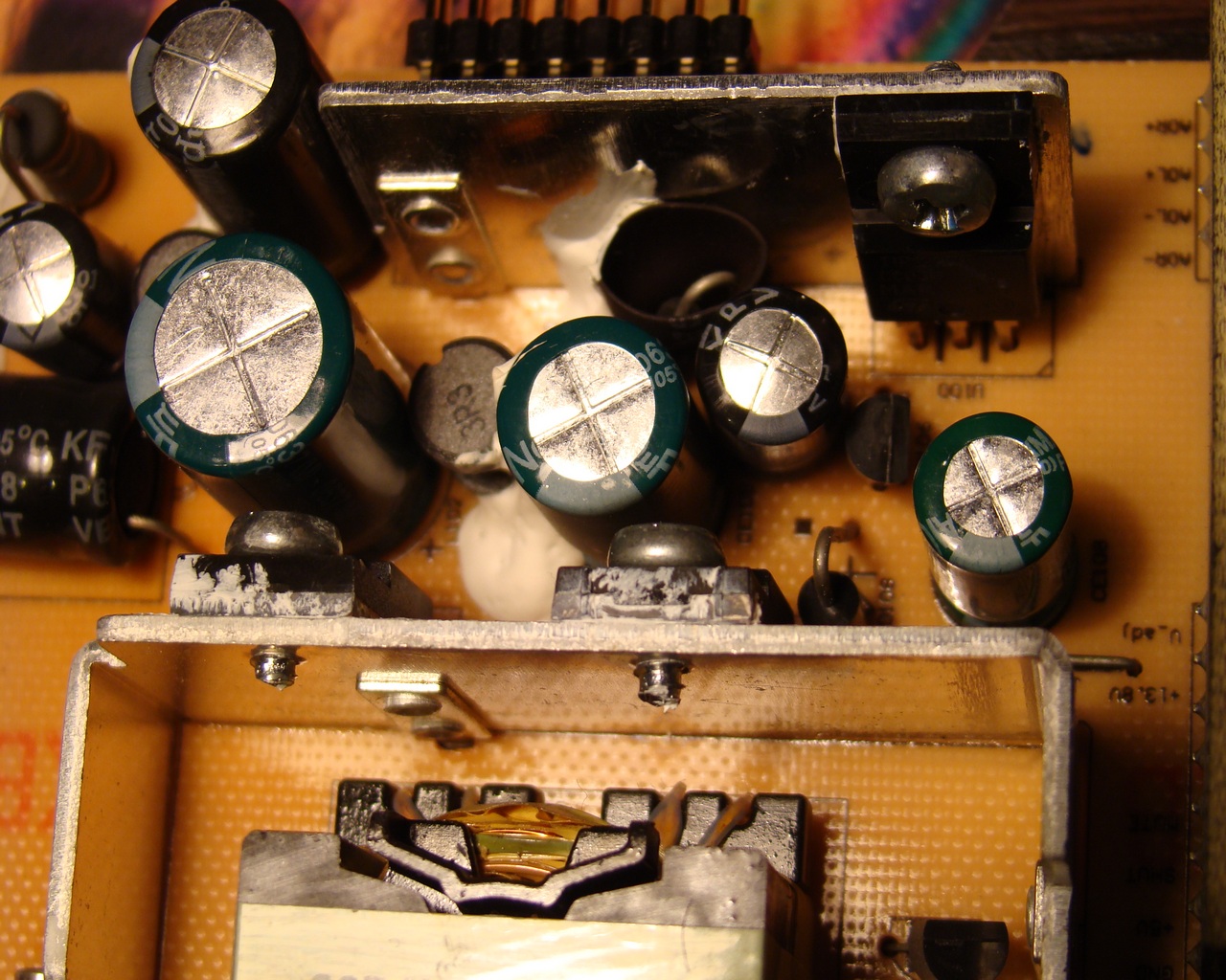

                              hi all ,
                              I'm so glad o find this forum :-)
                              I have the same ps board Chimei DAC-19M009 and have problem:
                              it started few month ago.
                              when the pc was of the led was orange (no signal) when I turned the pc on the led turned off (now it has signal) and I needed to wait 3~10 minutes until the led turned green and the screen was on and worked fine . during this time that the led was off and the screen was off I was hearing high pitch sound (like caps charging sound ) and it was going on and off (sound-> no sound....)
                              so now the problem is that the screen not turning on even after 15 minutes the led returns to orange (windows power saving turns monitor off after 15 minutes idle) and if I move mouse it turning off again trying to turn on
                              I opened not the monitor and it looks like the board you are discussing on
                              and the 3 crapxon caps 220uF-25V and one 2200uF-10V are bulged at the top .
                              what do you think ?should it be the problem?

                                Yes, that is most likely the problem.

                                  It worked!!! I have replaced the 3 220uF 25V and 1 2200uF 10V caps and it work's now!!! thank you all!!
                                  it cost'd me just 3$ lol

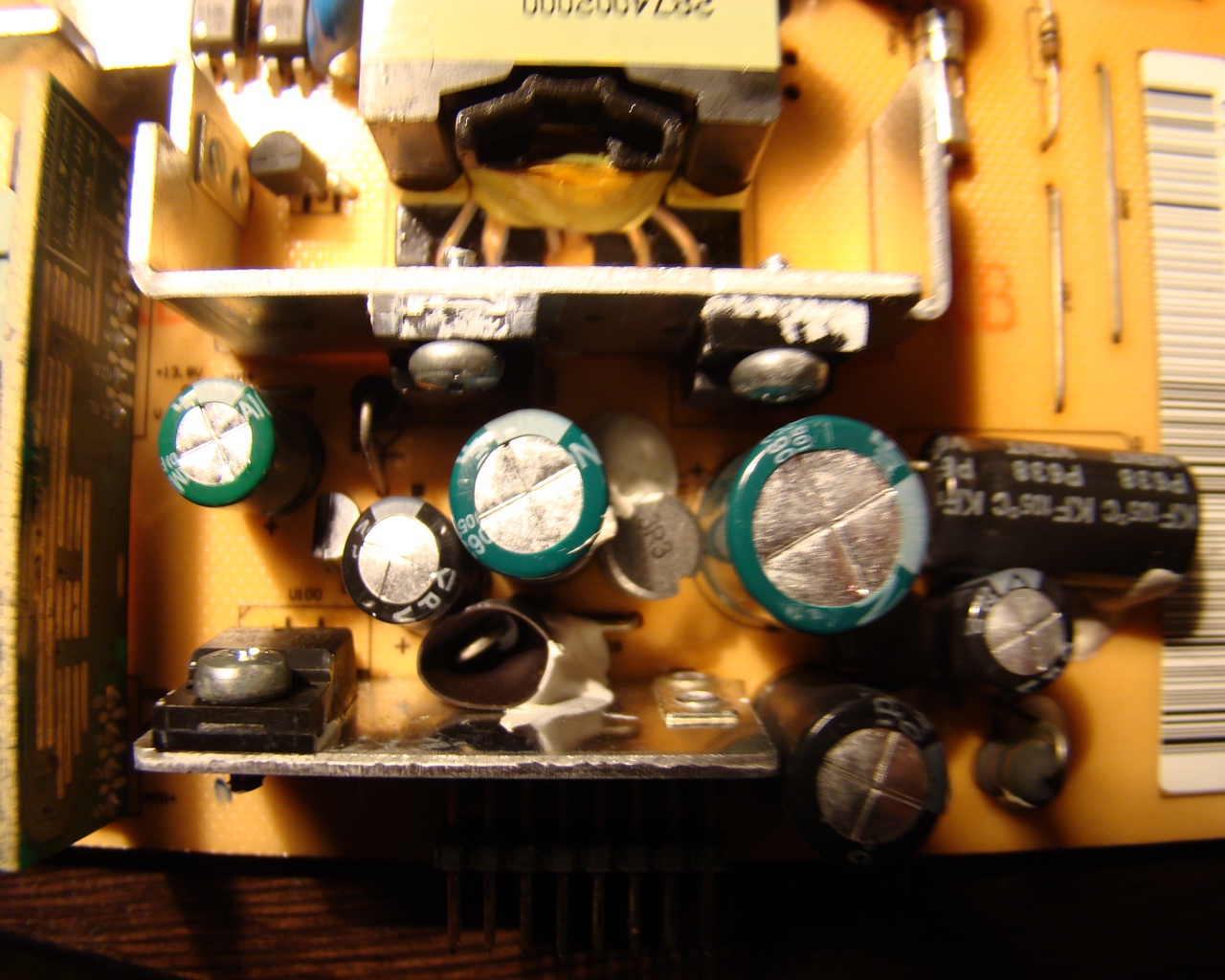

                                    Same here as Mishael guys! Great news!
                                    I replaced all the C(r)apxons capacitors with Rubycon capacitors (1000uf-25v x 2 and 220uf-25v x 3) and the monitor works like a charm! The other capacitors seemed fine so i left them as they were.
                                    Thanks for all of your support and advice!

                                        I'm trying to identify one cap that the white glue pulled the sheath off and I couldn't read.
                                        Any chance someone could take a look and forward on the value?
                                        Please see cap circled in red on the pic.
                                        Thanks!

                                          Startup cap. 22uF, 50V. Identified here.
