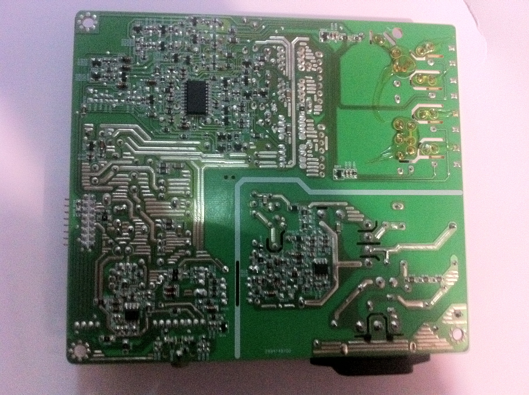

          I've recently acquired the VX2235WM monitor with the DAC-19M009. My issue is no power, no LED light. I've read through this thread and tried mostly everything in my ability. I have done electronics years ago in the Navy, but a little rusty on the soldering. Here's what I've done so far:
          Visual Inspection - no leaking/bulging caps, no noticeable solder issues
          Tested F200 and and F101 fuses -good
          Tested the big cap (400V 120uF) - good
          MOSFETS tested good
          Removed the startup cap and tested - good
          Bridge Rectifier tested good
          Tested the pins connecting to the logic board, no 5V to be found.....
          Not sure where to look next. Please bear in mind I'm waaaay out of practice with this, so you may get a response of "huh" or "how do I do that"
          Thanks for any help you can offer

              Having a problem with the same board or maybe even with the other board.
              It had bad caps so I changed them. Got the monitor working. A week later it did not work anymore. When plugged in, there is a clicking sound and 2 LED lights in front are blinking (I could barely see it) in the same tact as the clicking sound.
              There is no clicking sound when the other board is not connected.
              I tested out large cap - OK, rectifier - OK, SMPS has 11.7V - OK (according to datasheet), 13.8V - OK, 5v - OK. Removed F200 - still same problem.
              All caps have been replaced.
              Taking in mind this information, is the problem hidden in power supply board or logic board/controller or whatever you call that.

                  While I tested, I had no LCD panel even connected. Only the power supply board, controllerboard and buttonboard. Nothing else.
                  The model in question is VX2235wm

                            Ok - did you try jump starting - Can you find a pin labelled pson or blon or on/off on the main board connector. with the main board disconnected but with the lamps plugged in,
                            get a 500ohm resistor and jump the 5v pin to the pson or blon pin Switch on the mains power and see if the lamps come on ( may also need a resistor jumper to Blon.)
                            • RethoricalCheese
                              • Mar 2013
                              • 1517
                              • Estonia
                              #74
                              Re: Chimei DAC-19M009 Power Supply problems
                              Just tried jump starting. The lights turn on for half a second and go back off.
                              The lamps I used are taken from another monitor and are in 100% working condition.

                                this was what mine was doing.
                                Haven't fixed it as I am stuck with getting that cap 220uf 50v cap the trace was lifted. having trouble finding where its meant to go on the negative side.
                                pretty sure positive lead traces to above zener diode.
                                      I am not sure if the picture helps so I tested it instead.
                                      Positive side is connected with D109 and R133, negative side is connected with C121 and R144.
                                      Positive side rail should go underneath a diode also.
