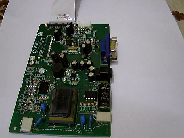

    LG flatron w1943se-pf
    lg flatron w1943se no power
    open case found ic 303 APW7142 burnt
    what's its equivalent or how can it was replaced in circuit ??

    Re: LG flatron w1943se-pf
    buy it from Ali etc. There are quite a few places where you can get the exact same PWM.
      Also see AOZ1073, analog.
