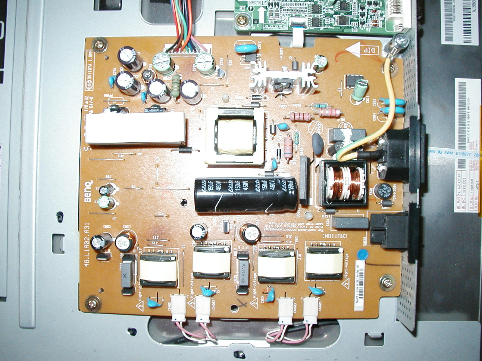

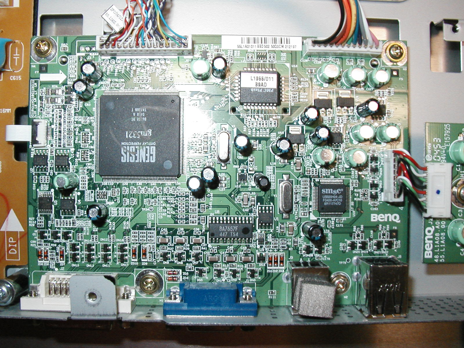

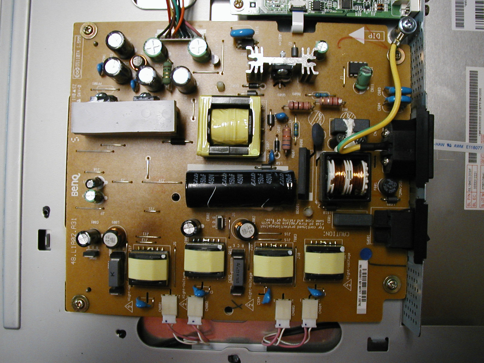

              Here are pictures of my inverter board (front and back) and my video board.
              I've included a couple of shots in different lighting.

                It might be the picture, but it looks like the green capacitor on the lower left side of the picture of the video board might be bulging. As for the inverter, search the forum for 1940, as this model use a inverter very similar to the one you got, and you will find several advices on troubleshooting that board.

                      They're Jamicons and Lelons after seeing the pics I remember from their colors.
                      Tracing out and making sure that the video board is getting supply voltage should be your first step. The rainbow colored connector all the way on the right is from the PSU for the board. At minimum measure across the secondary filter caps on the PSU to check the output voltage.

                                    I'd like an over-all shot of the back of the monitor. There seems to be an extra circuit board and a cable that doesn't make a lot of sense.
                                    This is the first time I read your first post carefully. The symptoms would seem to indicate a problem with the voltages on the panel itself. What do you mean by 'no video'? Black screen or white screen?

                                      The extra circuit board you're referring to is probably the USB board. This monitor has a built in USB hub.
                                      I don't know if it helps, but I've noticed that there is almost no electrical whine noise anymore since I've changed the caps.
                                      As for what is happening...
                                      The backlights are on, but the screen is black. There is a faint vertical grey bar that is in the center of the screen. I think this is the message text from the monitor saying that there is no signal and then another one saying that it is going to sleep. I can see the width of the vertical bar change as if the message changed. When the monitor was working before, these messages were in white rectangular boxes...one message box might have been a different size than the other.
                                      Does that make sense? If not, I'll draw out pictures of what I mean.
                                      Also, I checked the fuse on the panel board and it's not open. I also measured 5V coming from the logic board. There are three 5V lines and 4 grounds.
