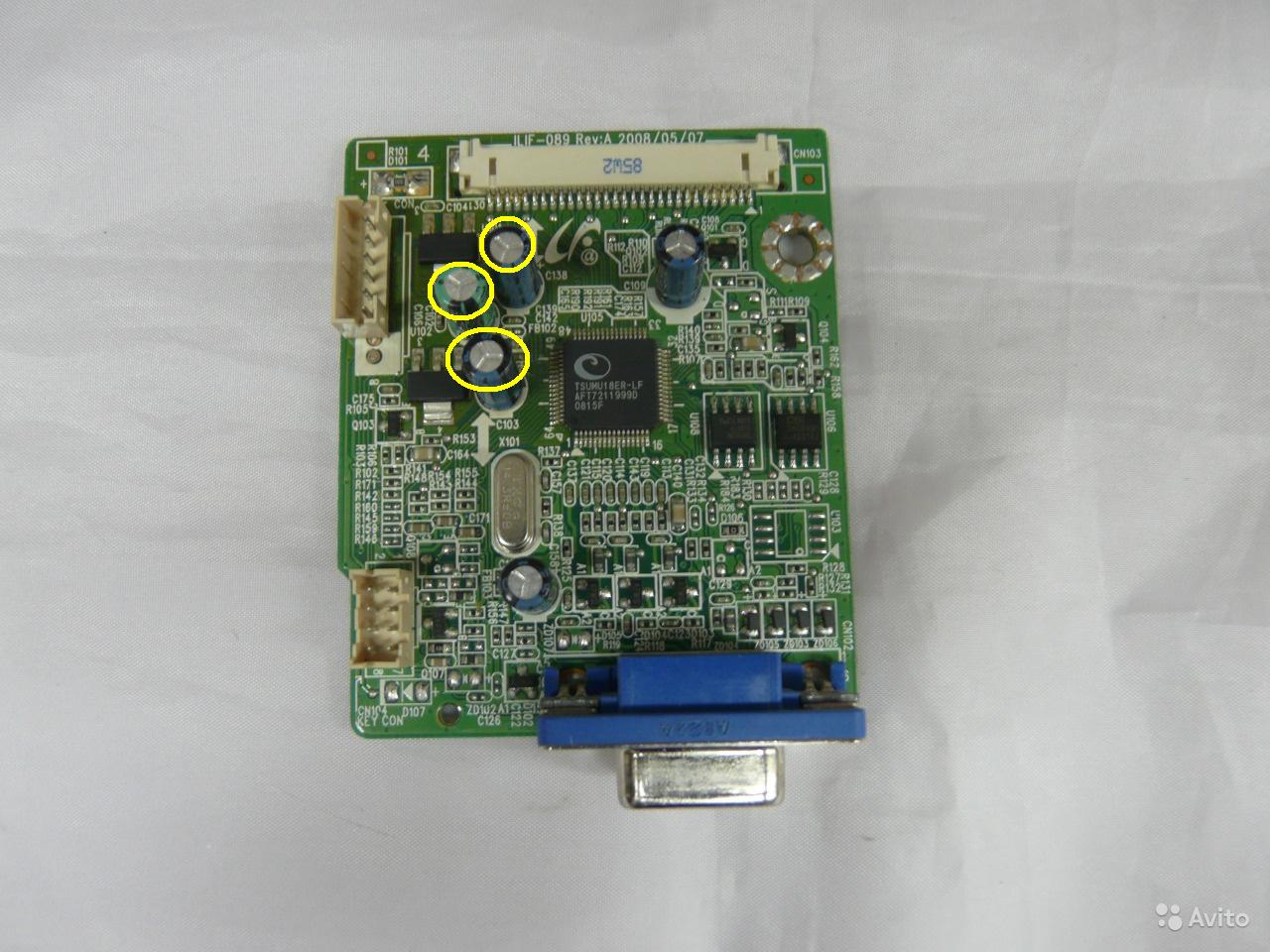

    • would not start at all
    • replaced six 470uF caps, three of which were bulging
    • afterwards it starts but image has colorful lines and is generally broken
    Any ideas on what to focus next?

    You replaced 6 caps, I see 9 caps, I also see 5 caps on the main board, start by replacing the caps C138, C103 and the one between these two next to the regulator ic's on the main baord

          Ok, its back with vengance, I got 680uF and put them in but still random lines
          any tips what to check next after caps change on the power board if this is how it looks?
          I am going for change of the caps on that other board now

            Caps on the main/logic board can cause this, it is usually the low voltage regulator ic's that can oscillate at high frequency when there bypass caps go bad as in almost open.
            There look like there are 3 caps near the two regulator ic's. These small caps usually look ok because they don't bulge or leak but they DO dry up.

              Ok, update after 1 hour of dicking with those little shits with bend legs.
              All caps on the logic board are replaced
              3x 22uF
              2x 100uF
              old ones had really high resistance, one was 22 ohm another 12 ohm
              I assume this is high considering new ones are like 0.X or 0.0X ohms
              Now, after I switched it on the first time it was still fucked.
              After switching it up second time normal image appeared,
              it is the very same behavior like with the first cap change on the power board.
              Will see, tomorow I try to run it most of the day
