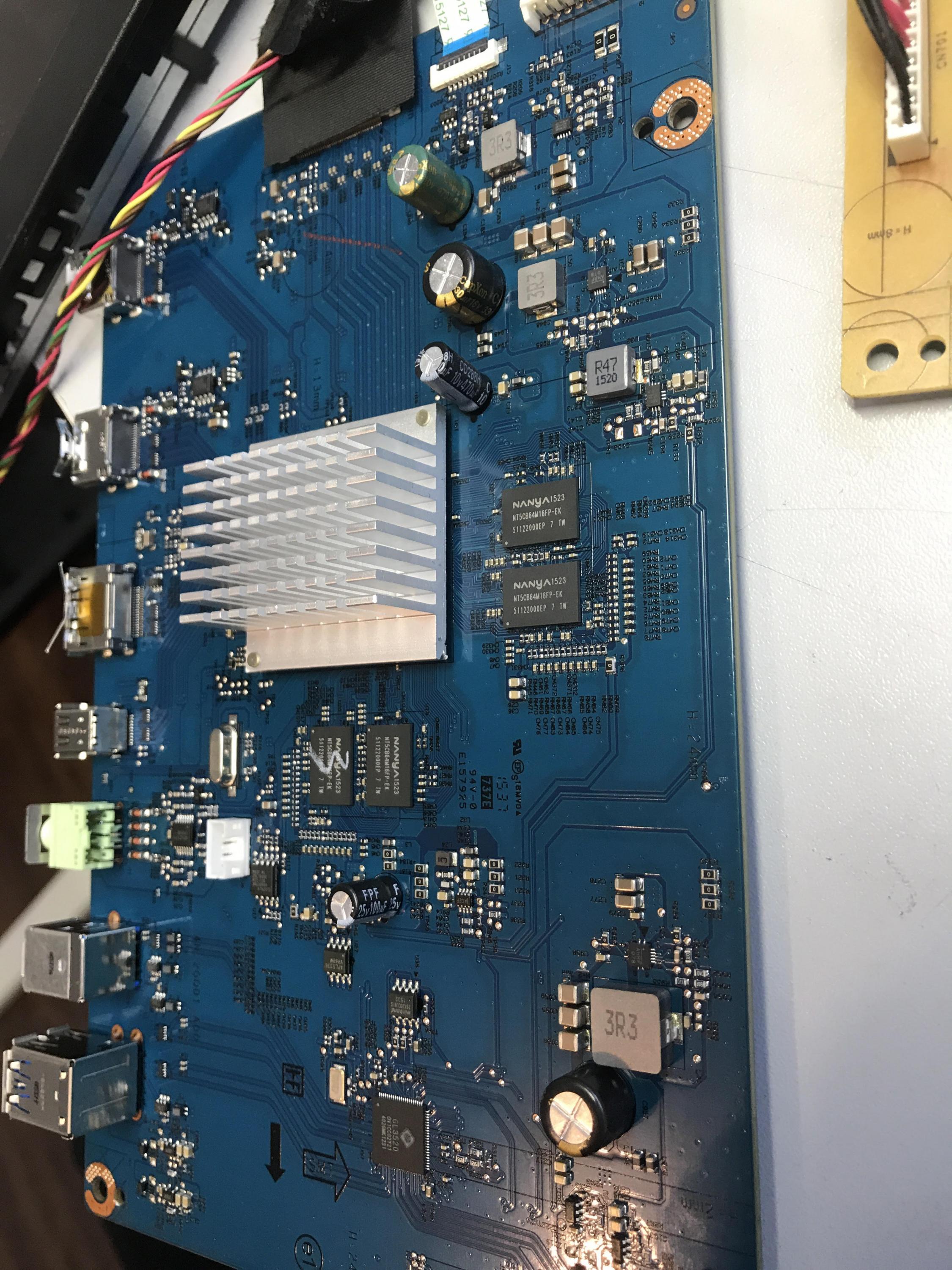

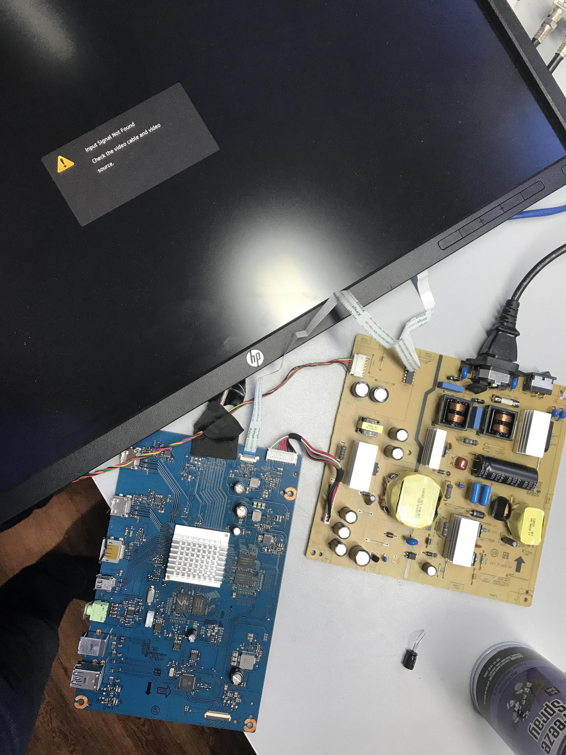

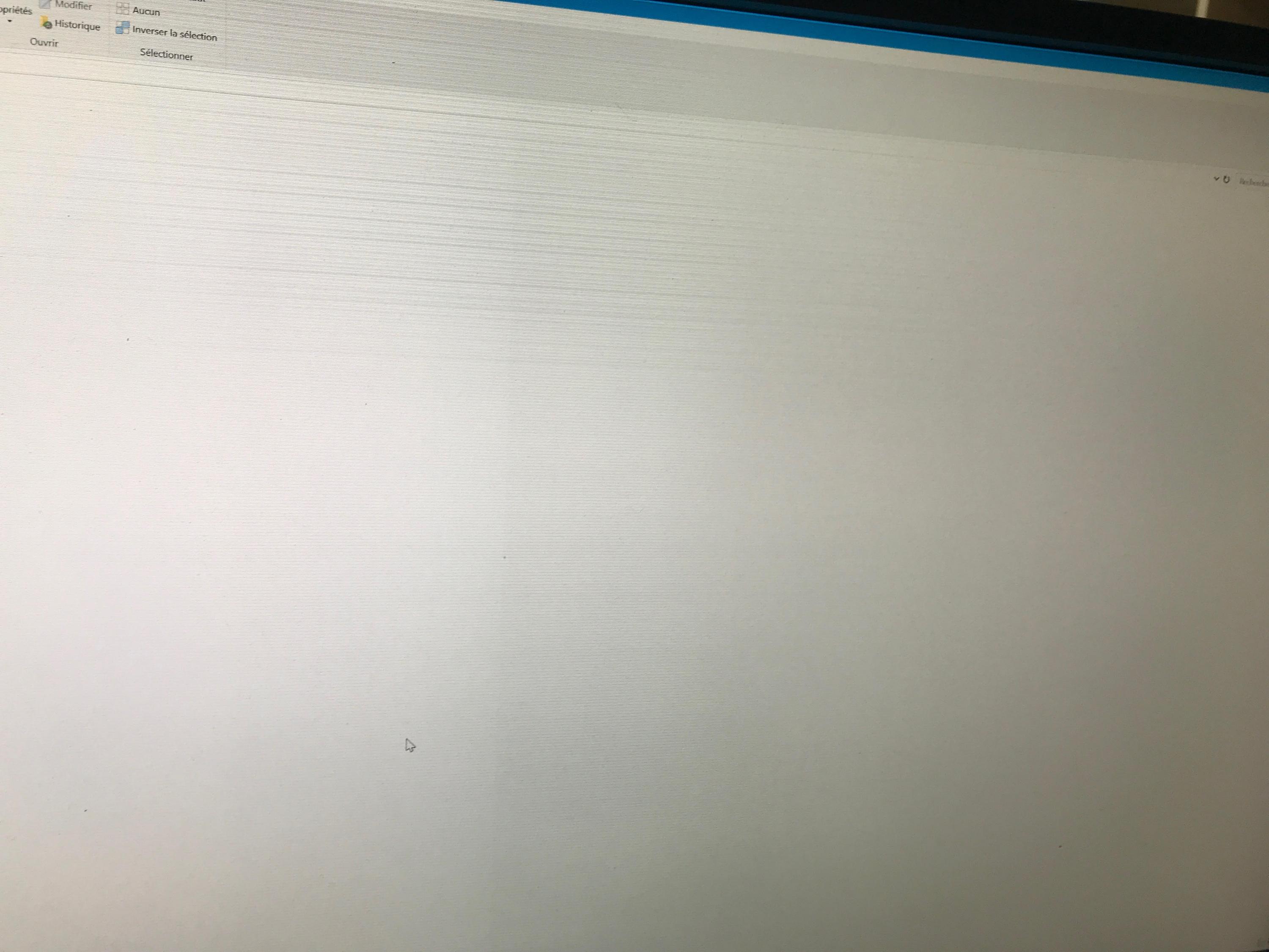

    Hello ! I have an HP Z27S display here, top of the line 4k monitor from 2017 that sold for about 900$ Canadian, still under warranty and hp denies repair.. Anyway, that's another story.

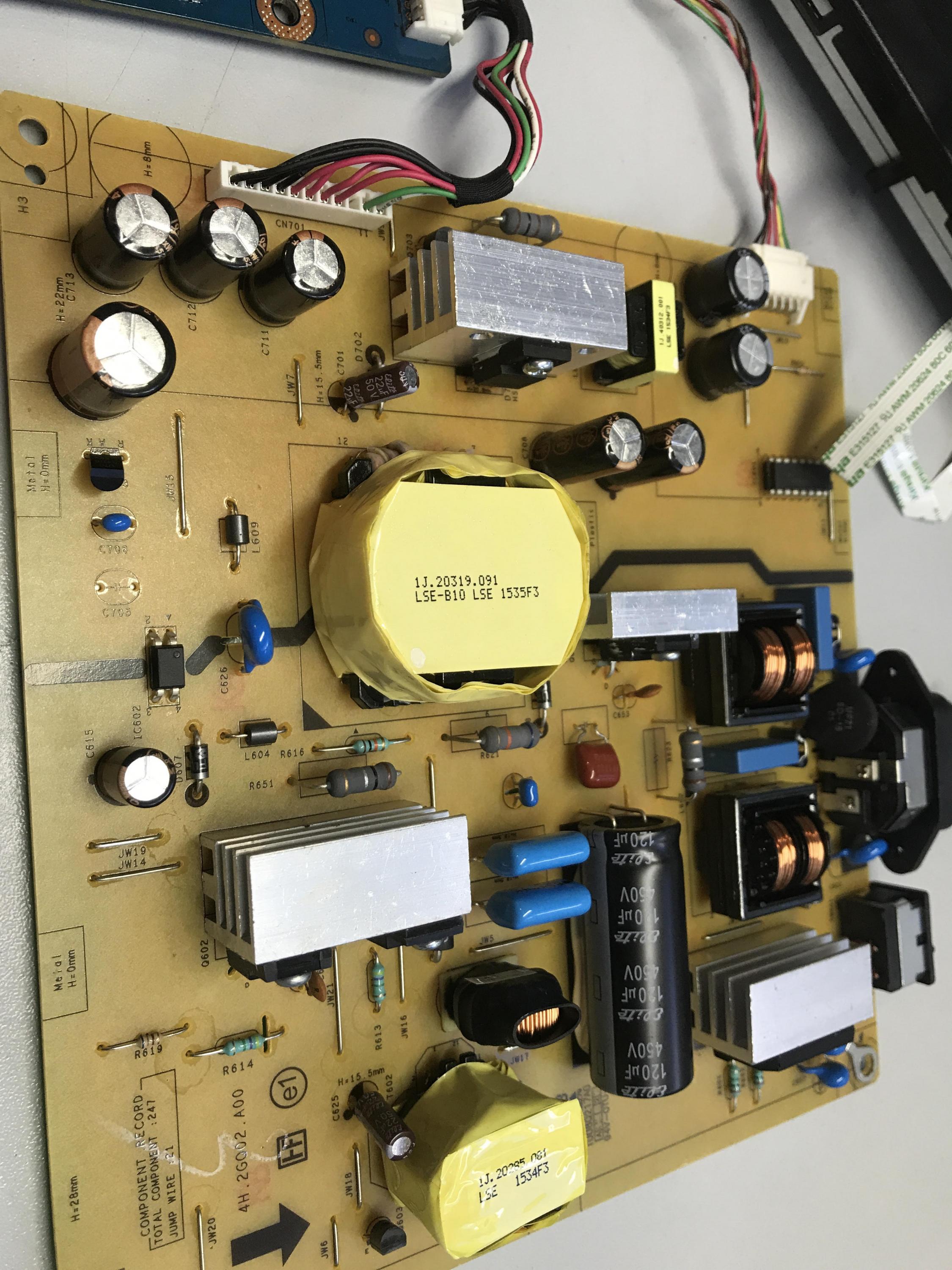

    Here's a picture of what it does, ive torn this thing apart and i was wondering if anyone has seen a similar issue, or have any clues of what could be causing this. Bad caps in psu ? I've tried heating and freezing the boards, either psu or the input board and no difference. I've noticed the issue is also present on the OSD of the monitor, with no input signal connected. Caps seem good visually. Any pointers would be really appreciated !! thanks

    why does HP deny repairs, It looks like a panel issue, A power supply problem would likely cause a problem over the whole screen not just part of it.
    Did you happen to buy it used or refurbished?

      It's a customer's screen and i can't find the invoice for it. HP asks for the receipt.. What a pain. Anyway, you think the panel itself is bad ? :|

        That would be my guess, What happens if you change the screen resolution to something else, does that have any effect on the lines?

            Hello ! It seems resolution changes have no effect at all on the panel's issue. I've also tried freeze-spraying or heating the pcb that's on the panel itself and the problem is still there !

                    The panel looks ok to me, it has BL and no regional defeceits. I would have to say it's an issue on the built in T-con board.
