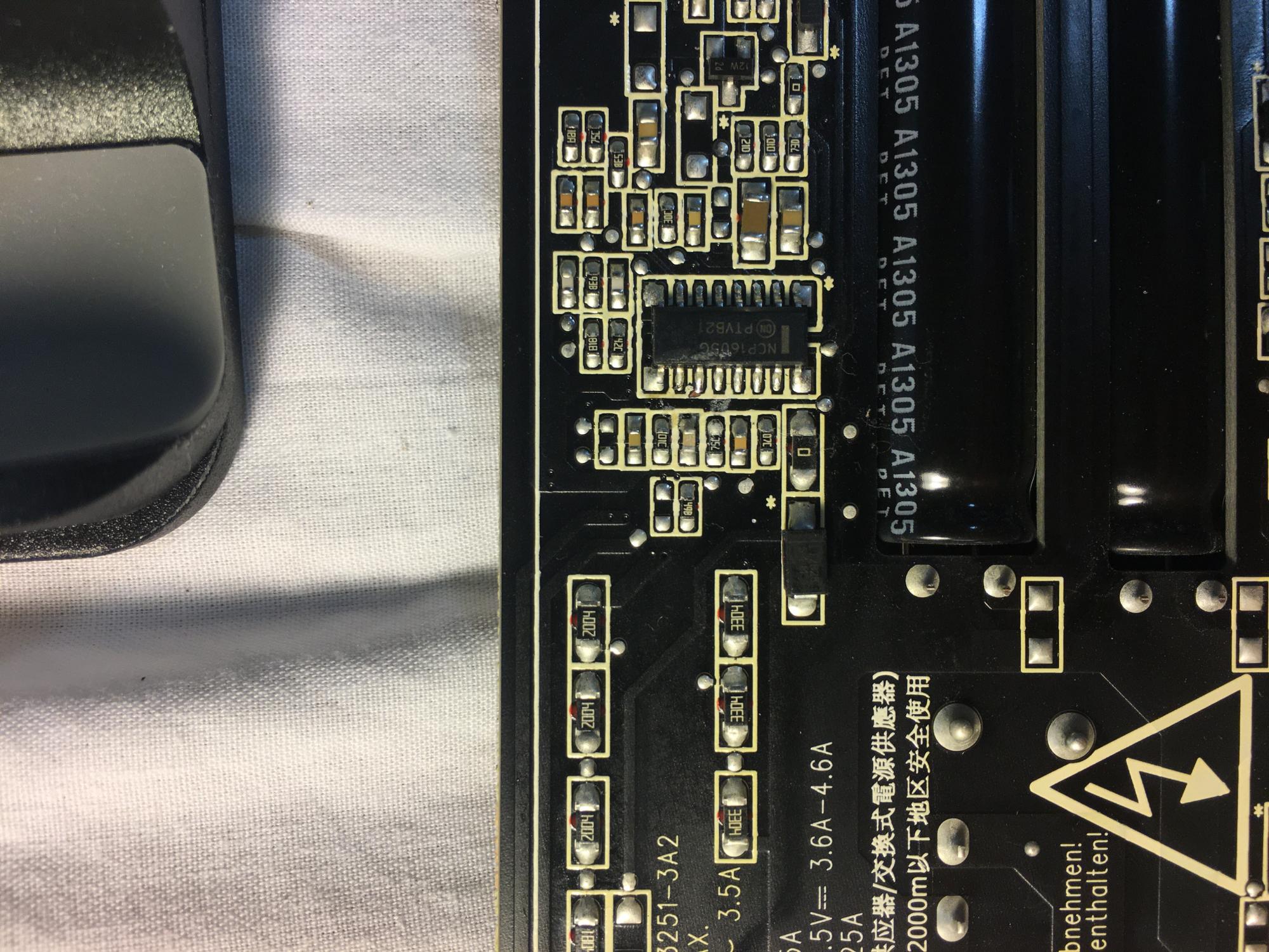

      Guys I'm still unable to source a picture for the thunderbolt power supply. Would really appreciate if someone could help with images . Thanks

        Re: Apple 27" Cinema Display (A1316) has trouble turning backlight on
        See attached.
          Hey misterkeeks, amazing picture dude... thanks a lot for it ! Exactly what I needed . Now I need to order all of the resistors and figure out the Oscillator pin caps the two white ones in your picture either-side of resistor 93b. If you have any ideas do let me know. But anyway thanks again for the image
