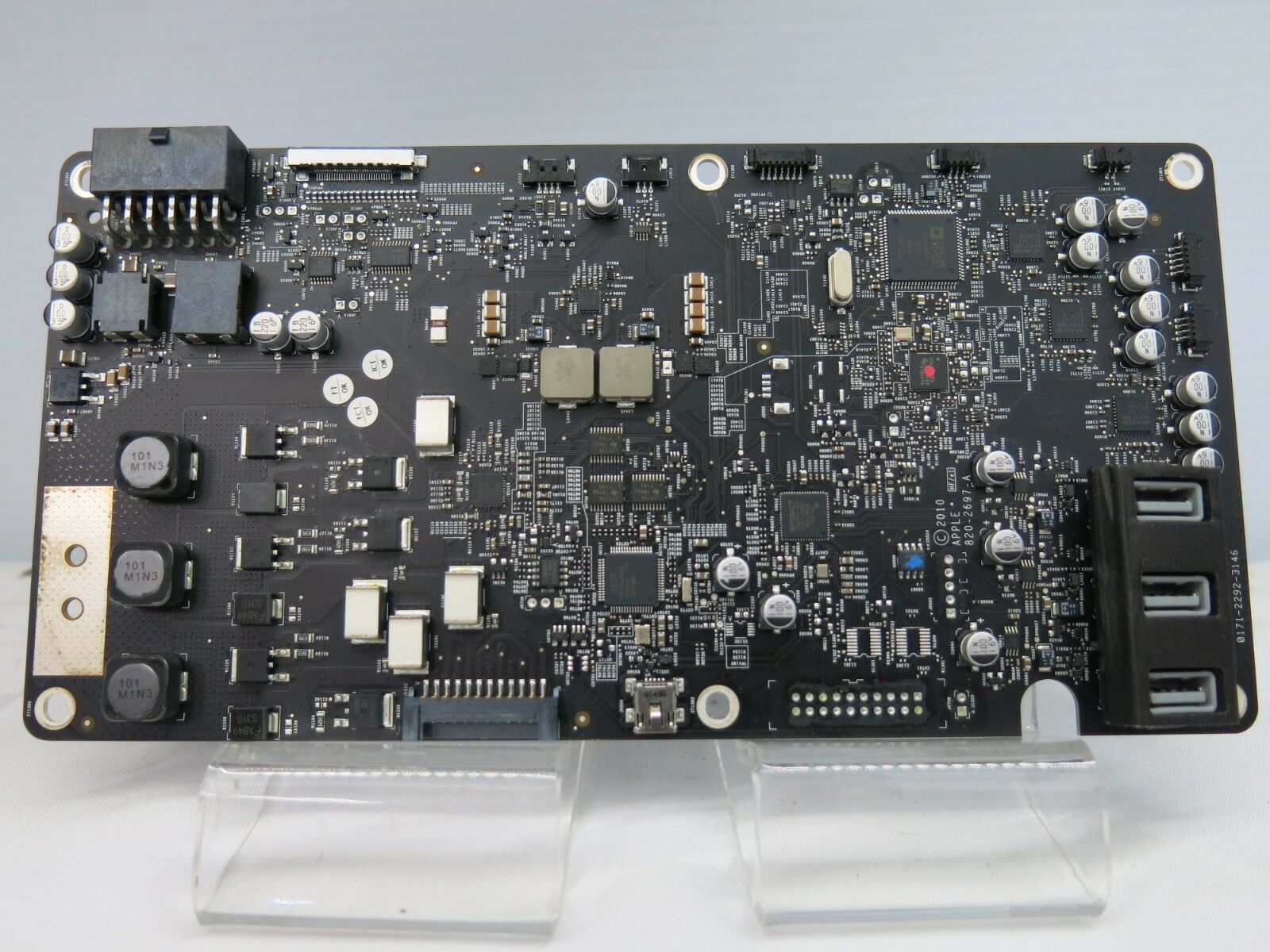

            So, next suspect I guess is the main board, which also contains the backlight circuitry. I’ve attached a stock photo of this board to the post. The backlight connector is the black plastic connector on the bottom left/middle area.
            Seems like there are a lot of SMD electrolytic capacitors, as well as some voltage regulators (?) in that region. I can replace the whole board for $35, but are there any things I can diagnose now with a multimeter?
            Also, is it possible that failing LEDs would require more current to start up, thus causing an intermittent failure to turn on the backlight?
            I guess I’ll try the hairdryer trick on the main board as well.

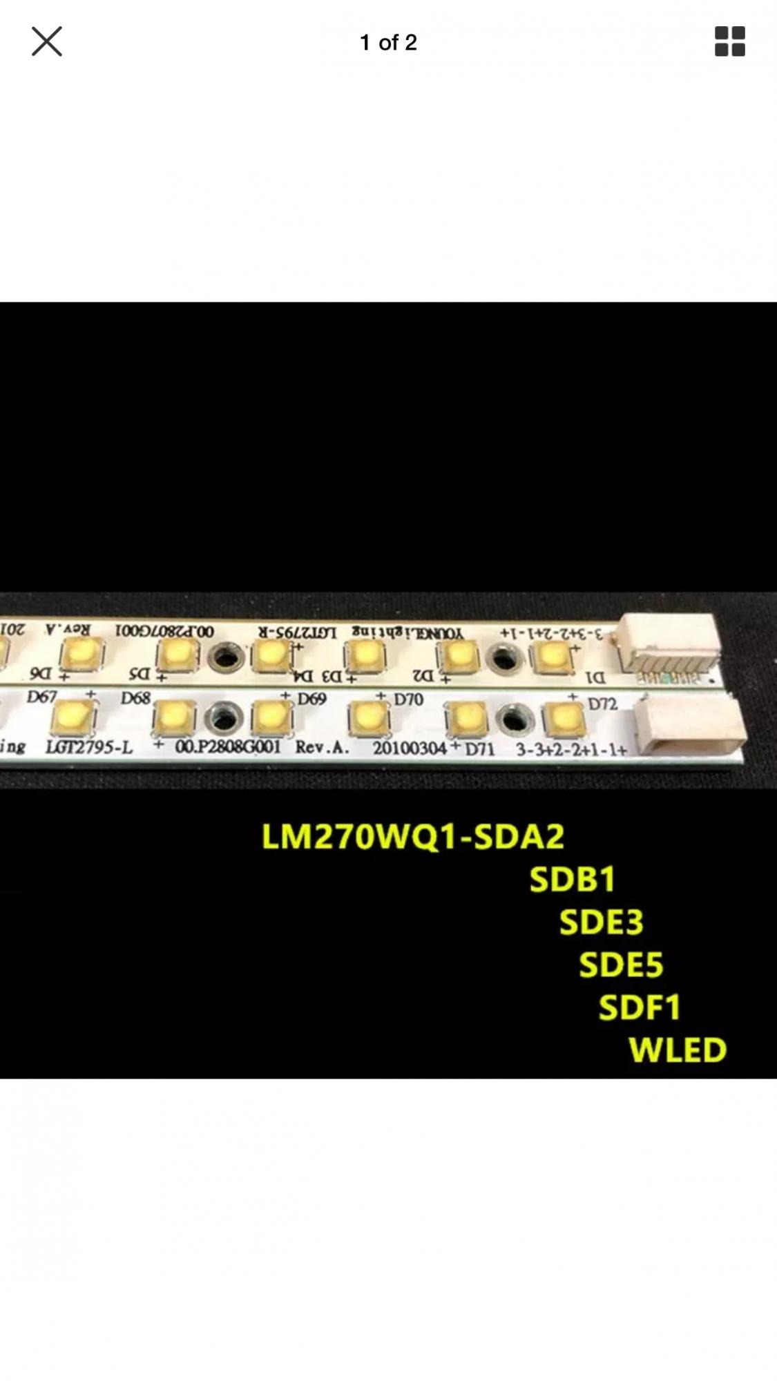

                  This is what I purchased - later on I realized that other sellers on AliExpress had it cheaper - about $11. Attached a picture for posterity.
                  This is the same panel used in the 27” iMacs- the backlight likes to fail there too, typically the connector on one side goes out, leaving half the display dim.

                        both have failed to fix the issue, which leaves me with the logic board.
                        For what it's worth, 27" iMacs use the same panel, but do not fail in the same way. I guest that should suggest that the failure is not located in the panel, but in the logic board (which is not shared with the 27" iMac. Any ideas on how to troubleshoot this?
                        This problem happens when the backlight controller does not provide a PWM signal to the LED drivers for brightness. Previous "repairs" seem to simply bypass the controller and tie the PWM to 3.3v, thus keeping the backlight on at full brightness.

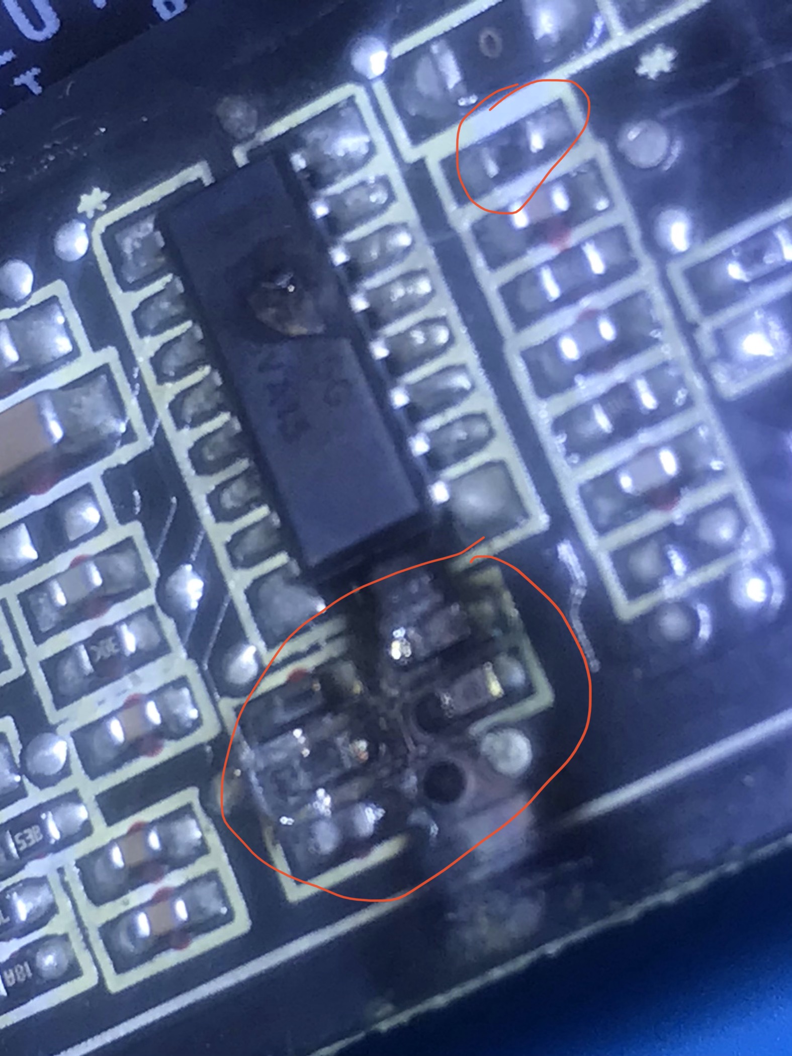

                              guys I need the values of some of the components around NCP1605 on the power supply board .
                              I'm attaching an image for reference . I would really appreciate it if someone could help.
                              Apple thunderbolt display PSU
                              Board model number : PA-3251-3A
                              the first one I got the this thread itself.
                              and the burnt one is what is the current condition of my power supply .
                              Also if someone is aware of schematics . I could just use that.
                              thanks everyone. this is one of the best fourms I've come across .
