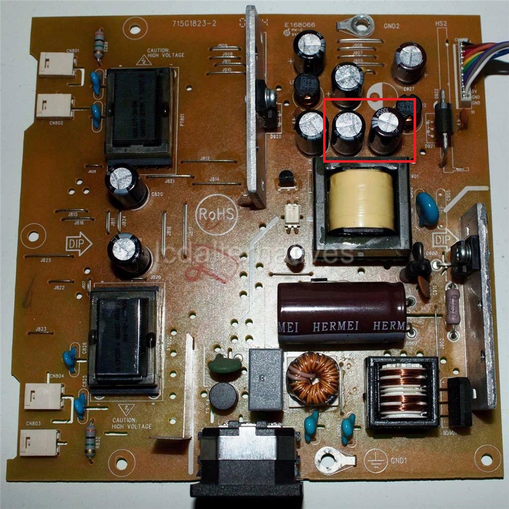

    I noticed lately that my Viewsonic VA903MB monitor had some issues, flashing black screen rapidly and 2 or 3 inch wide green bar going up and down vertical. Flashed so quickly I could barely see boot screen etc, so I took it apart and noticed a couple blown /bad capacitors.
    I took them both out, but stupid me forgot to write down the pin numbers for each one. I already ordered two 10 pieces of both sizes on ebay...
    Elite 1000 uF 16V
    Elite 680 uF 25V

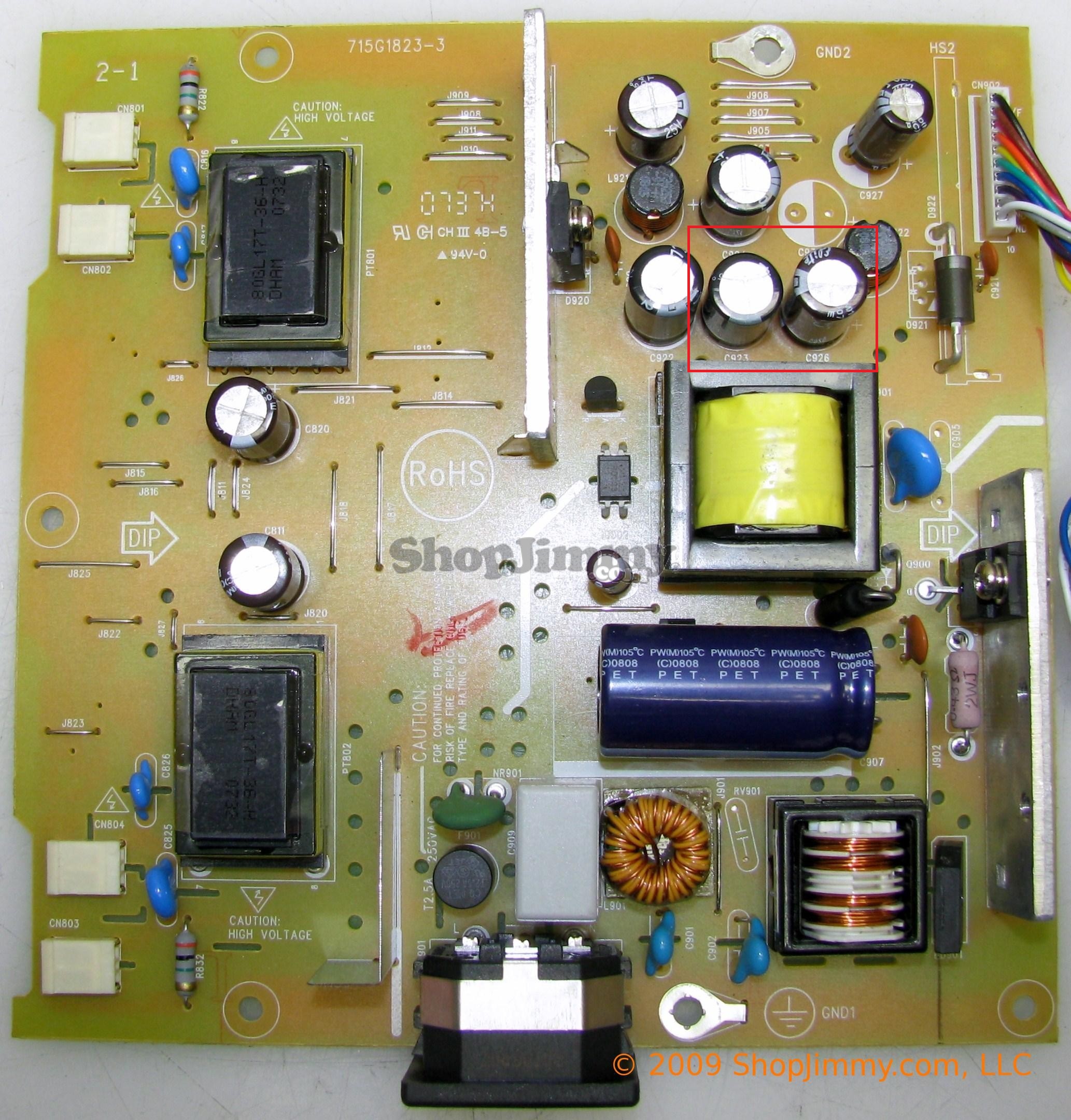

    I managed to find two pictures online that resemble the exact circuit board I'm needing answers to. I just need to confirm the right capacitors for the right pins.
    Pin #C923
    Pin #C926
    In the two pictures I have, I put a red border box around them. And from the one picture off of ebay I noticed the "far right" one has 1000 uF on top of capacitor casing. Does anyone here know for sure or that I'm correct?
    Pin #C923 gets the 680 uF 25V and Pin #C926 gets the 1000 uF 16V capacitor...? From now on I'll make sure to write down pin numbers and which capacitor size goes with which. Lol!

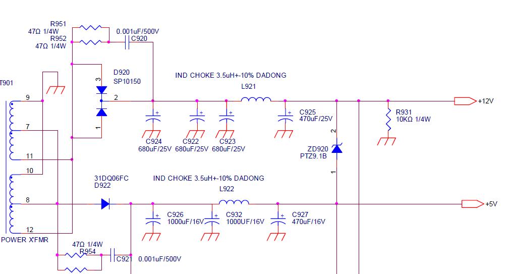

    C923 is the 680µf/25v; C926 is the 1000µf/16 volt

      Thank you!
      I also took apart another NEC 24" monitor that had some water damage and found several 1000 uF 16V capacitors in it that weren't blown that I could probably just use one of those.
      But I'd have to wait anyway for the 680 uF 25V capacitors to arrive in mail before putting it all back together. I my as well just wait on both new capacitors and not risk using the ones from other bad monitor that had water damage.
      There was a 1000 uF 25V in the NEC 24" monitor, but it might be too big in diameter to fit in the pin area. It's not bad to use bigger uF sized capacitors right, as long as the voltage is same?

        You can use a larger diameter as long as it fits, also you can use a larger voltage, you could use 25v caps for the 16 volt ones also. It is best to keep the capacity (µf) the same but in this power supply you could use 1000µf for the 680µf also.

          Oh okay, that's great to hear! Thanks for your help / input. Much appreciated! I'll try two from old monitor once and if anything goes wrong with them, I'll still have the new ones coming in mail from Hong Kong. My as well try something for now and see if it works.
