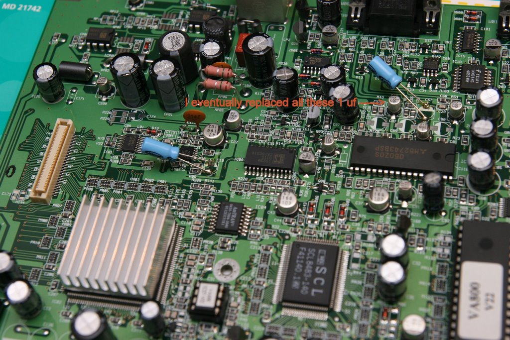

    I acquired a Viewsonic VA800 LCD monitor that works but has rolling horizontal lines. Looks like interference on a television. It is not as bad at 75 hertz and is most prominent at 60 hertz. Weird thing is that I don't get the rolling lines when the computer is off and I get a "no signal" display. Also, display is fine during "power on self test" on one computer but not on another computer. Once Windows is on screen, I get the rolling lines.
    It is not my video card or computer since other monitors work. I checked that the cables are seated tightly.
    I searched google and found that the 1 uf capacitors tend to be bad so I replaced all 5. But no change.
    Any ideas?

    I never say any bulging caps. The caps I replaced are the metal ones. I'll try to attach a photo of the board.

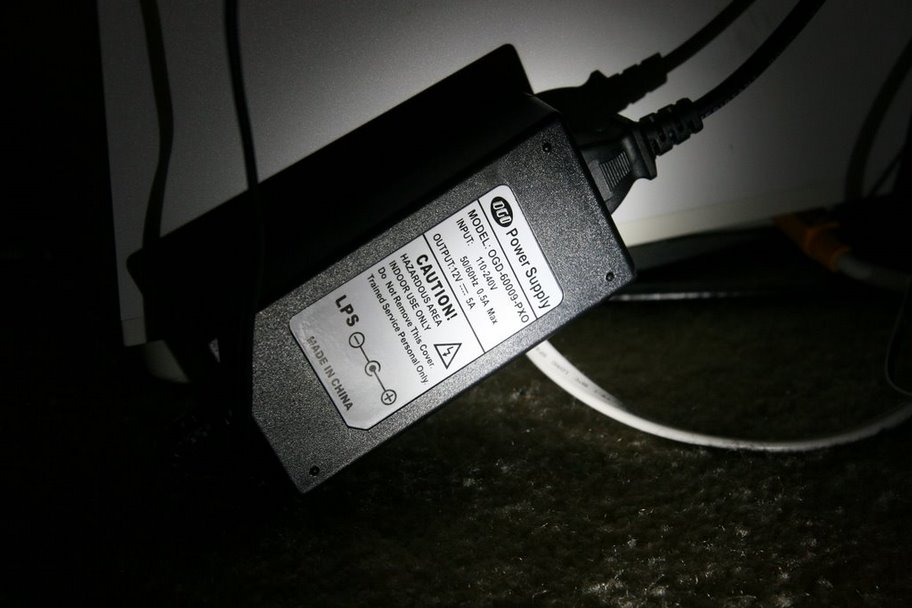

            Can you post a pix of the external power supply? Also, a close up pix of the rating tag would be useful.

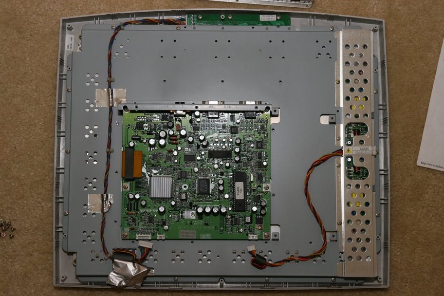

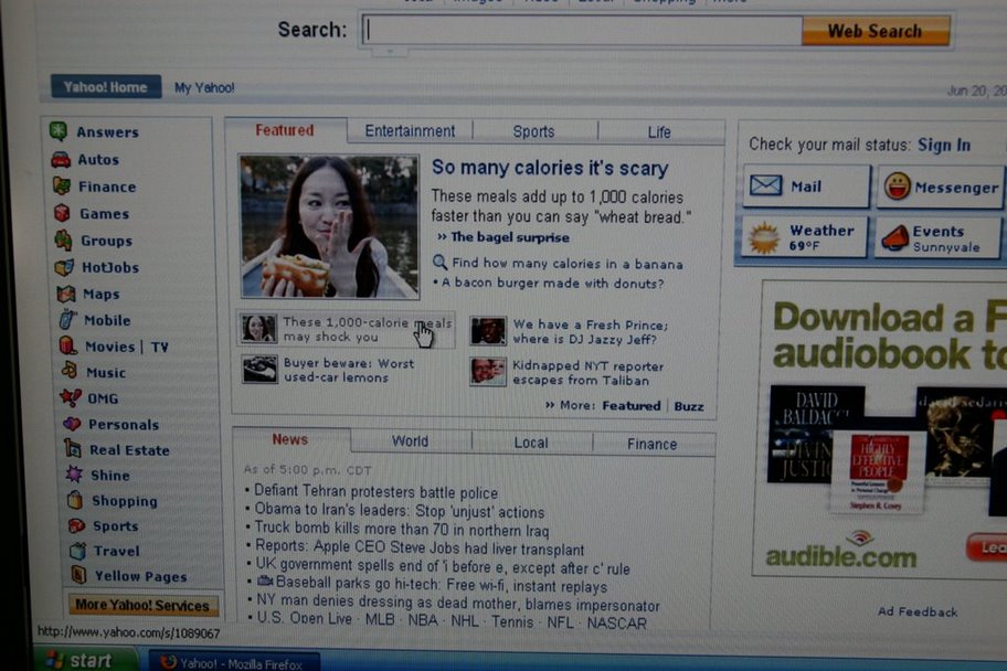

                Here is a pic of the external power supply. It is brand new from ebay. My wife picked up the monitor from a garage sale without the power supply so I had to get one. The prior owner described the same problem but I actually tried to fix it before ordering the new power supply so didn't see for myself.
                I also have a picture of the what the screen looks like. It is hard to see in the photo though. You can best see the lines by the "My Yahoo" bar near the top.
                I also have a photo of the opened monitor. Let me know if you need closeups of any part of it.

                  How did you determined that the external power adaptor need to be 12V/5A? Was there a label at the back of the monitor that indicated that?
                  Do you have access to a bench p/s that can put out pure 12v 5A dc?
                  It is just a possibility that the monitor is power hungry and your ebay p/s has too much ripple when pulling 5A.

                      Re: Viewsonic VA800 with rolling lines
                      It says 12V 5amp on the back of my monitor.
                      I don't have a bench p/s. I have an old computer p/s that will supply 12v though. But not sure of the best way to connect it up.
                      Here is a link to the brick I got.

                              i have repaired several of this series of viewsonic.
                              you need to replace all the surface mount lytics.

                                I just found a way to connect a spare computer p/s to the monitor and got the same rolling lines problem.
                                • hulla
                                  • Jun 2009
                                  • 7
                                  ouch. ALL of them? Desoldering these is kinda tough for me. I'm using a 15 watt soldering iron.
                                  These are the surface mount beer can ones right?
