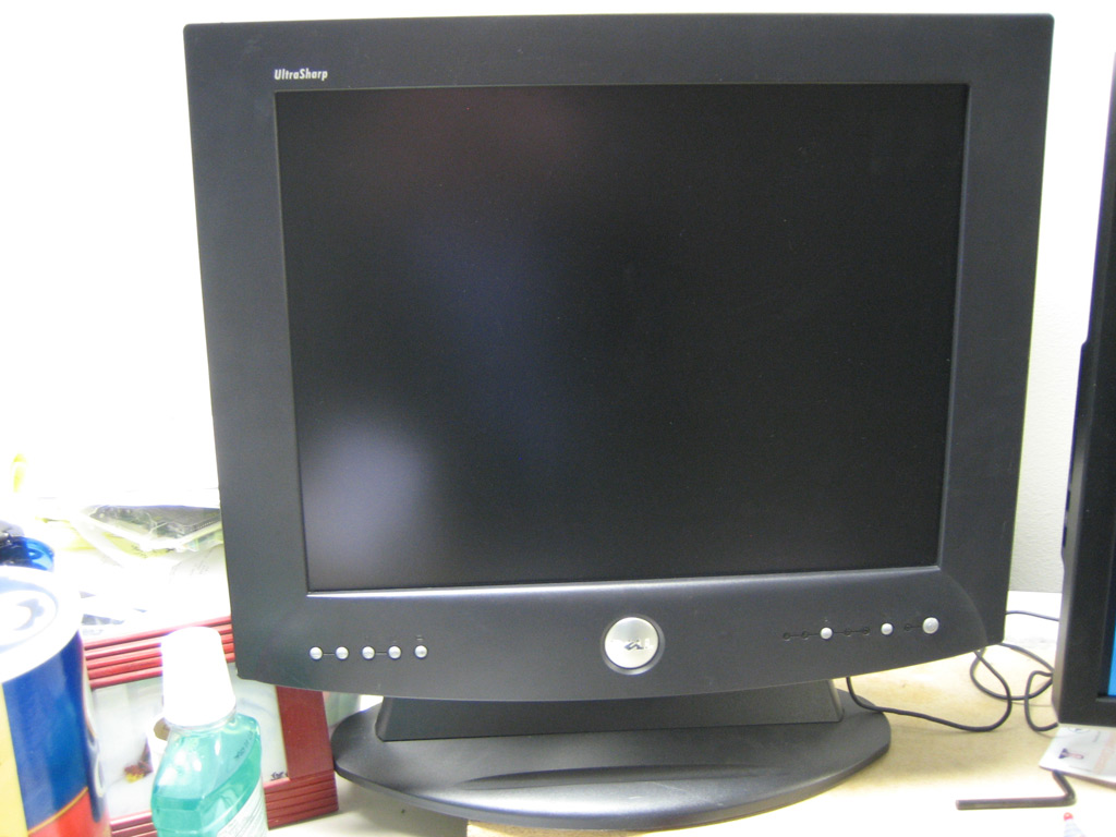

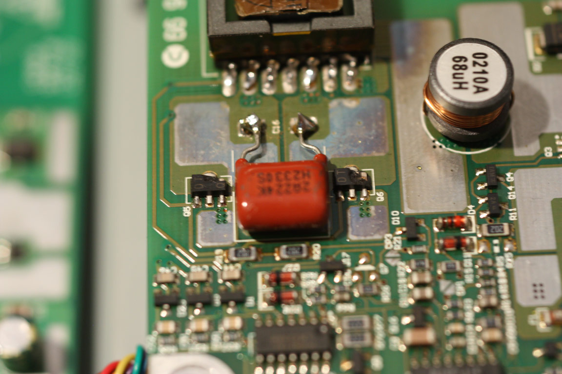

    Dell UltraSharp 2000FP Bad Inverter Board - Bad DT Transistors?
    I have a Dell UltraSharp 2000FP 20" LCD Monitor that doesn't show anything on the screen (though I do get green lights on the front controls). I've tested both the logic board and screen in another unit and know that this inverter (part # T051023.00) is bad. Upon visual inspection, I noticed that there are 2 transistors (DT) that appear to be chipped!
    I've ordered some new DT transistors form eBay, hoping this will solve the problem (replace what's visually bad first, right?), but does anybody know how to replace such a tiny part? What techniques are out there? I'm worried since the part seems soldered to the PCB and since the part itself is so tiny. Any help would be appreciated. Enjoy the pics,

    Re: Dell UltraSharp 2000FP Bad Inverter Board - Bad DT Transistors?
    Blown out, not chipped off.
    Either bad lamps or transformer failed.
    Cheers, Wizard
      Originally posted by maverick530
      ...that there are 2 transistors (DT) that appear to be chipped!
      Chipped?!?!?! They are blown.
      And good luck trying to change that small guys. You should check all that side of the inverter (especially the transformer).
        I would also suggest replacing both caps on the inverter and resoldering the transformer associated with these transistors. Wizard is right (he usually is), SOMETHING caused these to blow.
        Replacement is fairly easy. I would suggest getting a kit of Chip-Quik. It's a low melting point alloy (Woods metal) that will blend with the solder and reduce the melting point. I'd load up the legs well, then use a heavy (60 Watt) soldering iron to melt the tab free. Clean the pads thoroughly, apply a little flux, hold the replacement transistor in place and solder it in using a 15 -25 watt soldering iron. This usually takes three hands, so get some help. Do make sure the tab (collector) is well soldered to the metal pad; that is the heat sink.
          Thanks guys. I've resoldered the transformer leads and all other leads on the Caps. I may replace the caps as well, but they look good.
          I'm looking into that Chip-Quik and it's going to be about $25.00+ easy for the kit. It's a little steep for fixing only one board (I know I will be able to use it on others, but I only have one of these inverter boards to fix in this way). Is there any other more cost-effective method for removing this type of chip?
            Before Chip-Quik one trick was to get a piece of very fine steel wire (piano wire) and slide it under the legs while heating them. This would bend the legs up as the solder melted. Another approach would be to cut each leg after melting the solder (don't try to cut the legs without melting the solder, you'll lift the pads).
            Still another way is to use a heat gun (the type used for removing paint) to heat the chip to the point the solder melts. Mask the board with aluminum foil with a small cutout around the transistor.
            Or Buy Chip Quik here
                Ok so at that price, I had to go for the Chip Quik. Thanks for the link.
                I finally had an hour and desoldered the chips with Chip Quik in a snap! It was so easy! I am a huge fan now! It was a pain in the butt getting the new tiny part soldered without soldering the leg leads together, but I finally did it by seating the collector base first, then worrying about the leads with the least amount of solder possible. That did the trick.
                I didn't have time to replace the 2 caps even though I purchased them. I plugged the inverter board in, and success! My Dell UltraSharp 2000FP 20" LCD is up and running again! Thanks all for the wonderful support, yet again!
                  Replace the caps now. What if those two blew because of them?
                          I'm having the exact same issue as the op, with the same monitor, and same chip on the inverter board.
                          http://i663.photobucket.com/albums/u...0fp_Invert.jpg
                          Does anyone know where I can get the transistors to see if I can get the monitor working again?
                            Please do not use photobucket for images. On the 'Reply to Thread' screen scroll down to 'Manage Attachments' and use that.
                            Excuse the long winded lecture that follows. This is to provide a step-by-step path for others to follow.
                            1. Go to http://www.s-manuals.com/ It's a site with a number of good sources for information.
                            2. In the left column click on Marking SMD
                            3. On that page click on the first two characters of the marking code. In this case, DT.
                            4. If there are multiple lines on the target page, select the one with the correct third character AND / OR the correct package type. In this case, there is only one choice.
                            5. Copy the Device Name (in this case, 2SD2391) to the clipboard, go to your favorite component vendor and search for it. In this case, I went to Digikey and found they have 1686 in stock at $.77 each. Mouser has 153 in stock at $.72. If you order from Digikey, specify USPS First Class Mail shipping, which will run under $3.00. The cheapest shipping from Mouser is Priority Mail, which is several dollars more.
                            Of course, this applies only to the US. If you live in one of the 289 other countries you should try a local vendor.
