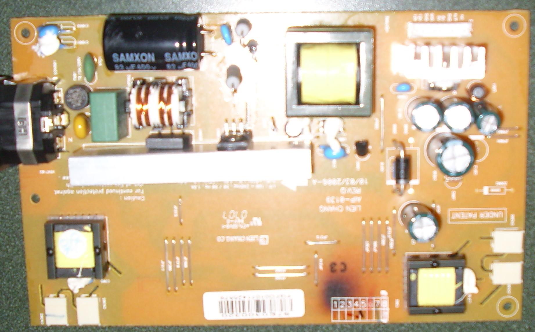

    The Green Power light will come on and then go to amber. The screen never flashes on at all. Supposedly this monitor was used for about 3 weeks. and then sat on a shelf for months. IT was made in may 07.

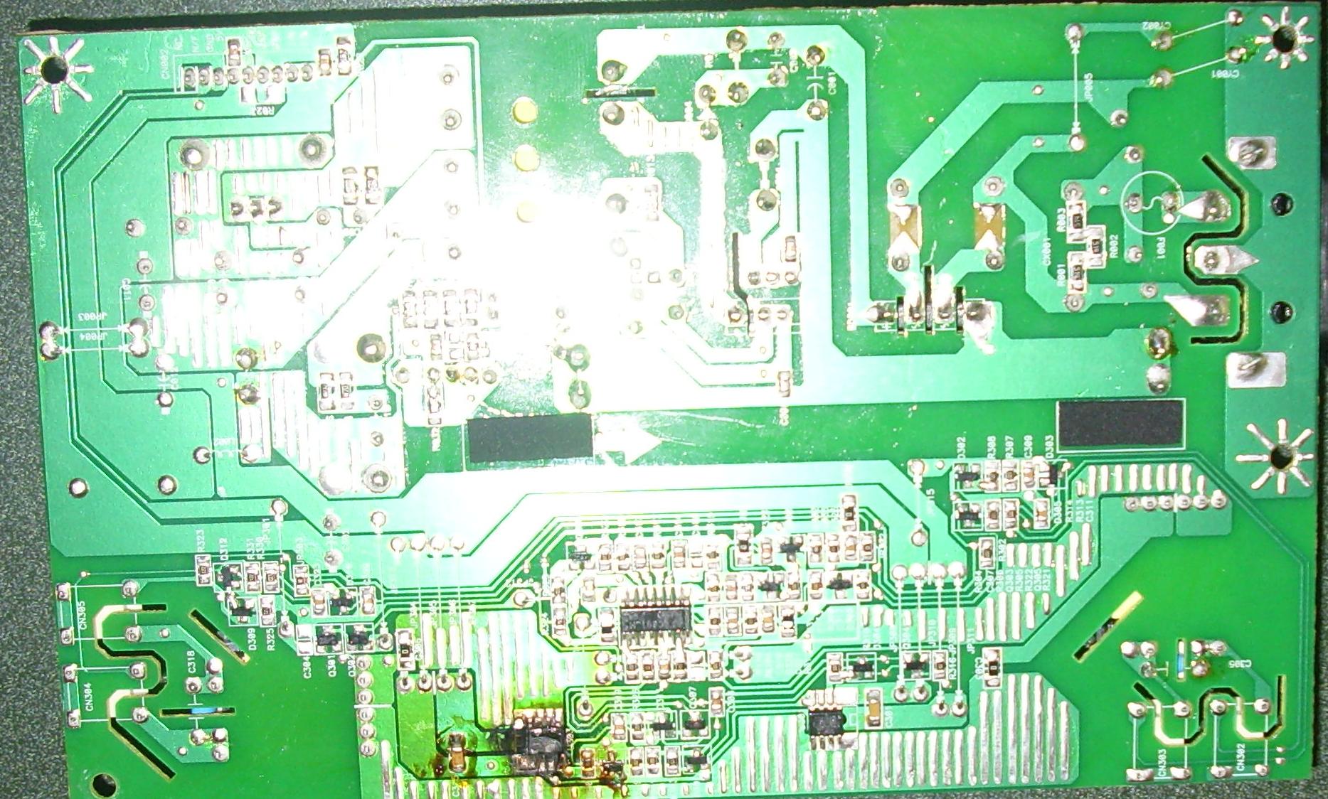

    There is a burned up ic on the bottom of the board and i have no clue how to figure out what it was, or what would have caused it to go bad.
    FYI: the 12v on the inverter is steady at 11.97v and the 5v is steady at 5.05v There is no 3.3v on this board that i can find.
    Any Ideas guys?

    not a very good picture but its probably a mosfet, one of a matching pair the other one is to the right of it, one for each transformer
      Re: Hyundai U90d no screen flash at all
      I agree. The burned up (left) is mirrored on the right. See what part number is that and you will know the part no. for the burned up.

        I have identified the other one it is this this
        https://cdn.badcaps-static.com/pdfs/...32cac38da5.pdf
        However digikey, mouser, and ebay do not seem to have it. any ideas on where else to find it would be appreciated.
          also once again i was pointed to this from someone
          and i can find it but. I dont know if its right.
