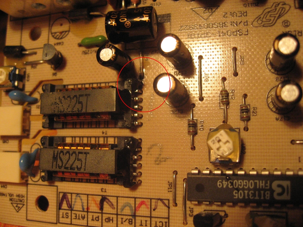

    I have tried to fix two of these so far with almost no success despite having fixed numerous other monitors. Can anyone reliably tell me which are the switching transistors on these boards. I have seen variuos posts describing "cures" but have yet to see a successful outcome
    Attach clear pictures of the top and bottom of the power supply / inverter board. Also, a little clearer description of the problem would be useful.

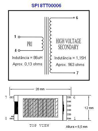

      Hi guys,
      Firstly thank you to all contributors - your wisdom really helped!
      I had two Dell 1504FPs exhibiting the dreaded "2 seconds to black". I changed caps C17 A,B,C and D... C17 and C23 - but still no luck.
      Checked the primary and secondary resistances on T1, T2, T3 and T4 and found the problem. Each monitor had a single transformer whose secondary was higher than the specified 0.9k. They were approx 1.7k and 1.9k respectively. So I removed them.
      I took a healthy txformer from monitor A and replaced the bad one on monitor B and VOILA! - it works.
      Now just need to scrounge around to find another healthy SPI 8TT00006. PS.
      Nice CCT diag of the txformer attached.
      Cheers all,

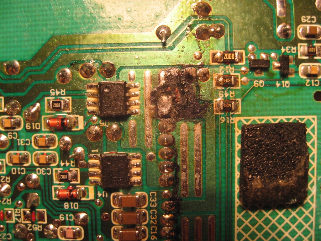

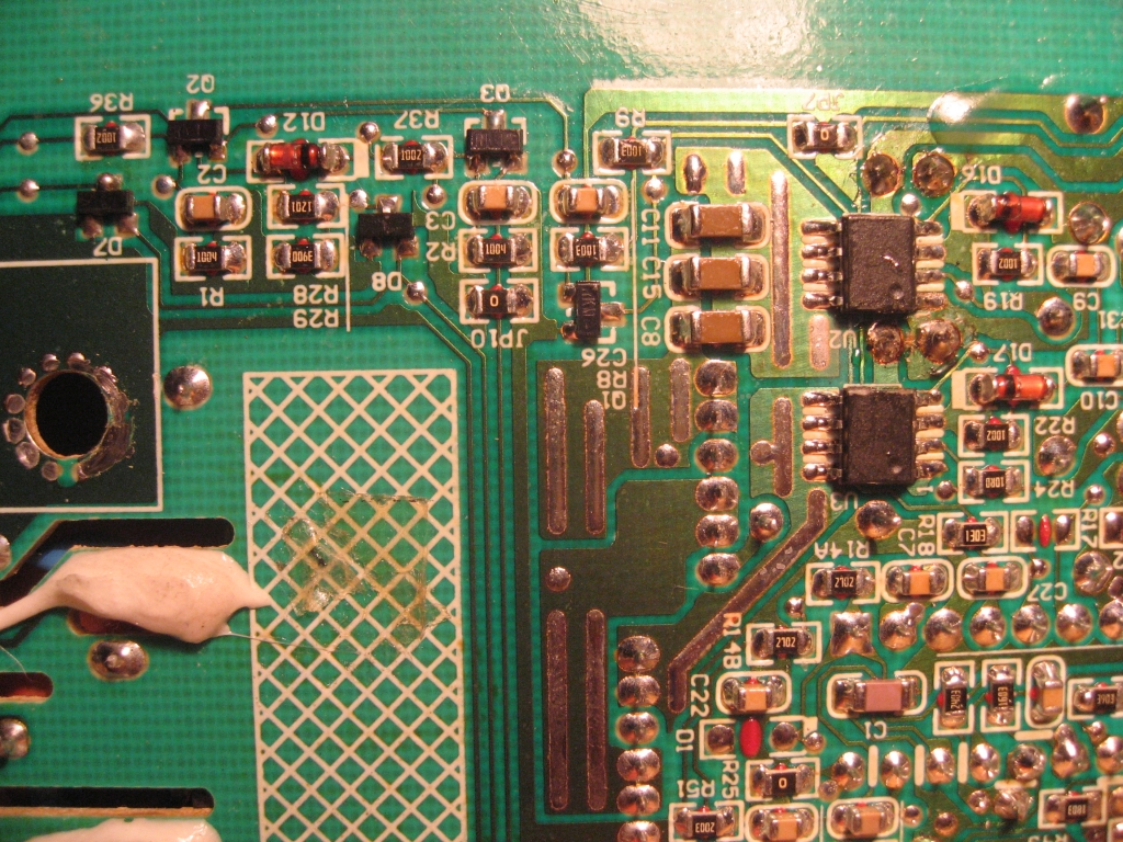

          Re: Dell - 1504FP W/Pictures - new problem
          Hi guys,
          As luck would have it of the two monitors I fixed, one has come back in when the smoke escaped from another component ... I'm just not sure which component it was. Any ideas what needs to be replaced there? See attached shots) ... and what may have caused it to fail? I suspect that after re-capping and replacing the busted txformers, the unknown component was next in line.
          I may be able to get the second monitor back to compare PCBs and identify the burnt component(s) but thought I'd check here first.
          Thanks in advance.
          • mhakat
            • Jun 2011
            http://www.diyprojects.info/bb/ftopic41030.html
            NAMA - check out the above link a guy called Michael seems to know what the issue is
            Sorted it! I soldered a 47k surface mount resistor over the surface mount
            capacitor (C25, on underside of PCD, near BIT3105- in case anyone has this
            problem in the future) and it works fine. OLP circuit disabled. I think I'll
            notice if any of the lamps die- dont need all that overengineered circuitry.
            Thanks for your help people.
