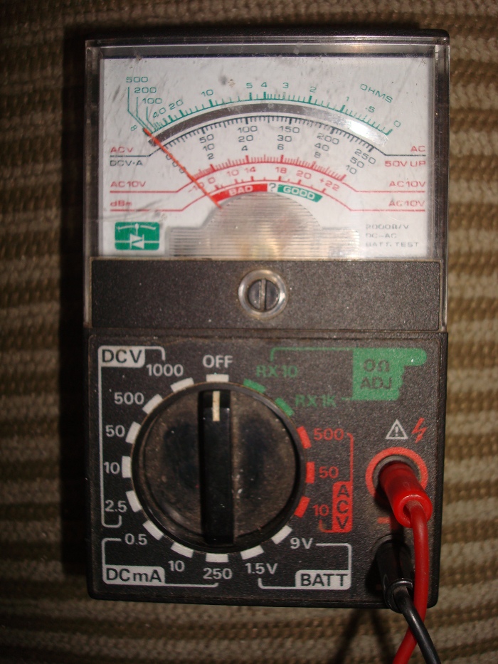

    This Dell powers up shows display perfect then back lights kick off. I replaced 3 CapXon caps with obvious bulging still the problem remains.
    As you can see in the picture c17a,b,c & d have discolored the board around them. But with no markings at all on the "what i would guess to be a cap" I have no idea what to replace them with.
    Would you also suggest replacing all caps on the board?
    Thanks in advance. Jacob

        You also might want to look at the opposite side of the board. While it is possible the caps overheating discolored the board, it is more likely that the transistors driving the transformers are located on the bottom side of the board, and are the source of the heat.
        PlainBill
          Re: Dell - 1504FP W/Pictures
          Correct PlianBill. The transistors are located directly on the other side. I guess it would be cheaper in the long run to buy a ESR meter and not recap every monitor. Thank you all I will let you know how it goes. Should I re size the pictures of boards in my future postings? or is it better to have them large?. I know these posts will be valuable to the next man just as the old ones have been to me. Jacob

                How exactly did you come to the conclusion your transformer was bad?. I have replaced all caps on this board and nothing has changed. I still have the 2 seconds to black issue. I do not have the money yet to buy an ers meter. can i use this to test the transformer?.
                Thanks again for all your help. I learn very fast and hope to be able to help others here in the future.
                ^Learning to walk on rice paper without leaving a trace,
                  Nope, a VOM won't cut it. At this point you have two more things to try.
                  1. Try the monitor in a darkened room (face down), you are looking for signs of arcing around the transformers.
                  2. Buy a case mod kit, the kind with two CCFLs and a cheap inverter. Use the CCFLs to test the monitor's inverter. (It will be necessary to test each output of the inverter with the CCFLs.) Use the inverter to test the monitor's CCFLs.

                        Not really. The controller drives the transformer (through one or more transistors) AND monitors the output voltage and current. An arc between turns in the secondary of the transformer will result in reduced voltage and reduced current. Many controllers will shut down the backlights if the voltage goes too high, and if the current is too high or too low. The particular inverter you have uses the BIT3105 (now the BIT3713). I've attached a datasheet showing a schematic for an inverter based on it. Note the feedback lines from the CCFLs to the controller. A VOM wouldn't work, but someone with a oscilloscope could monitor those lines and quickly determine WHY the controller was shutting down. (Well, first he'd have to trace the connections, your inverter isn't identical to the one in the app note).

                                Neither an ESR meter nor a VOM will test the transformer. The proper test tool is the ring tester. Without desoldering the 3 good transformers show all leds on the low voltage side. The bad transformer shows no leds. All transformers show no leds on the high voltage side. I didn't have the ring tester when I diagnosed this transformer so i did it the hard way.
                                It isn't too hard to test the transformer the hard way so long as the backlight flashes and there is more than one channel to test. Test each lamp in its channel separately with all the others unplugged. Watch for differences in the way each channel lamp lights up. Partially damaged lamps or channels may stutter and never reach full brightness which will get shut down by the controller. You might find that some channels flash their lamps and some are dark. Switch lamps and channels to test the unknown lamps in working channels and the unknown channels with working lamps.
                                In my case all lamps worked equally well and one channel was completely dark. I guessed that the transformer was the most likely failure so I desoldered and swapped the suspect transformer marked with an X into a working channel and the good transformer marked with a dot into the suspect channel. The formerly good channel went completely dark and the formerly dark channel was now good.
                                The ring tester is a lot faster. With two screens you'll get at least one working and have enough spare transformers to send one to me.
