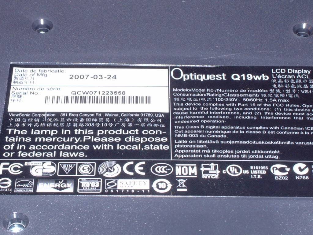

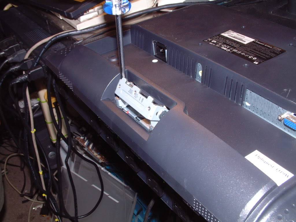

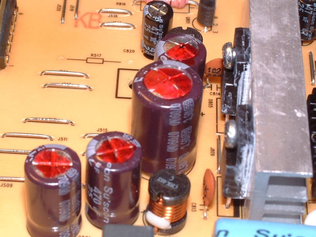

    2 seconds to black, saw the older threads, but how do I get the back off this thing? There is a padlock graphic on the back with a "K" beside a slot. Pushed in with a screwdriver but nothing popped open, no sign of screws either.
    I'd like to have a look inside before I scrap this as it was working well. The other day gave a scrambled image on boot up, restarted fine. Then yesterday 2 seconds to black.
    Re: Optiquest Q19WB Monitor

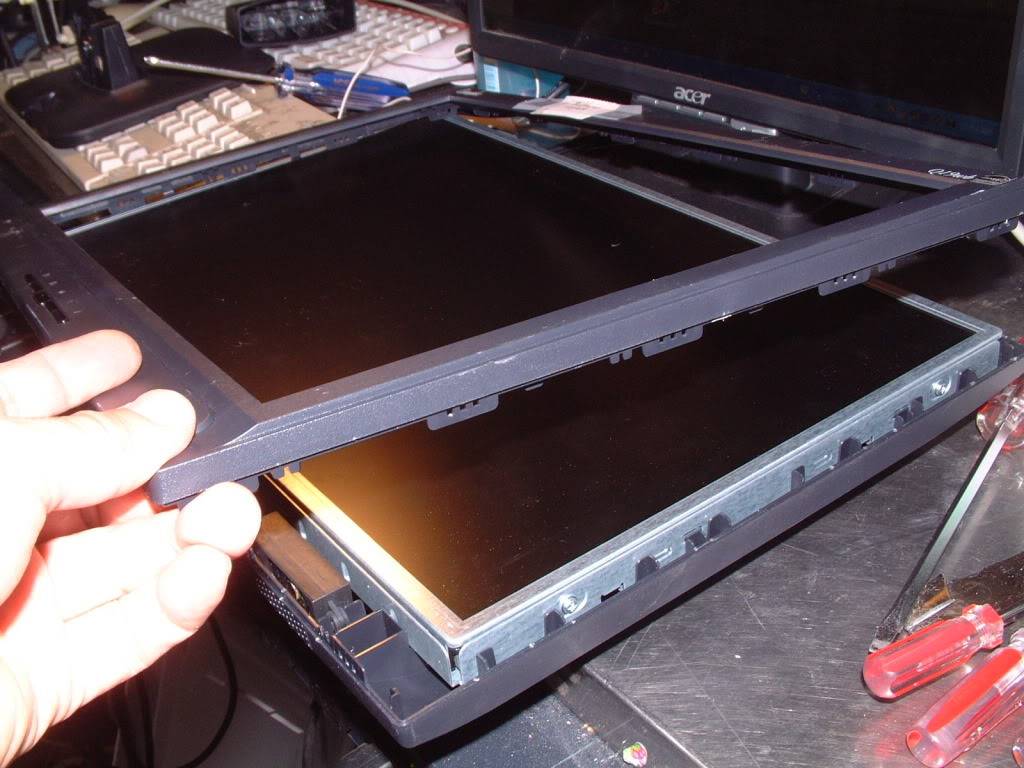

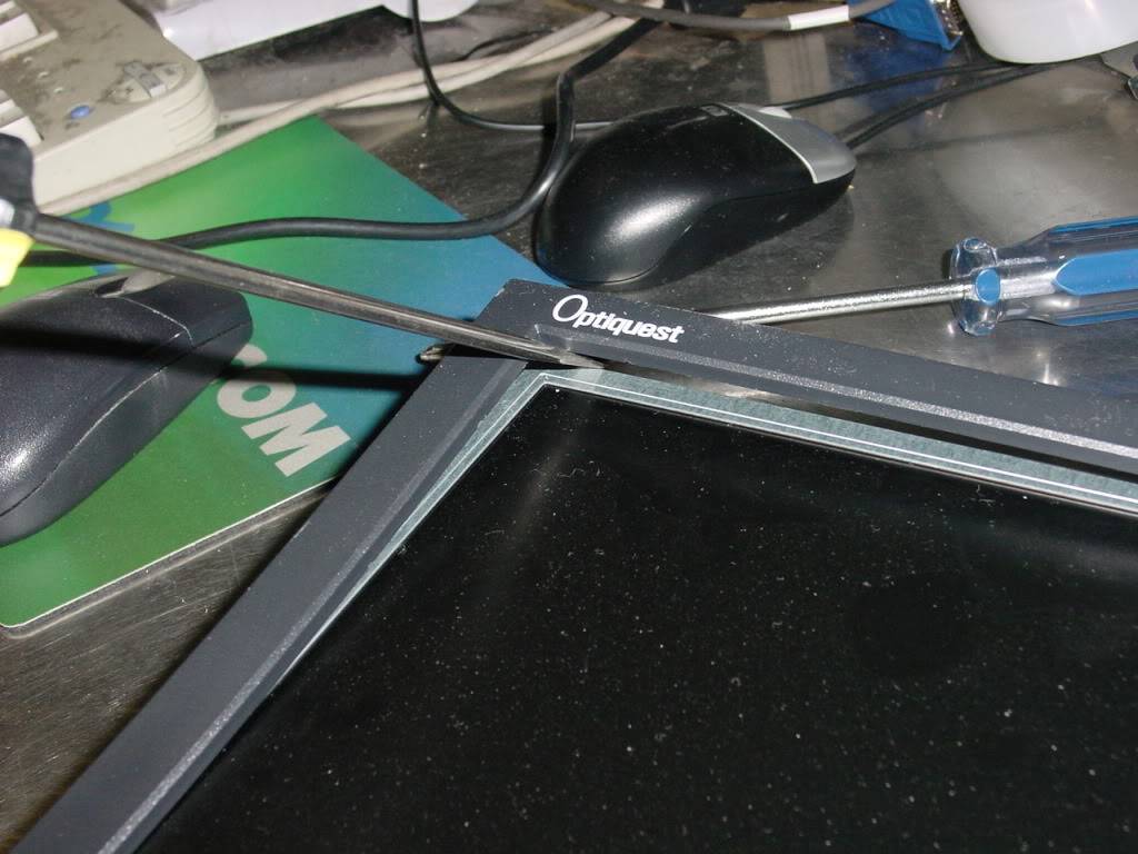

    It comes apart from the front, use this piece of plastic to pry up the bezel (where I point with the screw driver) and then work your way around.
      That padlock with the K is a kensington security slot, used to attach a security cable.
