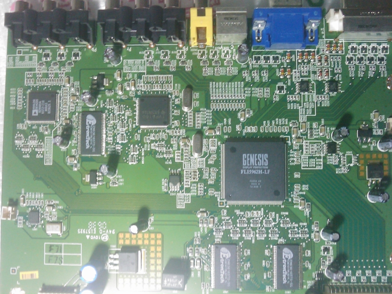

    Hi! First thanks to all of you who post and actively participate on the forum. It has been of a lot of help for me.
    I want to know if someone owns or has fixed one of this monitors.
    The problem is no power. No LEDs go on. I replaced the caps on the power supply, I replaced a bad voltage regulator on the motherboard and doesn't come on.
    Any hints on what could be the problem?
    Thanks a lot in advance.

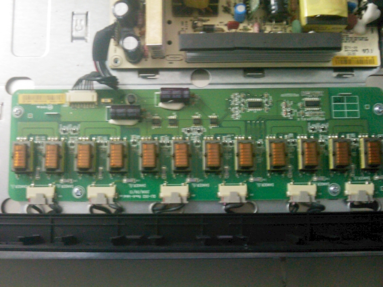

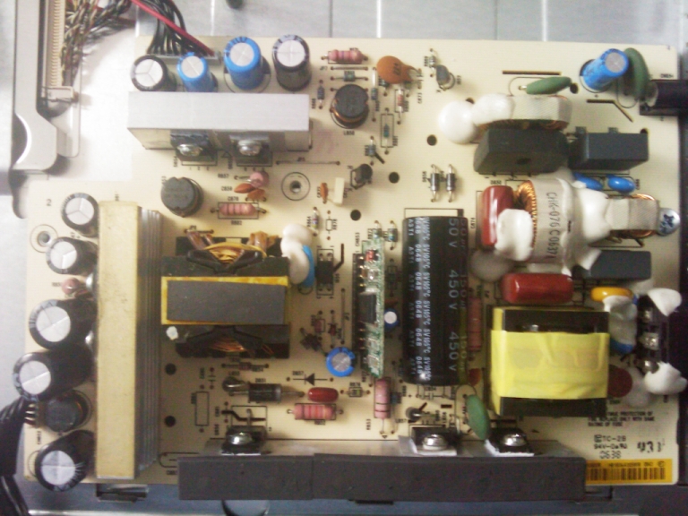

        Re: Gateway FPD2485W
        Hi!
        Thanks for the input.
        I checked all of that. Bad cord, blown fuse.
        The power supply gives the motherboard 5v. and the inverter gets 27v.
        Even the cable cord that goes to the ON/OFF switch of the monitor from the motherboard gets 3.3v. I just can't find the bad part.
        I include some pictures, and hope you can have some suggestions.
        Thanks to all in advance!
            There are a few things to check on these. First of all, there are a number of voltage regulators on the logic card - 3.3V, 2.5V, 1.25V are typical. If any of these are bad, the processor won't work.
            In at least one case, the problem was the crystal. It wouldn't oscillate, the result was no processor activity.
            There must be some way to hold the processor in reset until the power supplies are stable. Sometimes it is nothing but a cap and a resistor. Other times it is a three pin IC. Each of these can fail. Again, the result is no processor activity.
            PlainBill
              So I have the "no power", "no lights" problem but it looks like the fuse blew on my board so I'm looking into that. The capacitors on my board all look good but I ordered new ones just in case.
              The fuse that blew on my board was F850 which is right next to the power connector.
                  I just got a generic 5A 125V fuse I had lying in a bin however it blew the second I plugged the thing in which tells me there is probably something else wrong with this board. I doubt it's actually the capacitors as they all look fine...
                  Digikey has fuses similar to the one that was on the board.
                    The 'Usual Suspects' are the bridge rectifier and the main switching transistor in the SMPS.
                        A generic 5A 125V fuse is most likely a fast blow fuse. I believe a SloBlow fuse is needed on this monitor. Something always causes a fuse to blow, but it could have been a fluke. Try a slow blow fuse.
