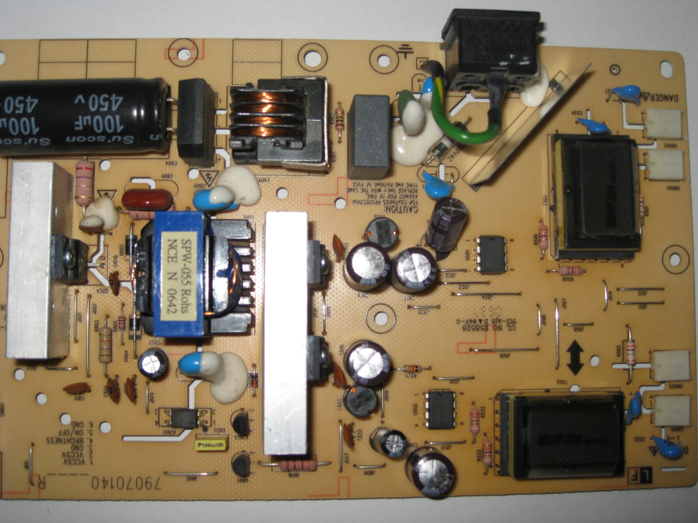

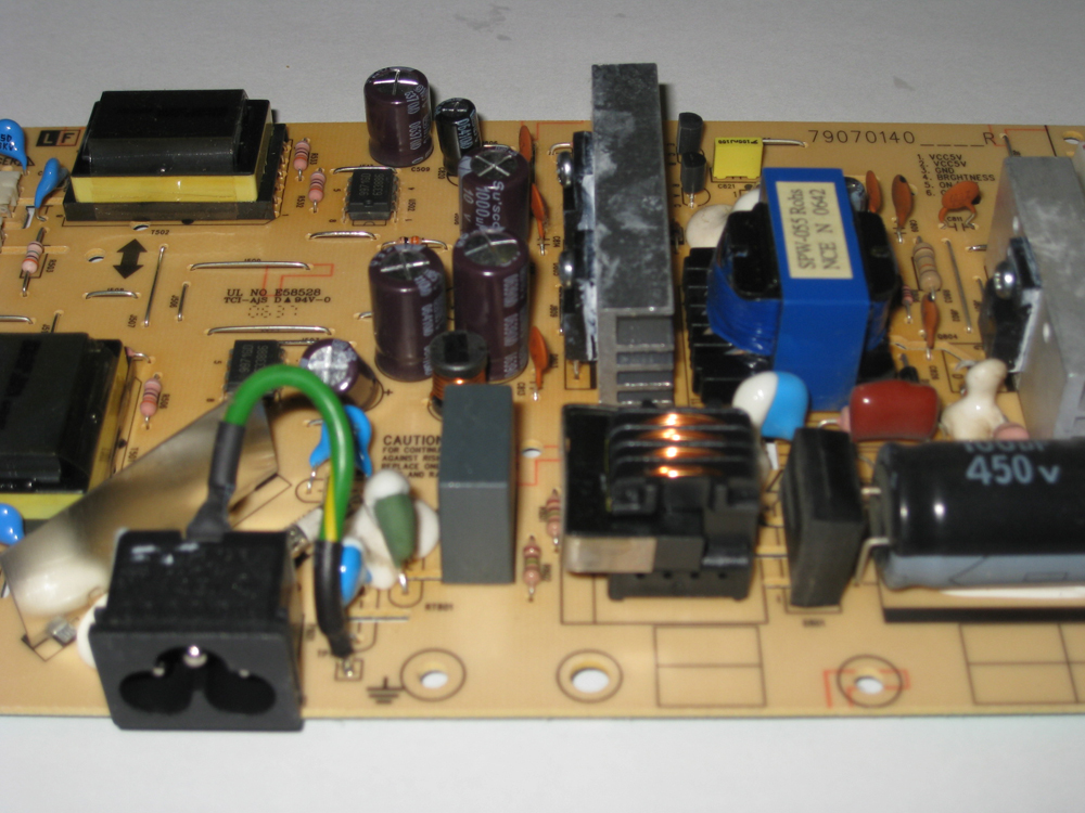

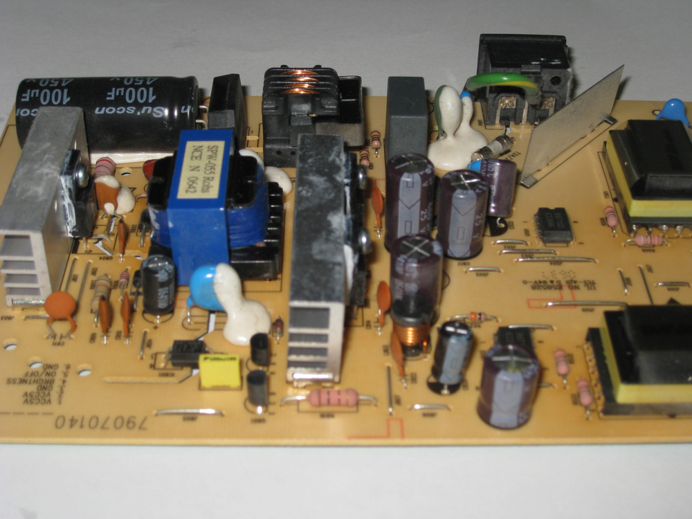

          Hello I also have a gateway fpd1975w had it for many years but now I'm getting the blinking blue light. I've notice some of the pics are different then mine. It looks like I only need to replace 7 of them but I don't know the diam. of them, I'm not good with mm. Are those 7 all I need? The caps on the other board next to this one looks alright.
          The caps on the board are Su'scon
          2x 47uf 25v 0641(M)
          1x 150uf 35v 0641(M)
          1x 220uf 35v 0637(M)
          1x 470uf 25v 0641(M)
          1x 680uf 25v 0639(M)
          1x 1000uf 10v 0641(M)

            I can only see 7 caps excluding the BIG one which is probably ok unless you can see any bulging or leakage. Replace all 7 with Panasonic FC FM or FR Diameter doesnt look a big problem on this board but you should get them the same height. You will have to measure them - wont matter to a mm. See digikey site to help you choose. It is unlikely that a local electronics shop will stock suitable caps. There is no guarantee that this will mend your set but its a good first step. Some of the caps on the other board may need replacing even though they look ok.
