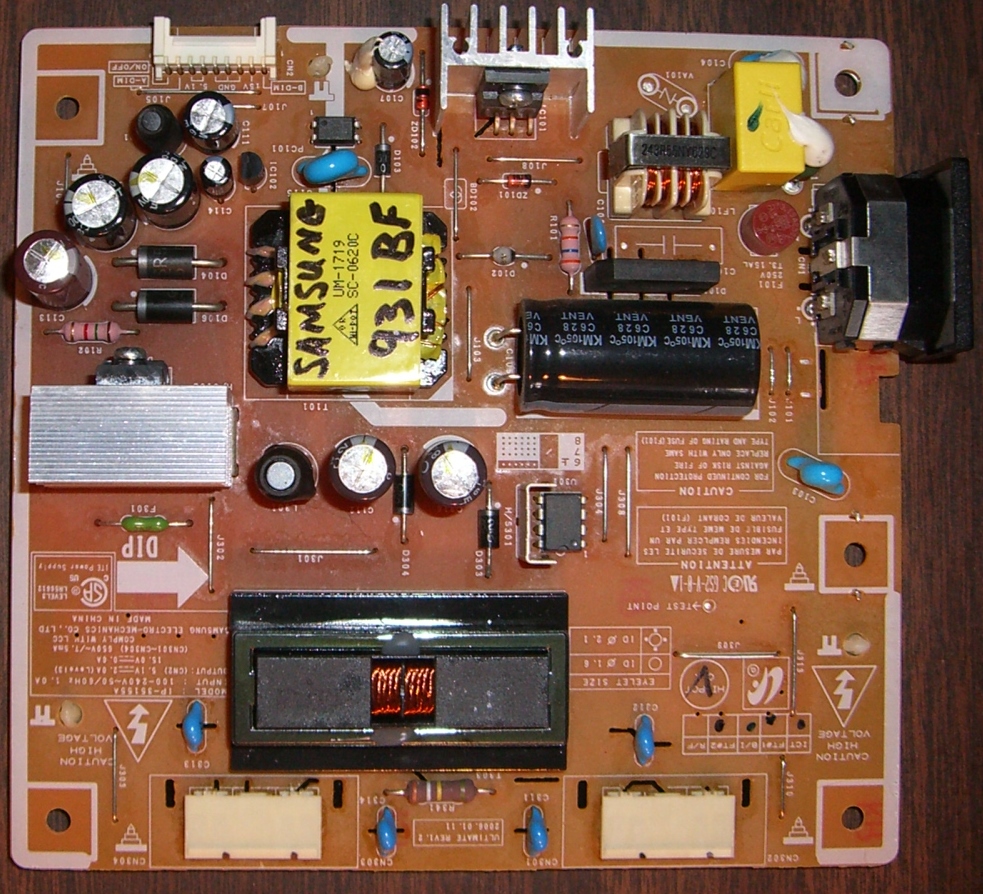

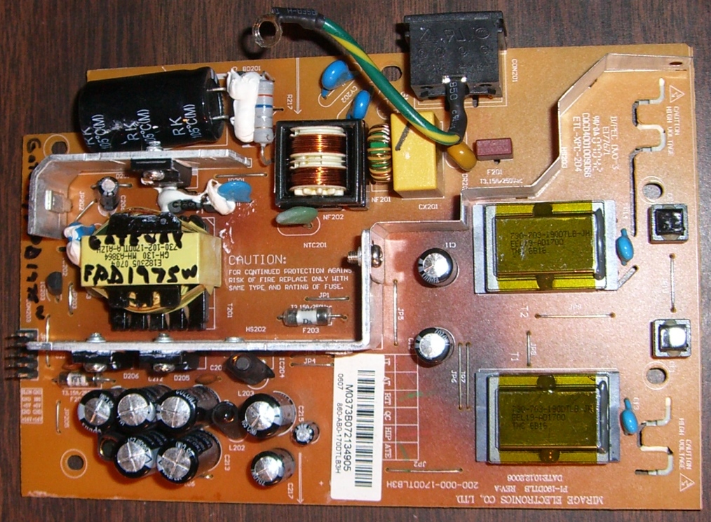

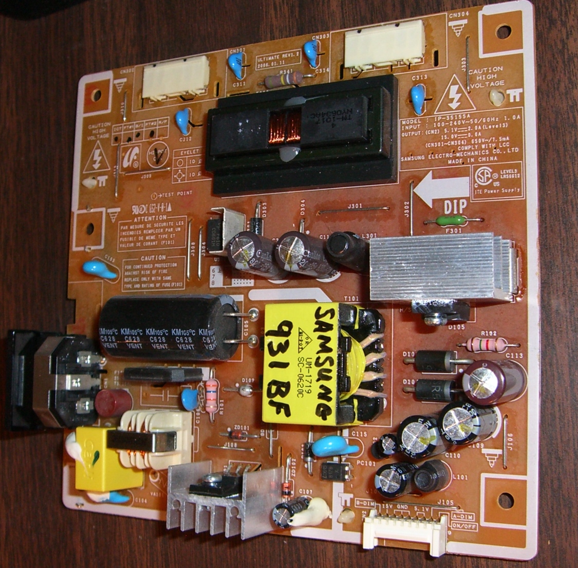

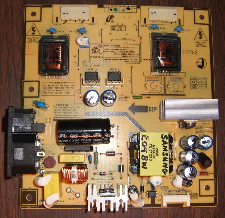

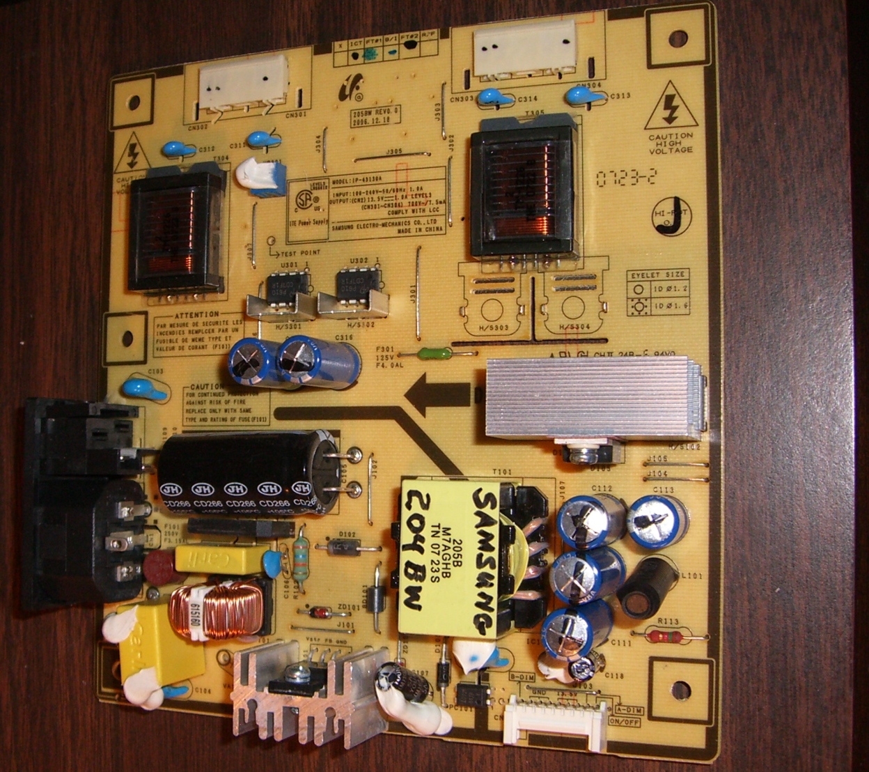

                              Great pics and good birds eye view so we can see the spacing. This will help in the discussion.
                              Samsung 204BW
                              The Samsung 204BW will indeed by a tight. The larger diameter 12.50mm cap will not make it easy to fit the 4 side by side in the lower right hand corner easy (C112, C111, C110, C113).
                              The one 820uf caps in the middle (C316) of the board can be 12.5 mm since it appears you have enough room.
                              So you have 2 options. Either is fine with me, but others may strong opinions?
                              1) Purchase the caps you found on ebay. I haven't seen these caps mentioned before, but I'm confident they will work. They may not be "optimal" in terms for ESR/ripple/etc, but many people use Radio Shack caps (as shown on youtube) and it seems to work fine.
                              2) Go up in capacitance to 1000uF to get the right 10mm diameter and stick with a preferred name like Panasonic, Rubycon, United Chemicon, etc.
                              Samsung 931BF
                              It looks like the two 820uf caps are right in the middle of the pic located side by side with diode D304 in between them. With the bigger diameter, these caps may have to sit "off" board slightly so they don't touch diode D304. I have a NEC monitor where one cap is actually straddling an IC (by design). I'll be posting that later to come in another thread.
                              You can slightly bend the cap leads away from the diode D304 and it will be alright. The important part is the underside to make sure the solder makes a good connection with solder pad and cap lead.
                              Notice the cap C107 in the 204BW picture (the one covered in white glue). It is not sitting flush to the board either. So caps don't necessary have to be straight up and down.
                              Gateway 1975w
                              Since there is no 820uF part for the Gateway, you should be good to go. It looks like cap C206 is sitting off board as well.
                              BTW, if you are eager to repair and don't mind paying for shipping again (I don't know how much digikey will charge for 2 orders versus 1 order), I would get all the caps for the Gateway now and then decide on the 820uF a bit later for the two Samsungs.
                              By fixing the Gateway first, you will get confidence and the other ones will seem a bit easier.

                                  The clearance appears to be 26mm. Depending on how well I can seat them against the board they might just barely fit. They probably would just fit but there is the possibility that the top of the caps would be in low pressure contact with the metal housing. Is that a problem?
                                    Samsung 204BW
                                    Samsung 931BF
                                    Gateway 1975w
