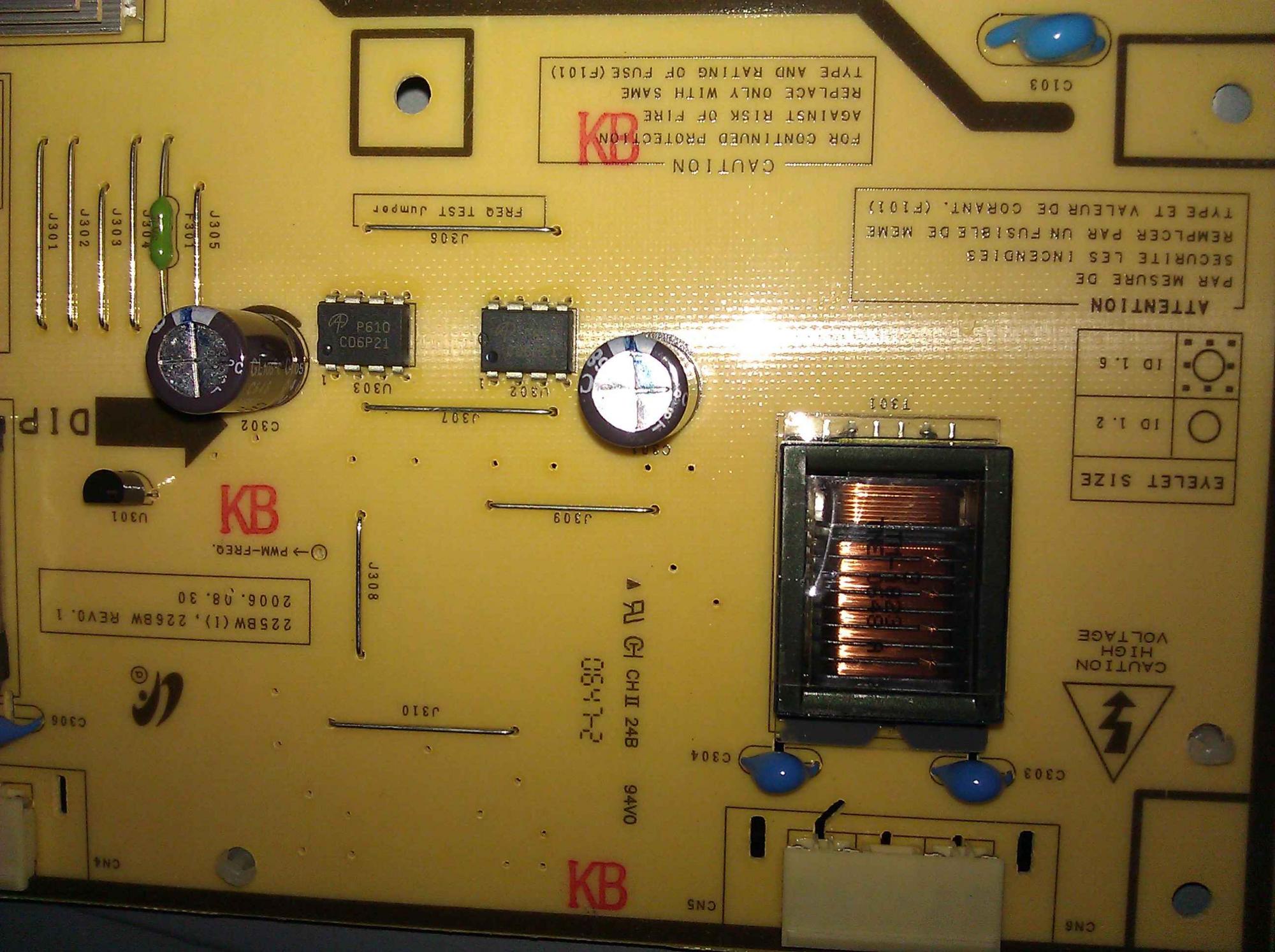

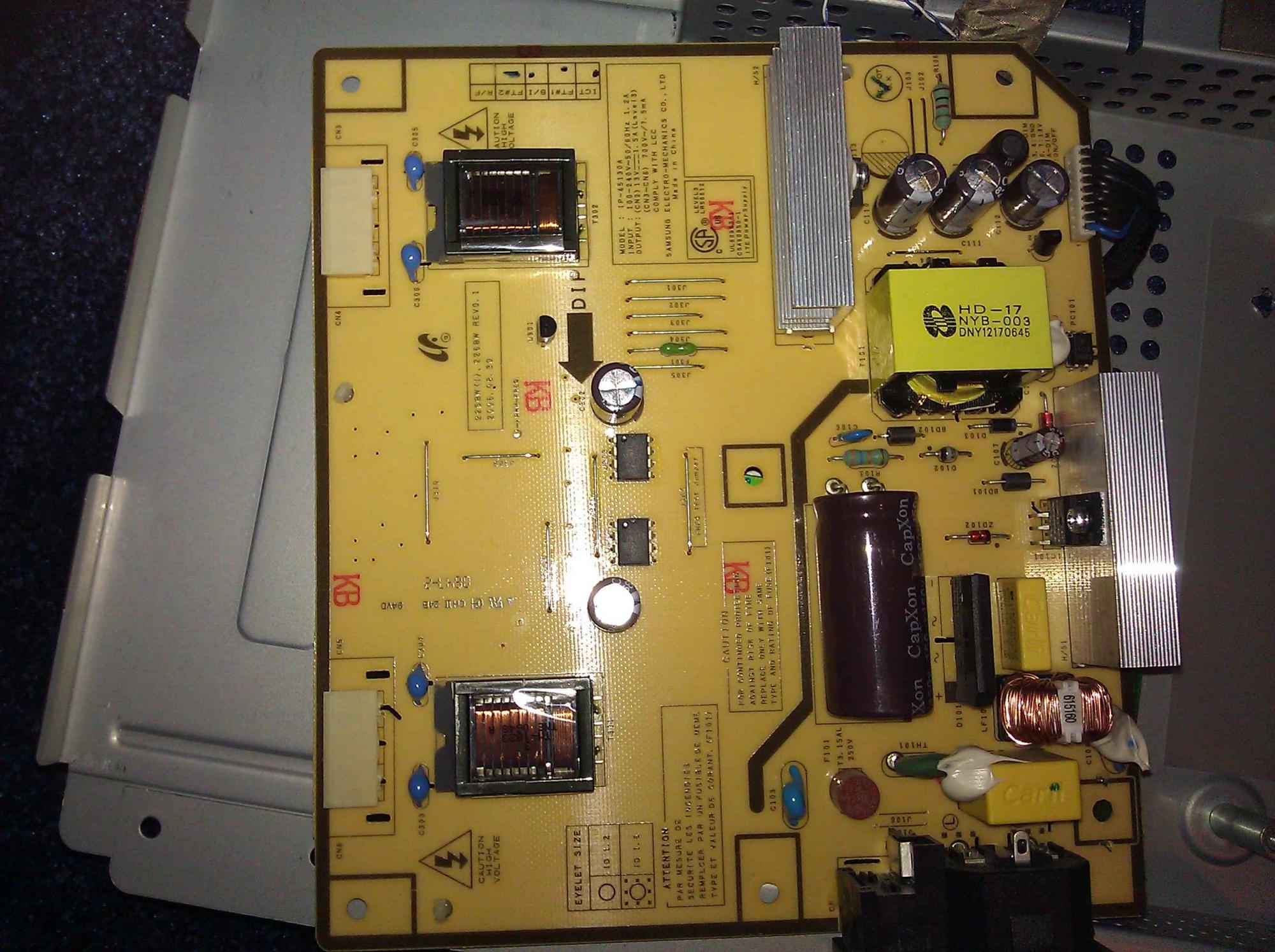

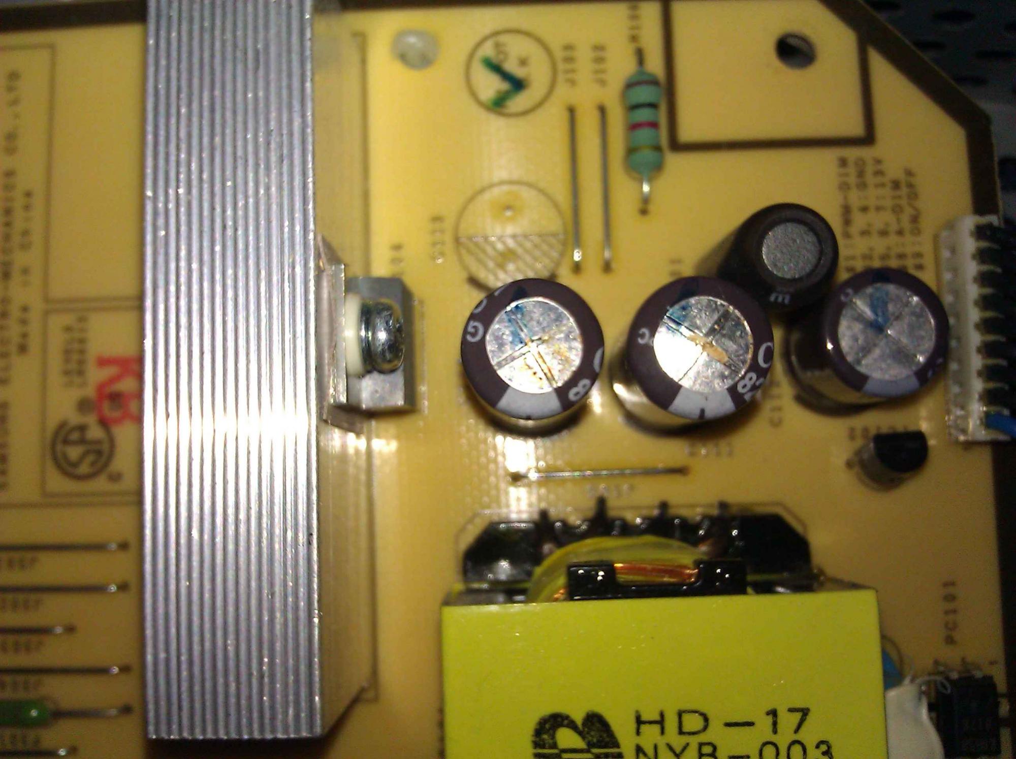

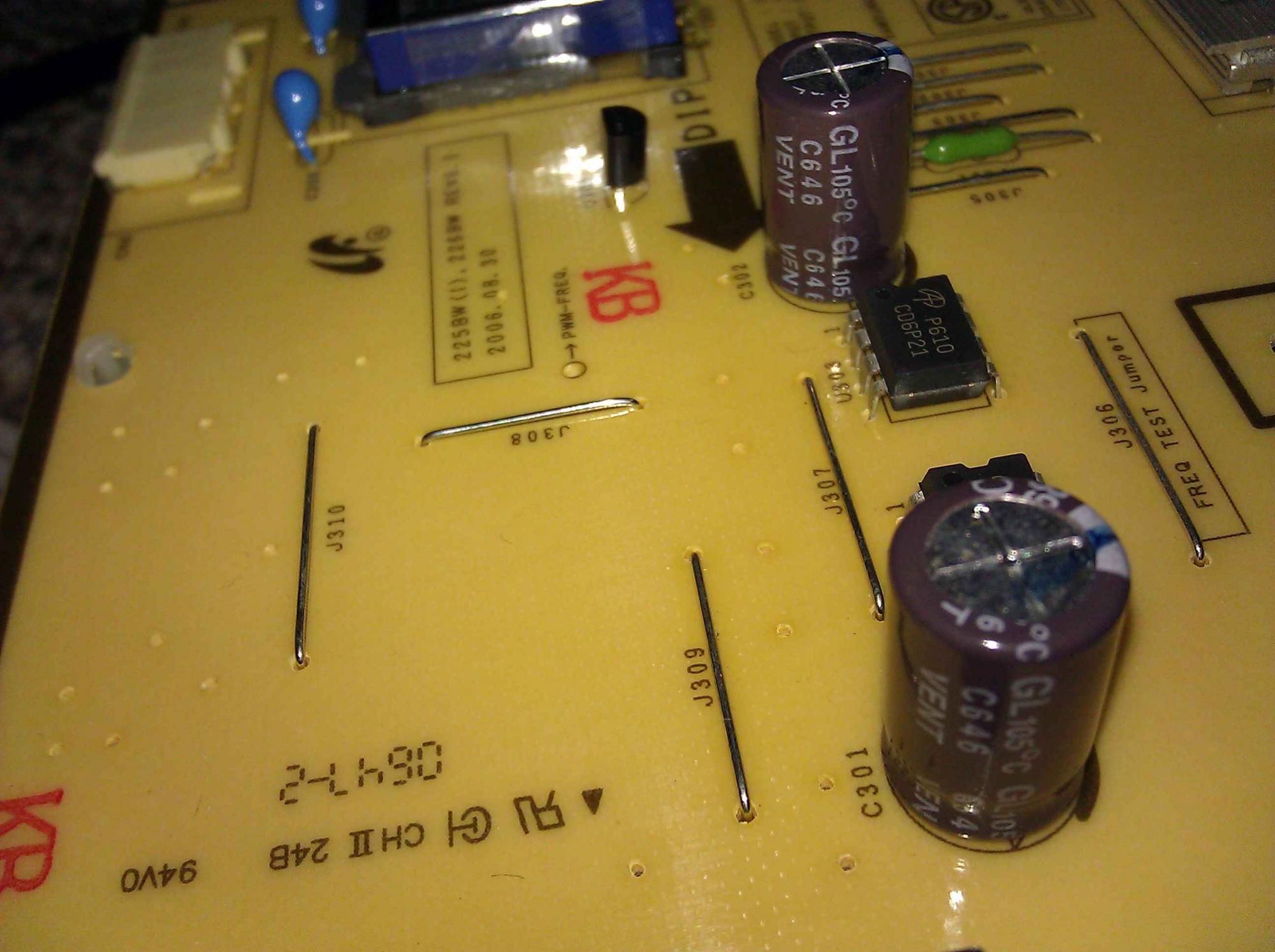

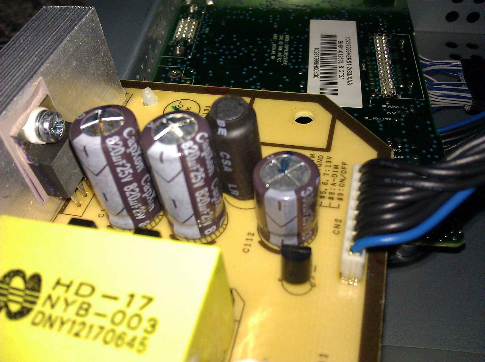

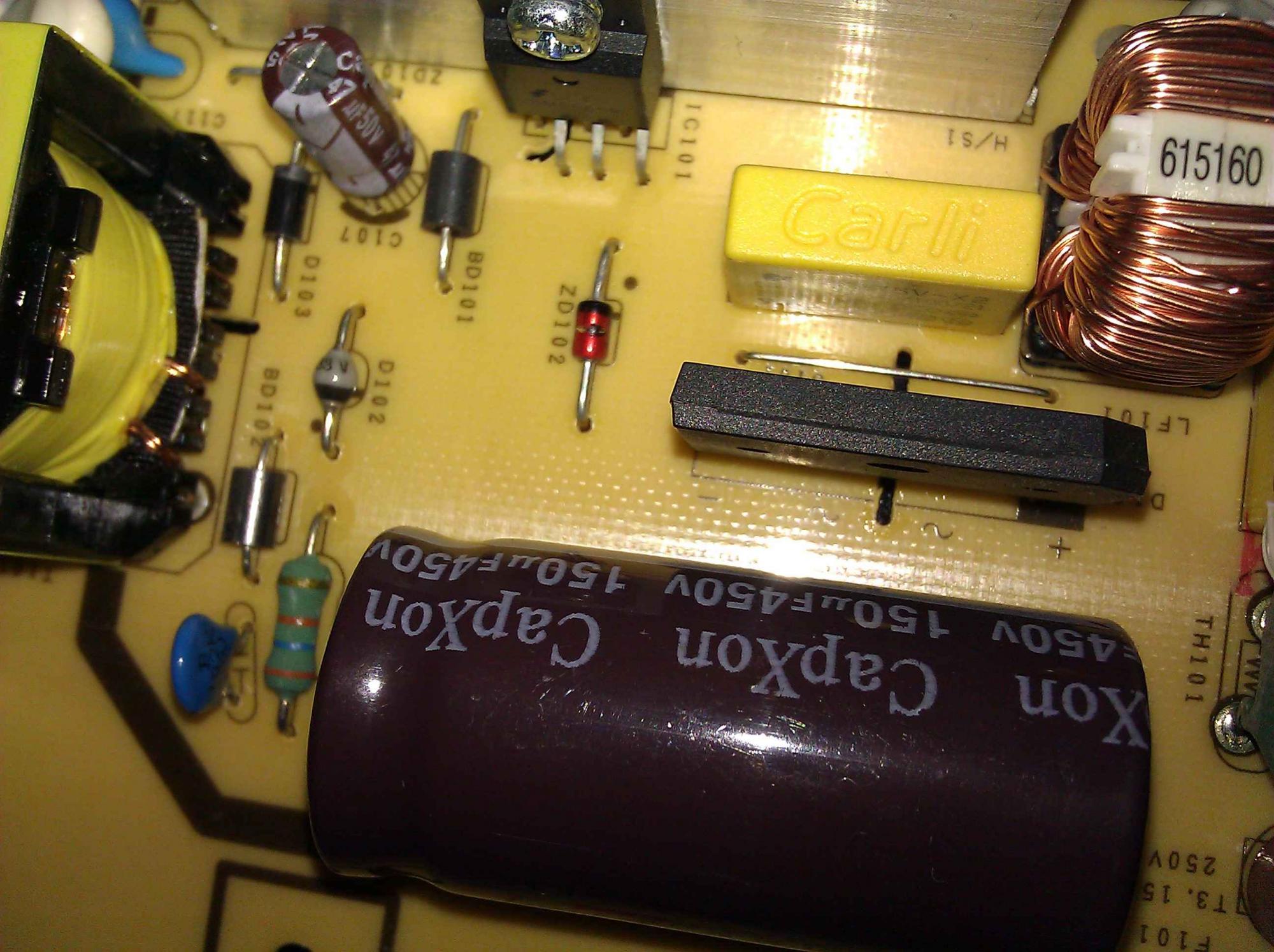

                    Re: Samsung Syncmaster 225BW
                    I'm having similar symptoms to everyone else. The screen goes on for a few seconds and it goes blank with a steady power light. Upon close inspection there's a faint image. I have 0 soldering experience so I hope I can fix the lcd as a friend left it behind telling me that if I fix it I can have it
                    • jetadm123
                      • 2169
                      #350
                      Looks like you have a couple of caps that are leaking. Caps that are made by Capxon should be replaced on sight! With the exception of the large 450V cap, replace the other 6 caps with something like Panasonic FR, FM or FC from digikey.com. Should run you under $10. Also, check the green fuse, F301, located just below the word "DIP" with the arrow to the left of it. Also, I suggest you watch some YouTube videos on "how to solder". Videos are much better than trying to describe in words.

                        #351
                        Best soldering video
                        http://www.youtube.com/watch?v=I_NU2ruzyc4
                        Like jetadm123 says, replace all the Capxon (except the largest one) with Panasonic FR, FM, or FC (in that order of preference). See PlainBill's instructions on how to order

                          #352
                          Wow that was fast! Is this it?
                          • jetadm123
                            • 2169
                            #353
                            Yes. With power off and your meter set to resistance, place your probes across F301. You should read 1 ohm or less. This fuse supplies power to the backlight circuit.
                            • itsallbs
                              • Jan 2011
                              • 5
                              #354
                              Unfortunately I don't have a meter but I will definitely try to replace the caps. What do I replace C301 and C302 with? I noticed the capxon's have the specs on the actual unit but not so much with c301 and c302?
                              • jetadm123
                                • 2169
                                #355
                                If you mean that the cap values are not stamped on C301 and C302, then assuming the member on post #341 of this thread has the same power board, try figuring it out through the process of elimination by comparing his cap values to yours.
                                      Ok I compared my caps to post #341 and this is what my order looks like. Can somebody review it before I order? I somewhat confirmed I have 2 680's upon close inspection.
                                      1 P10321-ND CAP 47UF 50V ELECT FC RADIAL PANASONIC FC 47UF 50V 0 0.34000 $0.34
                                      2 P11222-ND CAP 820UF 25V ELECT FC RADIAL PANASONIC FC 820UF 25V 0 0.90000 $1.80
                                      2 P12390-ND CAP 680UF 25V ELECT FM RADIAL PANASONIC FM 680UF 25V 0 0.67000 $1.34
                                      1 P12387-ND CAP 330UF 25V ELECT FM RADIAL PANASONIC FM 330UF 25V 0 0.50000 $0.50
                                      Thanks in advance!
                                      Last edited by itsallbs; 04-04-2011, 09:36 AM. Reason: edited to remove confusing quantities
                                      • FredEKing
                                        • 3
                                        #359
                                        Caps are inexpensive. If you can afford it order twice as many as you need just in case. I picked up some extra Lithium batteries for motherboards too for my older computers.
                                        • retiredcaps
                                          • Apr 2010
                                          • 9271
                                          #360
                                          I would suggest using FR instead of FM.
                                          http://search.digikey.com/scripts/Dk...name=P14421-ND
                                          http://search.digikey.com/scripts/Dk...name=P14415-ND
                                          FR has slightly improved specs in some areas compared to FM.
