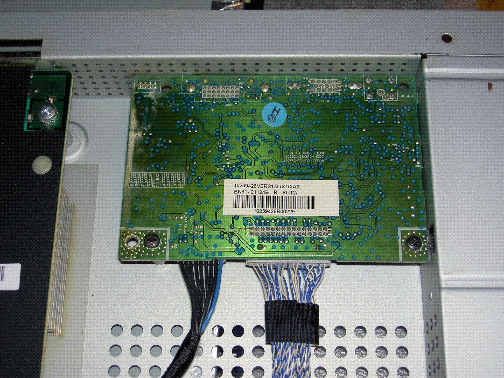

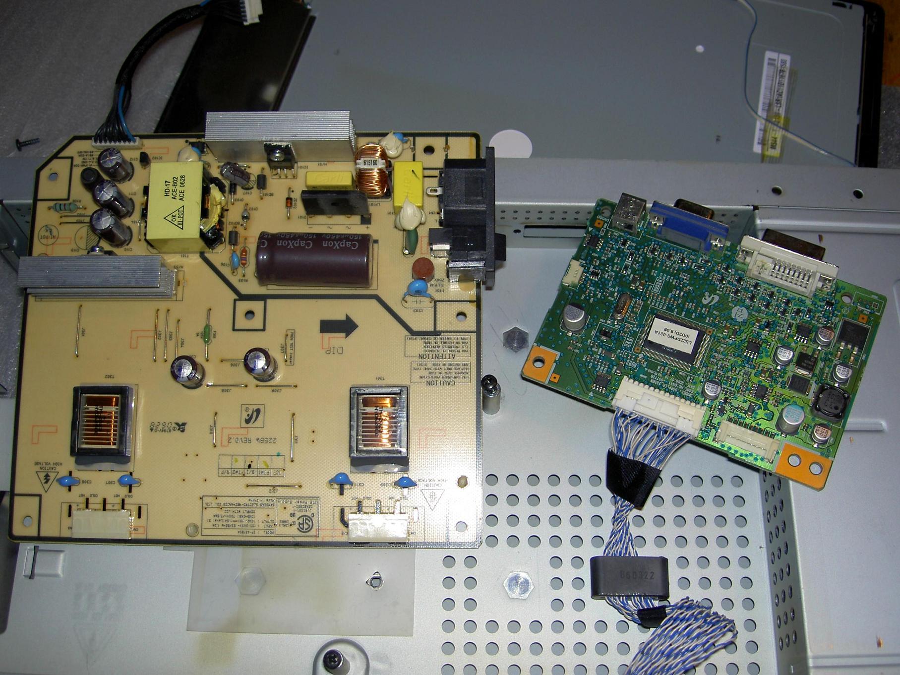

          #164
          Re: Samsung Syncmaster 225BW
          I took my 225BW apart and have a couple of pics for you guys to check out and let me know what you all think I should do! It appears that one of the circuit boards has what looks to be some slight corrosion and the larger board appears to have some traces of what looks to be excessive heat-not really sure. Any suggestions would be appreciated! Thanks again!
          • pedro
            • 199
            • AUSTRALIA
            #165
            Yikes, five perfectly bloated electros! Replace them an also the leetle one (C107?) near the switcher transformer.
            That heat seems to be under the large ? 3.3V reg chip. There *may* be a fault in this area, but more likely it is a symptom of the power supply issues (the caps). Walk before you run, replace the caps with some decent low-ESR 105C types and see what happens next.
            Friends don't let friends buy Samsung ....

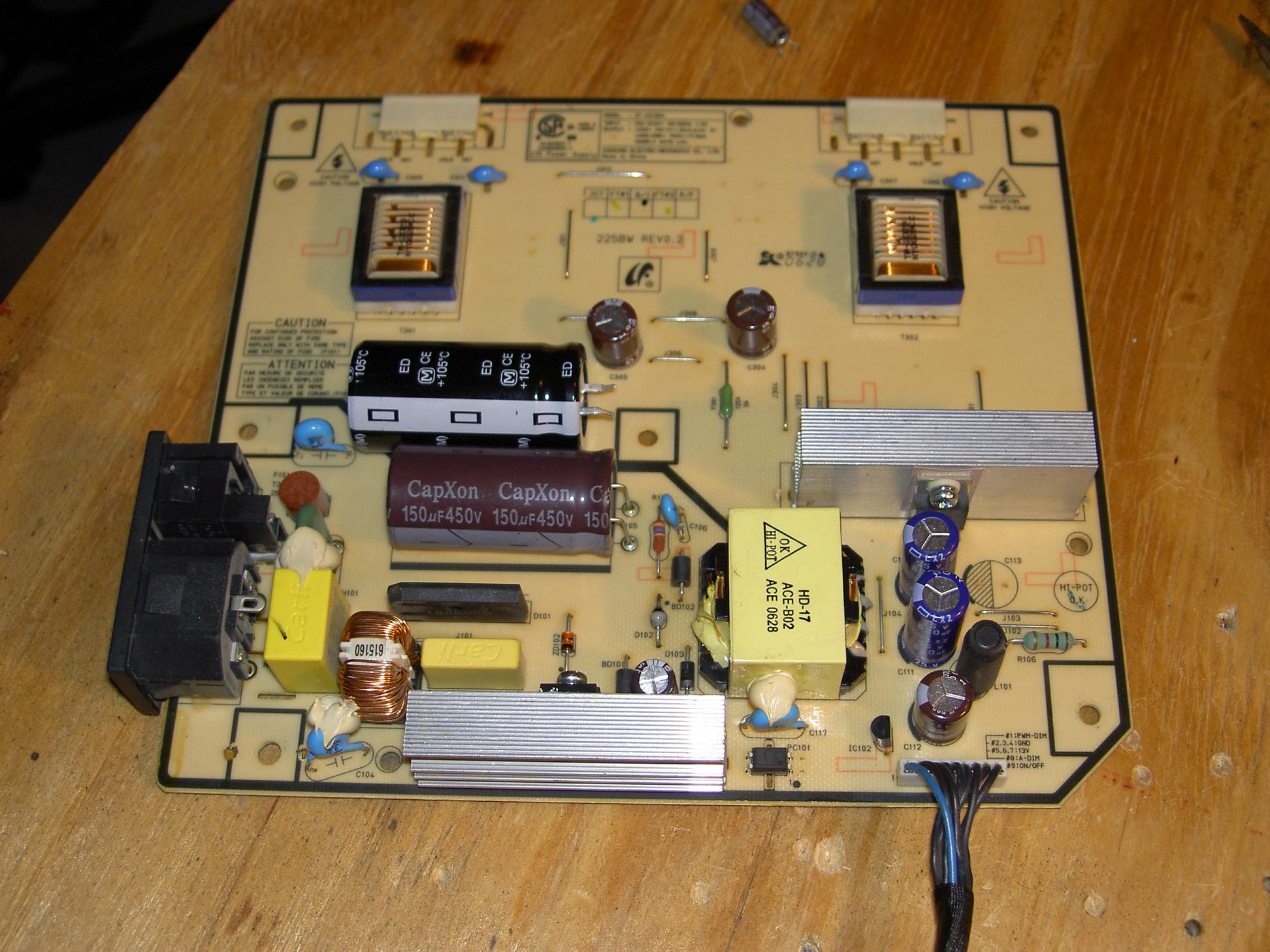

                                    Thanks Pedro! Here is a pic of the board with the new caps except for the 150uF/450v- As you will notice in the pic, I have placed the new cap(150uF/450v) next to the original cap that is still in place on the board. I am almost positive that I soldered the new caps in correctly, as the neg sides matched the same way the old ones came out. I also took a measurement on the new 150uF/450v cap, and got a reading of around 115uF- Is this ok if I decide to use it in place of the old cap?
                                    Thanks,
                                    Emile
                                    • Gammaray
                                      • May 2010
                                      • 120
                                      • U.S.A.
                                      #178
                                      Just to let everyone know that I took a measurement on the original caps (CapXion) after desoldering them off the board- and here is what my meter read- For the 820uF/25v caps- 47uF on one and 42uF on the other- for the 330uF/25v caps- all 3 were averaged around 22uF As for the 47uF/50v- it was around 41uF indicating that it was still ok!
                                      Emile
                                      • pedro
                                        • 199
                                        • AUSTRALIA
                                        #179
                                        Thanks,
                                        Emile
                                        Yes that should be fine, but again I wouldn't bother installing it. Of the caps you have installed, all the ones where the polarity marking on the board is visible appear to be in the correct way. Power it up and report back.
                                        Also note that *many* meters don't accurately show capacitance for caps above 10 or 20uF.
                                        • Gammaray
                                          • May 2010
                                          • 120
                                          • U.S.A.
                                          #180
                                          OK- I finished up and fired it up! Everything seems to be working fine! There is no delay in the picture coming on. By the way- I did put the new 150uF/450v cap in just because I had ordered it!
                                          Thanks again Pedro and the rest on here! Will report back if something does happen to go wrong! knock on wood!
                                          Emile
