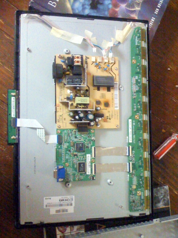

              Sorry to revive this thread, but I have the exact same problem. First off, I really had no interest in repairing electronics and the like but I have no choice since I don't have the $$$ to buy a new monitor
              Before finding this site, I came across information that all I needed to do was replace the bad caps, which I did... and boy was it a pain the a$$! It was my first time de-soldering and soldering that I probably did a poor job soldering (except for one cap lol)
              Tested my monitor, and voila, a faint dark image... at least I got an image! Then I realized I forgot to plug those 4 backlight cables back in, so I had to re-open the darn thing, but hoping that it will work this time. Of course, it didn't.. so google once more!
              And that is how I found this thread. So, please forgive me for asking these dumb questions...
              1. How can you tell if the fuse is "open," without using any gadgets/gizmos lol
              2. This Q is more for eGuevara > Do you have any pics that show how you bridged the fuse by soldering?
              Well that's it for now... If nothing works, I might just get a replacement board on eBay...

                You're going to have to have some interest to repair your monitor.
                You are also going to need some type of a volt/ohm meter.
                You will also need to post some photos of what you're working on. Please use the managed attachments option, and very detailed so we can read the markings on the board.
                What type of capacitors did you use, what make and series?
                Please Do not try to bypass any fuses they are there for a reason.
                Whatever I do, I consider it a success, if in the end I am breathing, seeing, feeling and hearing!

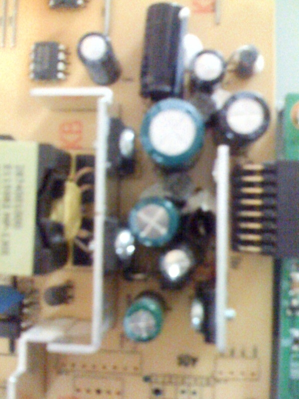

                      Thanks everyone. Attached are the pics I originally took before replacing the bad caps. Sorry for the poor quality but its from my friends phone
                      The new caps I replaced are from radio shack, its a XICON brand 220 uF, 35V, got all 3 replaced. I just ordered the mofset off eBay, and Im tryin to take the old ones as we speak.. (any tips takin em off, its taking me so long... im using a 30watt iron, desoldering braid)
                      Fuse is F102 which Ive located on my board and I did try to bridge it just to test it out, but that didnt work lol. I will buy the fuse off mouser, the 4 amp one
                      Thats about it for now, but IM not really optimistic.. but we'll keep you guys updated

                        1.- Caps are not the recommended replacements.
                        2.- Without changing the MOSFETS you will never get an image,even if the fuse is bridged (the fuse blew because the MOSFETs shorted...)
                        3.- MOSFET Removal tip? Patience, my friend....

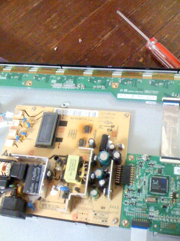

                          Thanks eGuevarae! Yah, I dont know anything about mosfets, fuses and how they work lol but I do get an image but its just very faint /dark. I replaced the caps that were bulging, but I still have those big Capxon caps, but they werent bulging
                          And yes I need patience lol but I finally removed one fet... I kinna pulled it out at the end tho, but I think it's okay.. I hope.. On to the next one xD

                              This is one of the common screw-ups. Xicon does not make a low ESR cap suitable for use in the switching mode power supply (SMPS) used in monitors. You can buy the right caps for less money from Digikey or Mouser. If you are going to keep the monitor, expect to be replacing the caps within a year. If you sell it, expect to have a very unhappy customer in the same time frame.

                                Although I did research which brands are the "good caps," my impatience got in the way and I just wanted to buy any replacement caps from the nearest retail store ^^; I initially thought that the bad caps were the only problem. I badly wanted it to work and wasnt really thinking long term. If anything, this will be more of an experimental project lol
                                Right now tho I'm using a measly 15in CRT monitor...
                                GOt both FETs removed now (yayy!) So I guess all I have to do now is wait for my mosfet to arrive.. I havent ordered the fuse yet, just wanted to see if everyting will work with the temp bridged fuse first. And if it does work, I'll repalce the all the caps with better ones and get that fuse

                                    I got them I'm have a hard time soldering.. urghhh... Question, if the soldering wasn't as volcano-perfect, would it still cause to fail ?

                                        Just tried it out despite my poor soldering job, and there's now a flicker whenever I turn the power on/off. Still getting very faint/dark images tho. At this point, I'm not sure if I can do any more resoldering/soldering... Ive been at it for 6 hours ><, ah we'll see.. maybe I'll feel different tomorrow and try to do a better job.
                                        ps. I officially hate the soldering part now lol
