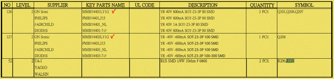

          Hello,although this post was started several years ago, it still keeps alive, so, after reading the whole tread, I think I can help a little.
          When trying to fix an ACER 2017, I used this dac-19m005 datasheet I found on the web.
          http://www.megaupload.com/?d=YJWEDABQ
          Here you can see schematics and components. Although it is a different LCD model, is has the same power board: DAC-19M005 CF REV: 00A, (plus it has just DUB conector, no DVI, but still the same board too), so: same problems and same fixes, I guest.
          After recapping all (same 2 bulged caps as every faulty board), I can see images on the screen but no backlight. You only can see it taking a light close to the screen ( I didn´t read anybody in this situation, everybody has no light but nobody has mentioned about dark images with no backlight)
          All the fuses on the backside are OK but I can see a damage transistor: Q204, on the backside, right close to the F200 4A fuse, so probably this is what I need to fix.
          According to Kahless (on post #299 and # 301) and billy 66 ( #320) I can see Q2004 burnt ( probably that´s because F200 fuse didn´t blew up), but I checked R210 and I got about 11 Ohm, so I think it´s Ok. Anyway, I ordered replacements for the whole components:Q204,Q208 and R210.
          I´ll post the results when I get it working here or in a new thread refering ACER 2017 (only DUB, no DVI conector)
