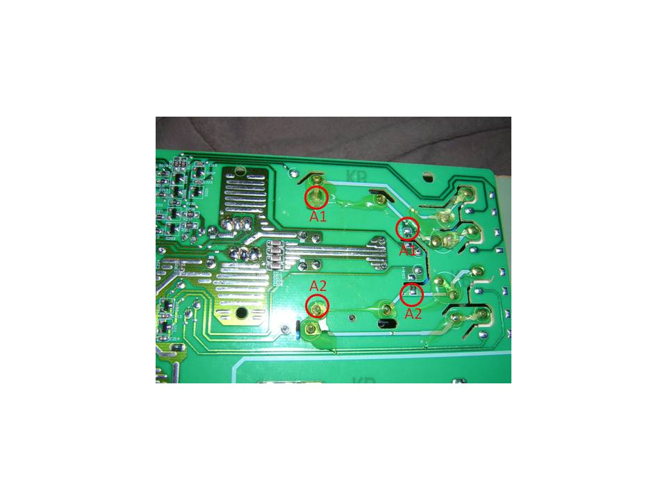

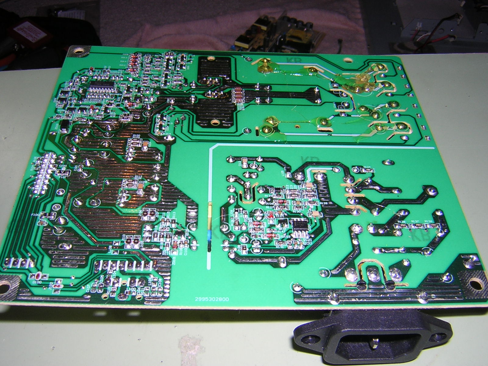

                  Ok I measured as requested:
                  I am enclosing two photos. One shows the overall board from a backside view. The other tries to show where i measured per your request.
                  The first measurement:
                  A1 to A1: Measured 0.749K-ohms
                  A2 to A2: Measured 0.750K-ohms
                  Does this tell me something?

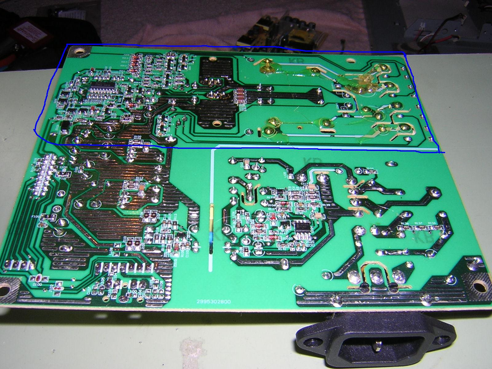

                    I'm not sure, does it? It tells me that the transformer secondary is not shorted. It doesn't tell me anything about the transformer primary. Unfortunately, it is unlikely that an ohmmeter will be able to detect shorted primary windings. That would take a transformer ringer.
                    Now I will need a good picture covering at least the area outlined in blue on the attached picture, and a picture covering the corresponding area on the top side of the board.
                    And does anyone know if a service manual or schematic has been found that covers this monitor?

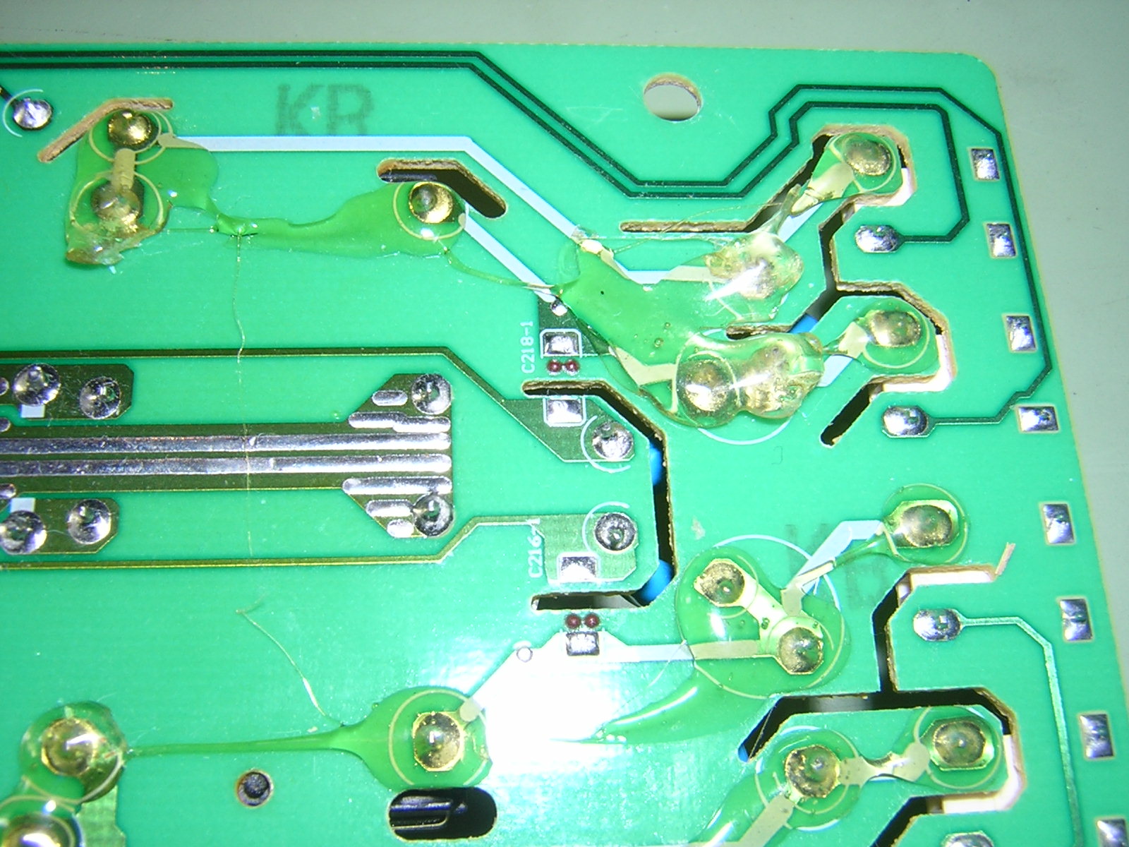

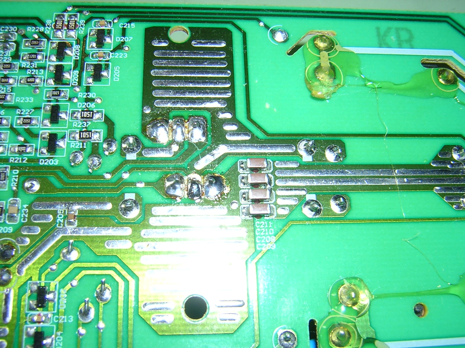

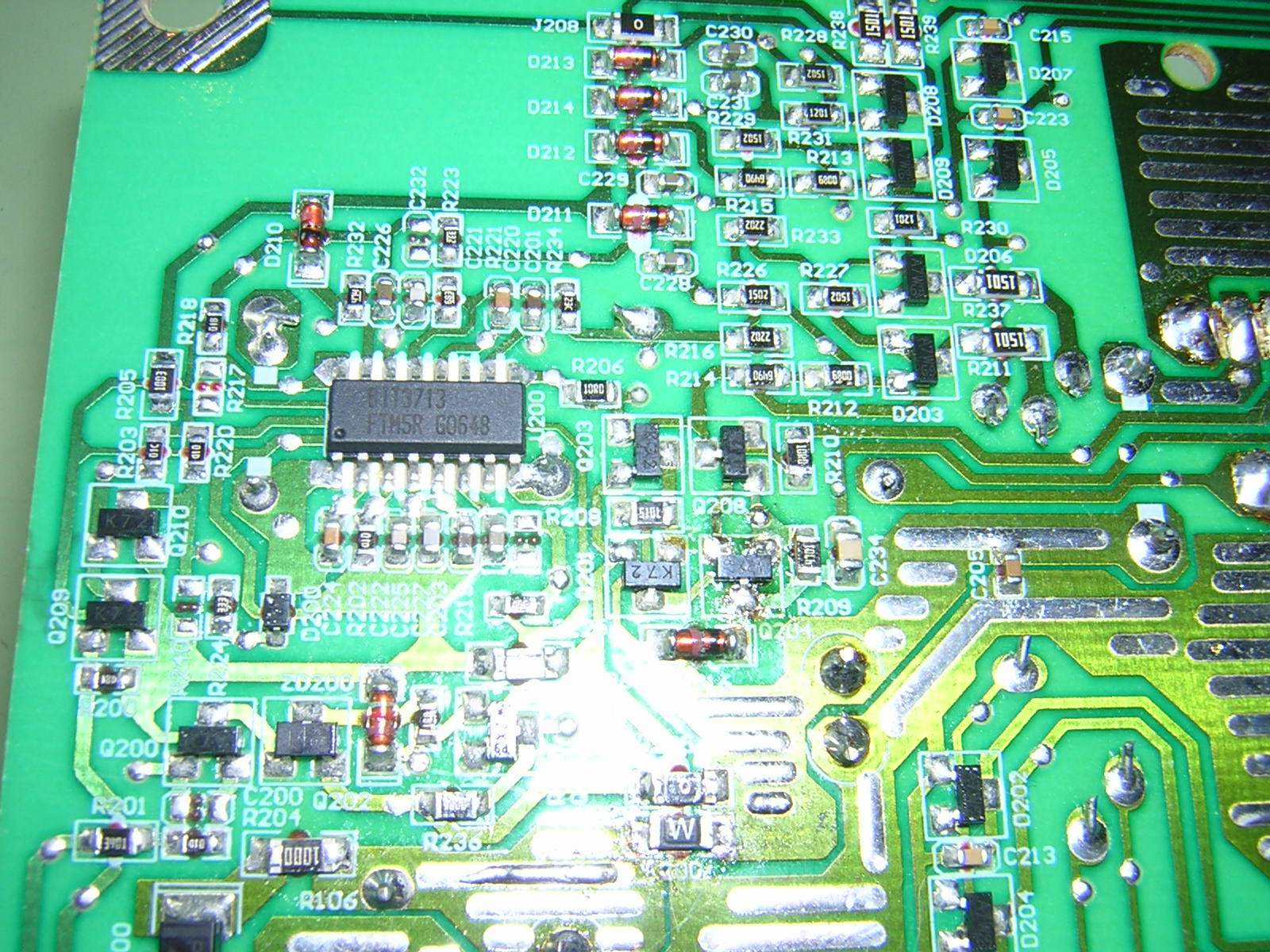

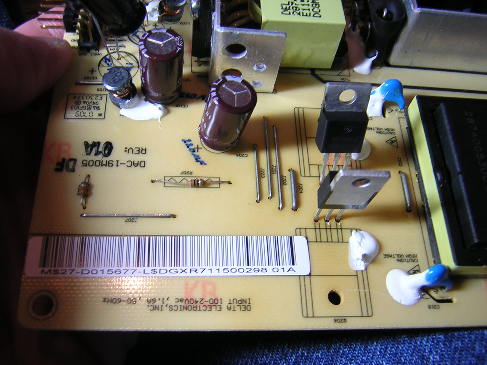

                      Enclosed are the pics you asked for. If you need better pics please just let me know. I can try and do better.
                      Also, you will notice in one of the top pics that the mosfet inverters are "standing straight up"........this is because i used the new devices and i did not "bend" them down since i wanted to be able to remove them again easily.
                      thanks for your help with this!

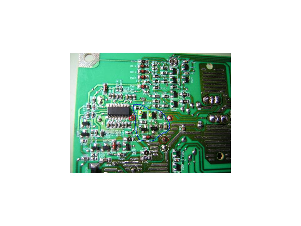

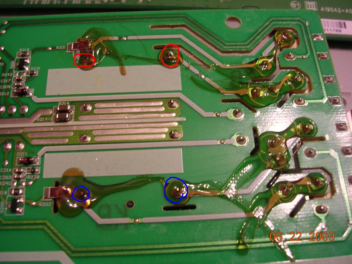

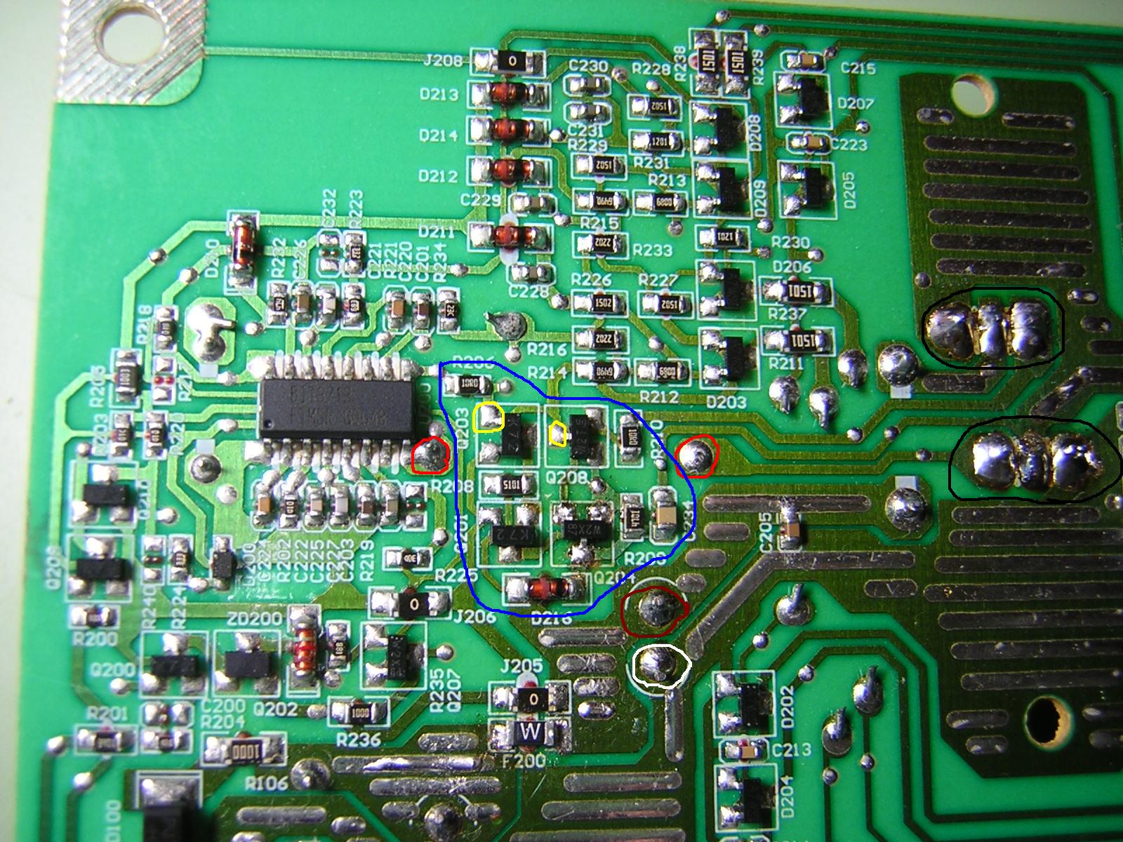

                        I've marked up one of the pictures and have some points for you to check.
                        Black circles: There is a lot of flux there. Make sure there are no hidden shorts.
                        Bright red circles: Are they connected by a jumper?
                        Large blue circle: Check the transistors and D212 for shorts. Has anybody bothered to identify what these are? (bipolar, mosfet, etc?)
                        Large blue circle: Are the points in the yellow circle connected together? Are they connected to either the dark red or white circle?
                        That's it for tonight. I'm taking the grandkids to look at Christmas lights.

                          #192
                          Re: Issue with Westinghouse 19" LCD Monitor (large pics)
                          1) Black circles: Lot of flux there.
                          I measured the resistance between each of the leads. Readings in the Meg-ohm range
                          2) Red circles: (see picture)
                          I have labeled each red circle with numbers 1,2 and 3,
                          Resistance readings:
                          1-2: 10ohms
                          2-3: 3Meg to 3.3Megohms depending on polarity of leads
                          1-3: 3Meg to 3.3Megohms depending on polarity of leads
                          3) Check transistors:
                          Note:
                          K72 is an N-channel fet. Equivalent digikey part number: 568-1369-1-ND
                          W2X is an NPN bipolar. Equivalent digikey part number: 568-1743-1-ND
                          W2T is an PNP-bipolar Equivalent digikey part number: 568-1744-1-ND
                          I have not checked all the transistors in this circle. I need to look up how to do this with a DMM. I will post again with results
                          Note: The W2x device originally was “bad” and I replaced it. The base and collector were shorted. How did I know this. From the circuit the base and collector are in parallel with a surface-mount resistor which has a value of ~ 4kohm. I new it was shorted when I measured between Base and collector and got a value much less than the 4kohm resistor value. Currently the W2x base collector resistance equals the surface mount resistor value.
                          I could not find the diode you asked for D212.
                          4) The yellow circles are not connected together and they are not connected to either the white or dark red.

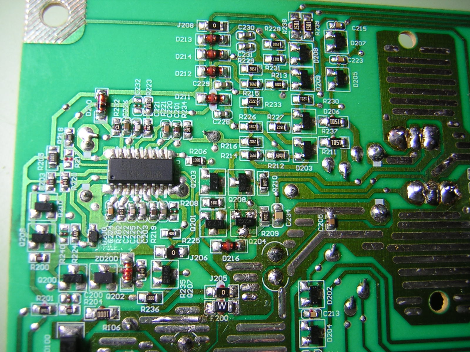

                                      #198

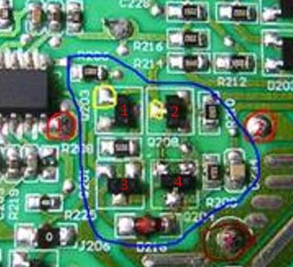

                                      I finally finished testing the transistors:
                                      Testing of transistors 1, 2, 3, and 4 (see enclosed picture):
                                      Note:
                                      Transistor 1: Is a K72 N-channel Mosfet. Equivalent digikey part number: 568-1369-1-ND
                                      Transistor 2: Is the W2T PNP Bipolar. Equivalent digikey part number: 568-1744-1-ND
                                      Transistor 3: Is a K72 N-channel Mosfet. Equivalent digikey part number: 568-1369-1-ND
                                      Transistor 4: Is the W2X NPN Bipolar. Equivalent digikey part number: 568-1743-1-ND
                                      Note: For transistor 1 and transistor 3 (K72 devices). From data sheet there is a diode from source to drain. This will also be measured.
                                      Note: I made the ohm measurements with both polarities....ie…swapped leads of DMM.
                                      Testing of transistor1: K72 device
                                      Ohm-Measurement Red/Black Black/Red
                                      Gate-to-drain: 9.3Meg-ohm 0.9Meg-Ohm*
                                      Gate-to-source: 3.1Meg-ohm 3.1Meg-Ohm
                                      Drain-to-source: -1.3Meg-ohm 1.9Meg-Ohm
                                      Source-to-drain-diode: 0.579Volts
                                      *: I had a very interesting result when I measured the Gate-to-drain resistance. If I measured the diode turn on voltage from source to drain and THEN measured the resistance from Gate-to-Drain, with black lead on gate and red lead on drain, the resistance measured was in the kilo-ohm range. If I wait ~ 4 to 5min and then measure the resistance I get the 0.9Meg-ohm value. But it's the “kilo-ohm” measurement that I get when ever I first measure the diode that concerns me…………what I don't know is it the device or something else in the circuit causing this. I DID NOT see this in the other K72 transistor.
                                      Testing of transistor3: K72 device
                                      Gate-to-drain: 1.5Meg-ohm 8.6Meg-Ohm
                                      Gate-to-source: -1.6Meg-ohm 2.4Meg-Ohm
                                      Drain-to-source: 4.9Meg-ohm 4.6Meg-Ohm
                                      Source-to-drain-diode: 0.693Volts
                                      Testing of transistor4: W2X device NPN bipolar
                                      Base-to-collector: 4.69kilo-ohm 4.69kilo-Ohm
                                      Base-to-emitter: 4.5Meg-ohm 4.5Meg-Ohm
                                      Collector-to-emitter: 4.5Meg-ohm 4.5Meg-Ohm
                                      Diode turn on voltages:
                                      Base-to-collector: 0.611Volts
                                      Base-to-emitter: 0.638Volts
                                      Testing of transistor4: W2T device PNP bipolar
                                      Base-to-collector: 5.86Meg-ohm 4.18Meg-Ohm
                                      Collector-to-emitter: 13Meg-ohm 1.6Meg-Ohm
                                      Collector-to-base: 0.697Volts
                                      Emitter-to-base: 0.95Volts
                                      If there is something else someone wants me to measure let me know. Also, can someone comment on the unusual testing of transistor 1.
                                        I still haven't tried to generate a schematic, but I notice there is a capacitor in that circuit. Could it be that it is holding enough charge to turn the FET on?
                                          What cap did you mean? I looked at the circuit but i did not see a cap connected to that transistor.
                                          Your questions seems very plausible but i just dont know the answer......wish my electronics was better.
