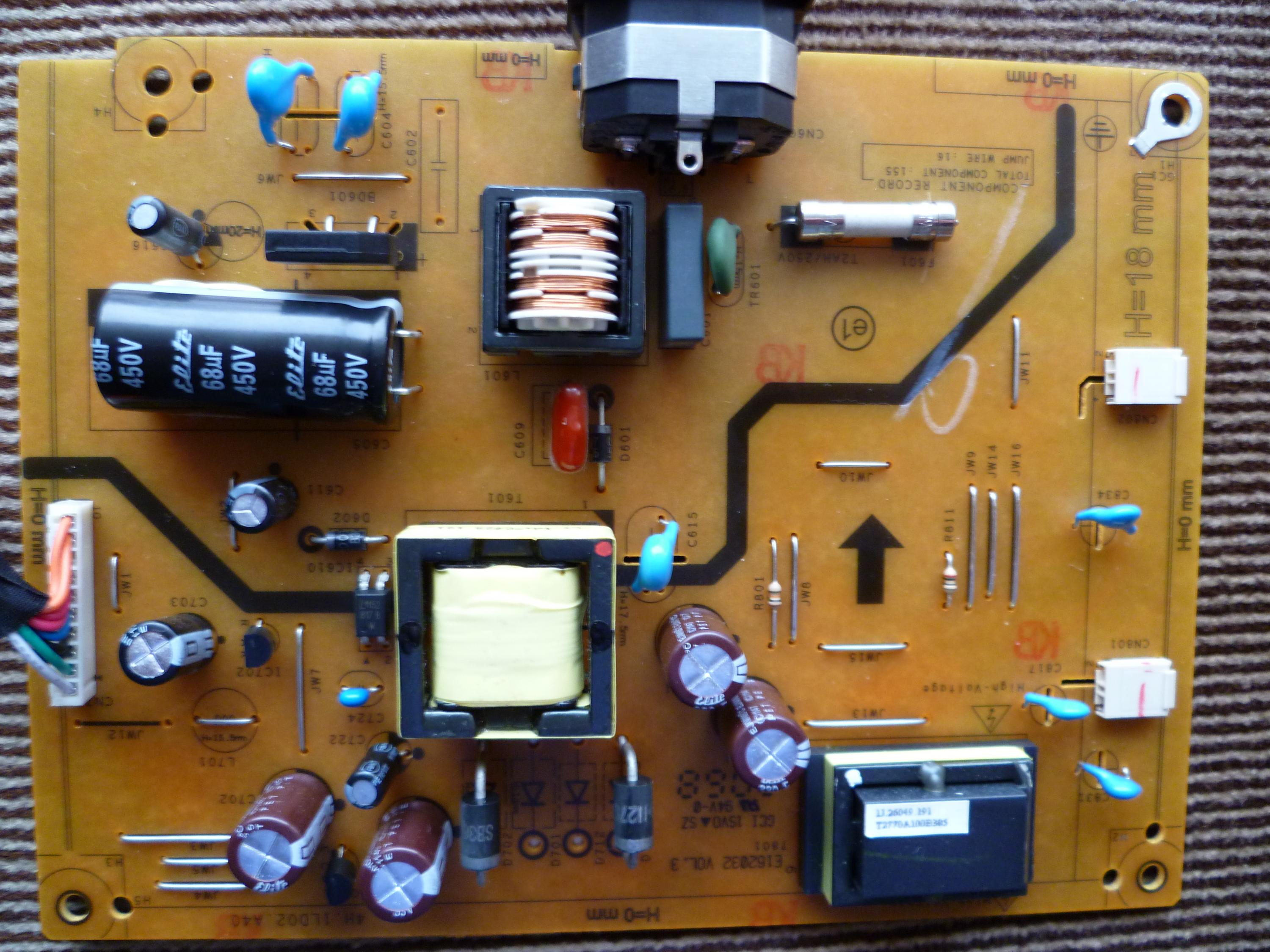

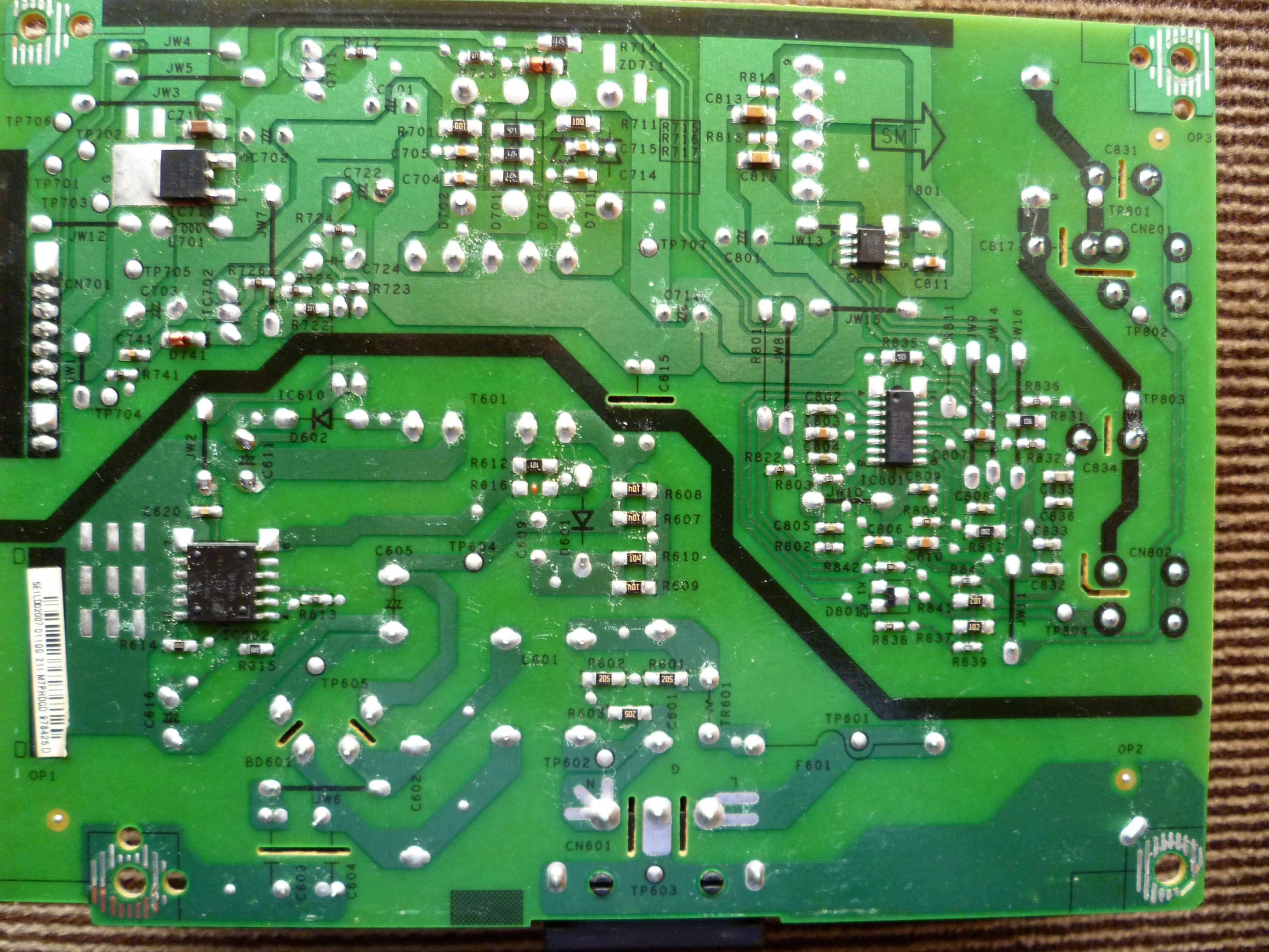

                        #171
                        Re: Benq G2255 doesn't power on - amber power light when plugged in - part 2
                        I am posting a photo of my board for easier reference, as part 1 of this thread has been a while! Please bear in mind that these are the original photos from the start, and that all caps including the big one were changed for either Nichicon or Rubycon caps, except the C703 (25V 220uf) which is a Panasonic.
                        I think we are back to the root cause for the 2 threads (part 1 and part 2) and that the 5V line seems to be causing something that fried the 6133 regulator to cook. Initially (at the beginning) the 3.3V line was fine but the TSUM on the main board had fried probably for the same reason?
                        Any thoughts anyone?

                          #172
                          Just finished checking the voltages on the power supply, and the 5V line looks very good, even under the oscilloscope. So I'm thinking, maybe it changes when there is a load, but yesterday when I was checking and it blew the 3.3v regulator, I had no load??
                          I'm thinking of connecting a 10W 10ohm resistor on the the 5v line, which I think would draw 2 amps, and then check how it behaves? Is this a good idea or will I fry something else? Tks.

                            #173
                            So I ended up checking everything (or almost) on the power supply board and nothing looks bad, so I thought maybe when I soldered the 61-33 regulator, I might have put too much heat.
                            So I installed a 1.5a regulator and tested the power supply board with only the cfl's connected. Nice clean 5V and 3.3V. So I'm off to test the power on sequence that Will62 wrote in a prior post. I'll be back for an update.......
