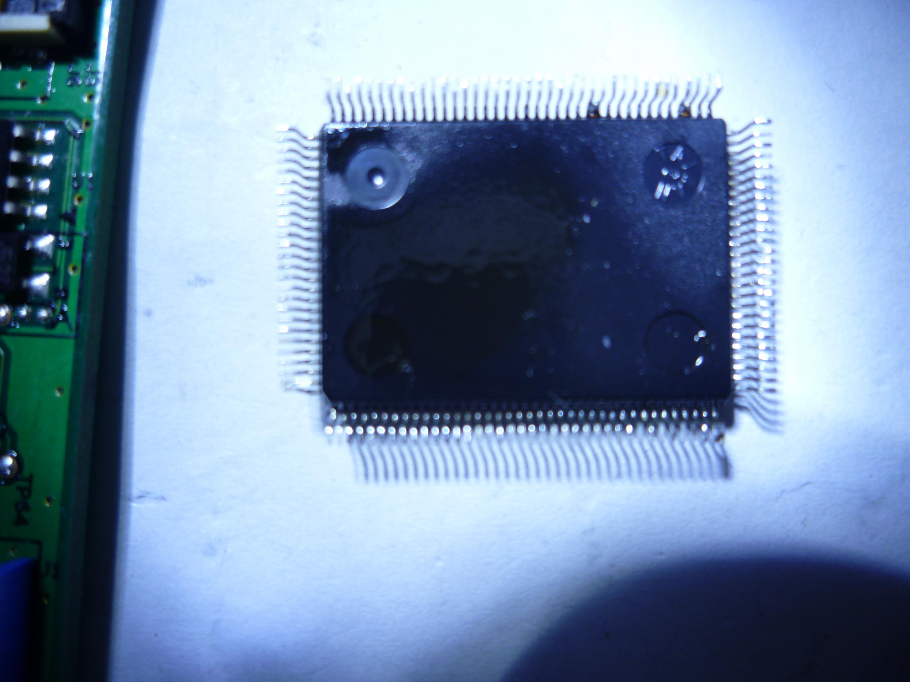

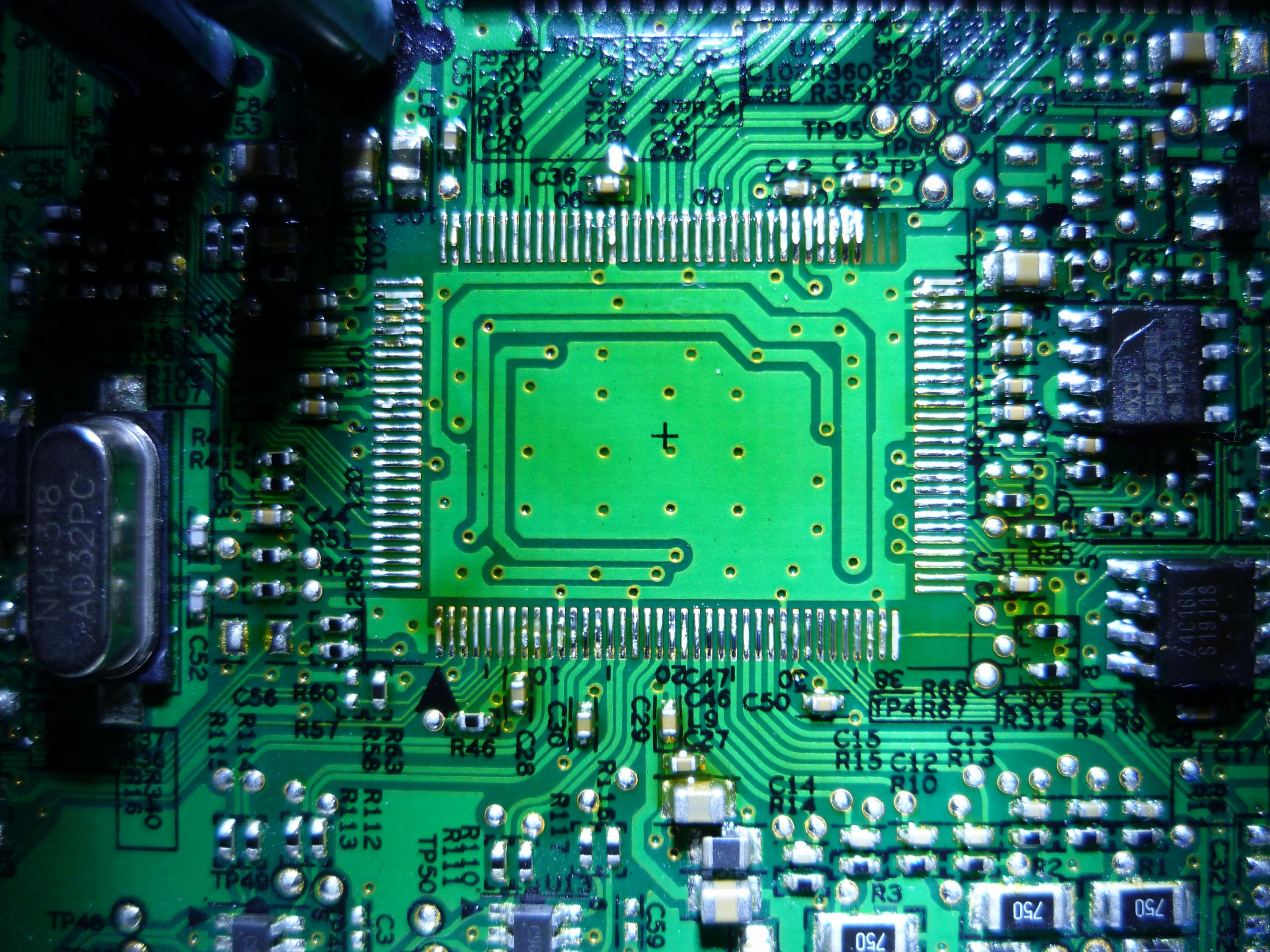

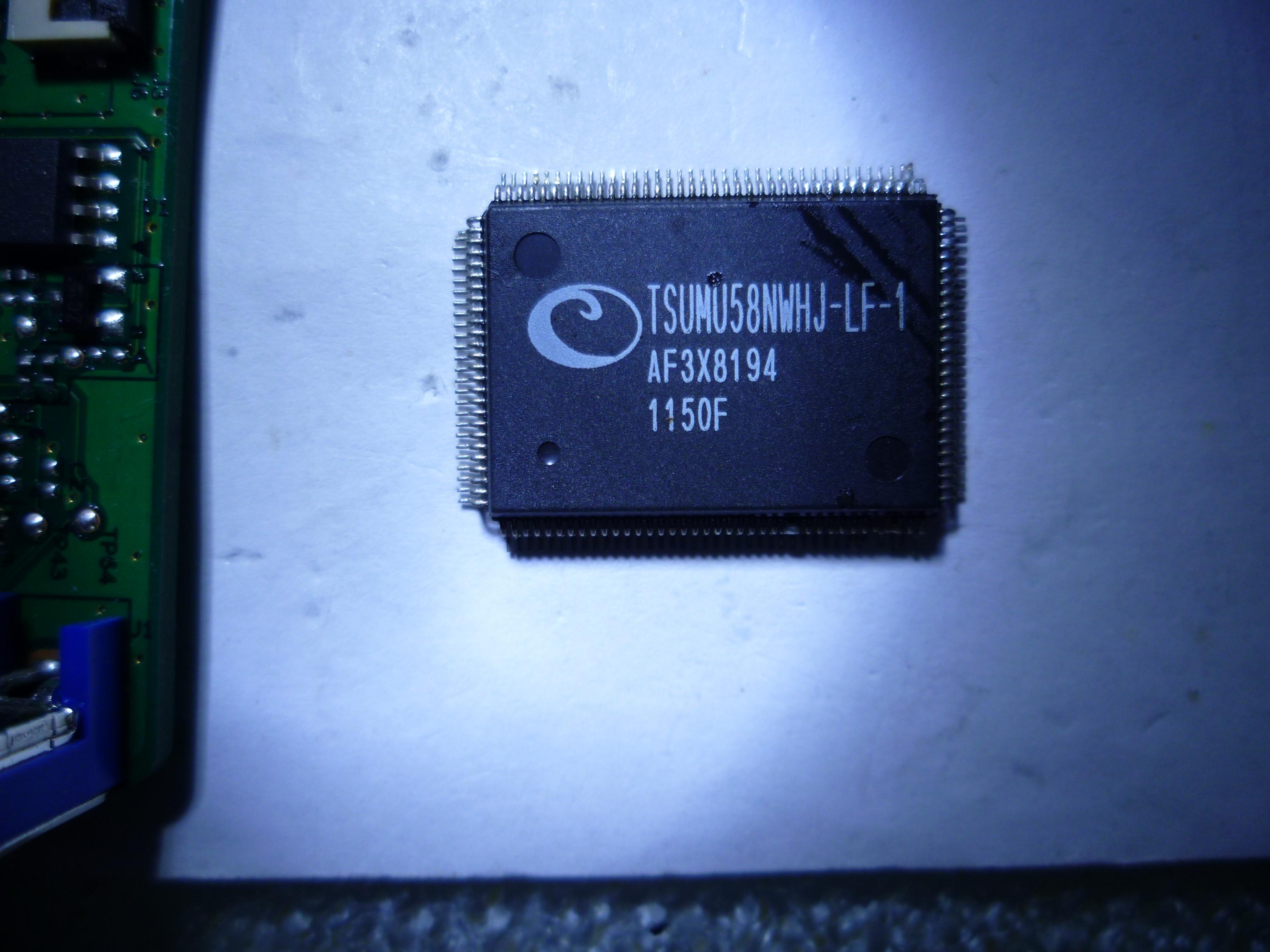

      ok Will, I plunged in and took the TSUM off (will be a long wait for the new one)! Guess what, resistance on the 3V is now in the 375Ks on the 1.8V in the 180K ohms and the 15 ohm I was getting on those 2 little caps, well now were in the mega ohms!
      So it does look as thought the chip was shot. One question however....pins 85, 86 and 87 don't see to have any solder or any trace on them. I checked the chip and i see the legs only...could it be that those 3 pins are not used or did I tear out the traces? All other traces look fine, I'm going to clean them up (with flux) and wait patiently for the TSUM to arrive.
      I am including some photos of the board and the chip. The one upside down, pin 1 is at the top left.
      I ordered another 2 by registered mail so it might go faster.

        Man, you got that chip up pretty neat. A lot of people just cut the pins off and remove them 1 by 1. It is easy to lift a pad if you let the solder cool while still lifting. Also very easy lifting them when cleaning up with solder wick. If I were you, I wouldn't use wick to clean those pads until you've practiced a lot on scrap boards. You'll be missing several pads before you know it. (don't ask me how I know)
        The pads that look blank to me appear to be pins 65,66 & 67. If that's the case, none of those are connected to anything. When you get the new chip in, before soldering it in, go ahead and measure the internal resistance between a ground pin and 1.8/3.3V. You'll know very quickly if there was a problem on the old chip. Back to the waiting game I guess...

          Ok, I'll send you a photo once I have it cleaned up. I don't use wick, I use flux with a hot iron to reflow and remove the solder on the pads. Worked very well on that Winbond, I did it a few times.
          You're right, those pins are 65, 66, 67...I don't know where I got 85, 86, 87, I think it was because I read on the board 84 instead of 64.
          As for the test you mention, couldn't I do it on the old chip? Which pins should I try...for example pin 1 is a ground, but would I have to check all grounds to each 3v and 1.8v pins? Not sure what to do here.

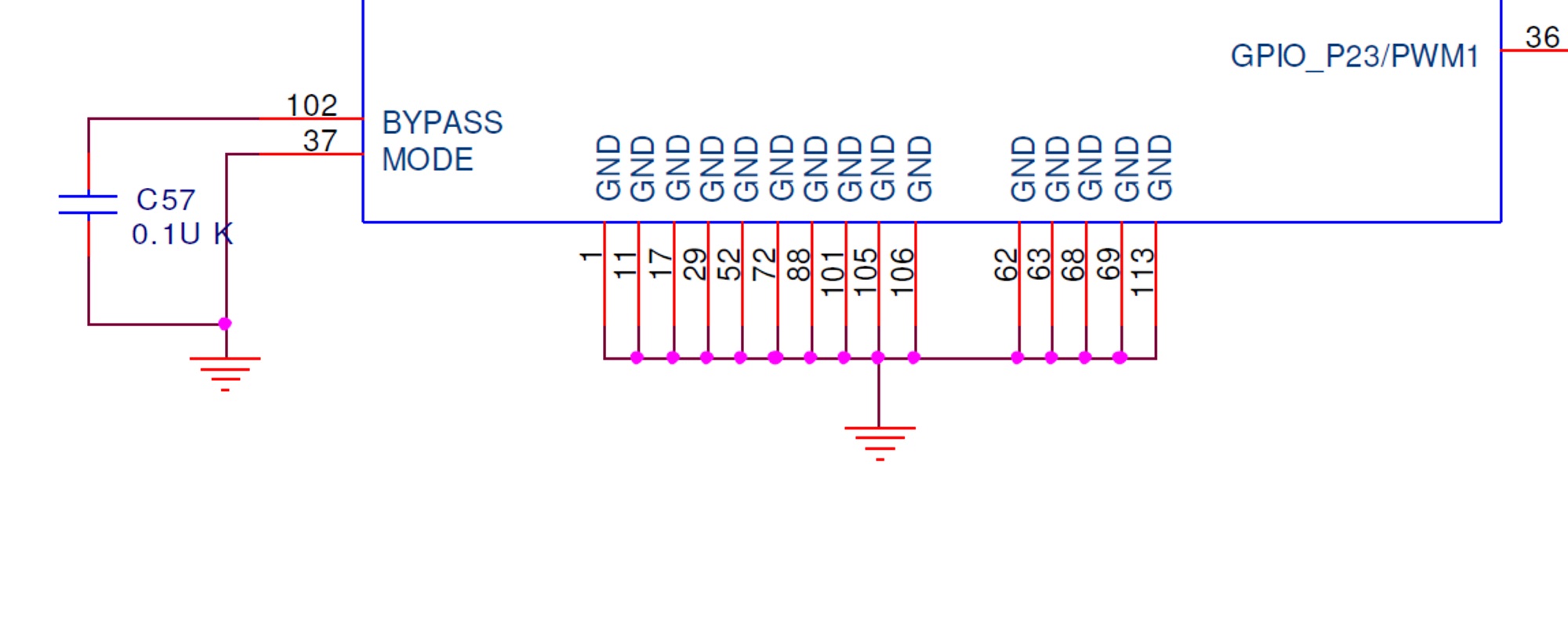

            You could check the old chip, but you said the board ohms to ground went way up with the chip removed, so I'd expect the chip to show low ohms to ground. There are only 5 1.8V pins if you want to try it. You shouldn't have to use different ground pins.
            1.8V = pins 21,53,74,104,126
            Gnd = 1,11,17,29,52,101+++many more

                  Found the ground on the old chip, it is between pins 17 & 8. Will check the new one to make sure.

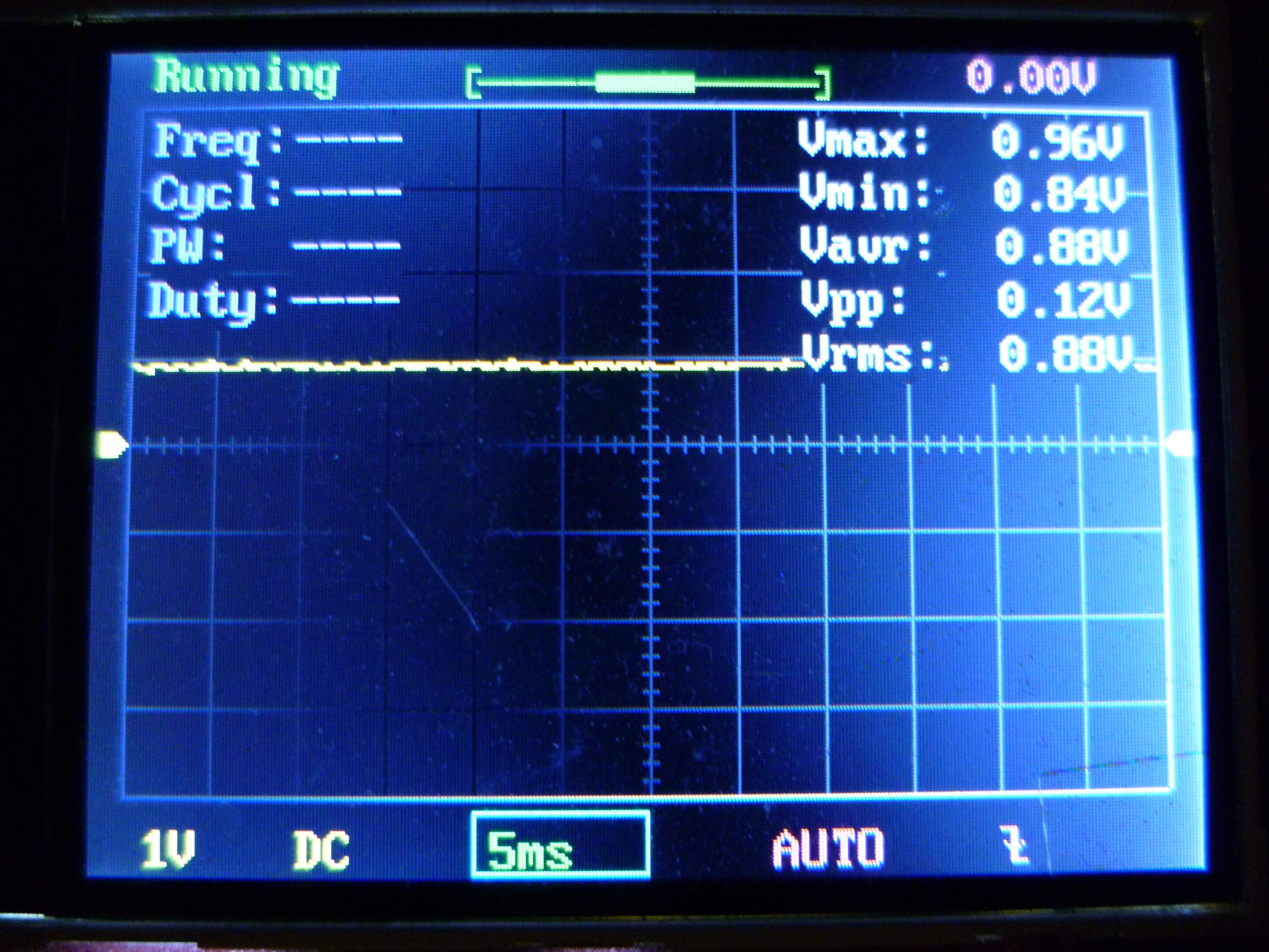

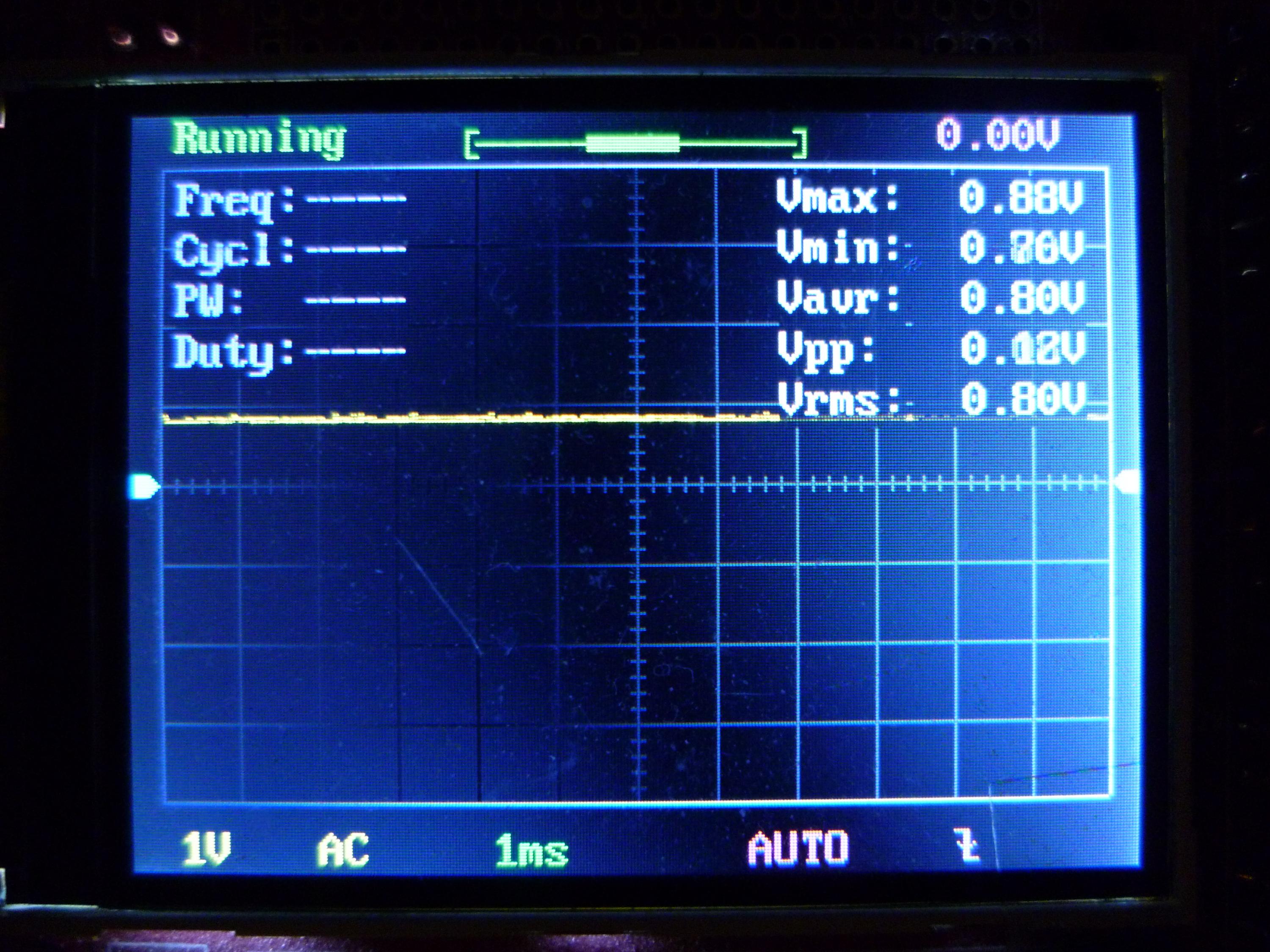

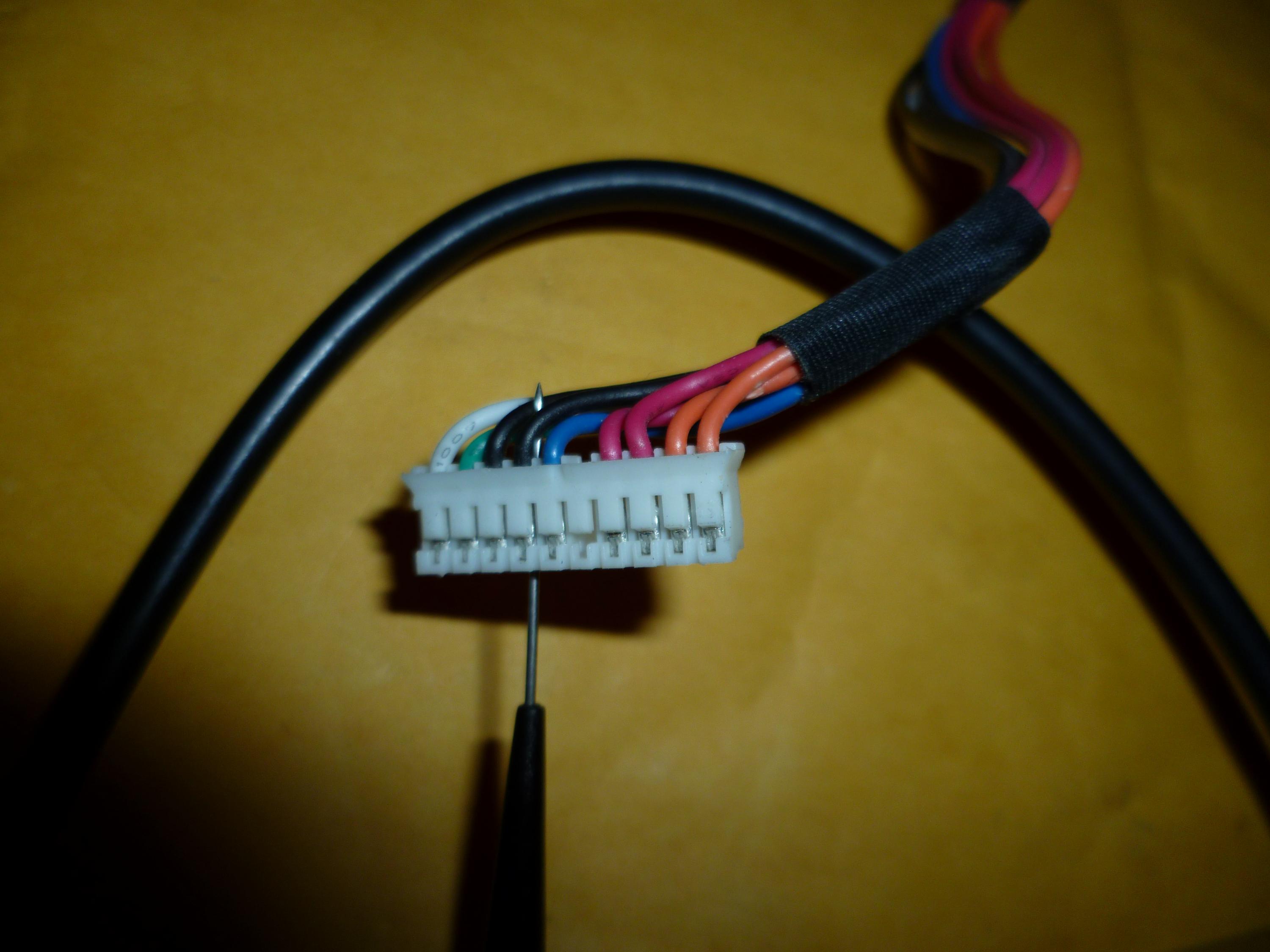

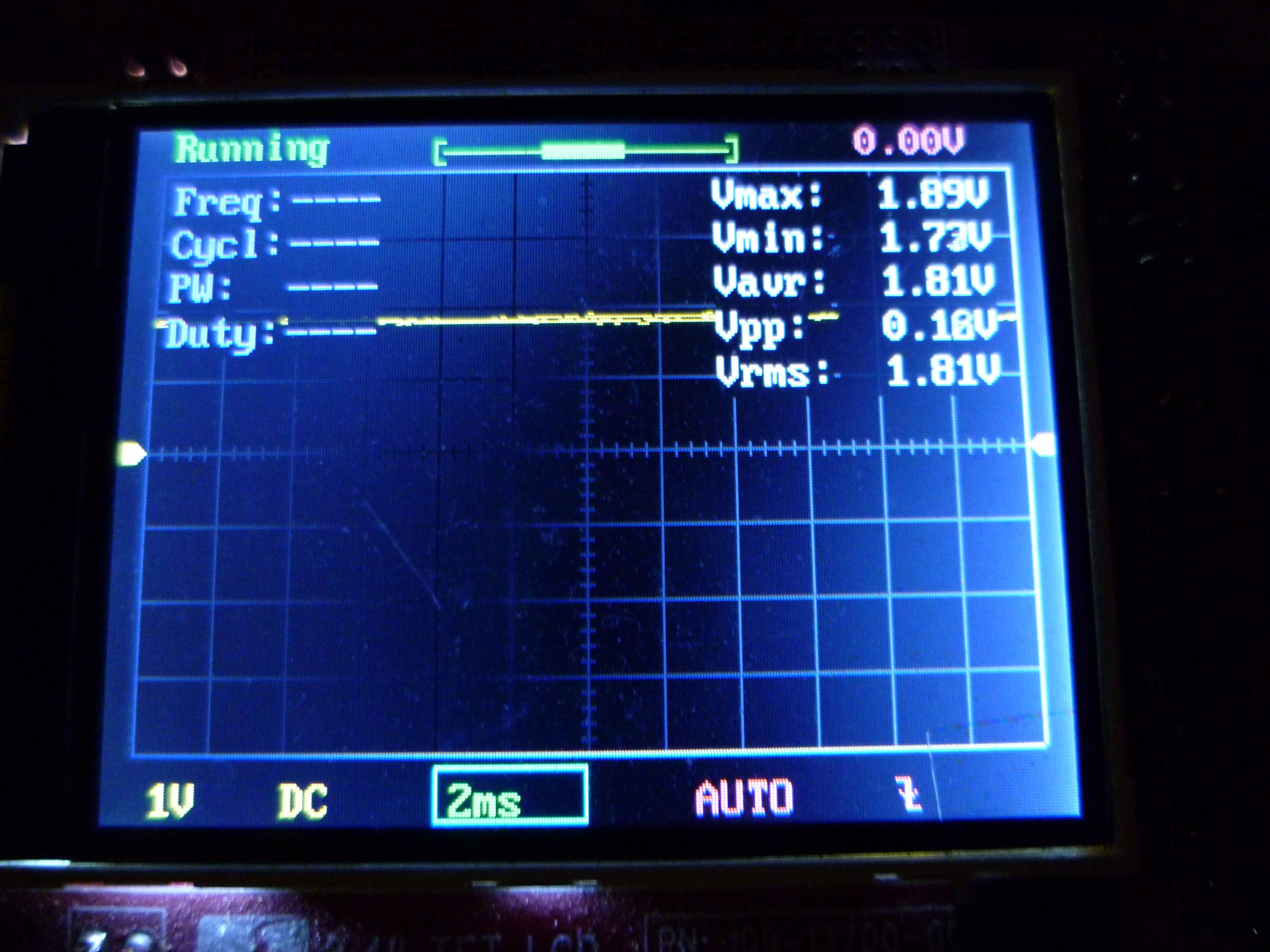

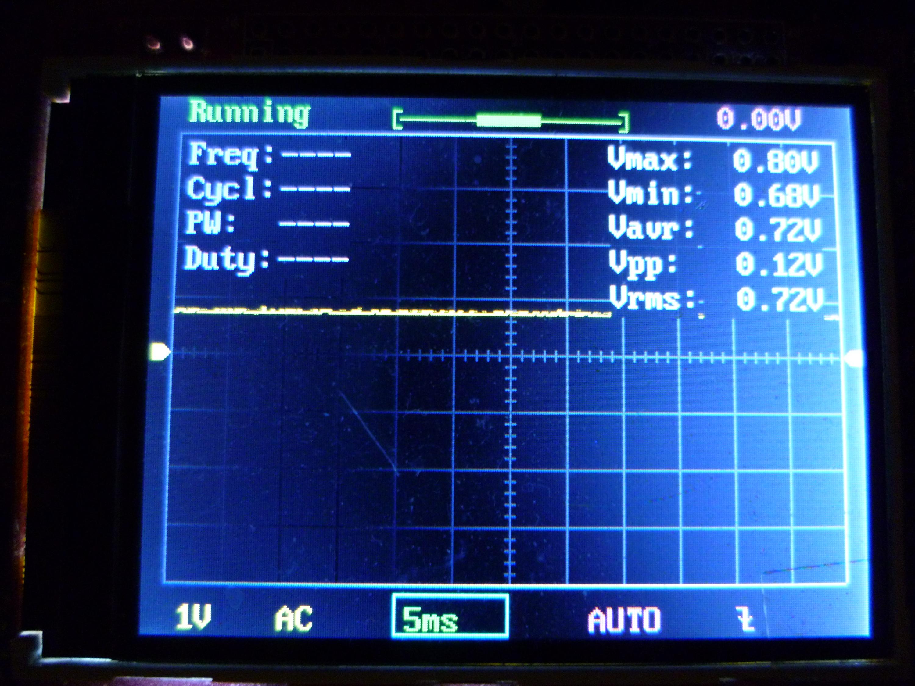

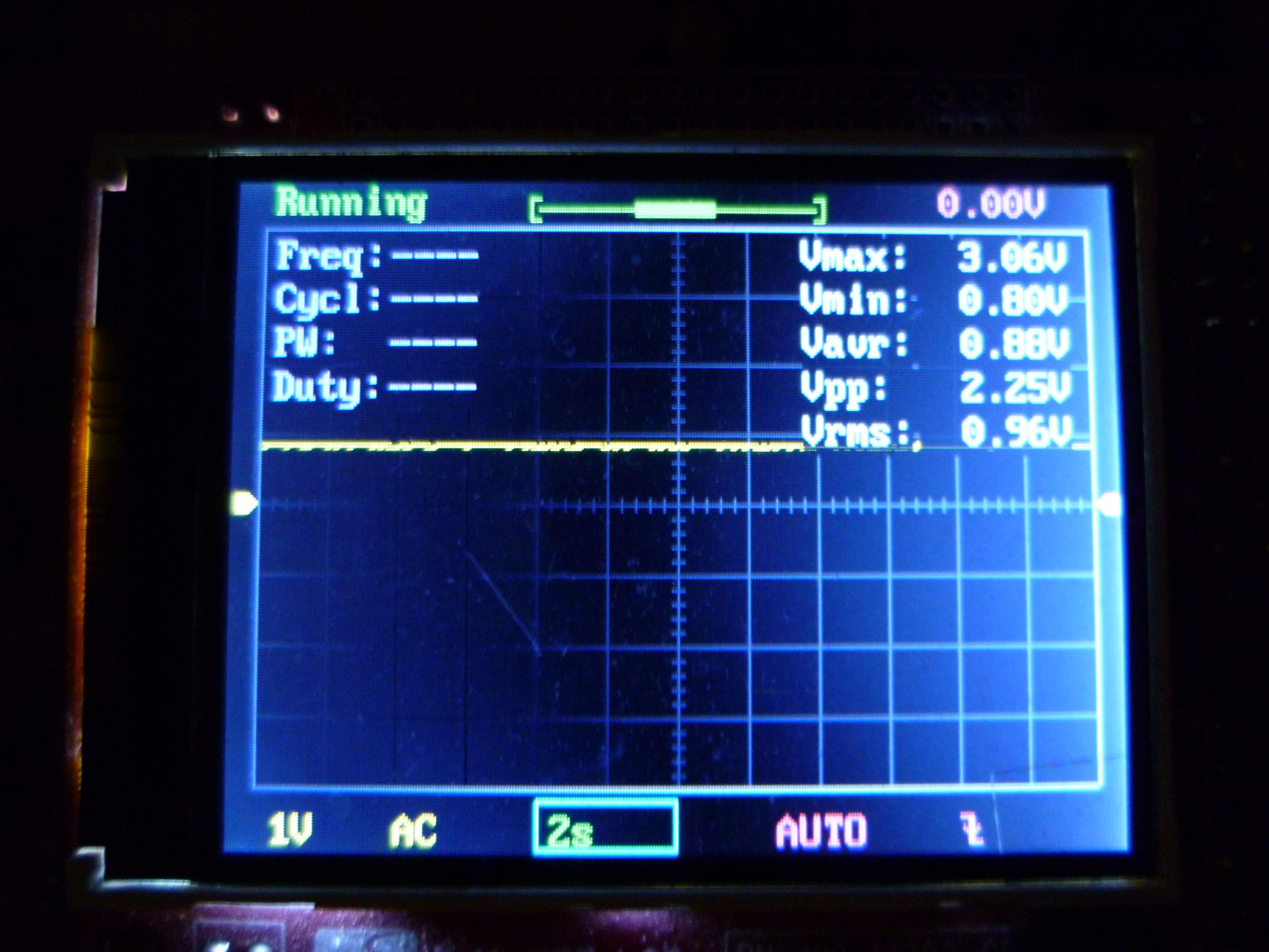

                                          #100
                                          Re: Benq G2255 doesn't power on - amber power light when plugged in - part 2

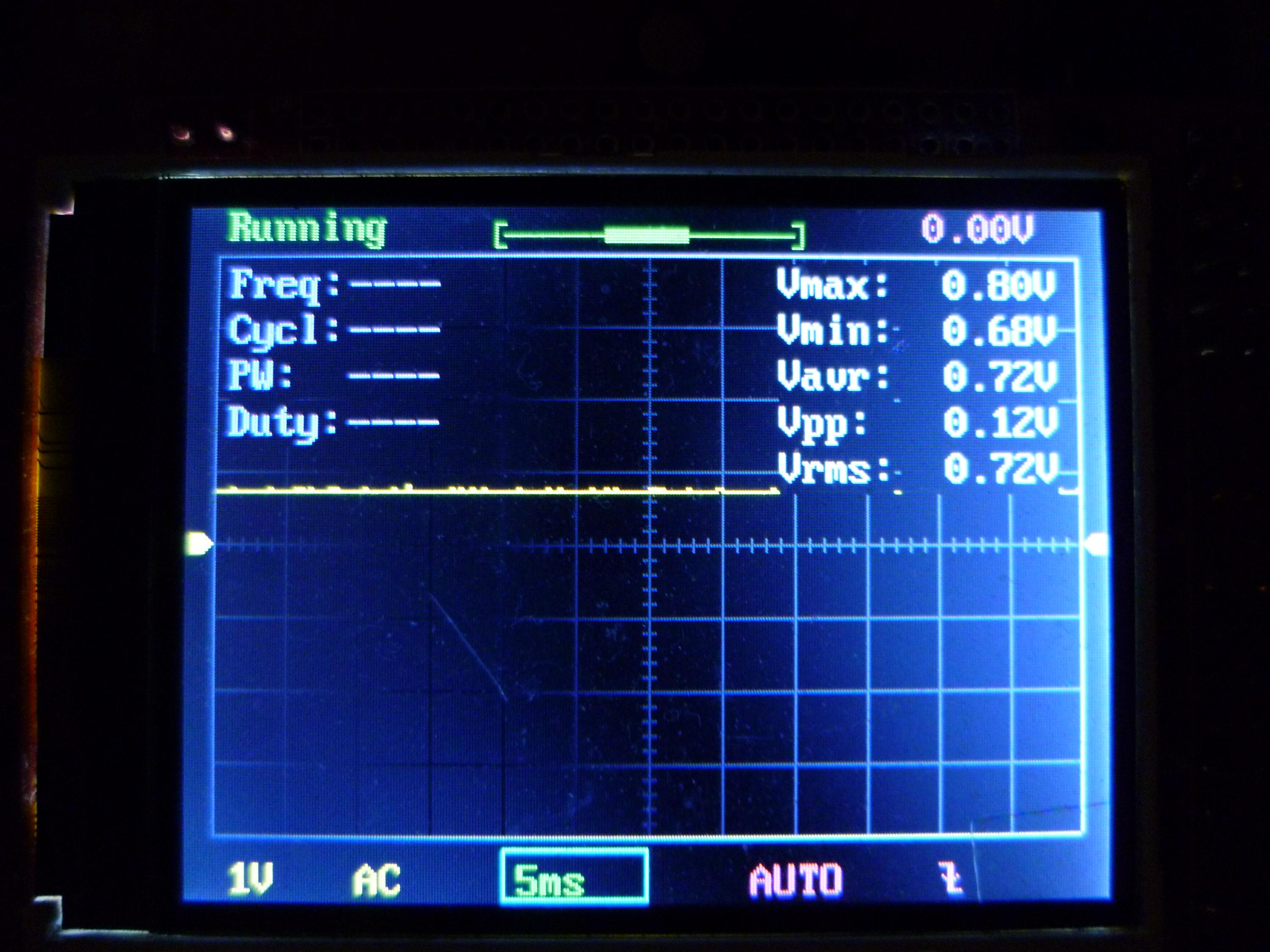

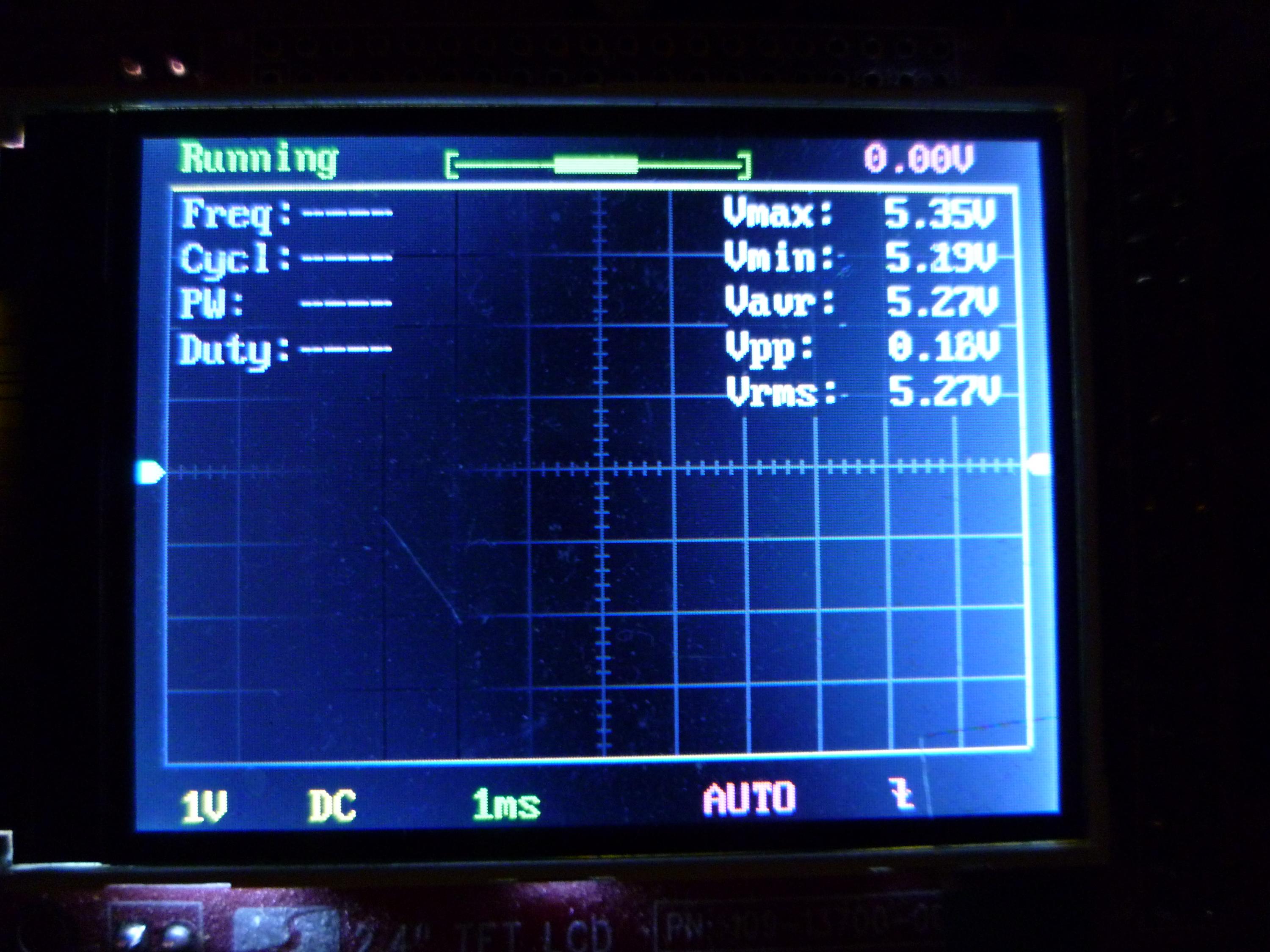

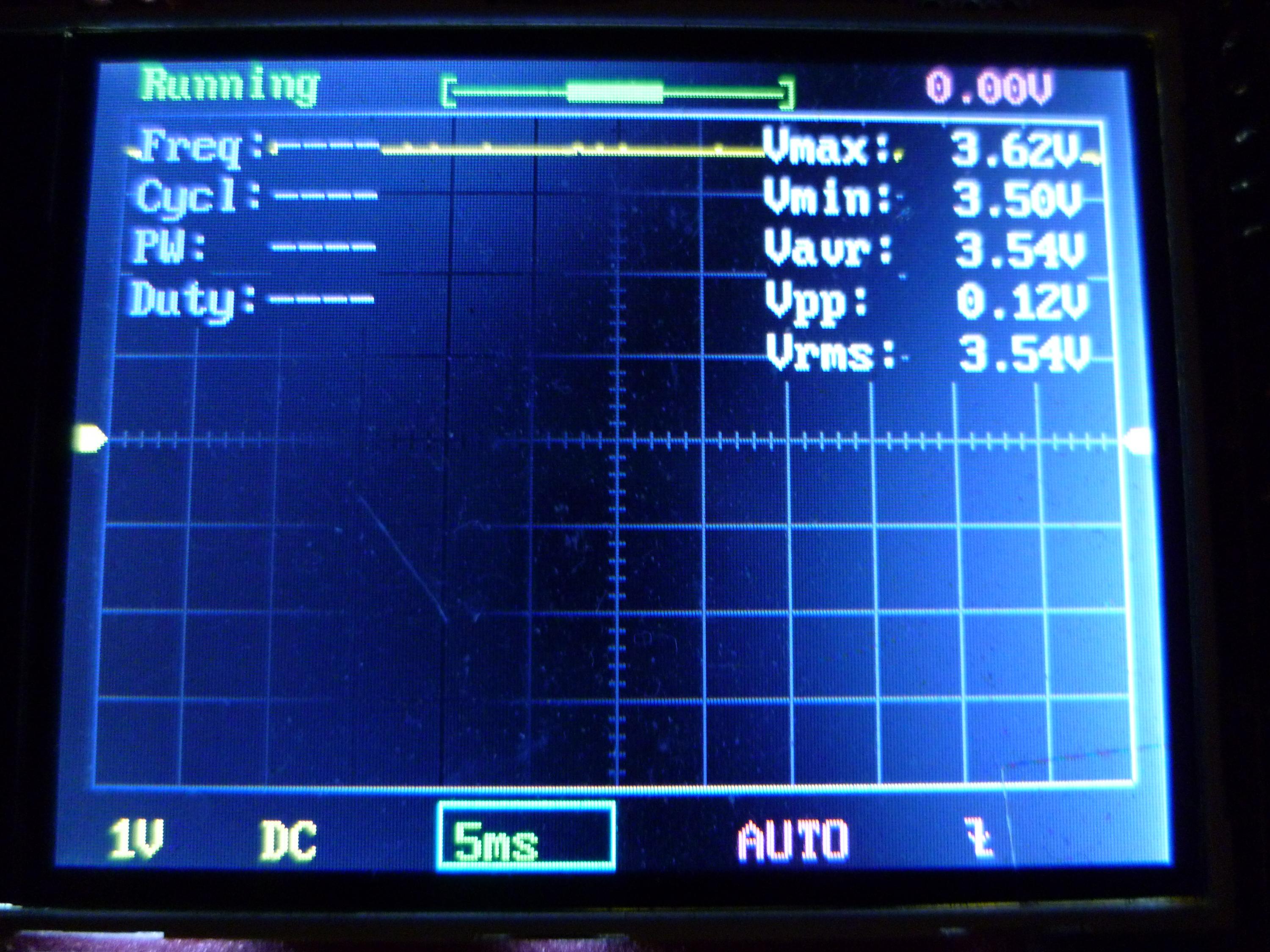

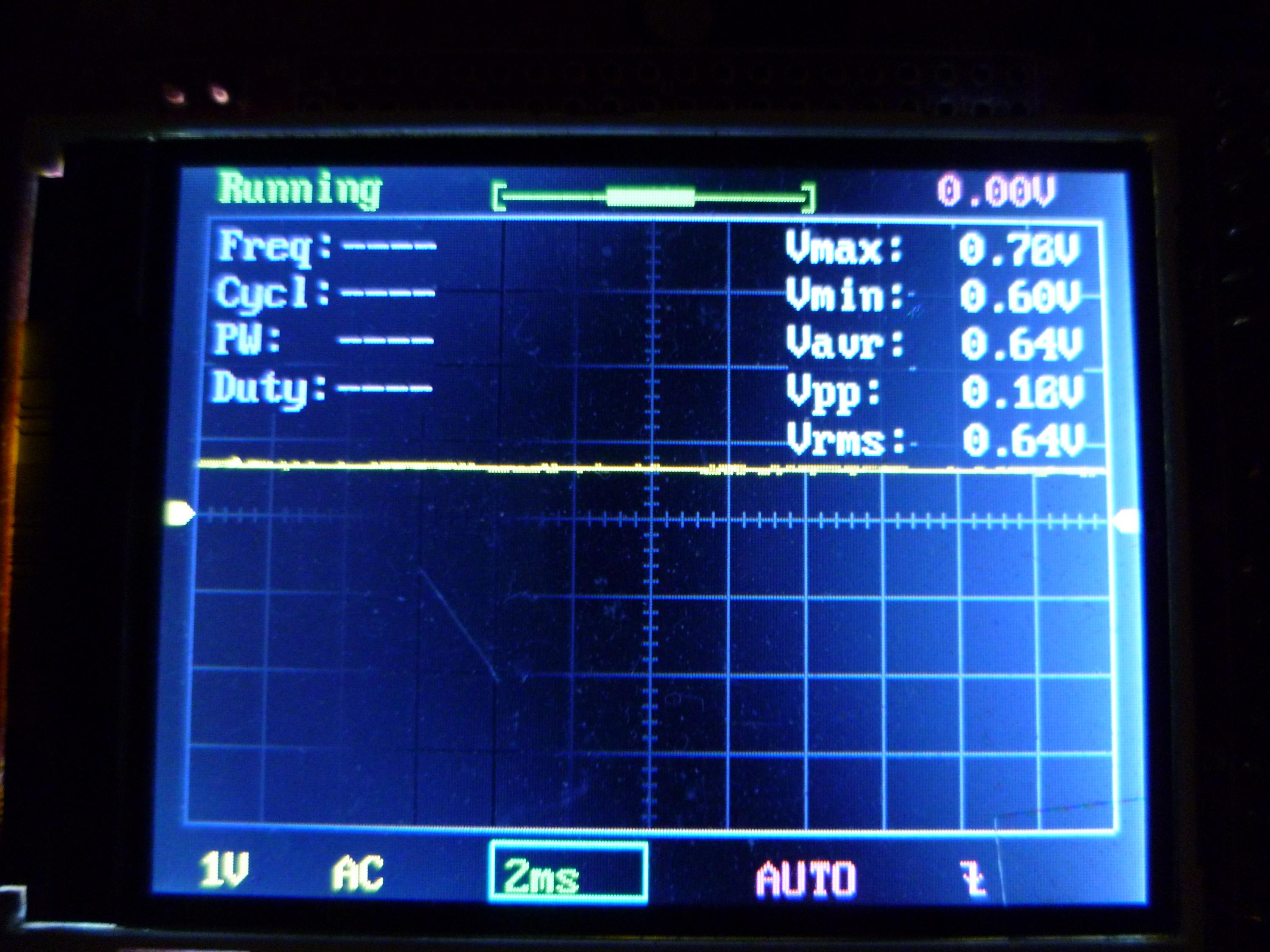

                                          Took some scope readings of every wire at the power supply, without the main board connected, both on AC coupling and DC coupling.
                                          Don't see anything special, do you?
