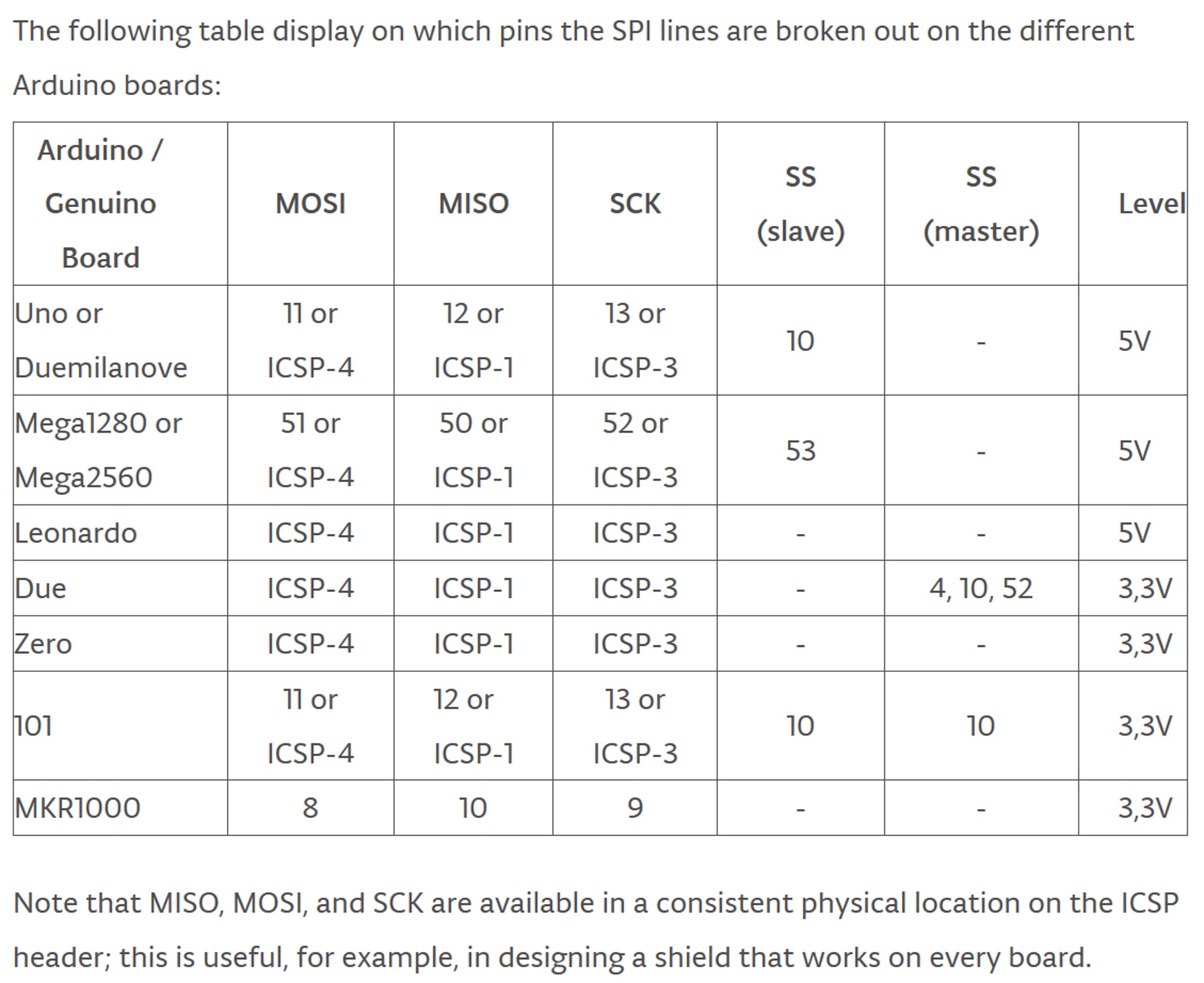

    OK, looks like that's actually the firmware for the flash chip, not the eeprom. Glad you found it. The highest tolerated signal on the flash is about 4.6V. As mentioned above, only a few Arduinos are below that. You need to check the specs on the Uno. Not a deal killer, but would require the voltage dividers.
    My UNO is the no brand name kind, so I really don't know what the signal voltage is. I guess that's why in the attached photo, the guy uses 1K resistors...he's on the 5V line, but I have a 3.3V line on my Uno that I could use instead of 5V.

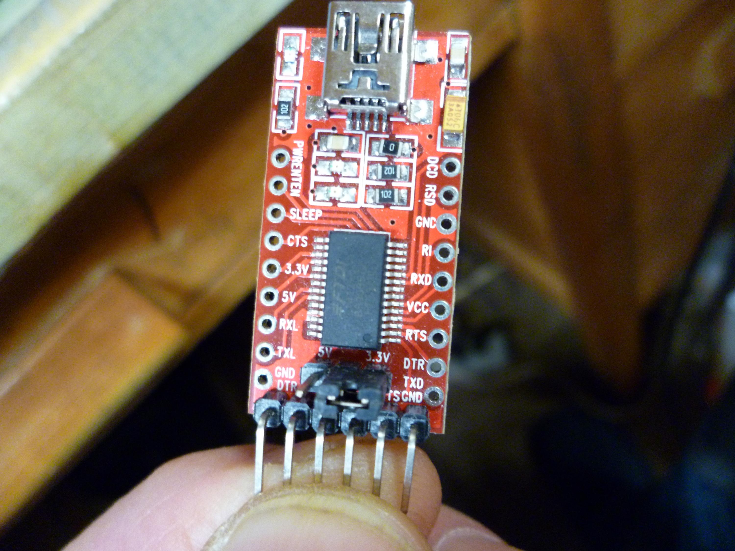

    I also have a USB ASP board, and a FTD1232 board in case does could be better, but I would not really know how to plug them? I do however use my FTD1232 to update my oscilloscope firmware by using RX, TX and GND it's got VCC 3.33V and 5V that you can select, right now I have it on VCC 3.3V. There is also a DTR and CTS line on this device.

      The flash uses SPI, the eeprom uses I2C. The pic below gives the SPI signal levels of different Arduino models. It could still be done, but the programming to read the .bin file and properly copy it to the flash ic, would be non-trivial to say the least. You could start by trying to issue read commands to the ic and see if you get a response.
      I'll look over the other items you mentioned above. Maybe there is something open source that you could use with them. If you get to the point of copying the FW to the flash ic, I'd think about buying a new chip. The old one could have bad sectors on it, causing the problem. You can get 5 of them from China for $1.99 (free shipping), but they'll take a few weeks to get here.
