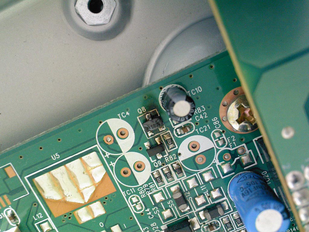

        • capamatic
          • Apr 2006
          • 33
          #64
          Re: Gateway 900G frustration
          Good to hear there is a non-DVI version.
          Tried at the native res 1440 x 900 at all available freq`s, still bad.
          Disconnected the VGA and now the `Gateway` splash screen/`no video input` is garbled too !, initially it was perfect.
          Maybe the voltage supply to the Video Board is out of spec. ?
          • PlainBill
            • Feb 2009
            • 7034
            #65
            Many video boards have on-board regulators (and their companion caps). Odds are one or more of those caps are bad. It sounds painfully like a problem I had with a VP211b.
            PlainBill

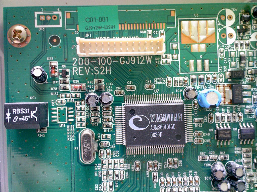

            • EGuevarae
              • Nov 2008
              • 1336
              #66
              Check voltage out to the VBoard. Then, post a pic (good size/res) of the board to see what 5v->3/3.3v regulators are found and/or check those. It may be a Voltage problem as you said.

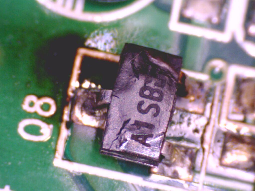

                • capamatic
                  • Apr 2006
                  • 33
                  #68
                  Didn`t have to look far for the cause of the res. problem
                  Looks like the recap put paid to the Vreg, assisted by a failing cap.
                  Burned Vreg.
                  Marked as A1SB then 51 rotated, doesn`t reveal much. Probably a manufacturers No. and impossible to trace, let alone find a replacement.
                  So if anyone has a VBoard (200-100-GJ912W) or source for one, I`d appreciate a pointer.

                    • Wizard
                      • Mar 2008
                      • 2296
                      #70
                      That's 5V switch to turn on or off 5V supply to the LCD, usually NPN with very low R-on and logic level input.
                      Replace it with uprated substitute. That tiny transistor is not rated for that demand.
                      Second, check the resistance between ground and 5V at LCD to make sure there is no short on 5V input high uF ceramic capacitors on the LCD circuit board. If there one, carefully look for cracked or discolored SMD capacitors otherwise unsolder one by one till short is gone. Usually fuse is first thing 5V comes through but there are other designs that had caps come first then a fuse then more caps.
