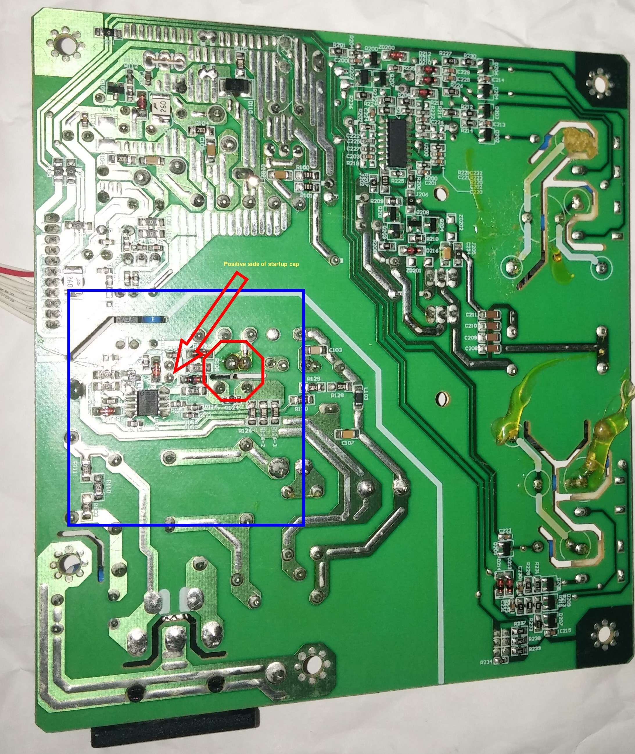

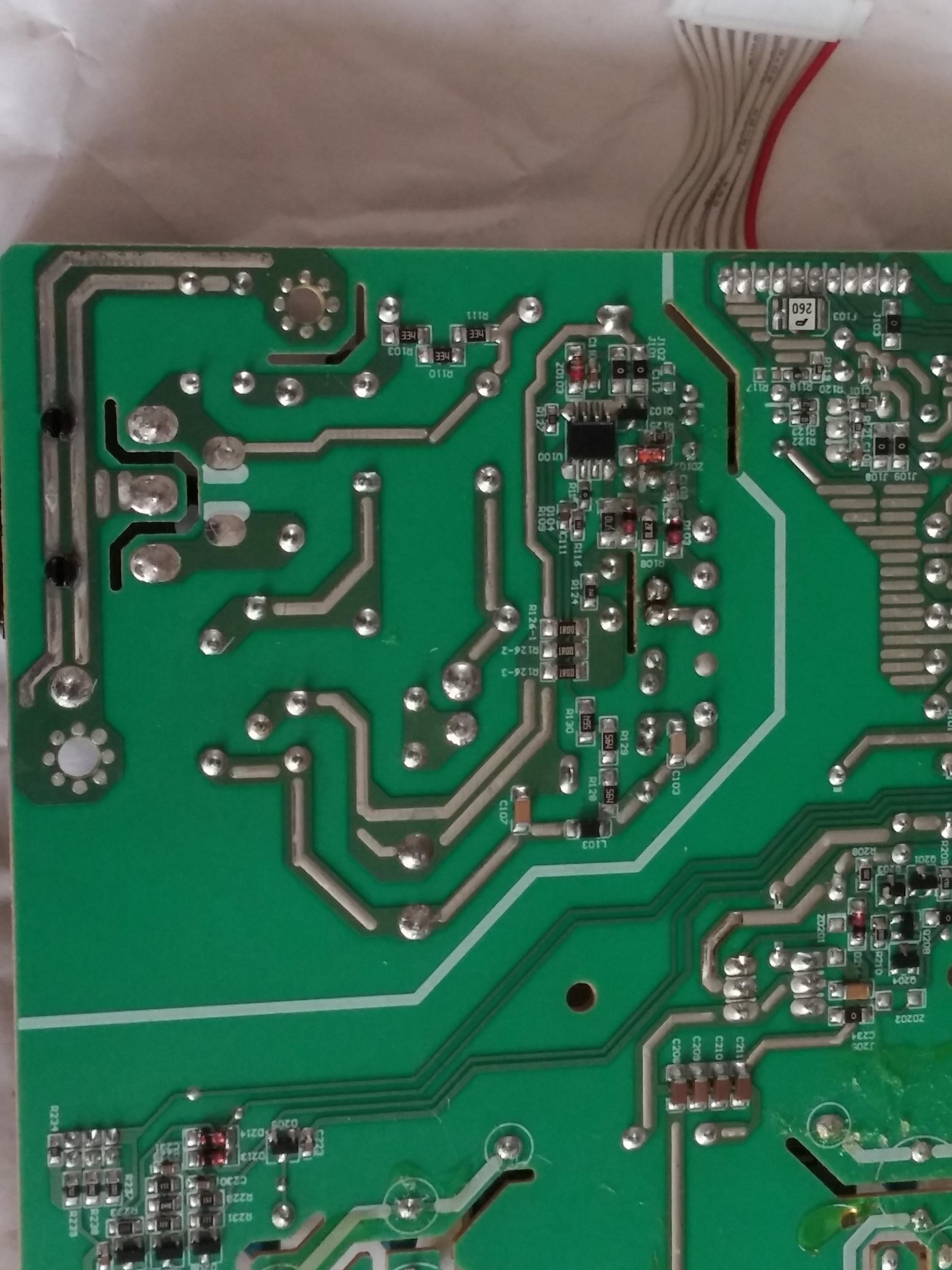

GNR TS902W no power , help please
  • lcdcaps1
    replied
    Re: GNR TS902W no power , help please
    ok i think i might have found a shorted diode that i missed but im sure i tested before
    I checked again but seems that its gone
    its d104
    0,055v, diode mode both ways
    what can i replace this with, can i used one from a old power supply
    attached is a pic shown
    please help again
    thanks
    Leave a comment:
    replied
    Re: GNR TS902W no power , help please
    Originally posted by lcdcaps1
    Thanks for the reply, really appreciate every ones help here
    I dont know how i did not see that h95 resistor
    I measured it and got a reading of 564.5 K ohms
    is this ok
    All electronic components have a tolerance for their values. Typically it can be anywhere from 1% to 20%.
    Assume most resistors to be 5%, unless they specifically have a lower tolerance specified (i.e. 1%, 2%, etc.). So for that 560 KOhm resistor, anything in the range of 532-588 KOhms is in spec.
    For electrolytic capacitors and most inductors, tolerance is usually specified as 20%.
    For film and ceramic capacitors, you'll normally see 5-10% parts used.
    Originally posted by lcdcaps1
    OK so replaced SG6841 and no joy
    i get 318mv on pin 3
    and on pin 7 3v
    also my start up capacitor has voltage 025.8mV
    no output power
    Something doesn't make sense here. How can you have only 25.8 mV on the start up capacitor, but 3V on pin 7 (Vdd) of the chip? Re-check your measurements and also re-check all SMD components mentioned previously. This time, please post what resistance/diode readings you get in your post.
    For example, post something like this:
    D108: forward direction diode test xxx mV, reverse direction diode test yyy mV
    R103: zzz Ohms resistance
    Do this for all components I mentioned above.
    That said, also try to familiarize yourself with the SG6841 datasheet to get an idea of some of the values to expect. For example, the minimum *startup* voltage on pin 7 (Vdd) is 16V, and minimum operating voltage for that pin is 10V (page 5, "Under-Voltage Lockout Section".)
    Last edited by momaka; 06-26-2018, 09:32 AM.
    Leave a comment:
  • lcdcaps1
    replied
    Re: GNR TS902W no power , help please
    OK so replaced SG6841 and no joy
    i get 318mv on pin 3
    and on pin 7 3v
    also my start up capacitor has voltage 025.8mV
    no output power
    Leave a comment:
  • lcdcaps1
    replied
    Re: GNR TS902W no power , help please
    Thanks for the reply, really appreciate every ones help here
    I dont know how i did not see that h95 resistor
    I measured it and got a reading of 564.5 K ohms
    is this ok
    please let me know anyone, someone
    thanks
    Originally posted by momaka
    Okay, good. Anything less than 100 Ohms, though?
    Heh, that's cause you're looking at it upside down. Turn it around, and it should look more like "564", no? It's the same value as R128 and R129 - i.e. 560 kOhms.
    In any case, since you're getting about 22 Volts on pin 3 of the PWM chip, I don't think that R130 resistor is open... but it doesn't hurt to check it again.
    Sound to me like your multimeter has offset at low resistances. This is typical with cheaper/budget multimeters. When you touch the probes of your multimeter together on the lowest resistance scale, what resistance do you get? If it's 0.5 to 1.0 Ohms (some cheaper meters even read as high as 2.0 Ohms), that would be the reason why your 2.7 Ohm resistor reads as 3.7 Ohms. If that is the case, you shouldn't worry.
    Also, 3.7 Ohms for that resistor still shouldn't prevent the circuit from working.
    Alright, that looks like it's okay too.
    Welp... at this point, I think the problem points to a faulty PWM chip then. So time for a new SG6841. Then we can continue from there if the problem still persists. I don't think there's anything else we can test until that's replaced.
    On that note, maybe buy two of these PWM chips, in case one turns out a dud or somehow gets blow up while repairing the PSU.
    Leave a comment:
    replied
    Re: GNR TS902W no power , help please
    Originally posted by lcdcaps1
    tested SMD Caps surrounding SG6841 chip
    all read above 30 ohms
    Okay, good. Anything less than 100 Ohms, though?
    Originally posted by lcdcaps1
    one resistor, r130 i dont know what the reading should be
    its a h95
    Heh, that's cause you're looking at it upside down. Turn it around, and it should look more like "564", no? It's the same value as R128 and R129 - i.e. 560 kOhms.
    In any case, since you're getting about 22 Volts on pin 3 of the PWM chip, I don't think that R130 resistor is open... but it doesn't hurt to check it again.
    Originally posted by lcdcaps1
    there is one resistor, R108. high lighted in attached pic
    rating is 2.7 ohm and i get 3.7 ohm, tested in and out of circuit but the same value, is this needed to get this working ?
    Sound to me like your multimeter has offset at low resistances. This is typical with cheaper/budget multimeters. When you touch the probes of your multimeter together on the lowest resistance scale, what resistance do you get? If it's 0.5 to 1.0 Ohms (some cheaper meters even read as high as 2.0 Ohms), that would be the reason why your 2.7 Ohm resistor reads as 3.7 Ohms. If that is the case, you shouldn't worry.
    Also, 3.7 Ohms for that resistor still shouldn't prevent the circuit from working.
    Originally posted by lcdcaps1
    q103
    diode voltage reading
    0.632v
    Alright, that looks like it's okay too.
    Originally posted by lcdcaps1
    All diodes are ok, non are bad
    tested all in diode mode
    Welp... at this point, I think the problem points to a faulty PWM chip then. So time for a new SG6841. Then we can continue from there if the problem still persists. I don't think there's anything else we can test until that's replaced.
    On that note, maybe buy two of these PWM chips, in case one turns out a dud or somehow gets blow up while repairing the PSU.
    Last edited by momaka; 06-25-2018, 07:19 PM.
    Leave a comment:
  • lcdcaps1
    replied
    Re: GNR TS902W no power , help please
    Hi
    I have done all the checks you mentioned
    22.68V pin 3
    0001.7 mV and climbing
    tested SMD Caps surrounding SG6841 chip
    all read above 30 ohms
    all resistors read ok
    one resistor, r130 i dont know what the reading should be
    its a h95
    there is one resistor, R108. high lighted in attached pic
    rating is 2.7 ohm and i get 3.7 ohm, tested in and out of circuit but the same value, is this needed to get this working ?
    q103
    diode voltage reading
    0.632v
    All diodes are ok, non are bad
    tested all in diode mode
    I am using a esr meter, one similar to bob parker design
    Originally posted by momaka
    Are you really getting 0 (zero) volts or just a very low voltage in the 100's of mV range?
    That being said, sometimes PCBs have a very thin invisible layer of flux left over from manufacturing over the solder joints. This can make you get false readings sometimes. To make sure this is not happening, always poke the solder joints with a tiny bit of force and movement of the multimeter probes to break any layer of flux that may be left over (but of course, be careful not to slip and short-circuit something - for this reason I recommend "poking" any joints you want to measure the voltage on prior to plugging the power supply in.)
    Well, if there really is no voltage on that startup cap / pin 7 (Vdd) of the SG6841 chip, then it is very much possible that the SG6841 chip is bad. However, before we jump to any conclusions, check the following:
    - With the power supply connected to the wall, check if there is a voltage on Pin 3 (Vin) - you should get a voltage there (though I don't know what value).
    Also, check ALL of the components surrounding the SG6841 chip. I know that is very general instruction, but if one of these components is not right, it could make the SG6841 chip appear dead.
    So in particular, check that NONE of the SMD ceramic capacitors (tan rectangular components) show short-circuit or a reading of less than 30 Ohms across. Any that do, please note them here.
    The resistors around the SG6841 controller should all read either the resistance that is printed on their code or LESS. If any of the resistors shows a resistance higher than 5% of its printed value, remove it from the circuit and re-check it.
    Next, check all of the SMD diodes and Zener diodes. Namely, check Zener diodes ZD102 and ZD103, as well as diodes D103 and D104 for short-circuit or open-circuit in both directions. I appears that D103 and resistor R108 is what supplies power to the start-up cap, and most likely ZD102 protects pin 7 (Vdd) of the SG6841 PWM controller. If D103 or ZD102 are shorted, that would certainly cause the no voltage you're seeing across the start-up cap. There is also a small SMD ceramic capacitor between ZD102 and D103 - definitely make sure that one is not shorted, as that can cause the same problem. And R108 should read close to 2.7 Ohms.
    Finally, check the small transistor, Q103. I think this might be used for pulling/regulating the voltage on either pin 3 (Vin) or pin 7 (Vdd). It's probably an NPN-type transistor rather than PNP, but it's hard to say. When viewed with the two pins on the bottom and the single pin on top, the left pin on the bottom should be Base, top should be Collector, and bottom right should be Emitter.
    For NPN-type, you should get a diode reading when the red (positive) multimeter probe is on Base and black (negative) probe is on either Emitter or Collector. For PNP, same results, but with the probes inverted.
    If all of these tests pass, you probably need a new SG6841 PWM controller.
    Just curious, what ESR value did you get from it? And capacitance?
    What about the new/replacement cap you used - what brand and series was it, and what ESR and capacitance did it have?
    Also what device are you using to measure caps?
    Thanks.
    Last edited by lcdcaps1; 06-25-2018, 11:56 AM.
    Leave a comment:
  • lcdcaps1
    replied
    Re: GNR TS902W no power , help please
    My startup capacitor I am getting 001.6 mV and it climbs but still stays in the mV range
    This is a new startup cap
    Originally posted by momaka
    Are you really getting 0 (zero) volts or just a very low voltage in the 100's of mV range?
    That being said, sometimes PCBs have a very thin invisible layer of flux left over from manufacturing over the solder joints. This can make you get false readings sometimes. To make sure this is not happening, always poke the solder joints with a tiny bit of force and movement of the multimeter probes to break any layer of flux that may be left over (but of course, be careful not to slip and short-circuit something - for this reason I recommend "poking" any joints you want to measure the voltage on prior to plugging the power supply in.)
    Well, if there really is no voltage on that startup cap / pin 7 (Vdd) of the SG6841 chip, then it is very much possible that the SG6841 chip is bad. However, before we jump to any conclusions, check the following:
    - With the power supply connected to the wall, check if there is a voltage on Pin 3 (Vin) - you should get a voltage there (though I don't know what value).
    Also, check ALL of the components surrounding the SG6841 chip. I know that is very general instruction, but if one of these components is not right, it could make the SG6841 chip appear dead.
    So in particular, check that NONE of the SMD ceramic capacitors (tan rectangular components) show short-circuit or a reading of less than 30 Ohms across. Any that do, please note them here.
    The resistors around the SG6841 controller should all read either the resistance that is printed on their code or LESS. If any of the resistors shows a resistance higher than 5% of its printed value, remove it from the circuit and re-check it.
    Next, check all of the SMD diodes and Zener diodes. Namely, check Zener diodes ZD102 and ZD103, as well as diodes D103 and D104 for short-circuit or open-circuit in both directions. I appears that D103 and resistor R108 is what supplies power to the start-up cap, and most likely ZD102 protects pin 7 (Vdd) of the SG6841 PWM controller. If D103 or ZD102 are shorted, that would certainly cause the no voltage you're seeing across the start-up cap. There is also a small SMD ceramic capacitor between ZD102 and D103 - definitely make sure that one is not shorted, as that can cause the same problem. And R108 should read close to 2.7 Ohms.
    Finally, check the small transistor, Q103. I think this might be used for pulling/regulating the voltage on either pin 3 (Vin) or pin 7 (Vdd). It's probably an NPN-type transistor rather than PNP, but it's hard to say. When viewed with the two pins on the bottom and the single pin on top, the left pin on the bottom should be Base, top should be Collector, and bottom right should be Emitter.
    For NPN-type, you should get a diode reading when the red (positive) multimeter probe is on Base and black (negative) probe is on either Emitter or Collector. For PNP, same results, but with the probes inverted.
    If all of these tests pass, you probably need a new SG6841 PWM controller.
    Just curious, what ESR value did you get from it? And capacitance?
    What about the new/replacement cap you used - what brand and series was it, and what ESR and capacitance did it have?
    Also what device are you using to measure caps?
    Thanks.
    Leave a comment:
  • lcdcaps1
    replied
    Re: GNR TS902W no power , help please
    ok so the diode tested ok out of circuit
    so this diode was ok
    Leave a comment:
  • lcdcaps1
    replied
    Re: GNR TS902W no power , help please
    ok so the resistor next to the diode is actually a fusible resistor, 100 ohms one
    which measured fine in resistance mode
    Leave a comment:
  • lcdcaps1
    replied
    Re: GNR TS902W no power , help please
    Hi
    I'll get onto this later and post but if this diode is reading both ways then is this bad.
    Also csn this be replaced with a different value diode please. Thanks
    I'll recheck the stsrtup cap voltage but i really poked and was getting some voltage in mv. I'll recheck and post
    The esr was 2.8 of the faulty one and new one was 2.3
    I don't know the brand of the new one i used but they are new.
    Originally posted by momaka
    That's your snubber diode. Definitely not good if you get a short-circuit across it. Take it out of the circuit and verify your readings, then post what you got.
    If that diode shows bad readings out of circuit too, remove the two resistors next to it from the circuit as well, then check and post their values as well. Also check the small SMD ceramic cap, C103, on the solder-side for short-circuit (it's in the area of that snubber diode).
    As for replacement of that diode... yes you can use a different part number. It just has to match specs of this one. Most likely, it's a 1 to 1.5 Amp ultra-fast diode, rated for 1000V DC reverse voltage. But post the part number of your original diode so we can find out what specs it has.
    And also please check the parts I asked you to check in my last post above.
    Leave a comment:
    replied
    Re: GNR TS902W no power , help please
    Originally posted by lcdcaps1
    Ok so more of an update, I was going through the diodes again and found a small one,
    I tested in diode mode and got 0.001 v both ways using diode mode
    I have highlighted the diode in a pic attached but i dont have one this to replace, can i replace with another value one
    That's your snubber diode. Definitely not good if you get a short-circuit across it. Take it out of the circuit and verify your readings, then post what you got.
    If that diode shows bad readings out of circuit too, remove the two resistors next to it from the circuit as well, then check and post their values as well. Also check the small SMD ceramic cap, C103, on the solder-side for short-circuit (it's in the area of that snubber diode).
    As for replacement of that diode... yes you can use a different part number. It just has to match specs of this one. Most likely, it's a 1 to 1.5 Amp ultra-fast diode, rated for 1000V DC reverse voltage. But post the part number of your original diode so we can find out what specs it has.
    And also please check the parts I asked you to check in my last post above.
    Last edited by momaka; 06-24-2018, 05:20 PM.
    Leave a comment:
  • lcdcaps1
    replied
    Re: GNR TS902W no power , help please
    Ok so more of an update, I was going through the diodes again and found a small one,
    I tested in diode mode and got 0.001 v both ways using diode mode
    I have highlighted the diode in a pic attached but i dont have one this to replace, can i replace with another value one
    please can someone advise
    otherwise i will have to order that will take some time
    thanks in advance
    Originally posted by lcdcaps1
    ok so after doing some research and lots of reading people are suggesting that the SG6841 chip in my case might be blown, so i tested for shorts across the pins and there are non
    I tested for voltage on pin 7 on U100 that is SG6841 and get nothing
    Is there any way to know if this is bad as there is no voltage getting to this seems to me it is but would like some clarification please
    thanks in advance
    Leave a comment:
    replied
    Re: GNR TS902W no power , help please
    Originally posted by lcdcaps1
    Ok so I measured the voltage on the startup cap as you suggested using the ground/negative from the main cap and i get nothing
    Are you really getting 0 (zero) volts or just a very low voltage in the 100's of mV range?
    That being said, sometimes PCBs have a very thin invisible layer of flux left over from manufacturing over the solder joints. This can make you get false readings sometimes. To make sure this is not happening, always poke the solder joints with a tiny bit of force and movement of the multimeter probes to break any layer of flux that may be left over (but of course, be careful not to slip and short-circuit something - for this reason I recommend "poking" any joints you want to measure the voltage on prior to plugging the power supply in.)
    Originally posted by lcdcaps1
    ok so after doing some research and lots of reading people are suggesting that the SG6841 chip in my case might be blown, so i tested for shorts across the pins and there are non
    I tested for voltage on pin 7 on U100 that is SG6841 and get nothing
    Is there any way to know if this is bad as there is no voltage getting to this seems to me it is but would like some clarification please
    thanks in advance
    Well, if there really is no voltage on that startup cap / pin 7 (Vdd) of the SG6841 chip, then it is very much possible that the SG6841 chip is bad. However, before we jump to any conclusions, check the following:
    - With the power supply connected to the wall, check if there is a voltage on Pin 3 (Vin) - you should get a voltage there (though I don't know what value).
    Also, check ALL of the components surrounding the SG6841 chip. I know that is very general instruction, but if one of these components is not right, it could make the SG6841 chip appear dead.
    So in particular, check that NONE of the SMD ceramic capacitors (tan rectangular components) show short-circuit or a reading of less than 30 Ohms across. Any that do, please note them here.
    The resistors around the SG6841 controller should all read either the resistance that is printed on their code or LESS. If any of the resistors shows a resistance higher than 5% of its printed value, remove it from the circuit and re-check it.
    Next, check all of the SMD diodes and Zener diodes. Namely, check Zener diodes ZD102 and ZD103, as well as diodes D103 and D104 for short-circuit or open-circuit in both directions. I appears that D103 and resistor R108 is what supplies power to the start-up cap, and most likely ZD102 protects pin 7 (Vdd) of the SG6841 PWM controller. If D103 or ZD102 are shorted, that would certainly cause the no voltage you're seeing across the start-up cap. There is also a small SMD ceramic capacitor between ZD102 and D103 - definitely make sure that one is not shorted, as that can cause the same problem. And R108 should read close to 2.7 Ohms.
    Finally, check the small transistor, Q103. I think this might be used for pulling/regulating the voltage on either pin 3 (Vin) or pin 7 (Vdd). It's probably an NPN-type transistor rather than PNP, but it's hard to say. When viewed with the two pins on the bottom and the single pin on top, the left pin on the bottom should be Base, top should be Collector, and bottom right should be Emitter.
    For NPN-type, you should get a diode reading when the red (positive) multimeter probe is on Base and black (negative) probe is on either Emitter or Collector. For PNP, same results, but with the probes inverted.
    If all of these tests pass, you probably need a new SG6841 PWM controller.
    Originally posted by lcdcaps1
    I am considering to replace the startup cap as the esr is out of spec
    Just curious, what ESR value did you get from it? And capacitance?
    What about the new/replacement cap you used - what brand and series was it, and what ESR and capacitance did it have?
    Also what device are you using to measure caps?
    Thanks.
    Last edited by momaka; 06-24-2018, 04:39 PM.
    Leave a comment:
  • lcdcaps1
    replied
    Re: GNR TS902W no power , help please
    ok so after doing some research and lots of reading people are suggesting that the SG6841 chip in my case might be blown, so i tested for shorts across the pins and there are non
    I tested for voltage on pin 7 on U100 that is SG6841 and get nothing
    Is there any way to know if this is bad as there is no voltage getting to this seems to me it is but would like some clarification please
    thanks in advance
    Leave a comment:
  • lcdcaps1
    replied
    Re: GNR TS902W no power , help please
    ok measured the resistance on J101 and J102 and get 000.9 ohms
    i get 323.2v on drain on the transistor mounted on the heat sink
    u100 is SG6841
    Originally posted by rddube
    Ok, check J101 and J102 for resistance they should have no resistance (they are fusible resistors). Also, check i you have any voltage (again be careful) at any of the 3 pins of the mosfet (or transistor) mounted on the heat sink.
    Could you also tell us what is the markings on U100?
    Last edited by lcdcaps1; 06-24-2018, 12:13 PM.
    Leave a comment:
  • rddube
    replied
    Re: GNR TS902W no power , help please
    Ok, check J101 and J102 for resistance they should have no resistance (they are fusible resistors). Also, check i you have any voltage (again be careful) at any of the 3 pins of the mosfet (or transistor) mounted on the heat sink.
    Could you also tell us what is the markings on U100?
    Leave a comment:
  • lcdcaps1
    replied
    Re: GNR TS902W no power , help please
    I measured the transistor mounted on the heat sink, as suggested again and i got 500v
    0.492V not mV
    Is this good or bad
    please
    Once again Thanks in advance
    Originally posted by lcdcaps1
    I get a reading of about 500 mV
    what shall i test next, please
    thanks so much for all your help in advance
    Last edited by lcdcaps1; 06-24-2018, 10:26 AM.
    Leave a comment:
  • lcdcaps1
    replied
    Re: GNR TS902W no power , help please
    OK, Replaced the start up and still no voltage on this cap
    a little stuck now
    please help
    thanks in advance
    Originally posted by momaka
    That's be the start-up cap.
    2.8 Ohms ESR is a bit high, but not too terrible for a small cap. I suggest replacing it first, to see if that brings the monitor back up.
    But since you say you read no voltage on it at all, then check resistors R128, R129, and R130 (they are small SMD resistors on the solder side of the board, in the area of the start-up capacitor... and to the right of that SMD PWM controller chip). Looks like they are all 560 KOhm resistors (they have "564" written on them). See if any of them is open-circuit.
    Yes.
    You should get a diode reading in one way (positive multimeter probe on anode and negative probe on cathode), and nothing or very very high reading when you reverse the multimeter probes. If not, take diodes out of power supply and test them again. Out of circuit, they should definitely show no reading in the reverse direction.
    Leave a comment:
  • lcdcaps1
    replied
    Re: GNR TS902W no power , help please
    Ok so I measured the voltage on the startup cap as you suggested using the ground/negative from the main cap and i get nothing
    I am considering to replace the startup cap
    as the esr is out of spec
    I tested the power mosfets and they seem ok
    I tested L103 and i got 318 V on both sides
    Attached are photos from the back, I am using the highest setting on camera and took a few shots
    Hope they are ok
    Originally posted by rddube
    Ok, so if you have no voltage at the startup cap, that means that something before it is not working.
    However, what are you using as ground to measure voltage on the startup cap? Your best ground on the hot side of the power supply is the negative side of that big main cap. Again just to make sure, be very careful in that area because you are playing with 324 V.
    Can you take a photo of the section I highlighted in blue without the glare hi-res?
    You'll have to trace the + side of the startup cap to see what is not delivering voltage. I marked the + side of the startup cap in the photo.
    Also could you check L103. Check voltage on each side or resistance of L103.
    Leave a comment:
  • rddube
    replied
    Re: GNR TS902W no power , help please
    Ok, so if you have no voltage at the startup cap, that means that something before it is not working.
    However, what are you using as ground to measure voltage on the startup cap? Your best ground on the hot side of the power supply is the negative side of that big main cap. Again just to make sure, be very careful in that area because you are playing with 324 V.
    Can you take a photo of the section I highlighted in blue without the glare hi-res?
    You'll have to trace the + side of the startup cap to see what is not delivering voltage. I marked the + side of the startup cap in the photo.
    Also could you check L103. Check voltage on each side or resistance of L103.
    Leave a comment:
