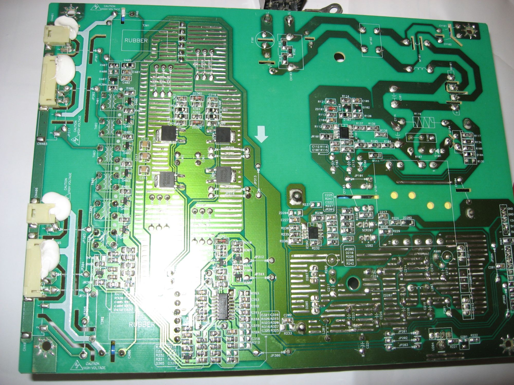

    Gateway 2100 powers up shows video than goes black I have replaced all caps but still no go. On the back of the board are 4 transistors 2 # BH 4214 (D405) and 2 # BE5G43 (D408) can someone tell me where I can find suitable replacements for these? and the spect. sheet

    Ok I did find the Data sheet for these mosfet They are Alpha & Omega transistors. The AOD408 is a 30v 18A N-Channel and the AOD405 is -30v -18A P-Channel The AOD408 is now AOD484 and is available from Digi-key but I cannot find the P-Channel AOD405 Is it necessary to match the data exactly What would be a suitable replacement and can someone suggest a Canadian supplier.

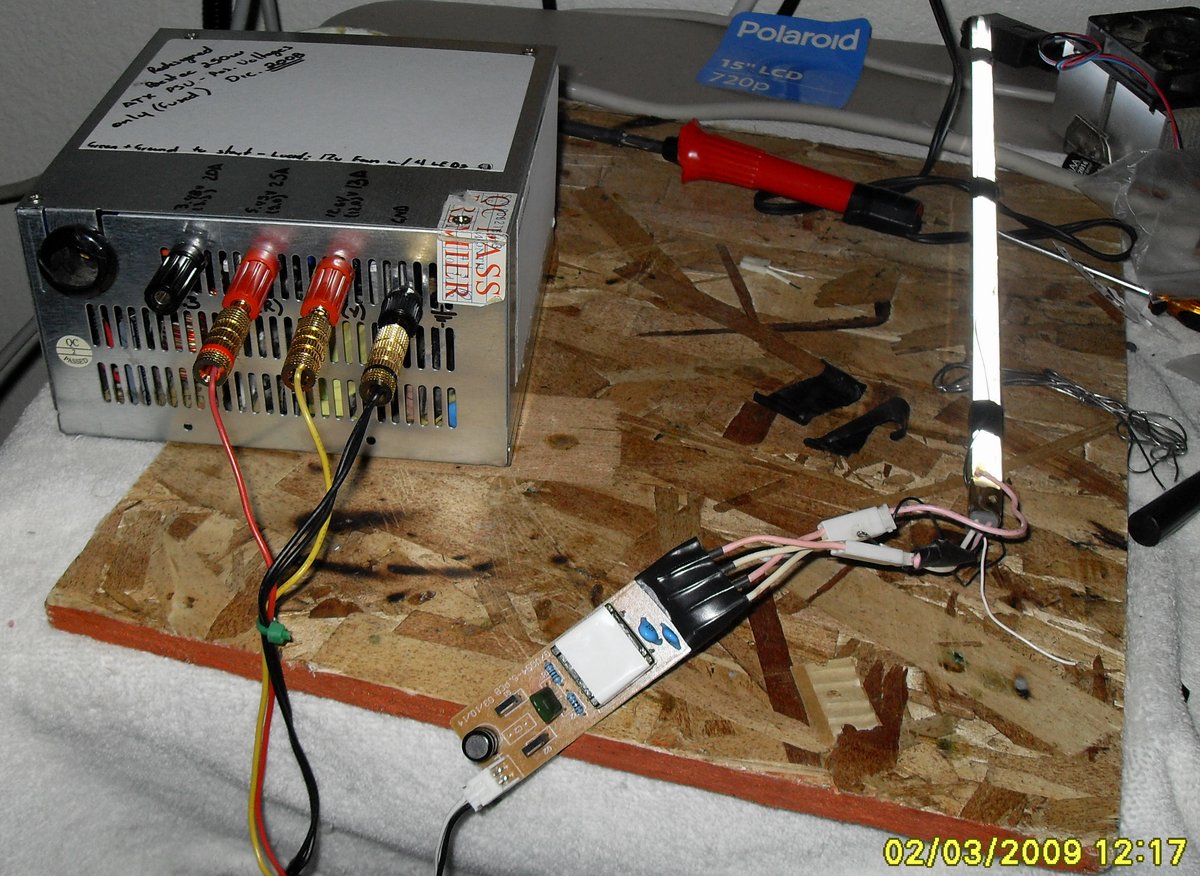

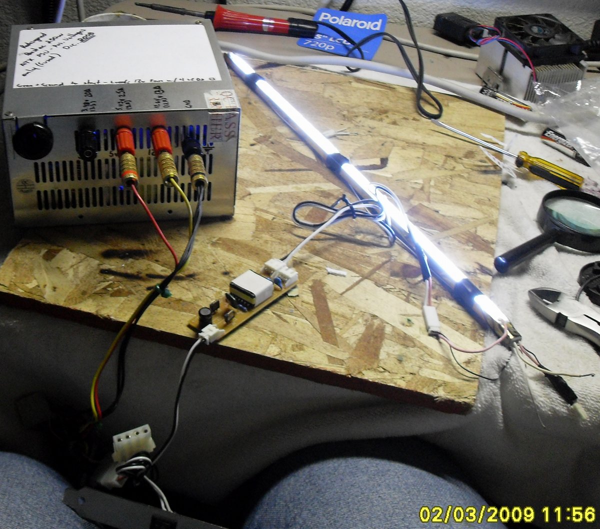

                  Well, I found myself in the same situation a while ago. Lucky (?) me, I had a pair of CCFLs from an LCD panel with a burned (melted, in fact) Power supply.
                  What I did? I took an inverter from a neon light kit for a PC (dual output), soldered the output connectors of the dead PSU/Inverter on it, and installed banana connectors in the input side of it. It has a switch so I can connect the lamps and then turn it on. Here are some pics. The last thing I did was put back the inverter circuit in its little plastic case and install the banana connectors (not shown) to use with my test supply. Before the test supply, I used a power adapter for external hard drives that had an output just like the molex connectors from an ATX PSU. That's how I test the lamps most of the time.
                  The removal of the lamps, is another story. It varies with the LCD Panel model, and sometimes it is easy, sometimes is not. Just be careful if you remove them, as they are fragile (very fragile)

                      Well. These pictures are from the project progress. Now I use it without removing the lamps. Almost all the panels I've seen have that narrow connector, but for those that don't, I have "adapters" built , again, from parts of dead panels. It might not be the best way to test lamps, but so far it has helped me a lot.
                      As for V and A ratings for the lamps, that is a really good question. I don't know.
