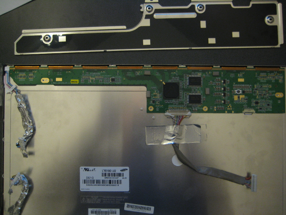

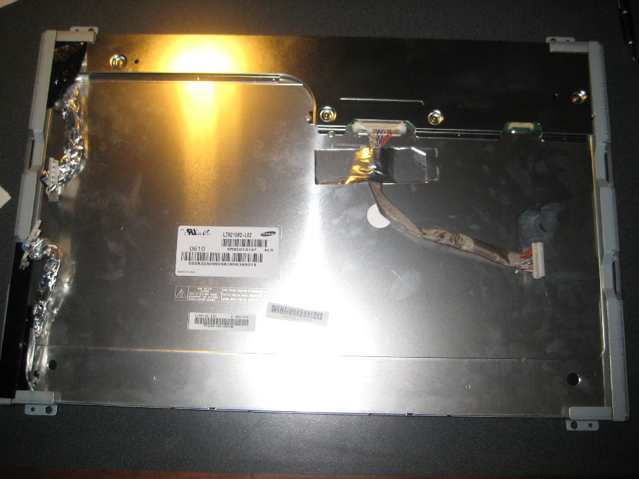

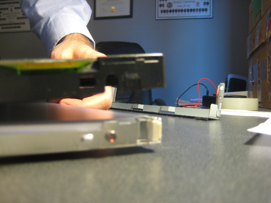

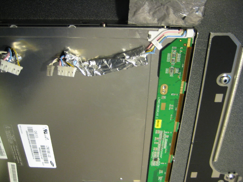

        1st pic is the back of the panel with the metal retaining clips still attached on the sides.
        Next pic is a close up of the leads going to an impossible to get to CCFL?
        I threw in one of the board in the LCD with absolutely no signs of issues and all solid state components.

          The first part is easy. The backlight circuit consists of four parts. The power supply, the logic board, the inverter, and the CCFLs. The logic board signals the inverter to turn the CCFLs on or off, and to adjust the brightness. The inverter has a pulse width modulated power controller which generates the drive pulses for the transistors that drive the transformers. The PWM controller also has logic to sense if all CCFLs are working properly. For about a second after the controller gets power it drives the CCFLs at full brightness. After that if any CCFL is drawing too much or too little power the controller will shut all of them down. Your tests established that the inverter, logic board, and power supply were all good. That doesn't leave much.
          The pictures look somewhat familiar. Take a look at the two pictures in this thread.
          By any chance are there two screws at each side of the FRONT of the panel?
          The LTM213 panel I have is made as a 'shadow box'. There is a metal frame that covers the sides. and has a lip that wraps around the front. There is a plastic frame that drops into the metal frame. The metal frame has 4 slots on each side (my second picture shows some of them). The plastic frame has 4 'catches' on each side that slip into the slots when it is pushed into the metal frame, plus it is held in place by the four screws I mentioned earlier.
          The trick is to release the plastic catches from the metal slots. I used some very high tech tools to do this. I had a flat tip screwdriver with a blade about 3/8" wide. By placing the screwdriver on top of the catch and twisting it gently I was able to force the metal frame out past the end of the catch. Then to prevent it from dropping back in I used the other high-tech tool - toothpicks. I placed them between the metal frame and the plastic frame.
          Work carefully, you don't want to damage the flexible circuit strip, nor pull it free. I would force each side out in two steps.

            You mentioned you have several units of that model. That means you have several sets of CCFLs to test with.Why don't you just take a good lamp and test each one of the CCFL outputs using the good lamp until you find the faulty one?
            As for the removal, you must first get off the front metal frame. That will leave you in front of a black plastic frame that covers the CCFLs and is at the same time, the base for the actual TFT panel and the cover for the diffusion sheets. Sometimes the CCFL channel is attached using aluminum tape. You must cut the tape before you can get the CCFL rail out.

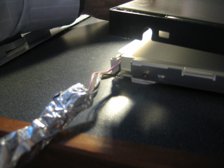

                I understand very much getting out of a comfort zone. What I would do would be to rig up extension leads so you can use a CCFL in the cracked monitor to substitute for each one in turn in the good monitor. Remember, the controller checks each individual CCFL.
                Once you have satisfied yourself that there is a bad CCFL you can tear down the cracked screen. The very worst thing that can happen is that you manage to drop it on your foot while your wife is watching and break every CCFL. The most likely thing to happen is you will say 'Heck, that's not too hard'.

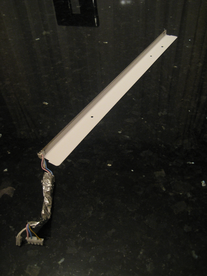

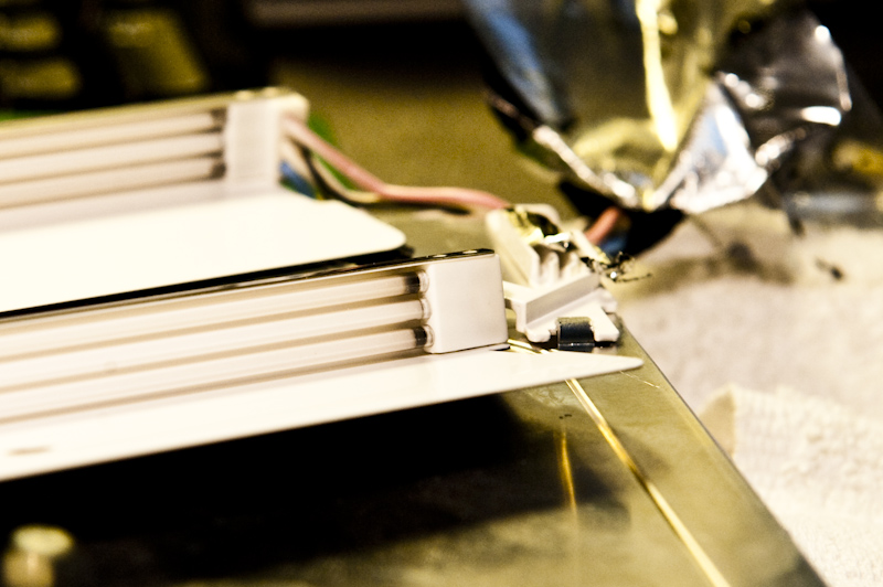

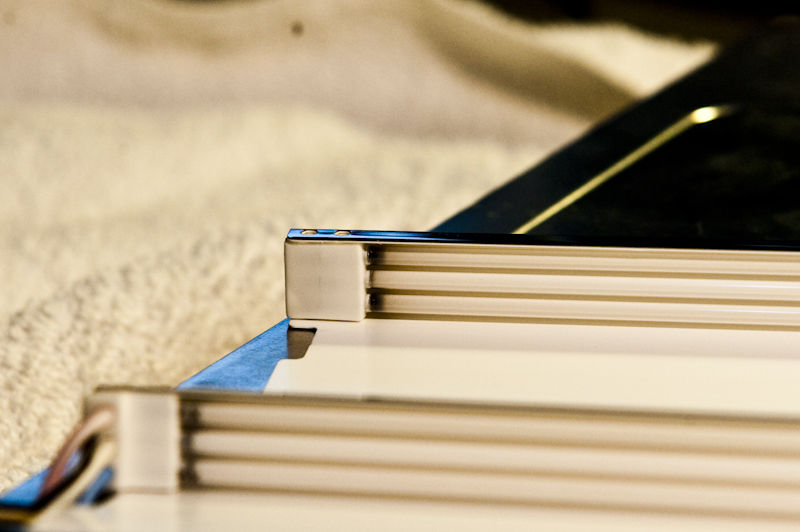

                  ok...so I took the metal casing off the panel and gently pried up the plastic casing which is somewhat apart. I can see that one bulb goes all the way across the top and the other all the way across the bottom. However, they are enclosed in what could best be described as a J channel where the entire back plane is attached. The wires run on top of this channel and the ends appear to be a rubbery material with a couple clips holding it in. I can't see how to remove this without taking the LCD glass itself out!

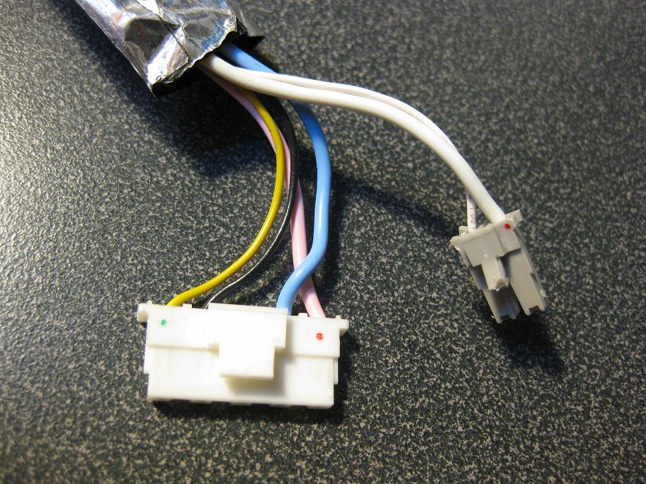

                  My point and shoot digital doesn't make it easy to get good photos but I have tried to show both ends of one of the bulbs.

                    On the panel I have dissected there are two 'cartridges' that hold the lamps, one at the top of the panel, one at the bottom. Each 'cartridge' is a three sided channel with three lamps side by side. The ends of the lamps are imbedded in rubber. One end of the 'cartridge' has a metal tab that fastens to the frame with a tiny screw. Once the screw is removed the entire 'cartridge' can be pulled out the side of the panel. lamps can be changed and the 'cartridge reinserted.

                      I wrestled with it and don't think that I did the proper way but I changed the bulbs. A couple in the bank of three were definitely blown. I didn't get a chance to re-assemble everything. I will update when I get some time tomorrow evening.

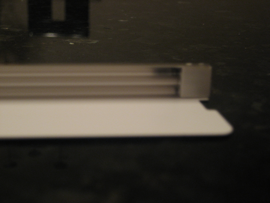

                        Ok so I wasn't ready to sleep after hockey and I only have a full day of meetings tomorrow so why not finish this up?
                        It turns out one of the CCFL bulb banks was blown. I replaced it with a functioning one from my monitor with a cracked screen and voila...works like a charm. I now have a bit of a hum in both of my monitors so I am wondering if I have a cold solder somewhere. Right now they work and I'm happy so I'm going to leave it until I can get my hands on another project.

                          That's weird...my pictures didn't go. I thought I would post a pic of the blown bulb so that others have an idea what this thing looks like. I'm really learning that I either need to get a better camera or better lighting because the bluriness has nothing to do with beer!

                            Yup, looks similar to what I have. Looks like the design is evolving.
                            See!!! I told you that you could do it!!

                                  I forgot to add that the Blue/yellow and pink/black are the wire pairings for the two bulbs in the bigger connector. Be careful when testing since there is high voltage going to these. Turn the power off in between moving wires.
                                  When you find the faulty bulb (assuming there is only one), the monitor will light up and it will light the bulb that you are using to test.

                                      Ok, got to the bulbs, it was easier than I thought. 4 out of 6 seem to be broken. I will post more images in around 6 hours. Gotta leave now.

                                        Ok I'm back and can take post photos of my ccfl's
                                        I take those dark endings as burns, do I still have to test them or can I just take that as a regular sign of malfunction? they look burned but what do I know about cold cfl's right?

                                          anyway. I connected the lights without the screen to see them light up, to my surprise all 6 light up, there is noise when they work and the light is very violet from all six of them, I expected a shower of bright white light and all I got was this semi bright noisy violet/pink light.
                                          can somebody confirm whether these bulbs are really failing?
