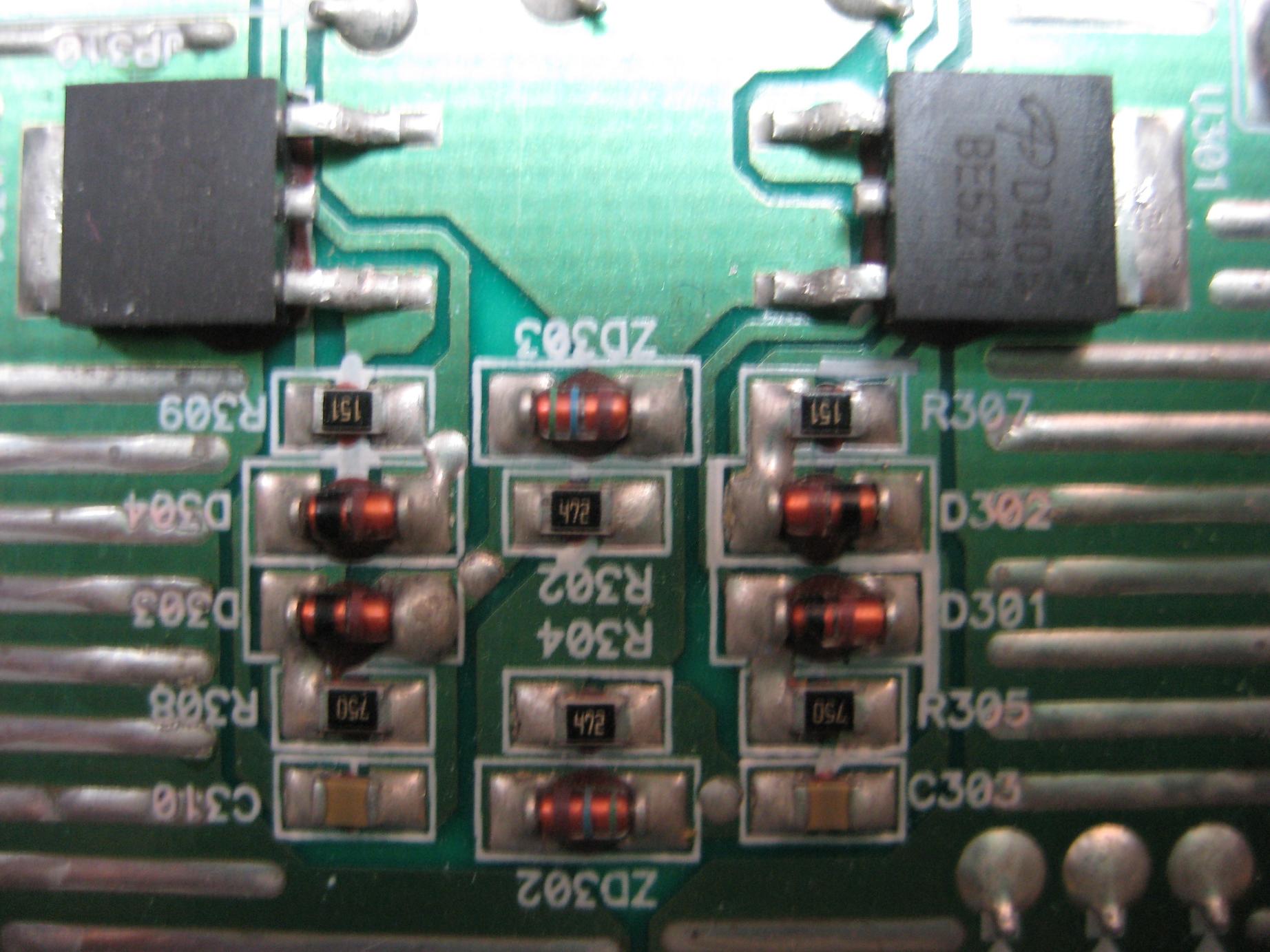

    The CCFLs are fine and I can confirm all other components are fine. I can swap this board with a known functioning board and everything is perfect. Therefore, I know that the problem is on this board but not entirely sure where.

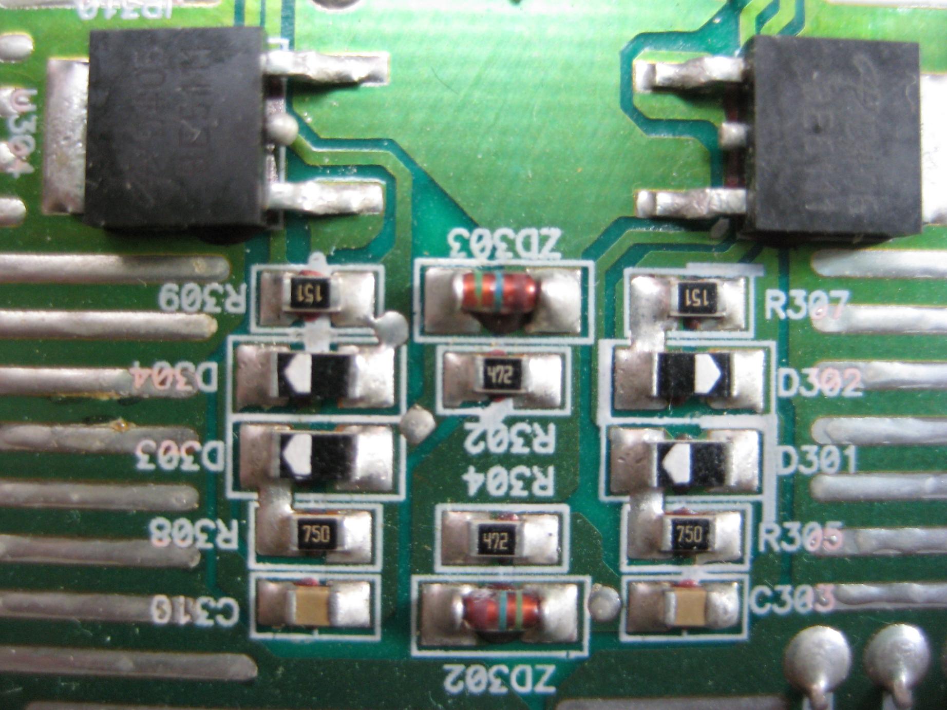

    I have included pics of the underside of this board with close ups of the primary and secondary windings as well as the 6 small transformers.
    By the way, so that I know what to look for in the future, what should I be looking for in the continuity and diode tests on the transistors?

      Thanks for reminding me of that. What can I say, my brain cells are dying. Fortunately there are a lot of younger, smarter people to back me up.

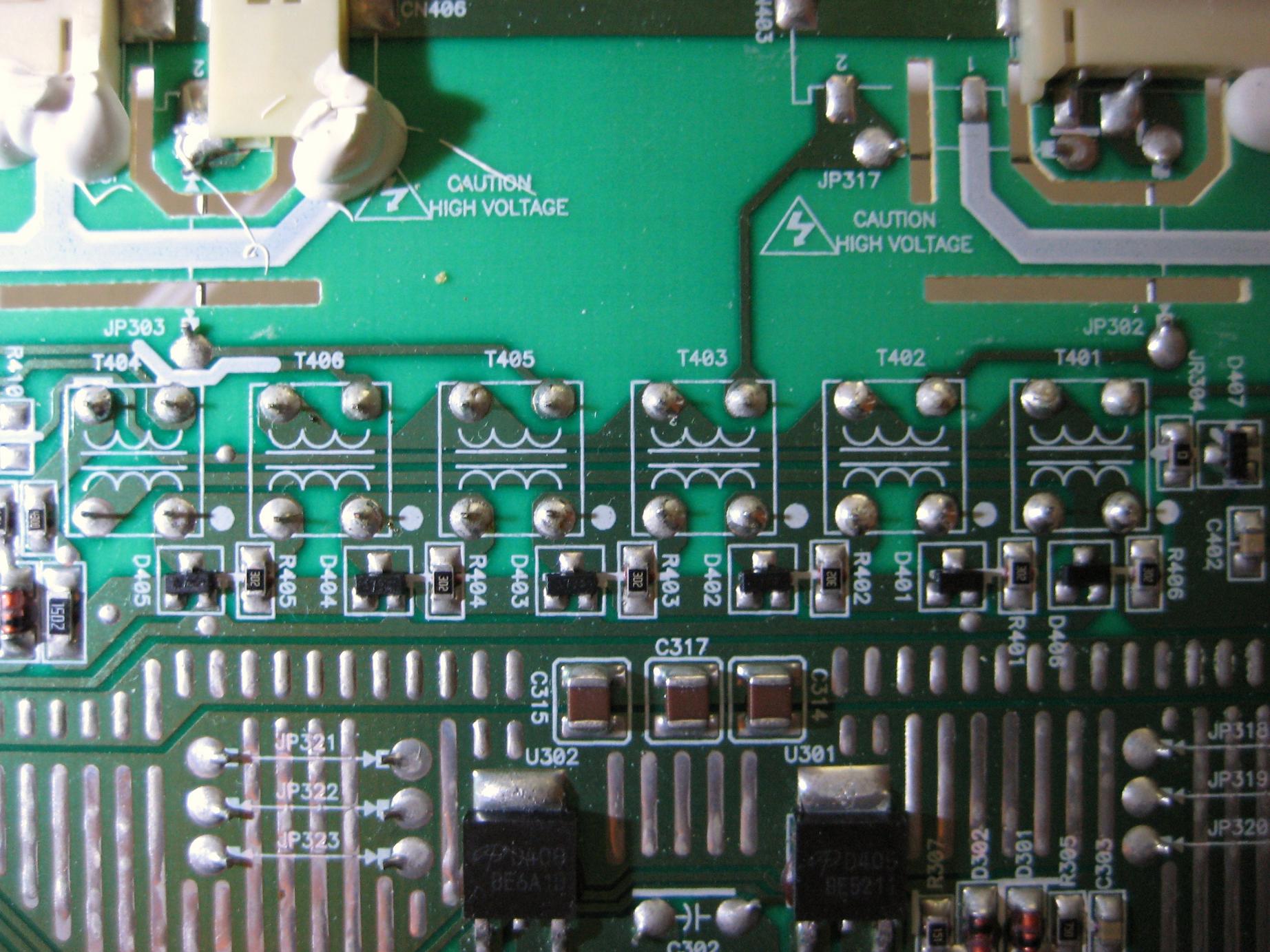

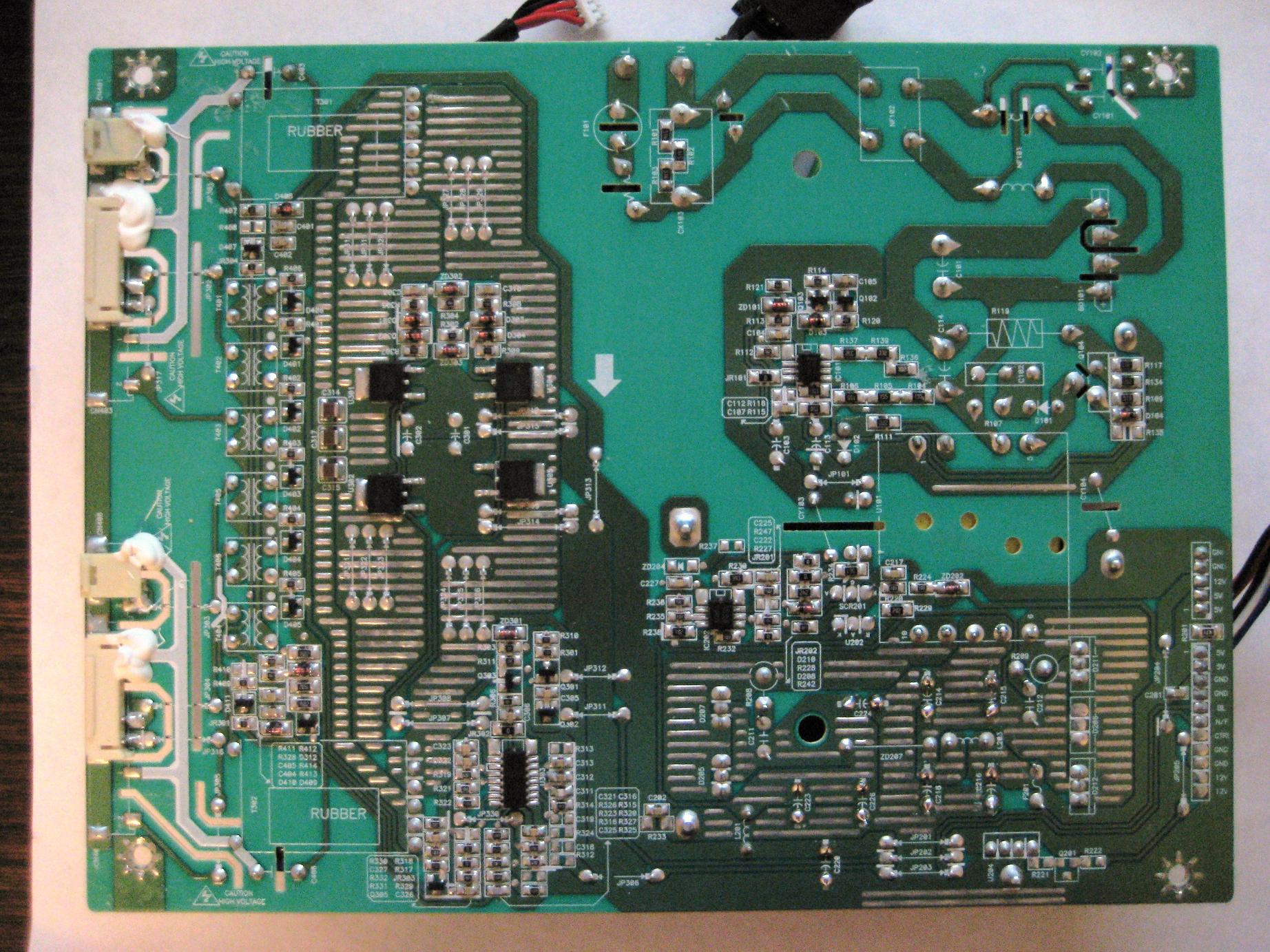

      Thanks. I've marked the picture up with a number of things for you to do. All of these can be done with the components on the board. The yellow circles are the outputs of the two transformers. Measure the resistance of each transformer.
      The red and black circles are the current sense transformers for each CCFL.
      Check the resistance of each transformer primary and secondary (I forgot to mark the secondaries).
      Measure the voltage from red to black on each transformer while the backlights are on. (The terminals circled in black seem to be connected together, so if you prefer, choose just one of them.)
      If you are having problems getting readings in the brief time the backlights are on, give me the part number of the IC circled in dark blue. This is the inverter controller and it may be possible to fool it to believe everything is good long enough to take your readings.

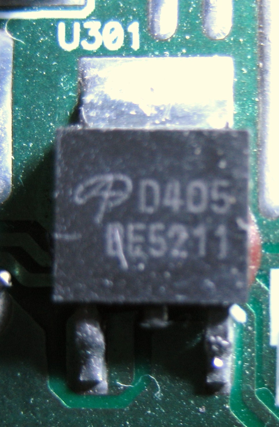

      I was operating on the assumption that they are bipolar transistors. This may not be true, more on that later.
      A bipolar transistor can be modeled as two diodes with either the anode or cathode connected together. The resistance function of most DMMs are designed to use a very low voltage so as to not cause any diodes to conduct. By measuring the resistance between each terminal of a transistor you can determine if it is shorted. Typically a short will be under 10 ohms, a 'good' transistor should show over 100 ohms. (There are exceptions when making measurements in circuit, chiefly if the transistor is directly coupled to a transformer. This circuit uses 3 capacitors so that is not an issue.)
      By switching to a diode test function and measuring the voltage drop across the leads of a transistor in all directions b-c, c-b, b-e, e-b, c-e, e-c you should get a voltage approximating a diode drop for only two combinations. Again, this is not a perfect test, but the combination of the two tests should identify any shorted transistors and any transistor that has an open junction.
      After some reflection, I realized I am not sure how the transistors are connected, nor if they really are bipolar transistors. To that end, I have circled them in baby blue. What are the part numbers?

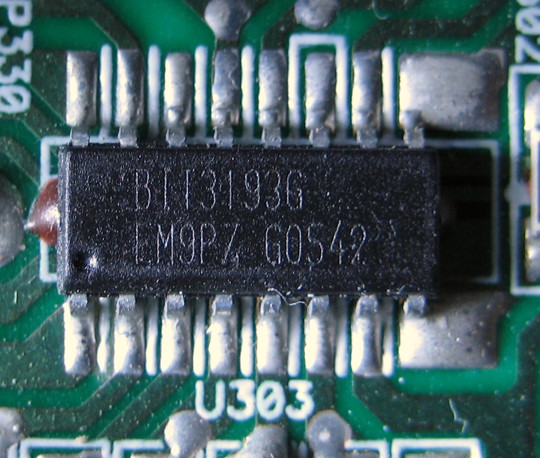

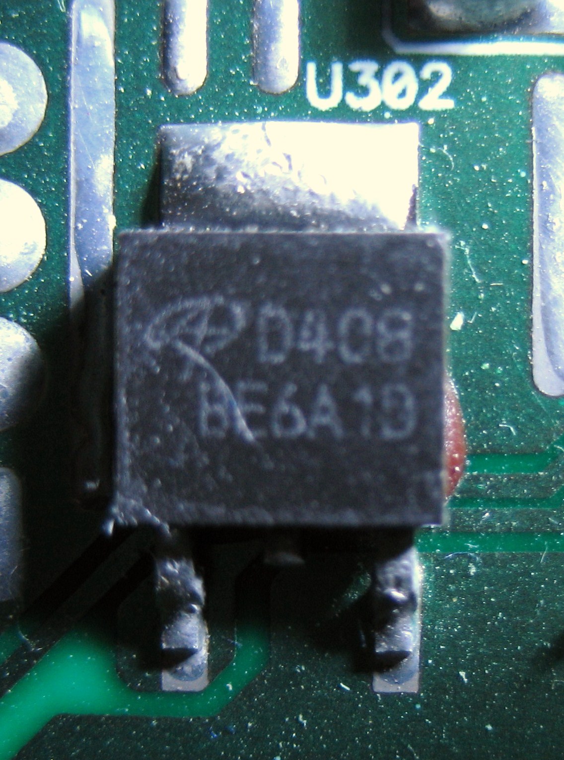

        I will try the current sense transformers soon. In the meantime, the transistor codes are:
        U301/U304 = D405 BE5211
        U302/U305 = D408 BE6A1D
        U303 = B113193G 1MP7 G0542
          #64

          ok...I am using DC which I expect is right measuring with my leads matching your colors.
          T401 ~ 0.25VDC before shutting off
          T402 ~ 0.25VDC before shutting off
          T403 ~ 0.25VDC before shutting off
          T405 --> this kind of does nothing and then makes my DMM go crazy...what does this mean?
          T406 --> similar to T405
          T404 --> similar to T405
          I am assuming that this means that something is up with the transformer at the bottom of the picture that feeds this side?!?
              Sorry, I wasn't explicit. I want this measurement done using the AC ranges. However, this has me very puzzled. Obviously, something different is happening on the two halves. Your idea has merit, but let's make sure we know which side is bad.
              I've circled a point above the upper transformer in yellow, and a spot just below it in white. Another spot below the lower transformer has also been circled in yellow. Using the AC volts scale, measure the voltage from the upper yellow spot to the white spot while the backlights are working. Repeat for the lower yellow spot to the white spot.
              More later; I'm also playing plumber today AND fighting with both the post office and a doctor's office. It would be nice to succeed at least one of the above.

                Pin 14 gets to ~0.25VDC before the backlight goes off
                Pin 15 gets to ~0.056VDC before the backlight is off ******
                Pin 5 gets to ~1.5VDC until the backlight shuts off but then climbs to 3.89VDC...it drops back to zero when the panel switches in to standby.
                I am a chemical engineer that dabbles in electrical projects so bear with me if I get some of the fundamentals backwards. I read that the pin out is labelled from the dent and around but I have included a picture so that you know for sure which pins I tested.
                  PlainBill
                  For the transformers, with my common lead on yellow and my other lead on white with the DMM on AC, I get a reaction but the voltage is still 0.00xx VAC as it moves so I'm not sure what that tells us.

                    I have re-done these measurements with AC scale again with my common lead on black.
                    For all of these, it messes up my display on the DMM until the backlight shuts off and then scales down. I repeated multiple times for each transformer and sometimes the scale would hit 2.5VAC, sometimes OL but most often jibberish and other random stuff like changing units etc.

                      Your numbering is correct. The dot is pin 1, then counterclockwise around the chip. Next, I'm guessing here, but it may be that your DMM is slow to respond to changing signals. When the BIT3193G starts up the voltage at pin 5 rises slowly. The protection logic isn't enabled until the voltage at pin 5 gets over 2.5 volts.
                      The fact that the voltage at pin 15 is so low indicates the controller is shutting down because the current isn't going high enough. I'll try to figure out how to determine which set of outputs is causing the problem.
                      By any chance do you have a spare CCFL around (even one in a panel) that you can hook up to this controller. It would appear that one transformer may not be outputting anything, but I would like to verify that; the voltage readings aren't telling me.

                          Using an analog meter, the yellow/white dot test on the transformer with the meter set to AC has no reaction in either direction.
                          For the current sense transformers, I get the following with my analog meter:
                          T401 = 100VAC
                          T402 = 220VAC
                          T403 = 125VAC
                          T405 = 125VAC
                          T406 = 125VAC
                          T404 = 150VAC
                          For the IC, I can't get the analog meter to show any DC voltage for pin 14, 15, 5.

                            That reading for T402 looks VERY high - nearly twice the others. Try substituting a known good CCFL for the one hooked to that transformer.
