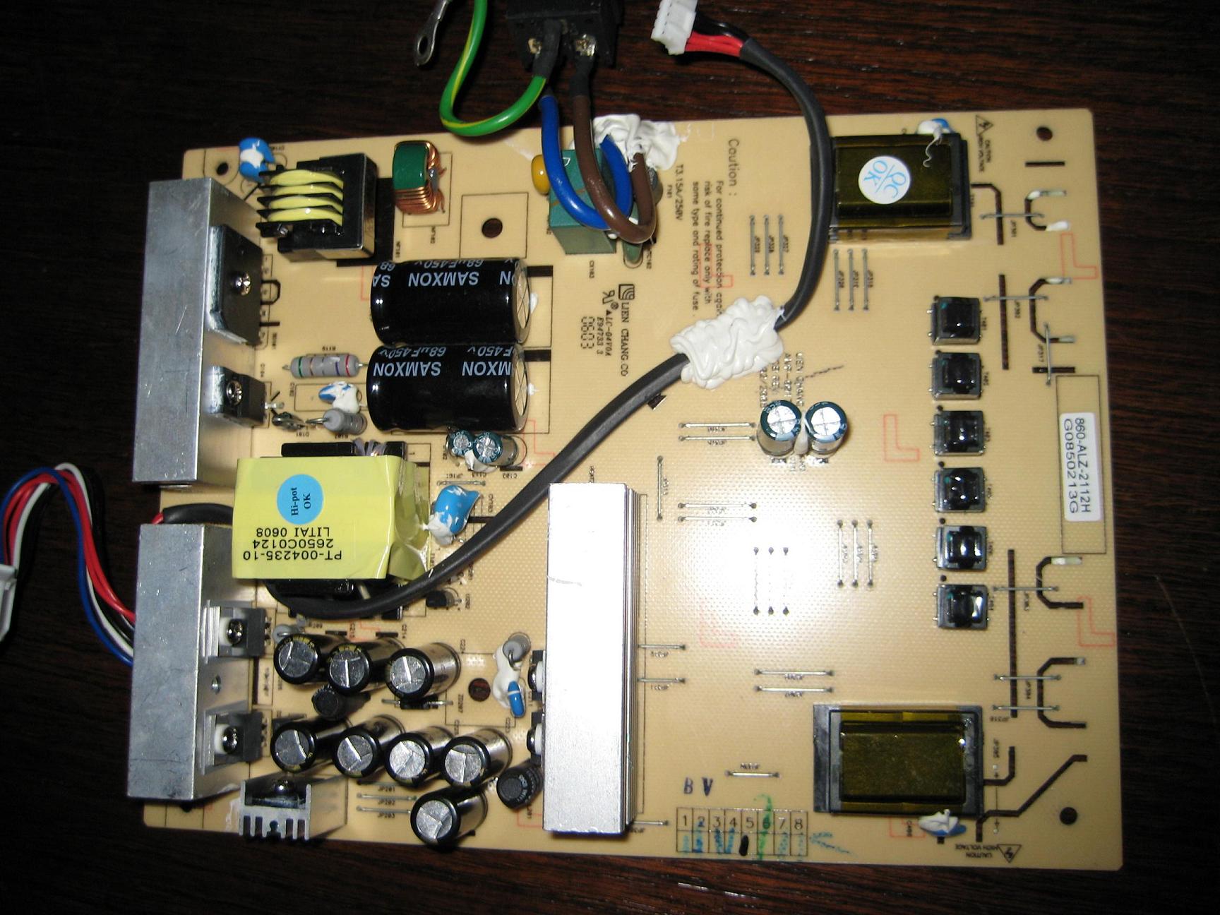

                            Since we seem to have a decent thread going on this model, I thought that I would post my new problem in the same thread.
                            I acquired yet another one of these monitors and I have isolated the issue of the monitor not coming on to the power board. Although the 470uF 25V capacitors didn't look bad, they have been the culprit with the other monitors of this type that I have saved.
                            So, I replaced them with Panasonic FM series capacitors (as I have done before) but the monitor still doesn't stay on. It does the on for 2 seconds then power off routine.
                            There is someone that has suggested that the transistors are an issue but I'm not completely sure how to test them. I have an identical functioning power board on my desk with this one so if you can guide me to what I should check next, I would appreciate the guidance.
                              #54
                              Re: Gateway 2100
                              That statement is ambiguous, we need more information. Does the power LED stay on, but the display go blank? In that case, you are looking at an inverter shut down issue, sometimes referred to as the 'two seconds to black' problem. If the power LED also goes off, there is another issue.

                                Sorry about the lack of detail, I will try to be more concise. The LED stays on (blue) when the unit is powered up and then the display turns off.
                                I measured a couple of values but I don't know if they help.
                                N/F = 0.0 VDC when panel is off
                                N/F = 3.1 VDC when panel is on
                                BL = 1.5 VDC when panel is off
                                BL = 1.488 VDC when panel is on

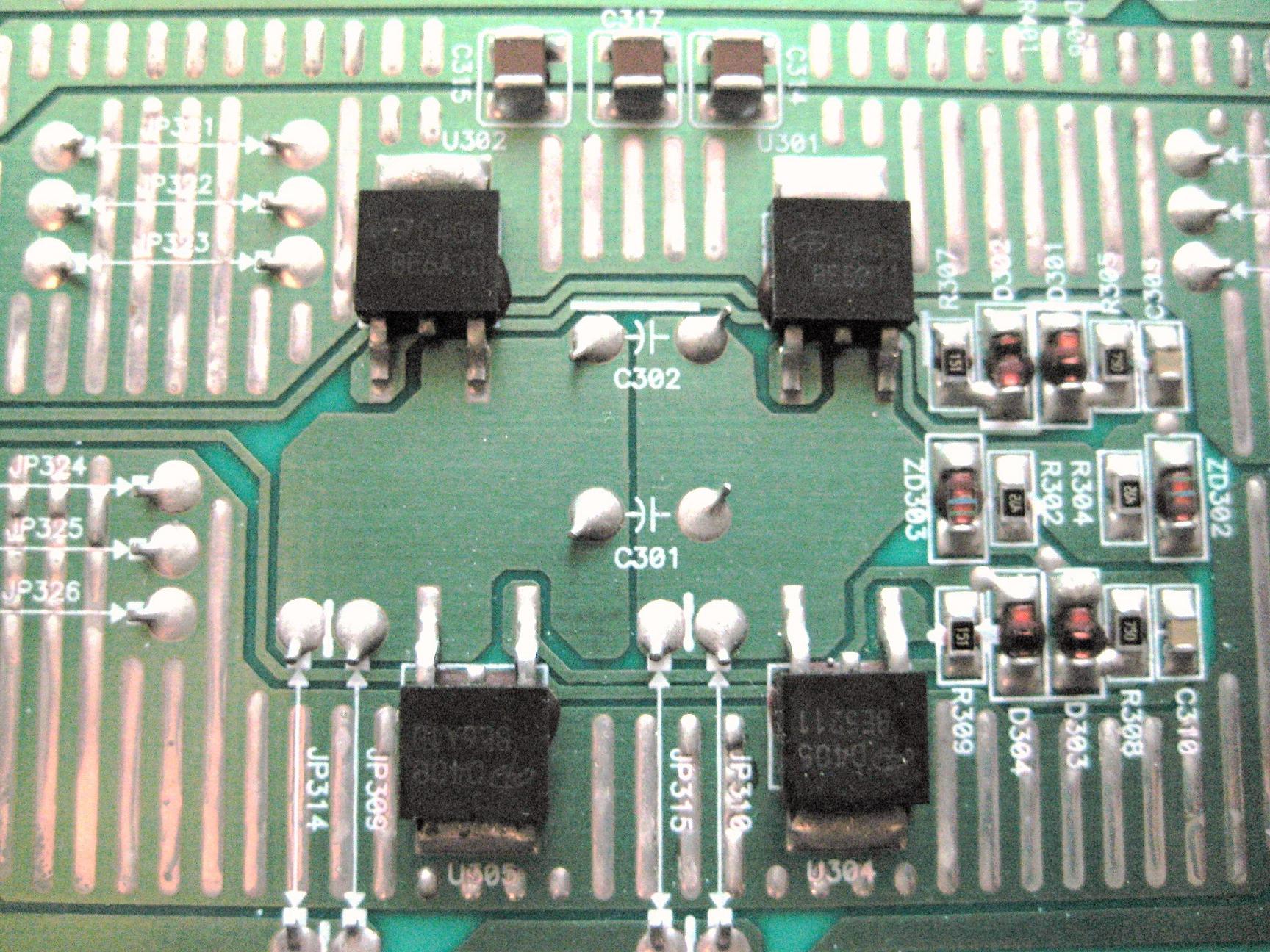

                                  Please double check the N/F voltage in the following states: Power LED on, backlights on; Power LED on, backlights off; Power LED off. I would expect to see it change voltage in synchronization with the power LED.
                                  There are two tests to perform on the transistors. Note that there are three leads on each transistor. For simplicity (and because I'm tired) we will assume the tab is pointing away from you, and will label the leads L (for left), T (for tab), and R (for right). It is not necessary to remove the transistors from the board for either of these tests.
                                  The first is a simple continuity test. Set the ohmmeter to the lowest resistance scale (typically 200 ohms). Measure the resistance between each combination of leads on each transistor. The orientation of the meter leads is not important. You should wind up with a table that looks like this.
                                  L - T T - R L - R
                                  U301
                                  U302
                                  U304
                                  U305
                                  If any reading is less than 20 ohms it is not necessary to perform the second test. Simply post your results.
                                  Now we are looking for bad junctions. Set the meter on the diode test scale. For the following tests, the black meter lead goes on the first lead, the red lead on the second.
                                  L - T L - R T - L T - R R - L R - T
                                  U301
                                  U302
                                  U304
                                  U305
                                  PlainBill

                                    As for N/F, my notes were correct. When the panel is off, it reads 0.0VDC, when the panel is on (with backlights on) it reads 3.1 VDC, then the panel goes black (blue LED remains blue) and the value still reads 3.1 VDC. After about 30 seconds the panel goes in to standby (when I don't have a video source connected) and the voltage eventually starts dropping back to 0.0VDC.
                                    As for the transistors, I have tabulated per your suggestions (for some reason my formatting is all lost but hopefully you get the idea.
                                    Continuity Test
                                    L-T T-R L-R
                                    U301 OL OL OL
                                    U302 OL OL OL
                                    U304 OL OL OL
                                    U305 OL OL OL
                                    Bad Junctions
                                    L-T T-R L-R
                                    U301 OL OL OL
                                    U302 OL 0.488 0.643
                                    U304 OL OL OL
                                    U305 OL 0.486 0.642
                                    Note that for the T-R readings of U301 and U304 under the diode test, they were not immediately OL. They started about 0.5VDC and climbed over a couple seconds to OL.

                                        I have re-done the diode test and copied the order exactly (sorry about the lack of attention) and posted the results below:
                                        Bad Junctions
                                        L-T L-R T-L T-R R-L R-T
                                        U301 OL OL OL OL 0.697 0.507
                                        U302 OL 0.641 OL 0.472 OL OL
                                        U304 OL OL OL OL 0.695 0.506
                                        U305 OL 0.639 OL 0.468 OL OL

                                          It's a crude test, but the transistors seem to be good.
                                          There are several other possibilities. A shorted or open transformer would do this. And a bad CCFL or problem with the wiring would do it. And lastly, a bad component in the current sense or OVP circuitry would do it.
                                          A picture of the bottom of the inverter would be a big help.
