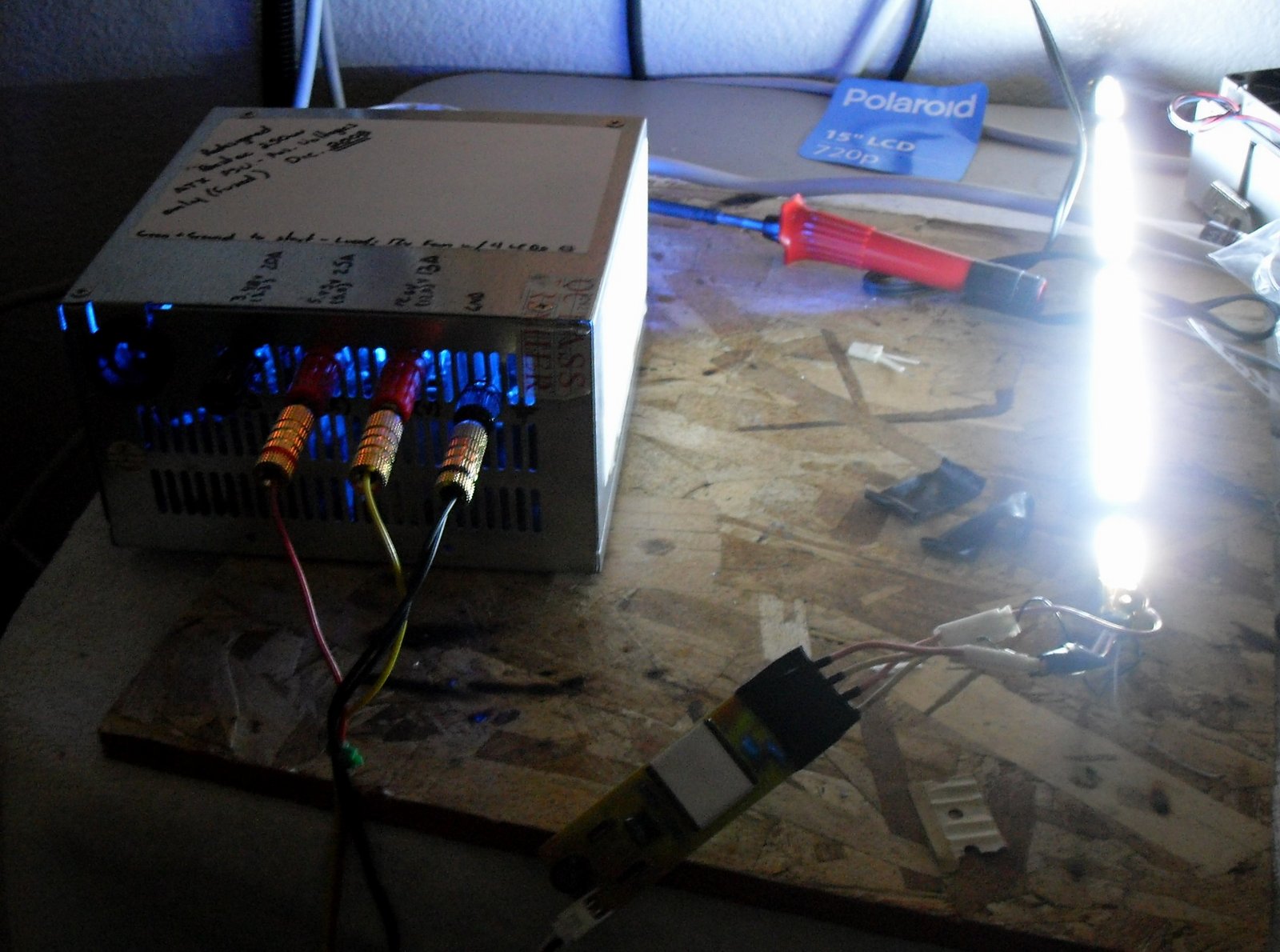

What I did? I took an inverter from a neon light kit for a PC (dual output), soldered the output connectors of the dead PSU/Inverter on it, and installed banana connectors in the input side of it. It has a switch so I can connect the lamps and then turn it on. Here are some pics. The last thing I did was put back the inverter circuit in its little plastic case and install the banana connectors (not shown) to use with my test supply. Before the test supply, I used a power adapter for external hard drives that had an output just like the molex connectors from an ATX PSU. That's how I test the lamps most of the time.
The removal of the lamps, is another story. It varies with the LCD Panel model, and sometimes it is easy, sometimes is not. Just be careful if you remove them, as they are fragile (very fragile)Last edited by EGuevarae; 02-12-2009, 10:44 AM.There are 10 kind of people in this world: those that understand binary, and those who don't.- ASUS ROG Maximus IX Code

Originally posted by eguevaraeWell, I found myself in the same situation a while ago. Lucky (?) me, I had a pair of CCFLs from an LCD panel with a burned (melted, in fact) Power supply.
The removal of the lamps, is another story. It varies with the LCD Panel model, and sometimes it is easy, sometimes is not. Just be careful if you remove them, as they are fragile (very fragile)Comment

Originally posted by davgVery creative my friend good job. What kind of voltage and amperage do these ccfl require? There must be some way to test them without removing them? Connectors is another issue of course these are different than the ones in a known good screen just my luck.
As for V and A ratings for the lamps, that is a really good question. I don't know.There are 10 kind of people in this world: those that understand binary, and those who don't.- ASUS ROG Maximus IX Code

Voltage is like 800-1800 VAC, usually in the 30-60 kHz range.
Amps though is only like 5 mA.
