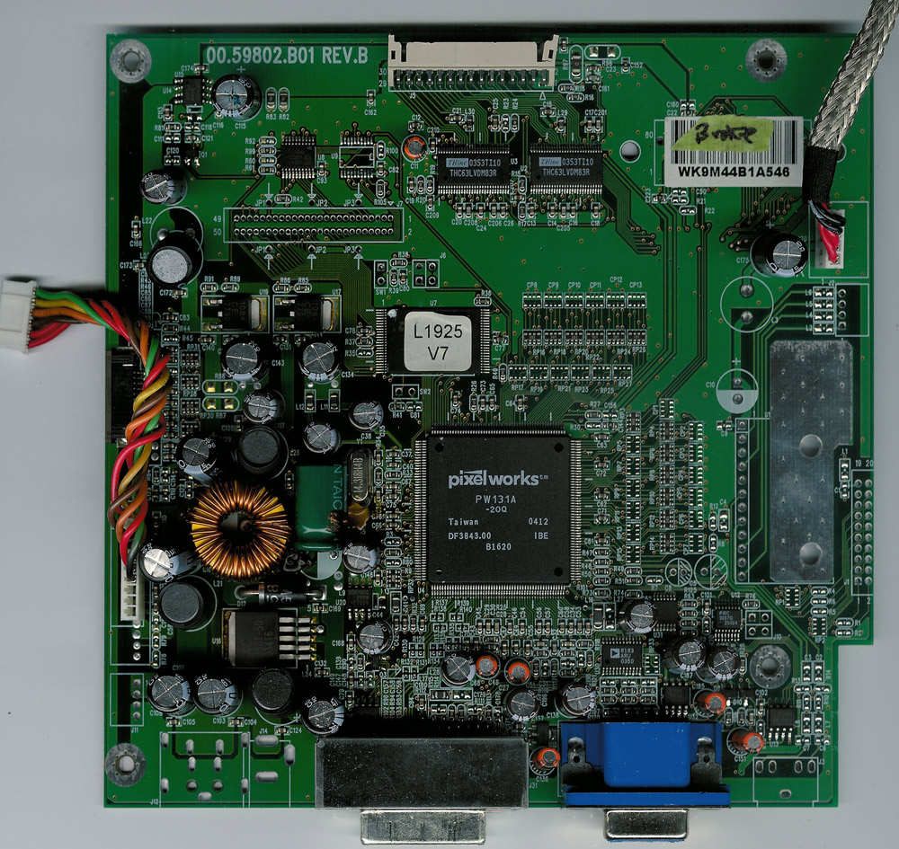

    I have an HP L1925 LCD monitor that has a Video Input Logic Board (00.59802.B01 REV.B) with a pixelworks PW131A-20Q chip that won't power on. I verified all the other parts to the monitor work with a known-good logic board. It looks as though the power from the PSU of the monitor flows through this board and then onto the power inverter to power the display.
    My biggest question is, see the huge green capacitor that says "TAICON" on it? (Left of the pixel works chip) Visually, it has a lot of gewy crud all over it-- is that putty just to hold the capacitor in place, or is it actually blown? Do capacitors blow like that?

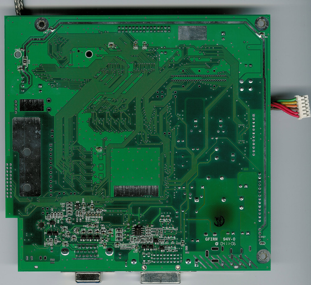

    What's more, could that be the cause of the blowout burned mark on the bottom left of the back of the board, directly opposite the AC 1501-50 03013 chip (that has 5 pinouts)? My guess is that chip blew, but WHY did it blow? Would replacing this chip just cause it to blow out again?
    Just make sure that that 1501-50 ( I guess that is the number on the chip, 'cause I coudn't figure out anything from the pic, as it is too dark) does not end like this one I tried to remove from a dead board (I have a eMachines E15T3g with that chip shot)
    And as a reference take the board from your other 1925 thread. It does not look like the one on this one. You can change the cap if in doubt, just to test (either for the one in the other board or a completely different one). Also, look up the chip in alldatasheet.com and see if the IC is shot or not. Mine is short from pin 3 - GND- to 5. The other one (the "naked", from the pic) was not.
    Also, what brand/series are the other caps?

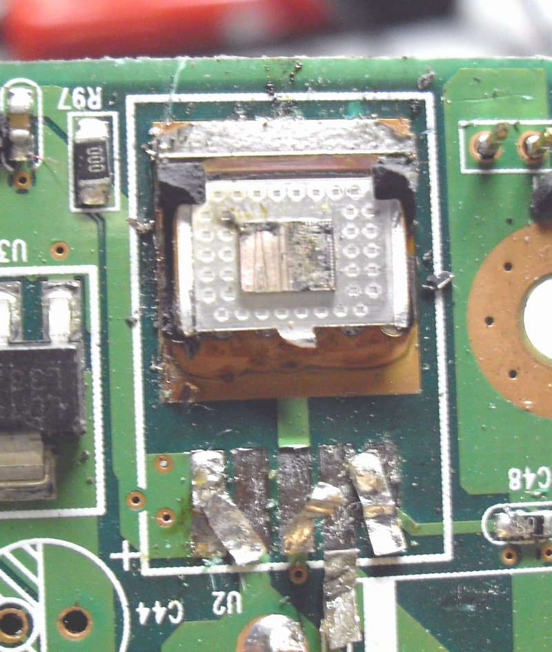

      I found the datasheet for the 1501-50 chip (attached). Can I
      test this on-board or do I have to desolder it first in order to properly
      test it with a multimeter?
      Also, is it even possible to remove these chips? What if they are glued on (see previous post)? Does anybody know of a good way to unseat these chips for transplant onto other boards?

        Unlike my other board, this one is 100% TAICON caps.
          Re: HP L1925 Video Input Logic Board won't power on
          Replace them.

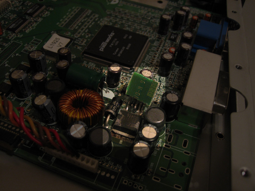

            Ok, I just replaced the 4 suspected "bad" caps, and each circled tap still registers as shorted. I tested the "bad" caps once out, and they all seem to hold charges. So, it turns out that it wasn't a cap problem at all, and I'm still left with a bad monitor that won't accept a signal. What else can I try?

              Have you checked the 1501-50 chip? It could have gone bad because of the caps or a surge in the PSU or just because he wanted to . The E15T3g I was messing with has this IC bad, and everything else seems to be OK. The monitor is dead because of that IC.
              How I found out it was bad (why I tested it)? I started following the (+) pin from the DC in (in your case, the connector from the PSU) and traced the voltage up to that point. It reached the IC and it disappeared. Then I took the number on the IC, found out what it was, and tested.Shorted on 3-5, and then I checked the (now naked and useless) other one, and they didn't do the same, so I concluded that t was bad. Apply power to the board, and follow the V until it is lost. See if it varies along the path (I've seen 12, 5 & 3.3 on logic boards. Dunno if they are more Voltages used in that cards). If you follow a 12v path and end up suddenly with 17 or 7v, then something is wrong.
              Maybe it is obvious for experienced electronics people but It is what I do and so far, it has helped me on many cases, monitors and not monitors....

                      I desoldered the old IC (1501) and ripped a good one from another board that I had (not wanting to spend the $4.50 digitech was going to charge me, so I took the PCB and all from the other board, I'll have to show you a pic). I turned the monitor on, and still nothing. No green light, no picture, nothing. I think I might have ripped up where the IC contacts the board (PCB). I can't tell where on the PCB the IC's contacts are connecting to (probably some inner layer of the PCB) so I think I killed that board. Oh well, no guts, no glory. In this case, I all I'm left with is guts.
                      BTW, I did also replace the suspected bad Green 1000uF 16v TAICON Capacitor with the donor board's cap. Out of the board, the suspected bad one still seemed to charge so now I'm thinking the IC was the only thing blown.
                      My advice next time, is to just spend the money and get a new one, if it's suspected bad. Don't try and use a donor board to give you one. It is impossible to remove (as demonstrated in post #2) and you will not only ruin the bad board you took it from, but you may also ruin the board you're trying to fix in the process.

                        I managed to do this finally (not that IC, another one, and not 5 pins, 8). It requires a fine tip soldering iron, lots of patience and a steady hand. But it can be done.

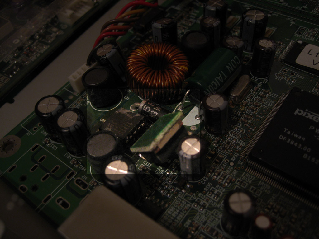

                            Here is the pic of my work, as you can see, it's poorly soldered onto the board where it needs to be. I don't think there's any saving this one.

                              I can't figure much from the pics (dark), but please tell me that you didn't rip the donor IC WITH THE PIECE OF BOARD STILL ATTACHED and soldered it on the board WITHOUT TAKING THE OTHER OFF.

                                Yep, I ripped the IC off of the other board with the board still attached! Why not? The IC doesn't need to be grounded, and as you saw, it is near impossible to remove from the board. So I just cut around it and it probably would have worked perfectly if I knew how to bend up the pins where the old IC is connected to the board without stripping the pins entirely off of the board (I know now how to do it, you have to hold the pin down with a flat-head screw driver, applying pressure onto the board where it is connected while bending the other sawed-off ends up at the same time).
                                If I ever get another board with this same problem, I'll try again and repost, but I'm out of luck for now.
