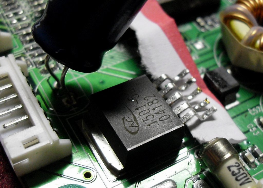

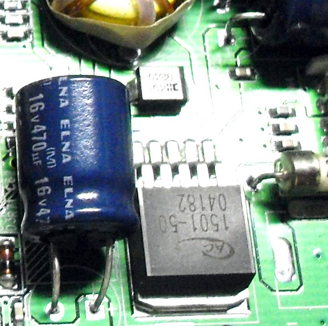

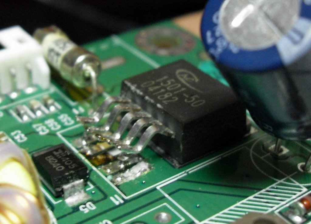

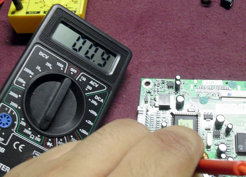

          As promised, pics and notes were pulled out from the Cold Cases Department, and here are the conclusion:
          My IC is, as far as I know, BAD , as it should not have continuity between pins 1 (V) and 3 (GND).
          How I arrived to that conclusion? Desoldering the 5 pins in both the bad and a good chip (see post #2 for a good example of something you should not do. Kids, don't try this at home ..... this is only for professional IC Killers... ). The pins measured 0.9 ohms between them, both ways. I have pics of before the test, close ups of the bad IC with the pins lifted and even a piece of paper between the pins and the circuit board. Obviously GND (Pin 3) was connected still, as it is the pad too, but the other 4 are/were not. I even had a pic of the reading, and the last pics are of the board as it was stored, still pins lifted. The one that was good and is now destroyed, didn't measure like that. I can't find the readings, maybe because I destroyed it and the readings were not important anymore. I know (well, I think) that there is more damage to the board, and that's the reason it is in the Cold Cases Container, until I get proficient enough to fix it (I have resolved one Cold case : The Proview 568, so this one has still hope ...).
          I don't know your particular case, but you can try to just lift (very carefully) the pins and test. Maybe your problem is different.
          I hope this helps.
