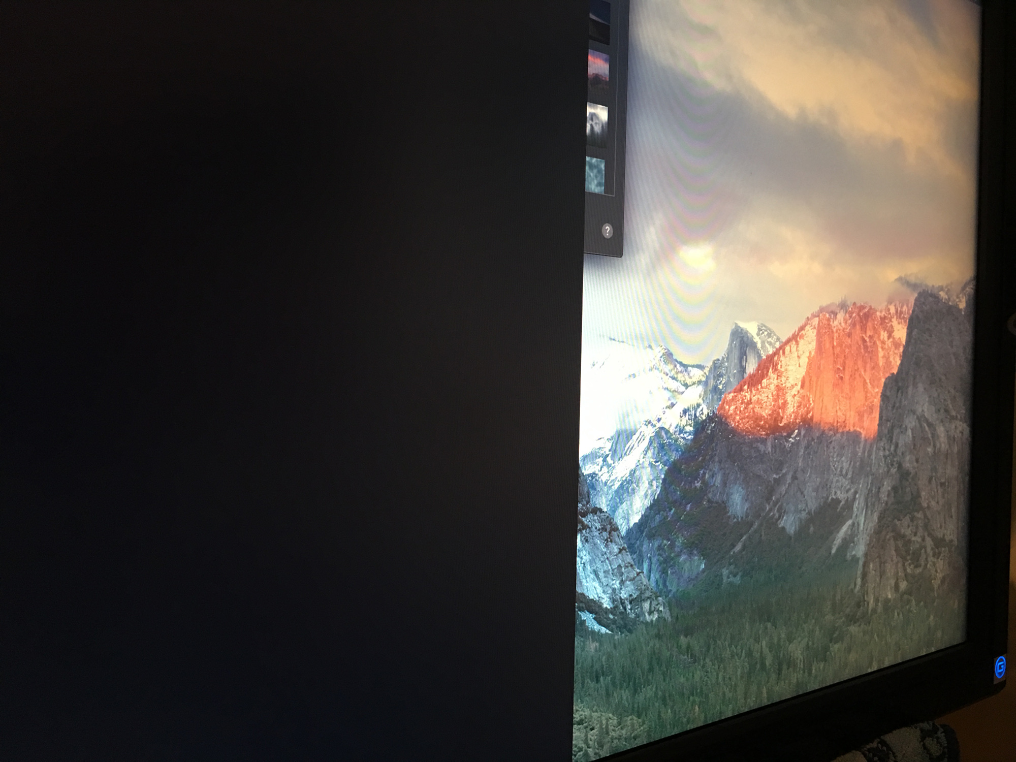

Another HannsG HG281D

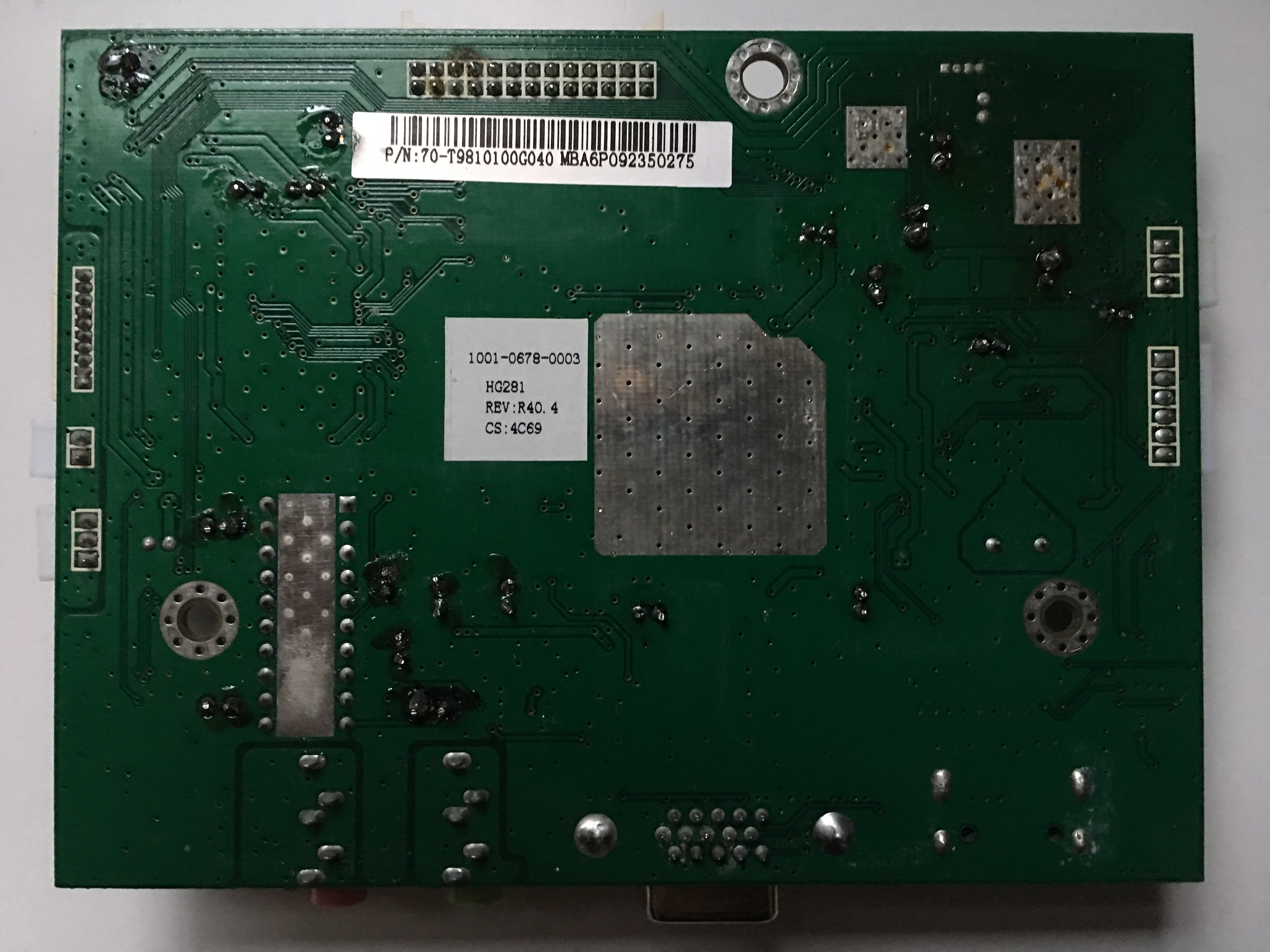

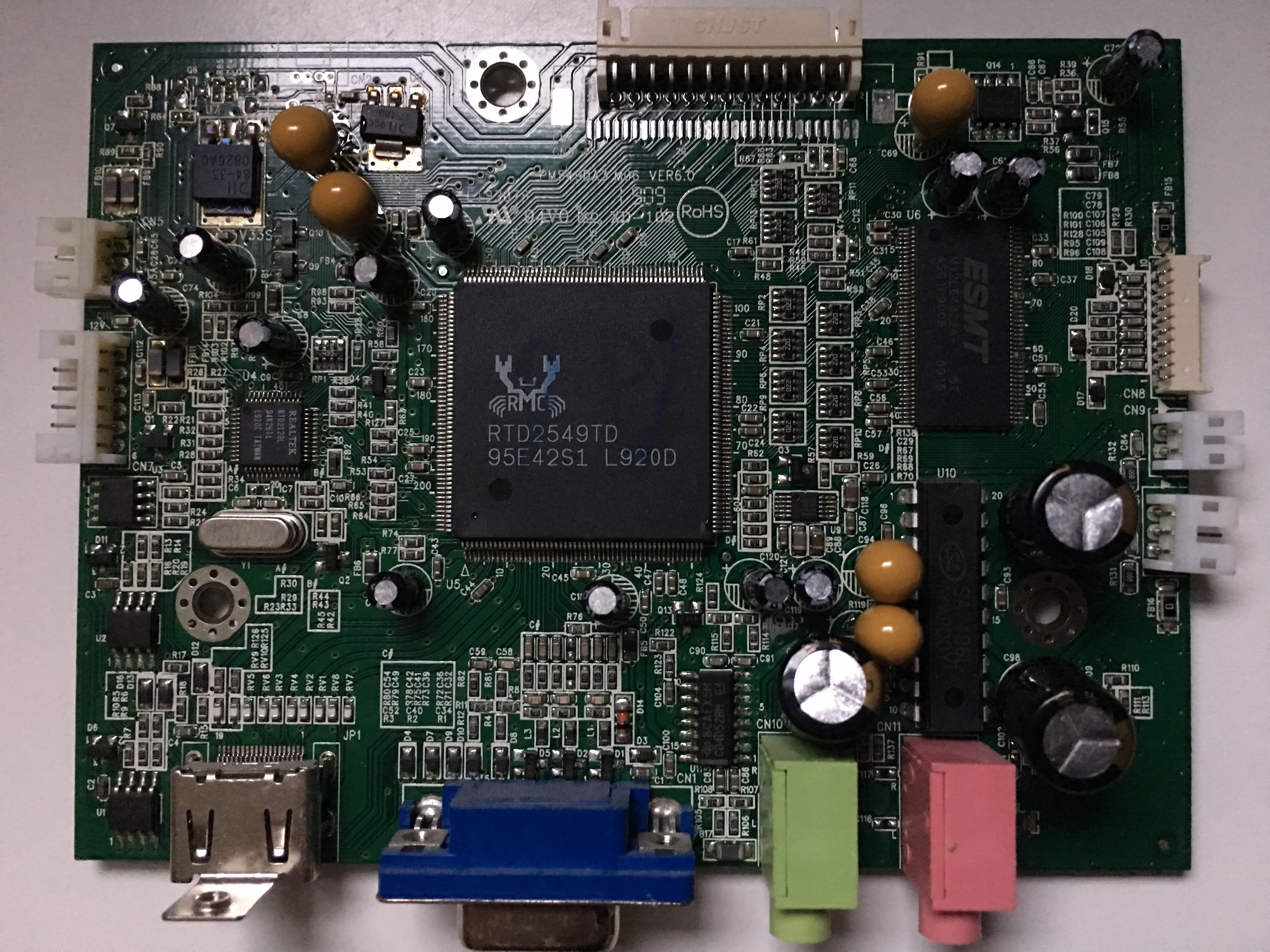

        Logic board PM549DA3 M06 VER6.0 images attached
        Q14 is a 9435GM P-channel enhancement-mode power MOSFET
        Q15 is a 2N70002K N-channel enhancement mode MOSFET
        Pins 1-3 are source, 4 is gate, 5-8 are drain
        I poked around some more with the multimeter while I had the logic board completely detached for the photo session.
        For Q14,
        LVDS pins marked 1-3 on the logic board (and go to F400 on the TCON) go to this drain
        drain to source is 558mV in diode mode
        No pins are shorted to ground, though gate sometimes looks like a capacitor charging (resistance quickly rises to infinity over a second or two)
        Q15
        gate is grounded, source to drain is 577mV in diode mode on the multimeter
        10.1kΩ between Q14 drain and source pins (1-3) of Q15
        There's > 2MΩ resistance between the +12V supply line and all pins of Q14 and Q15
        FB7 & FB8
        No resistance across each of them
        I get infinite resistance from each FB to source on Q14
        FB7 and FB8 both have 509Ω resistance to both source on Q15 and ground
        Q8 (obscured by C69 in the photo) is unpopulated
        Is gate being grounded on Q15 normal?
        Maybe the inductors feed Q15 which in turn feeds Q14?

          Originally posted by Capt. Cap
          FB7 & FB8
          That's a problem. I have never seen small ferrite beads like that read open-circuit. Some had resistance as high as 4-Ohms due to high inductance. But never open.
          Before concluding they are bad, try moving and poking harder at them with your multimeter probes. Sometimes SMD components have a layer of flux on top of them after being soldered at the factory. This can make readings appear open-circuit or high resistance until you poke and dig a little harder with your multimeter probes through the flux layer. Once you get through it, you should get an accurate reading. If they are still open circuit, they are definitely bad.
          If it was like that, then yes. Grounding the Gate of a MOSFET essentially turns it into a diode (due to the body-diode junction in MOSFETs).
          Could be. Though I don't see why the power going to the T-con would go through two switching devices. (Read: more losses) But there could still be a valid reason for that.

                                          Some more good news!
                                          I removed FB14 and soldered in some copper wire across it, and got a consistent image on the right side of the display.
                                          By gently pressing around on the ribbon cable at CN501 (right side of the TCON), I can nudge it into a position that yields a normal image on the right half of the display
                                          I took readings from almost every test pad and some other places of interest on the TCON while the right side image was good, hopefully it can help determine if the TCON is OK and the problem lies downstream.
                                          Scroll down in the box below to see all values

                                          I attached a picture of the display, not a very good pic but I was trying to prop it up with one hand and snap a photo with the other while keeping everything from falling apart...
