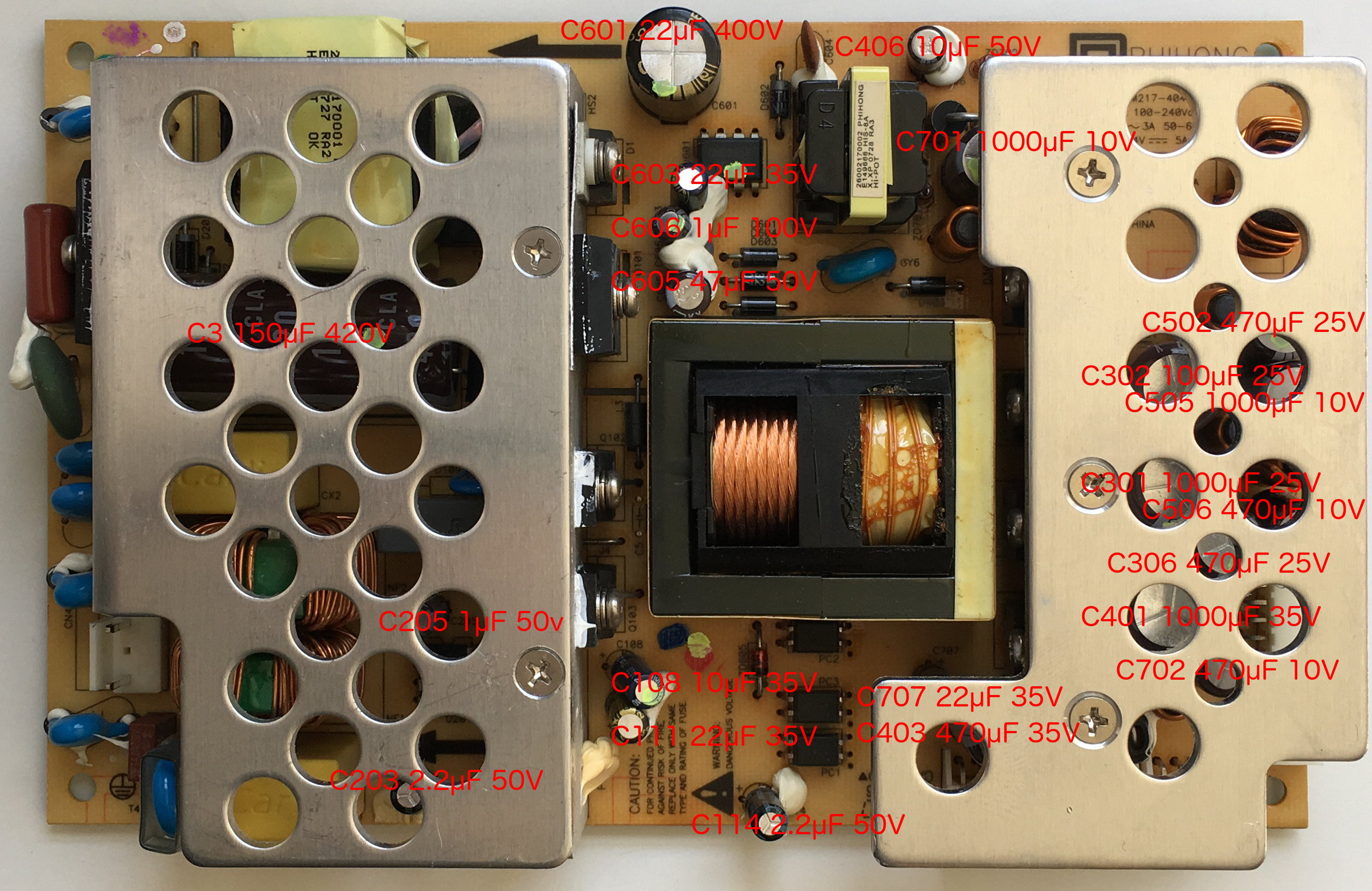

    I'm working on a recap for a HannsG HG281D monitor with a Phihong PSM-217-404-H-R rev. A1 power supply.
    There are quite a few threads on this monitor at badcaps, and I've read through all of them, but have a few questions related to my particular situation.
    The monitor worked fine until about a year ago. I usually would power off the monitor completely when not using it (I don't trust the plug-an-play stuff to not fry the HDMI port on my laptop), and it would not turn back on without a couple of power button presses. Once powered up into standby mode (orange LED color) it would go into normal operation (blue LED color) just fine and not have any issues during use. Getting the monitor initially powered on started to become a bit of a chore, so I started leaving it in standby mode and doing the plug-and-play thing. As long as I didn't accidentally flip the switch on the surge protector, I would be fine. Then it started to turn itself off completely while sitting in standby mode after a week or so; getting it turned back on would be quite time consuming, though sometimes it would just kick itself back on (this monitor seems to revert back to its last state after power failures). Getting the power back on became harder and harder, and now I have not been able to get this thing powered on since the last time it turned off.
    From my reading about the HG281D in other threads, it appears this is likely a power supply issue, in particular, a startup capacitor problem (as mentioned here https://www.badcaps.net/forum/showpo...2&postcount=34) does that sound about right to you guys?
    Which exactly are the startup caps on this board?
    Sounds like the C603, 606 and 707 are also problematic, so I was planning on recapping the entire board (except for C3). I'm wondering if film capacitors would work for the 100V and 50V capacitors or would the ESR be too low? I'd like to understand which places on the power supply board are important to get low ESR, where some ESR may be necessary, and where GP caps are OK.
    According to this picture linked from another thread http://www.directupload.net/file/u/4...fvxoqk_jpg.htm the primary is everything to the left of the transformers in the middle, the secondary is everything to the right. This follows a white silkscreen line printed on the back of the PCB. However there is a low ESR cap (C108) on the primary and a GP cap (C707) on the secondary - are those just bad choices? Where is the PFC on this board?

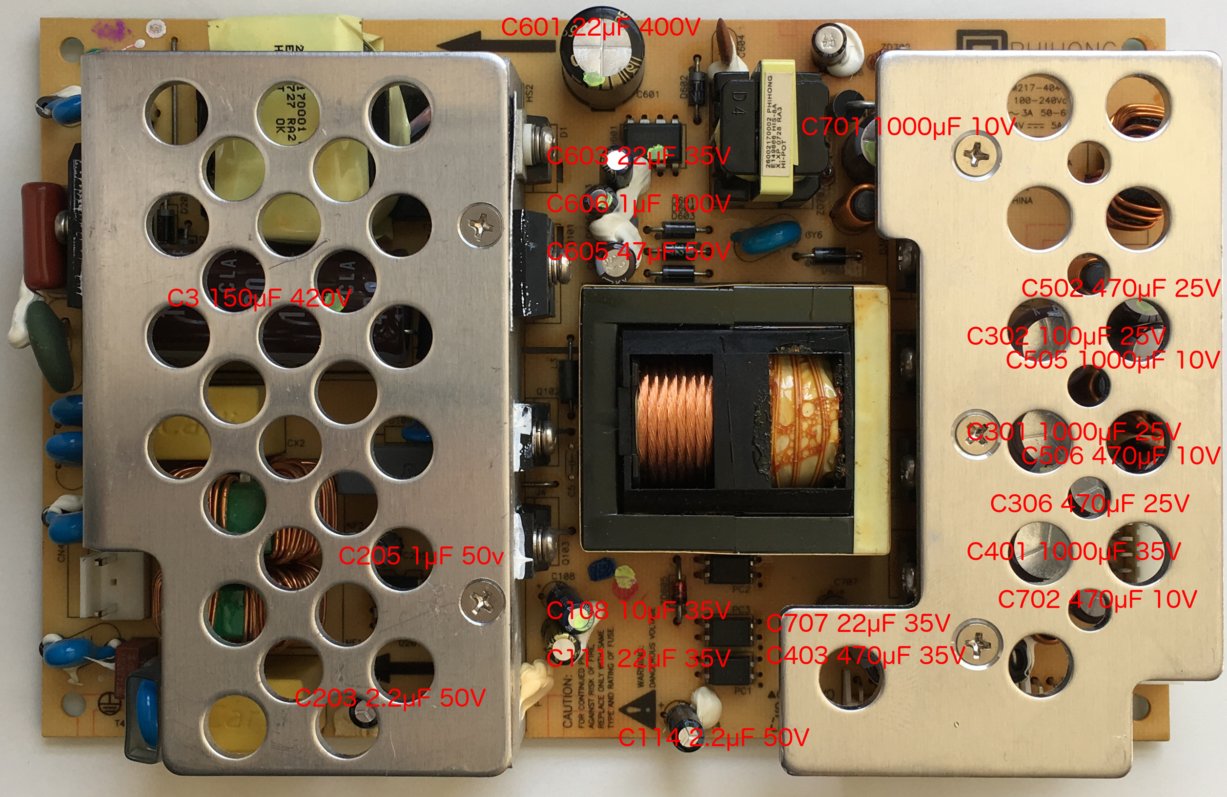

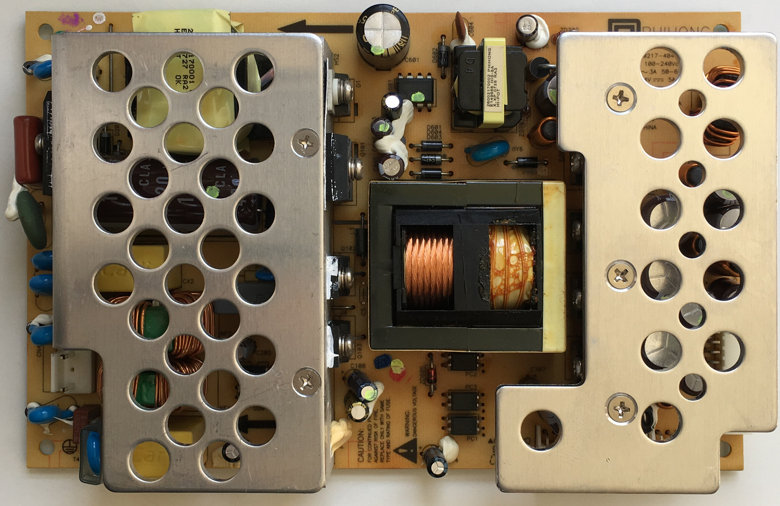

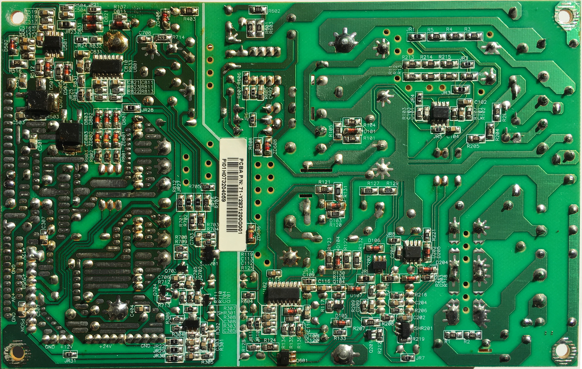

    I've attached pics of my particular PSU, also an annotated pic with the cap PCB number + specs to help identify all of the caps.
    Also, that picture linked above is a nice reference (it's of the rev. A2 board, all capacitor values are the same).
    PCB # / brand series breakdown is as follows:
    C203 C114 are Jamicon TK series (general purpose) https://cdn.badcaps-static.com/pdfs/...0a384e50a9.pdf
    C205 C606 are Taicon VT series (general purpose) https://cdn.badcaps-static.com/pdfs/...6f416a420a.pdf
    C601 Ltec TH series https://cdn.badcaps-static.com/pdfs/...710cf29b67.pdf
    C603 C707 C111 Ltec TK series (general purpose) https://cdn.badcaps-static.com/pdfs/...eff471caef.pdf
    C108 Ltec LZG series (low ESR) https://cdn.badcaps-static.com/pdfs/...3154c18b5e.pdf
    C3 Nippon Chemi-Con CLA https://cdn.badcaps-static.com/pdfs/...41a221bc5e.pdf
    Everything else is Nippon Chemi-Con KY (low ESR)
    I also plan to replace the DC filter caps on the logic board https://www.badcaps.net/forum/showth...ghlight=HG281D

    Re: Another HannsG HG281D
    Looks like I missed C406 in that first annotated photo. Can that picture be replaced?
    The corrected picture is attached.

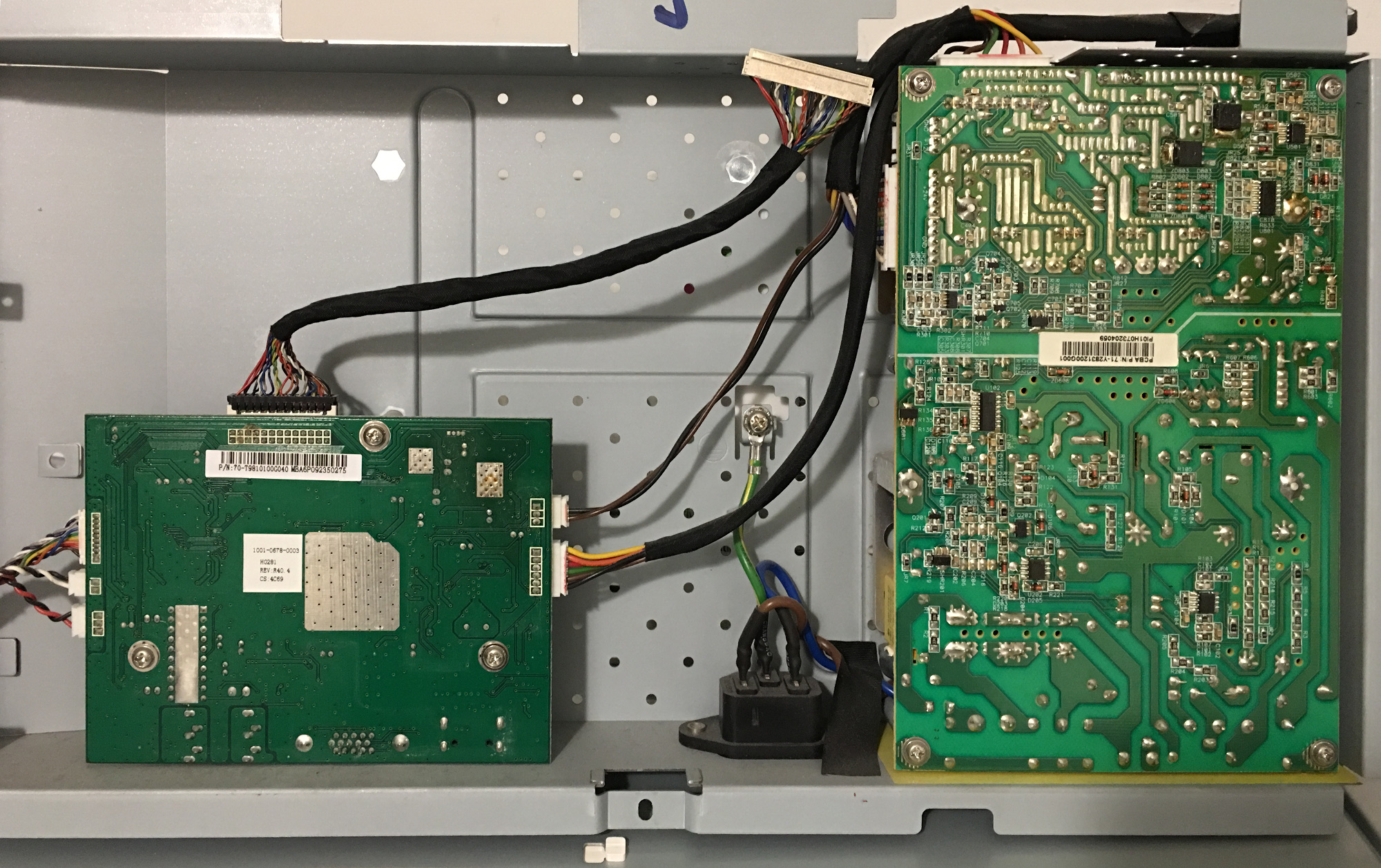

                    I opened up the monitor and broke out my multimeter and oscilloscope as I wanted to get an idea of the difference any modifications make.
                    Apologies for the _s, I couldn't get it to align correctly with spaces.
                    Here are the measurements I took:

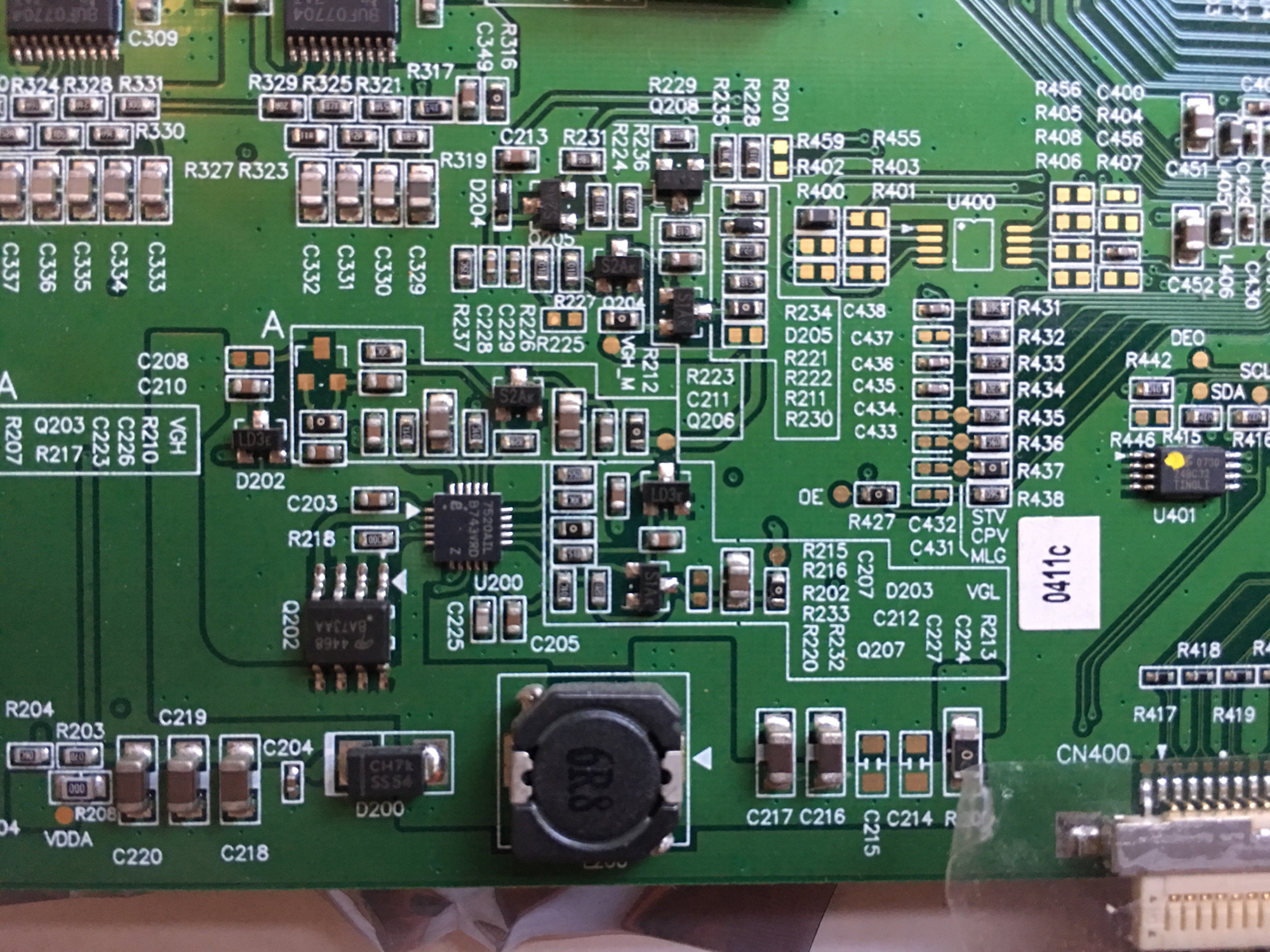

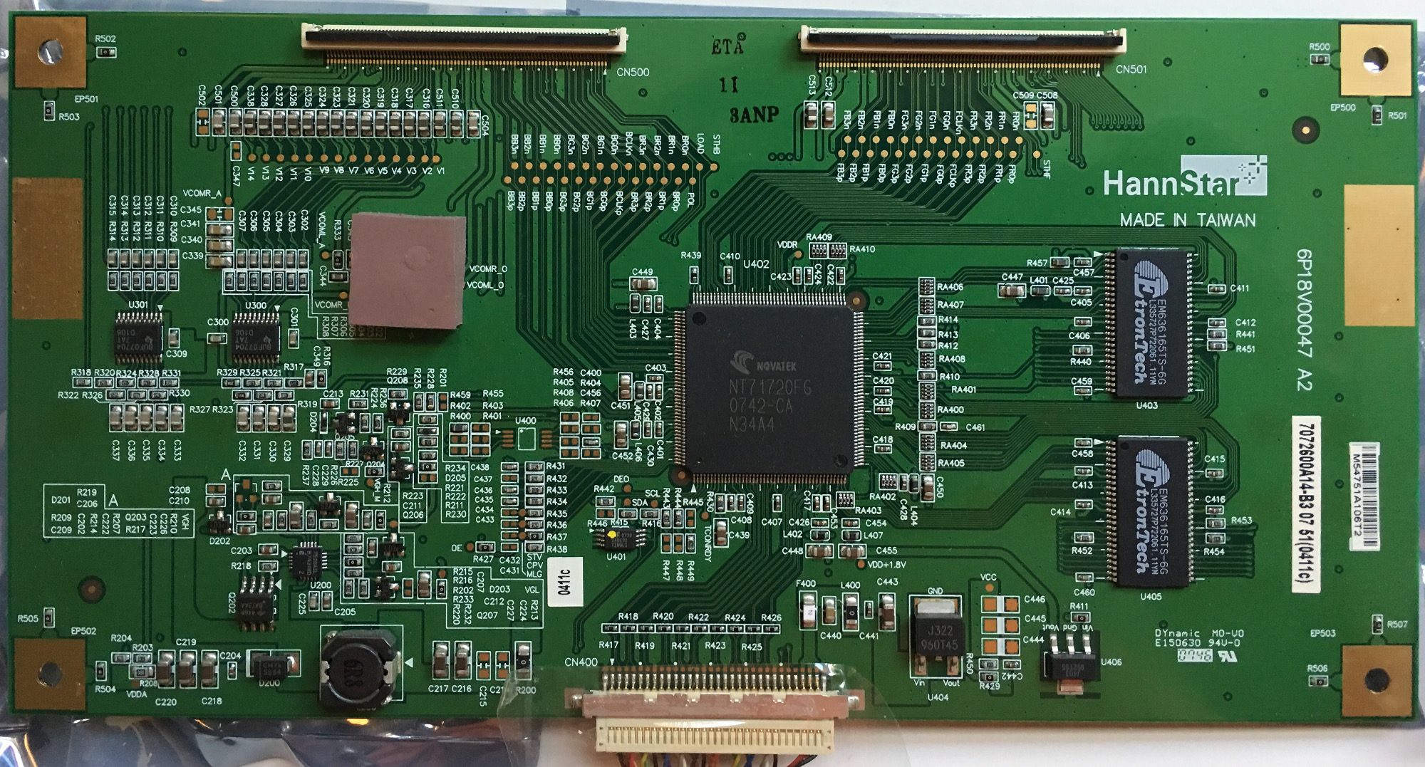

                            T-con board.
                            That's the one permanently attached to the TFT screen and usually located at the top of the monitor, under a metal shield. It's possible the badcaps may have cause damage to the t-con board.
                            Take some pictures of the t-con board and post them here. The are of most interest is where around the LVDS connector (from the LVDS cable that comes from the logic board) and also there should be a round inductor and a fuse on the t-con. The round inductor is where the main boosted rail and other secondary charge-pump rails get produced. The fuse should be near the LVDS connector. Start with checking the fuse.
                            Post pictures and results here.

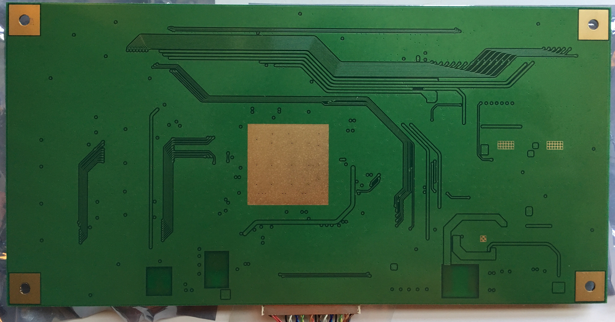

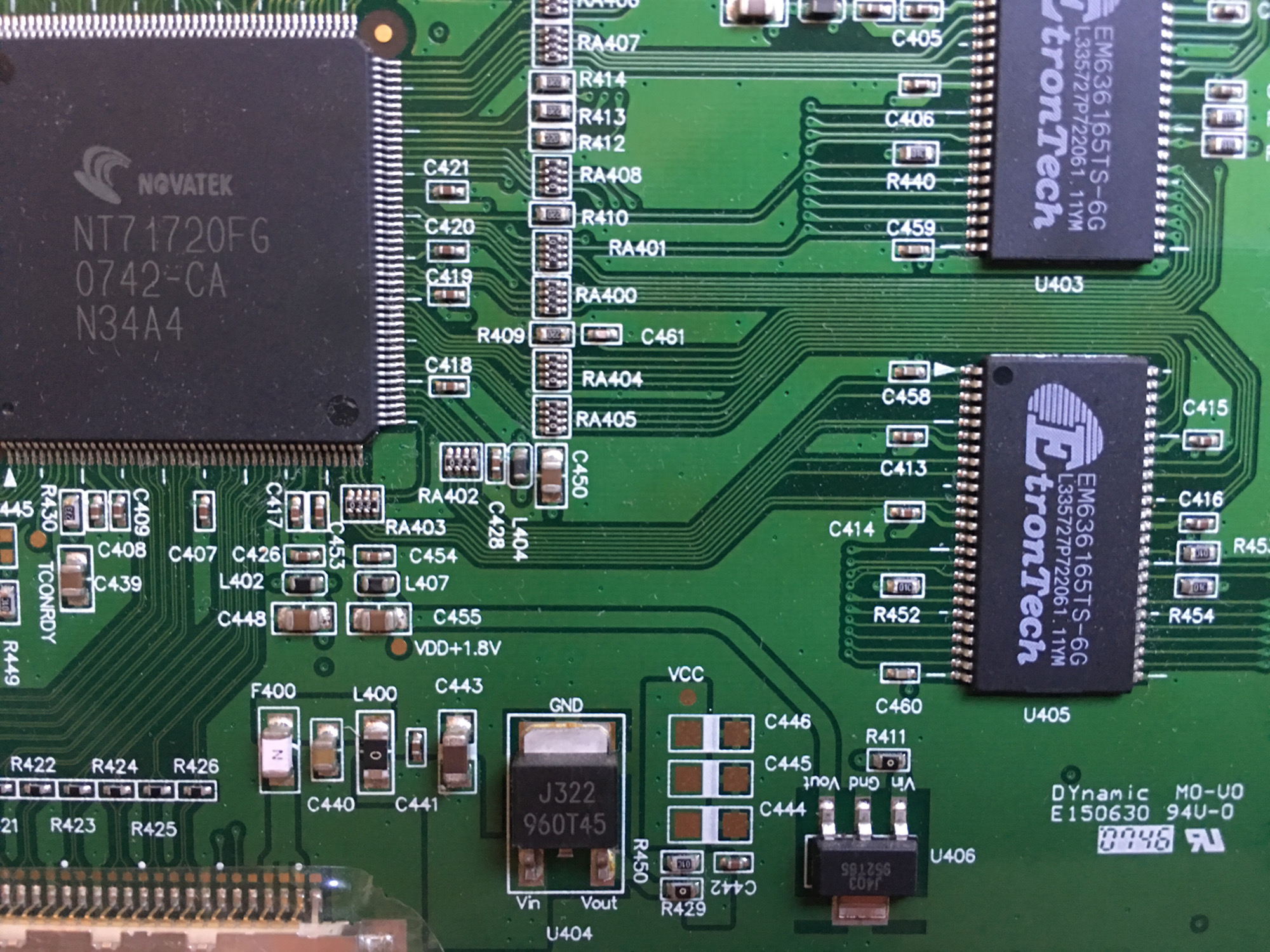

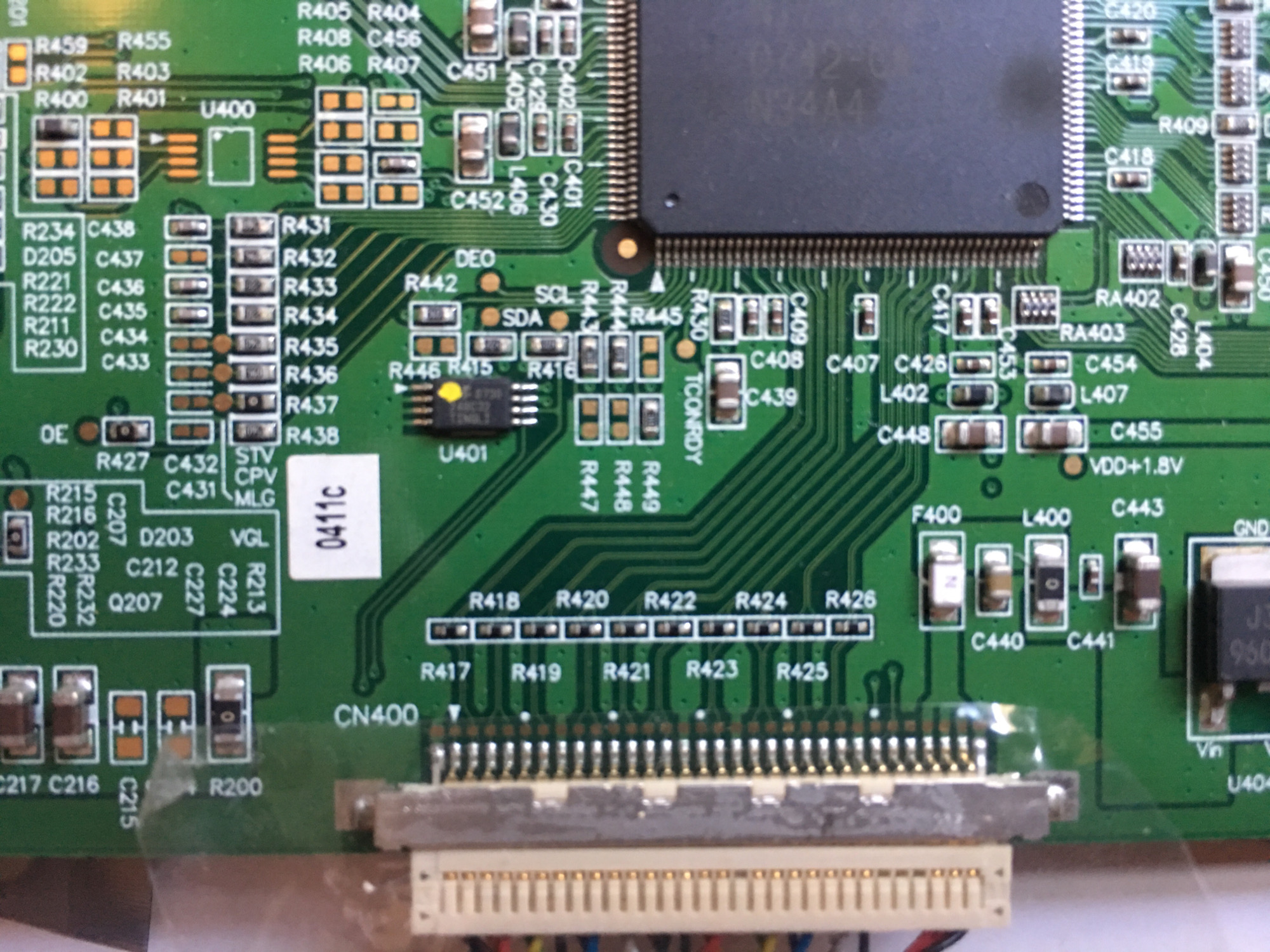

                              Pictures of the TCON are attached.
                              Let me know if there are any others I can take that would be of help.
                              Thanks!
                                  I started checking resistances and voltages on the TCON, the voltages were all way off (VGL, VGH, and VGH_M are all 0V) and eventually got back to F400 which has 0.84V on both sides.
                                  Not sure what the supply voltage is supposed to be to this TCON, but it seems U404 and U406 are not going to be cranking out VCC and VDD+1.8v respectively from 0.84V.
                                  So back to the logic board, V18S is 1.784V and V33S is 3.30V, but the pin 1 of the TCON LVDS (which carries power to the TCON) was only 816mV (same as was on the TCON at the time, it fluctuates a bit).
                                  Any ideas which components are responsible for the supply voltage to the TCON?

                                    Yes, if T-con is not getting power, then we need to look back on the logic board. T-con usually runs on either 3.3V or 5V. Follow the power pins on the t-con board going back to the logic board. Using this picture as a reference...
                                    https://www.badcaps.net/forum/attach...2&d=1538959176
                                    ... you can see that there are 4 pins on the right side of the LVDs connector. After the first one, the next three have a trace that goes to fuse F400. Color-wise, those wires appear to be the just orange and red with the 3rd pin being unused. So follow these two orange and red wires to the logic-board.
                                    On the logic board, there is likely going to be a PNP transistor or MOSFET that switches power to the T-con board. Using this picture uploaded by user Mishannya...
                                    https://www.badcaps.net/forum/attach...3&d=1285531627
                                    ... and assuming your logic board is exactly the same (pictures of yours still wouldn't be a bad idea, just so we can verify), it appears that Q14 (8-pin SOIC chip) may be what switches power to the t-con. Because I can't see if that is 100% true, use your multimeter's continuity/lowest resistance setting to find what switching component these two orange and red wires on the LVDS connector connect to. If it's a PNP transistor, it may have gone open-circuit. If it's a MOSFET, it may have a Gate shorted to ground, which won't allow it to turn on.
                                    The issue could also be that this switching part is not getting a signal from the main controller to turn on. In that case, we will have to investigate what exactly controls this t-con power switch and why it is not getting a turn on signal (for example, it could be that the bad caps on the t-con caused too much noise and corrupted the flash chip, which then doesn't allow the main controller to boot and run everything else... though that's unlikely.)
