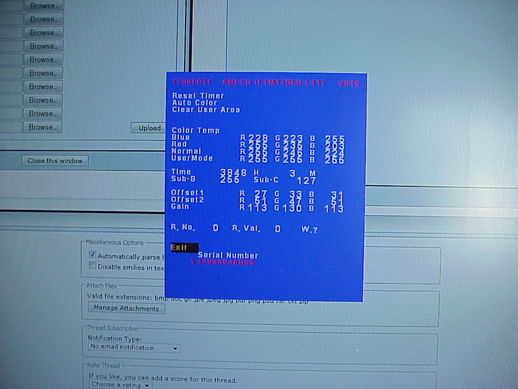

                    okay i finally got it...
                    thx to kc for that service mode tip
                    found the complete service manual for the 10 19 10
                    for some reason, the green offset and the green gain were totally off (value 200, while the others were around 120 - 130), giving me the green tint.
                    i went into the "factory 2" menu and ran the automatic color adjustments as stated in the service manual.
                    turned the brightness up to 100% and contrast to 80% (factory settings).
                    then i displayed a fullscreen picture with black and white and went through "auto color" and "auto color1" and finally ran the "color update" menu point.
                    and voila.. the green tint disappeared after the color update..
                    for other ppl who maybe find this thread through google:
                    to get into the service mode/menu on Belinea/Maxdata LCDs:
                    - put a signal in (doesnt really matter what)
                    - turn the LCD off
                    - keep holding the "Select/Auto" switch and press the power button
                    the LCD then turns on and shows the input signal, but the power LED stays amber (as in standby/no-signal-mode) to indicate that you're in service mode.
                    with this, you get 2 additional "Factory" menu points in the main menu

                      Great: without the service menu, the last chance is a color profiling.
                      Still wondering how it was so out of specs: did the previous owner play a bit with the service menu?

                                Did exactly like you on my Viewsonic VX910 but i connected power in my ATX in the computer.
                                Was a little pink at first but after the Factory Menu the picture is sharp and very Good!!
                                Thank you very much!
