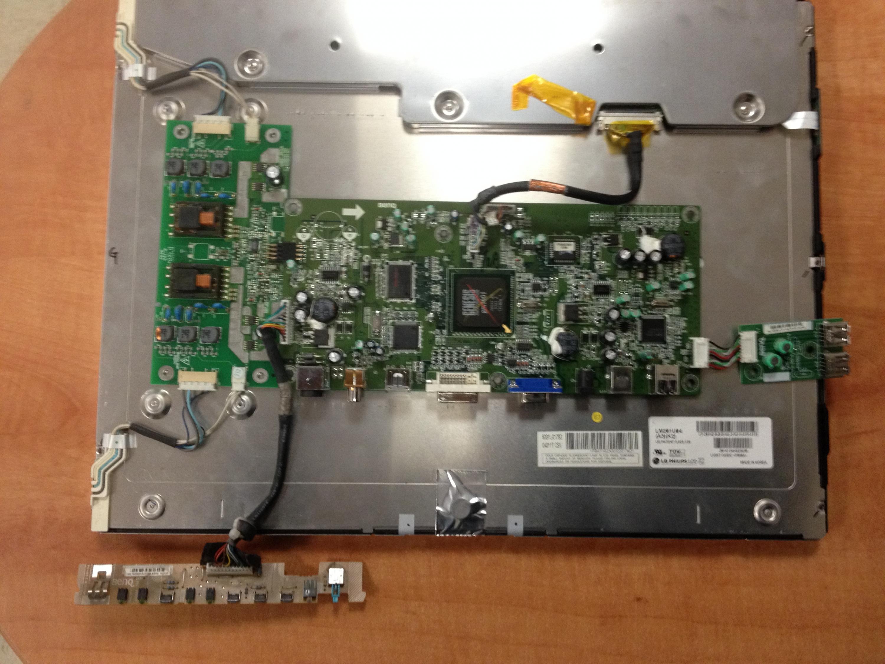

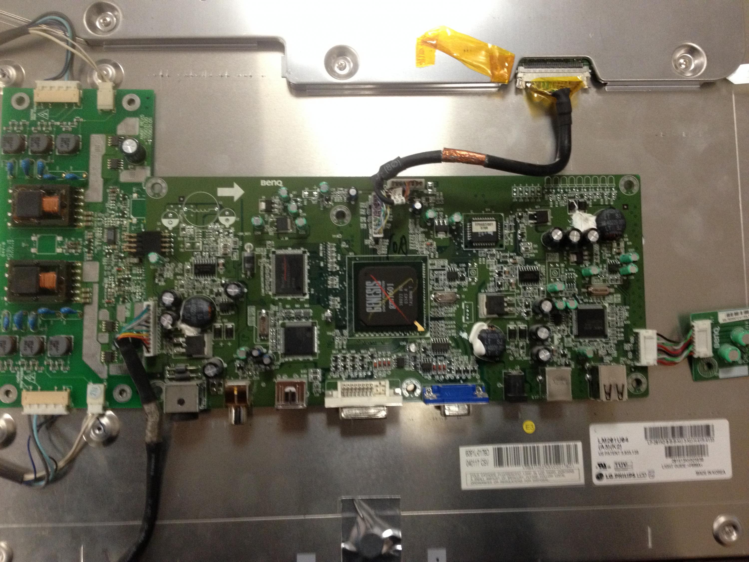

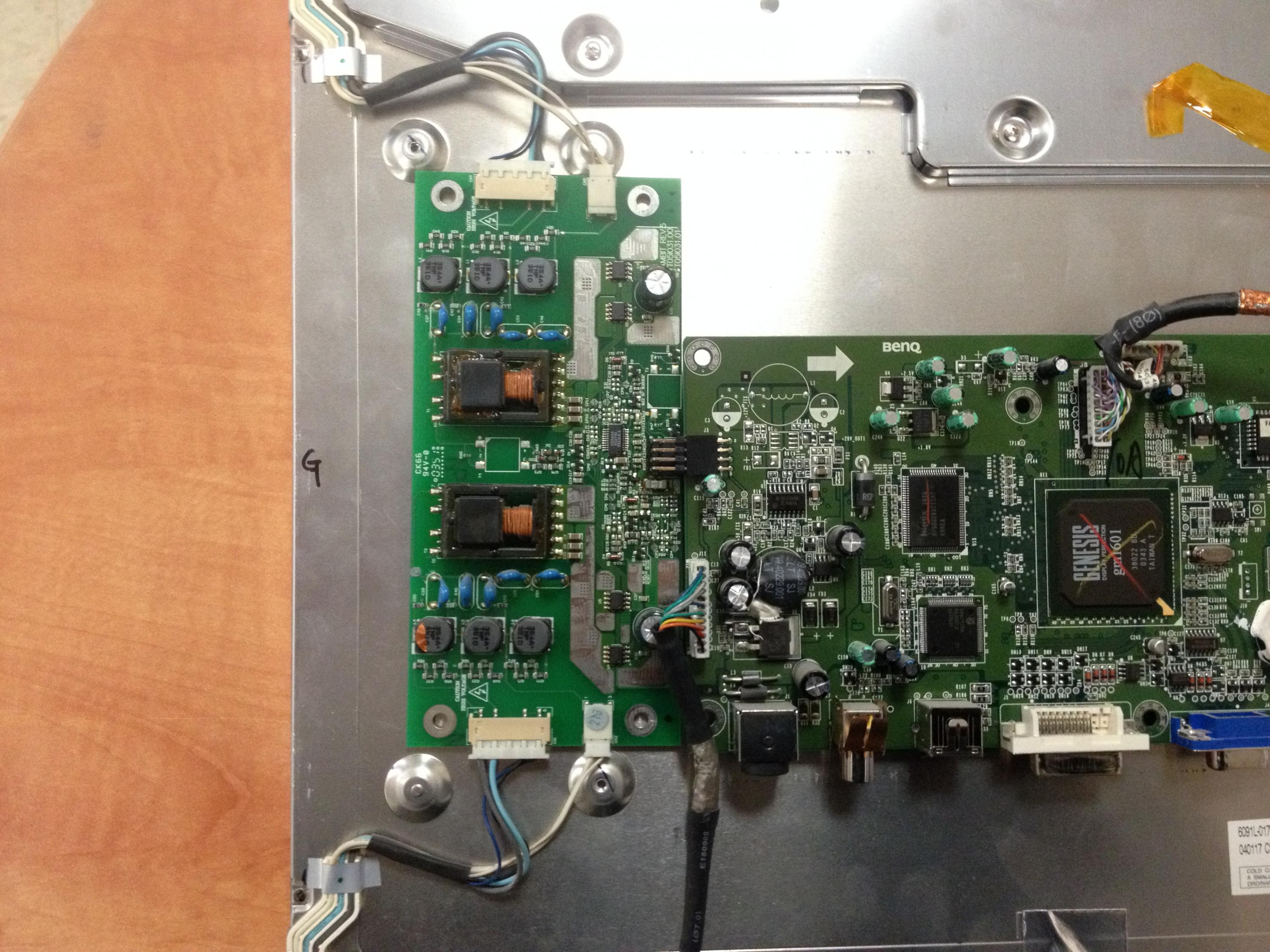

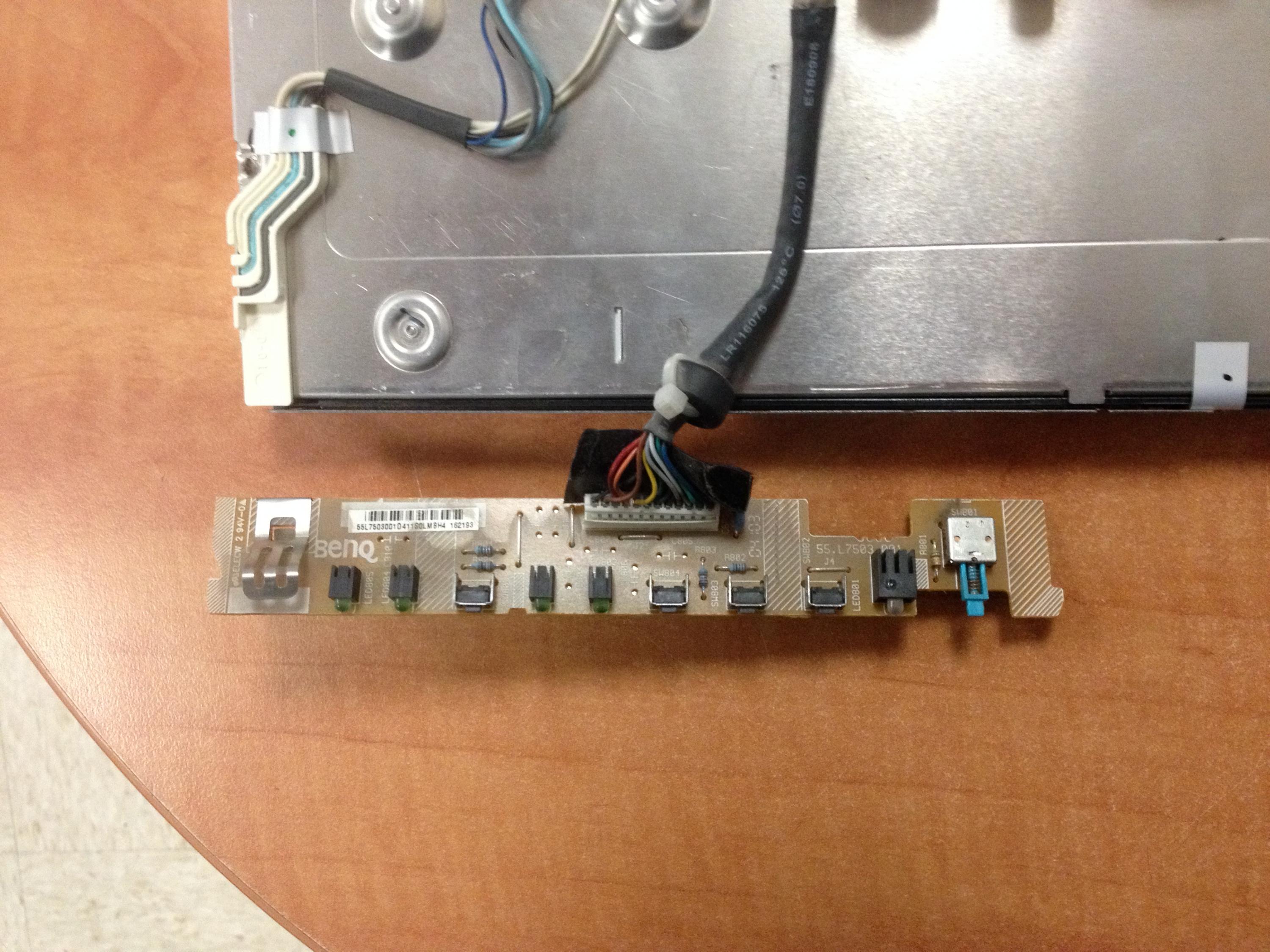

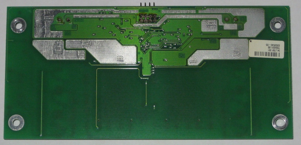

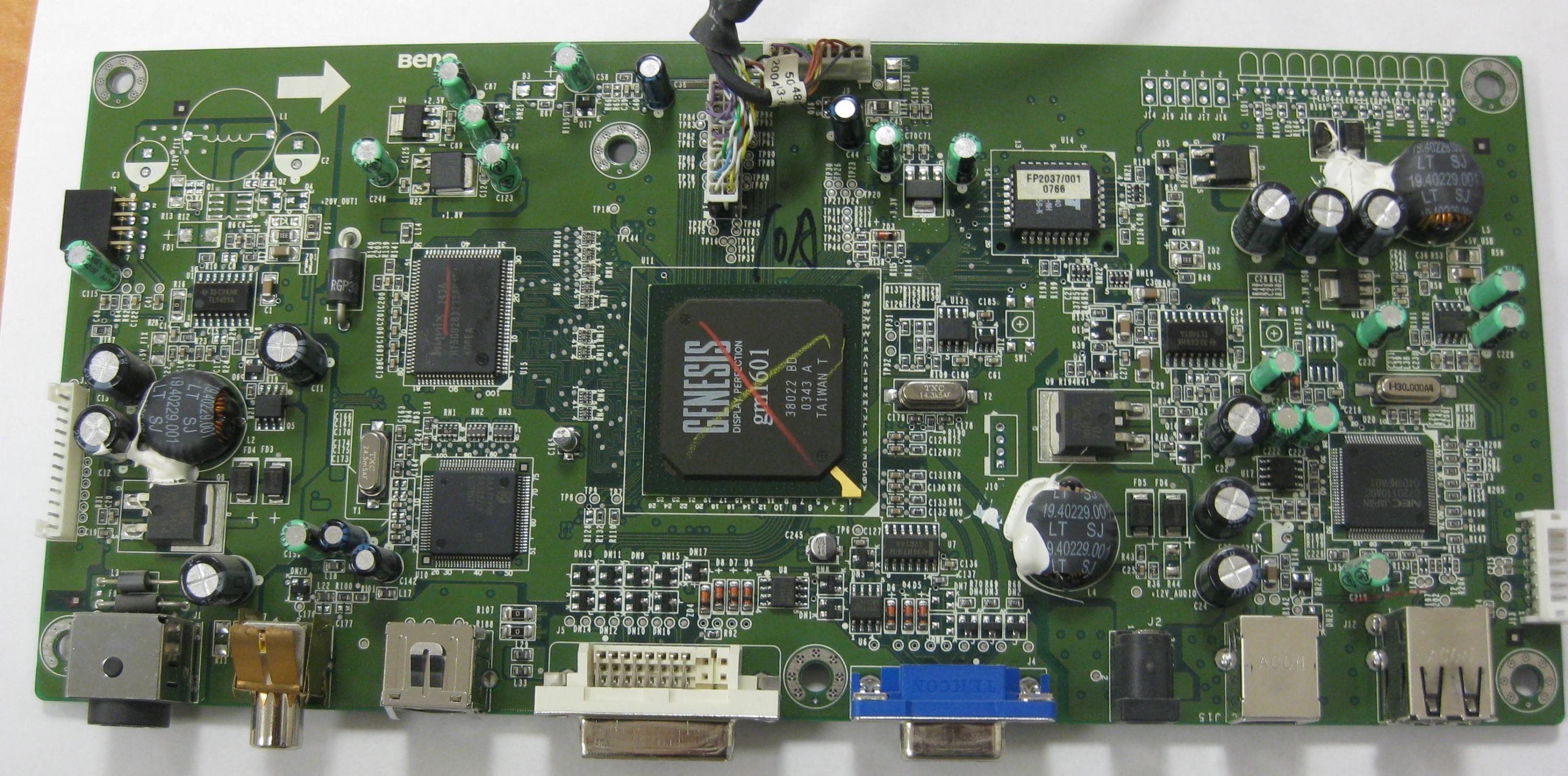

Troubleshooting a Dell 2001fp monitor. No backlight at all, not even for an instant. Image is there, flashlight shows it.
Dell 2001fp - no backlight (not even a blink)
Tags: None
Re: Dell 2001fp - no backlight (not even a blink)
Can we see the pictures with all the boards and connectors back in place?Never stop learning
post #1, third photo is your inverter board. I'd start by checking the fuse F1 located to the right of the black plug at the top/middle of the board. It's the white rectangular block with "3.5 A" stamped on it.Comment
