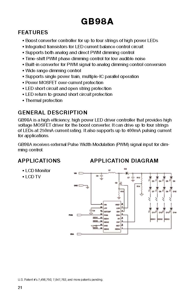

          The IC says GB98AGN CF7NIN 1448A2 at I701. I couldn't find an easily accessible datasheet, I emailed a place; we will see if they respond.
          According to this russian forum, the hp elite display e221c has the same chip. This might give us some insight to the led driver of the dell, but again I can't seem to find a service manual.

                          Re: Dell S2715Ht LED backlight
                          GB98A is made by O2micro: https://cdn.badcaps-static.com/pdfs/...6f8b3d4b96.pdf
                          at page 21 a very ugly schematic, no datasheet..
