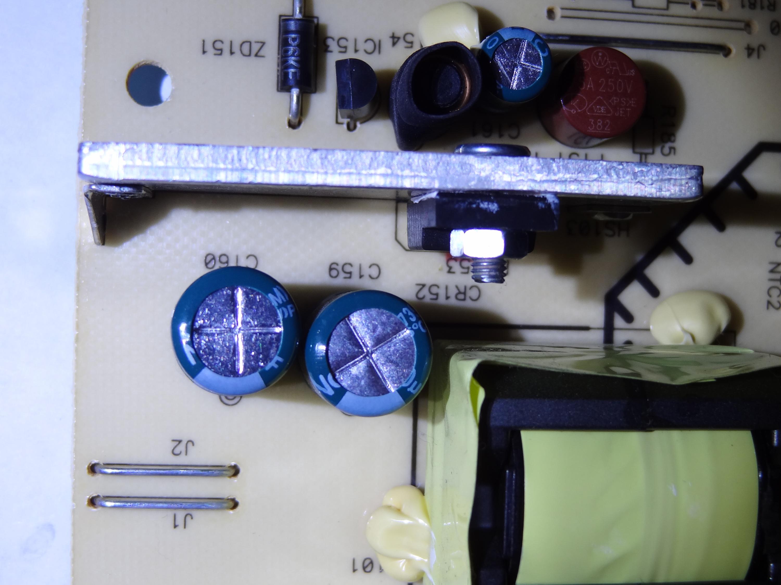

    Howdy everyone,
    After a long time away (was here a few years ago recapping some moboards and their power supplies), I'm back and finally going to get around to doing some preventive recaps on my monitors. I've got a bunch of Dell E198WFP's. They are on pretty much all the time, and would like to keep them going as long as possible, so thus the reason why I want to do a preventive recap on them.
    I took a few long looks at budm's galleries and figured out how to get one of them apart. By the way Budm, you don't have the E198WFP on your site. I know it's a cousin of several others you have on there, but if you want to grab any of the pics I've uploaded to put on your site for others, please feel free to do so. And if I don't have a picture of something you think should be included, please let me know and I'll happily provide.
    One quick question - it seems that these flatscreens are particularly susceptible to being fried because of shorting/overloads in troubleshooting. Is there a proper way you are to power them off and then discharge the supplies before tearing down? I know I'm a little late in asking as I already tore one apart, but after reading budm's guides I had an oh crap moment on the high voltage warning. Or is it more of you have to be careful when you are live troubleshooting? I never did anything special when I recapped the computer's power supplies, but that may just be because I didn't know better.
    Before I dive in to the datasheets and try to remember all of the lessons Mockingbird and Momaka (and all the others) taught me on identifying the right replacement caps, can those of you who exclusively work on these displays weigh in on what all needs changed? I included diagrams I made of the boards with all of the caps and their specs. These cap manufacturers are all on the bad cap manufacturers list, so unless someone says otherwise I'll change them all.
    And are there any other recommendations you have to extend the life of these displays? Anything else that should be changed besides the caps?
    Thanks!

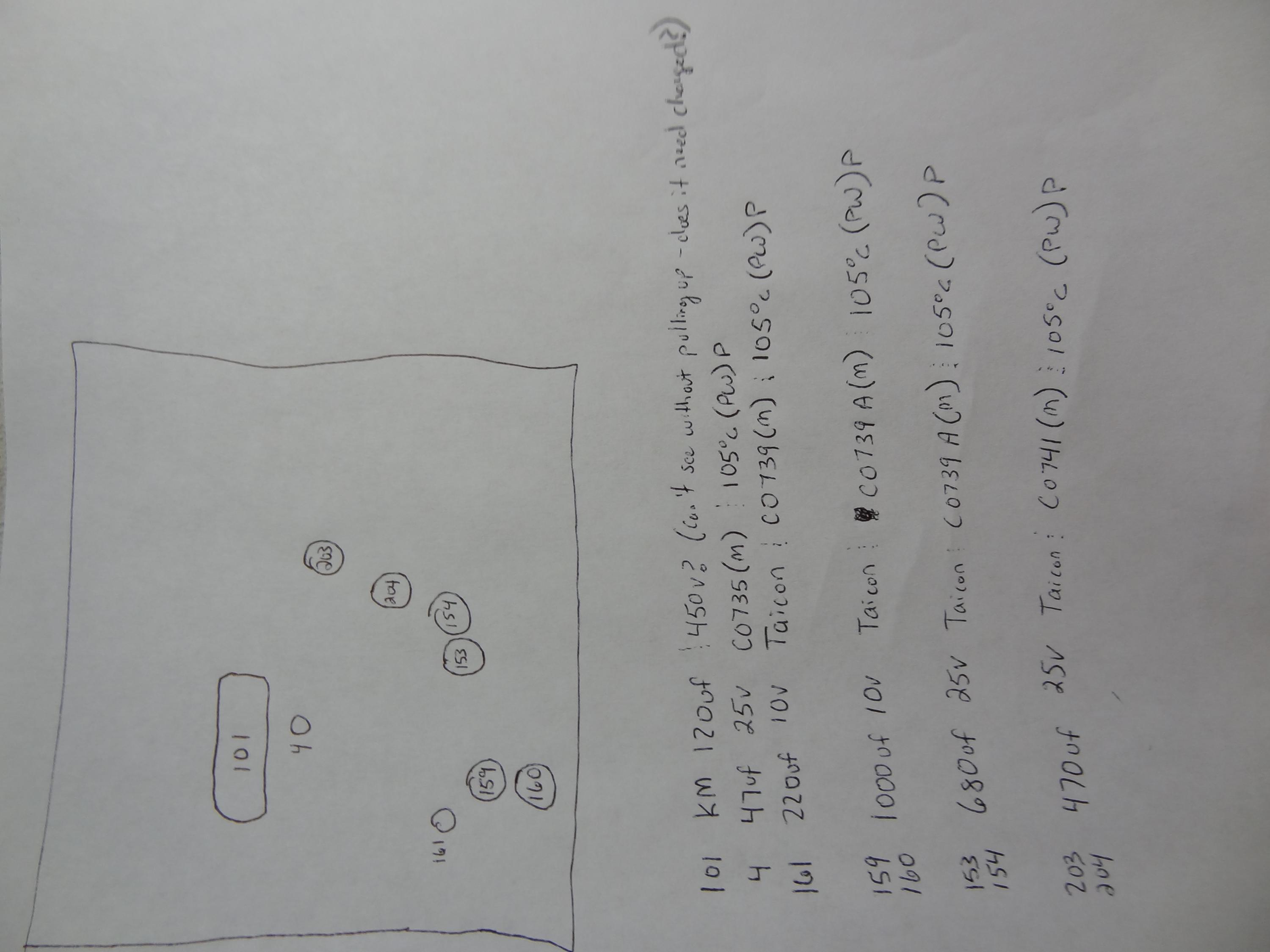

      Certainly I'll agree in some context's that if it ain't broken don't fix it. But this is the first time I'v heard of that analogy here. My understanding is that in alot of instances bad caps are just ticking timebombs and when they do blow, they can completely destory the device. And that is even more so relevant here (with displays) because when they blow they can take out other components that can be hard/impossible to replace. So I think it's certainly prudent that if you have the time and resources to do a prevantive recap you should if you want to try to get as much life as possible out of a device. Certainly don't see any harm in doing so?!?!?!?

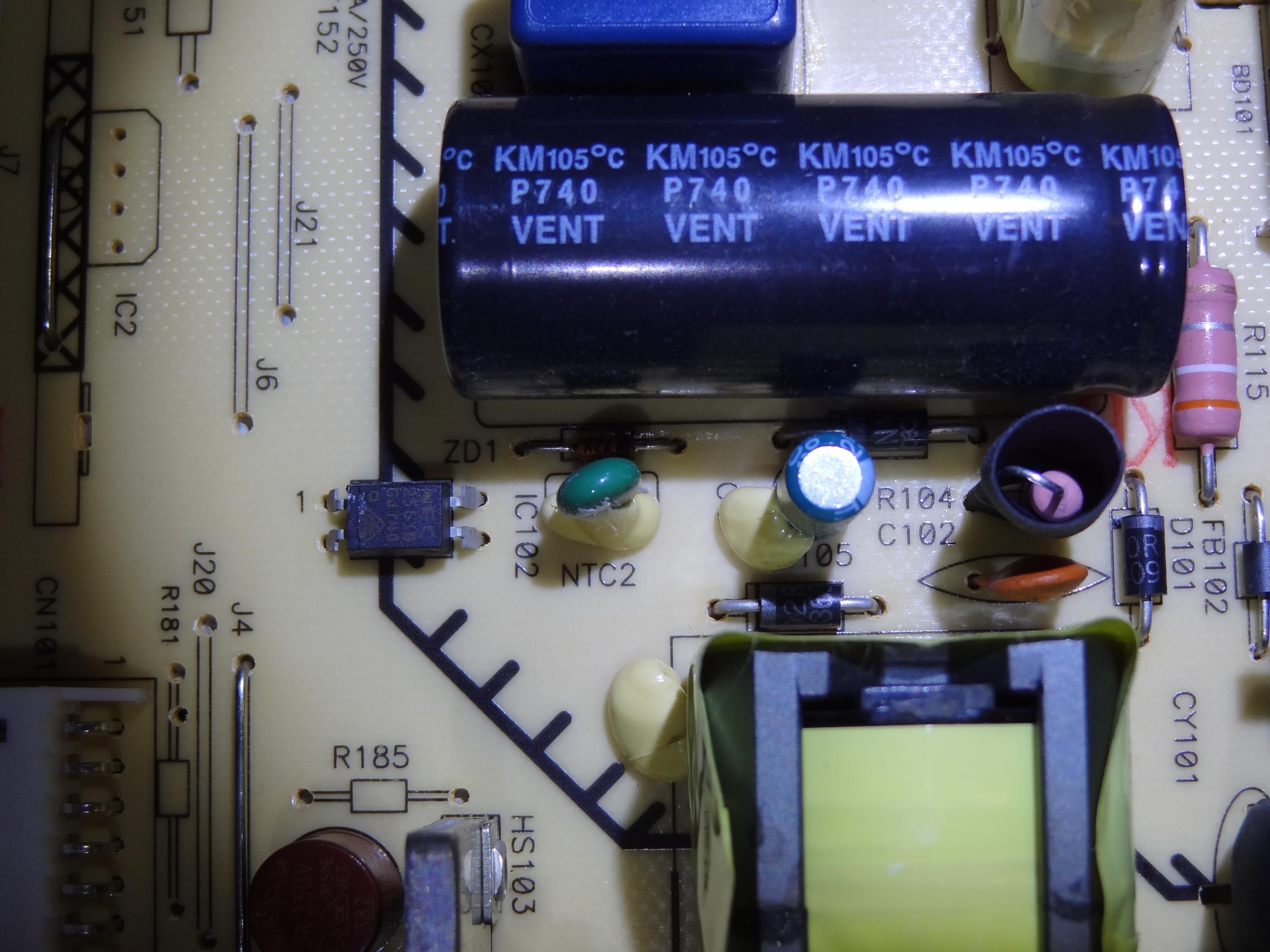

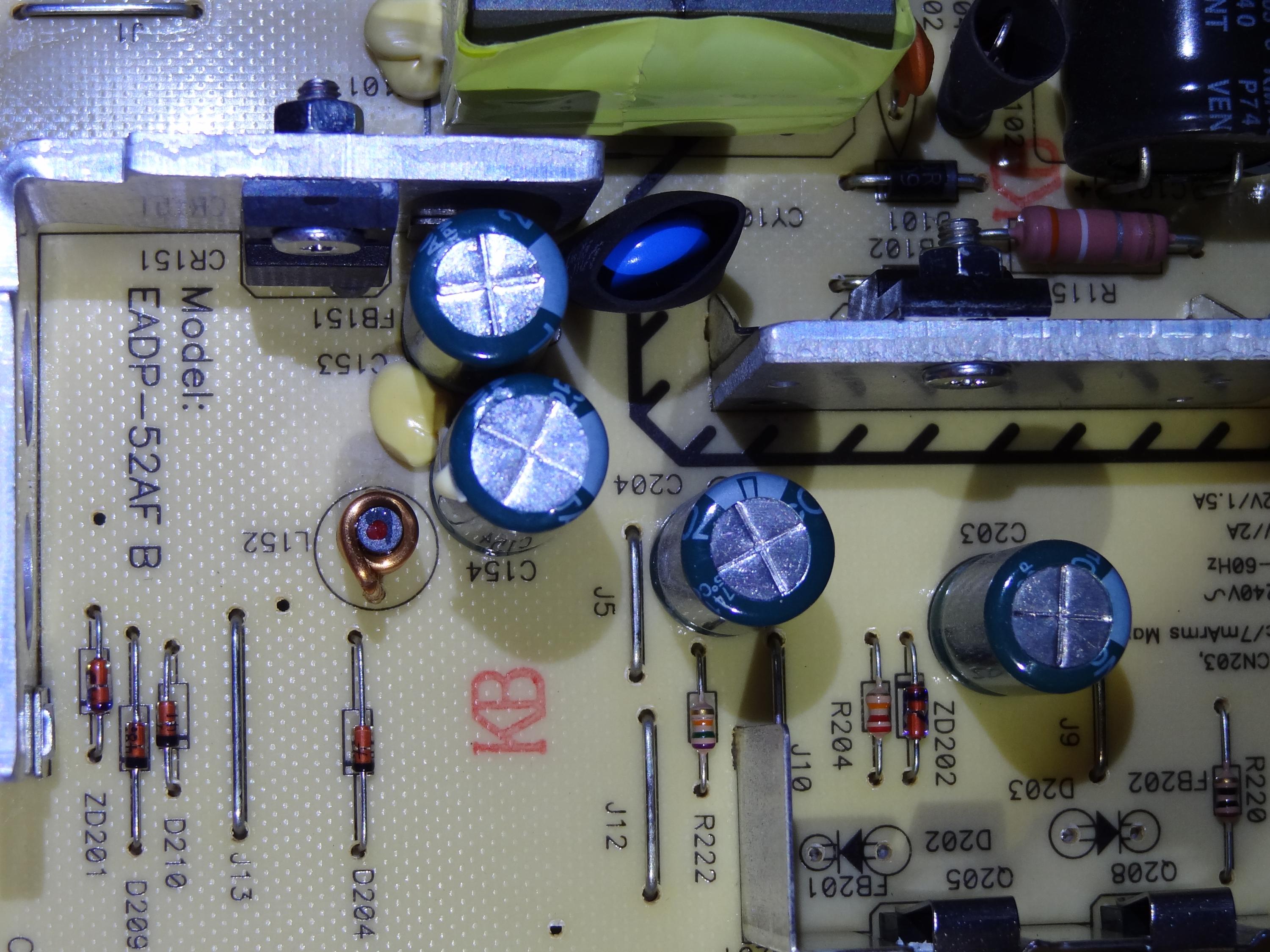

      That said, I plan on replacing all of them as they are all on the list of known bad manufacturers. I identified all the caps for the power supply and am using all Panasonic FR's for replacement. I know there are cheaper options, but I used them predominantly in all of the motherboard and power supply recaps I did a few years ago. They've got a long life, and way better values than the original and it was just easier to identify replacements. Here's my notes if anyone's interested.
      Code:
      PS:
      Cap		Brand		uf	Volt	D MM	H MM	Info		ESR	Ripple		Digikey#	Replacement		DxH	ESR	Ripple
      161		Taicon		220	10	6.3	11	PW		0.25	290		P14375-ND	EEU-FR1A221		6.3x11	0.130	455
      159&160		Taicon		1000	10	10	16	PW		0.068	1050		P14378-ND	EEU-FR1A102L		8x15	0.041	1240
      4		Taicon		47	25	5	11	PW		0.60	180		P14411-ND	EEU-FR1E470		5x11	0.300	280
      203&204		Taicon		470	25	10	16	PW		0.065	995		P14417-ND	EEU-FR1E471Y		10x12	0.043	1290
      153&154		Taicon		680	25	10	20	PW		0.052	1220		P14422-ND	EEU-FR1E681		10x16	0.028	1790
      Big question here, this is under the assumption that the "PW" series of Taicon caps are actually PZ. I couldn't find PZ listed in the cap datasheet depot, but did fine this Taicon cross reference listing PZ(PW) and when I looked at the Taicon PZ data sheet it had the (PW) as well. Can someone confirm this? Otherwise my initial specs of these caps for replacement comparison is totally wrong.

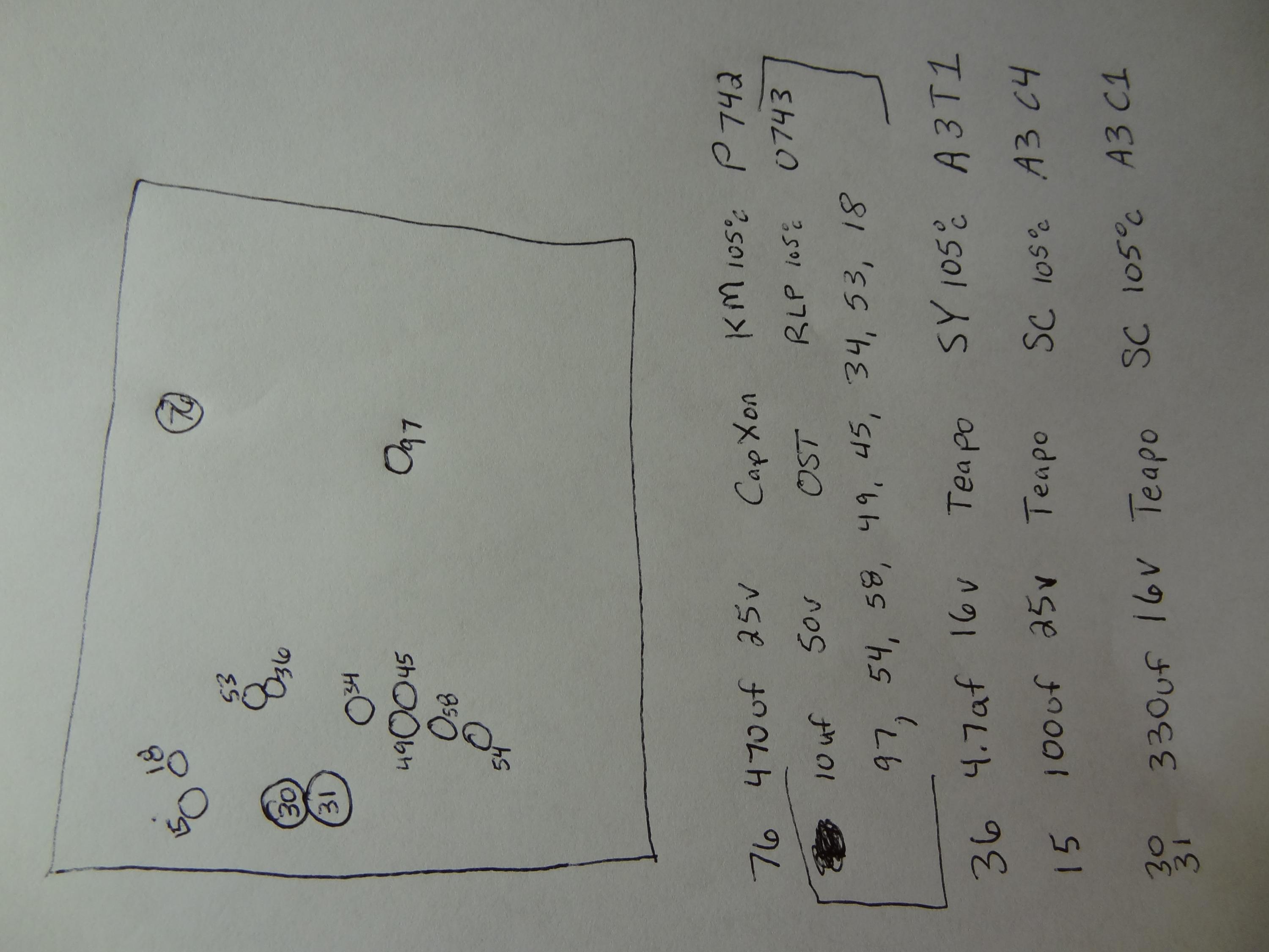

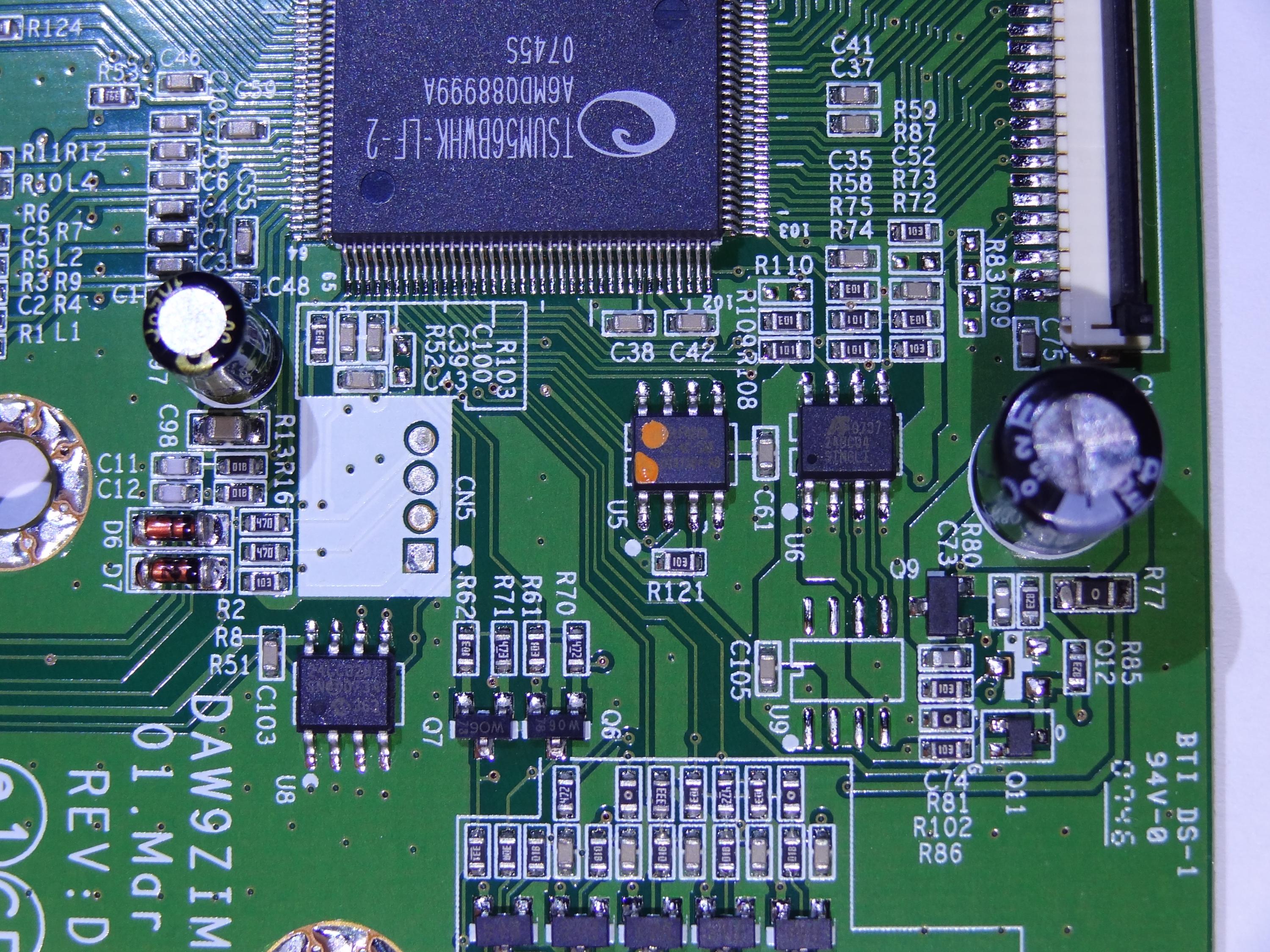

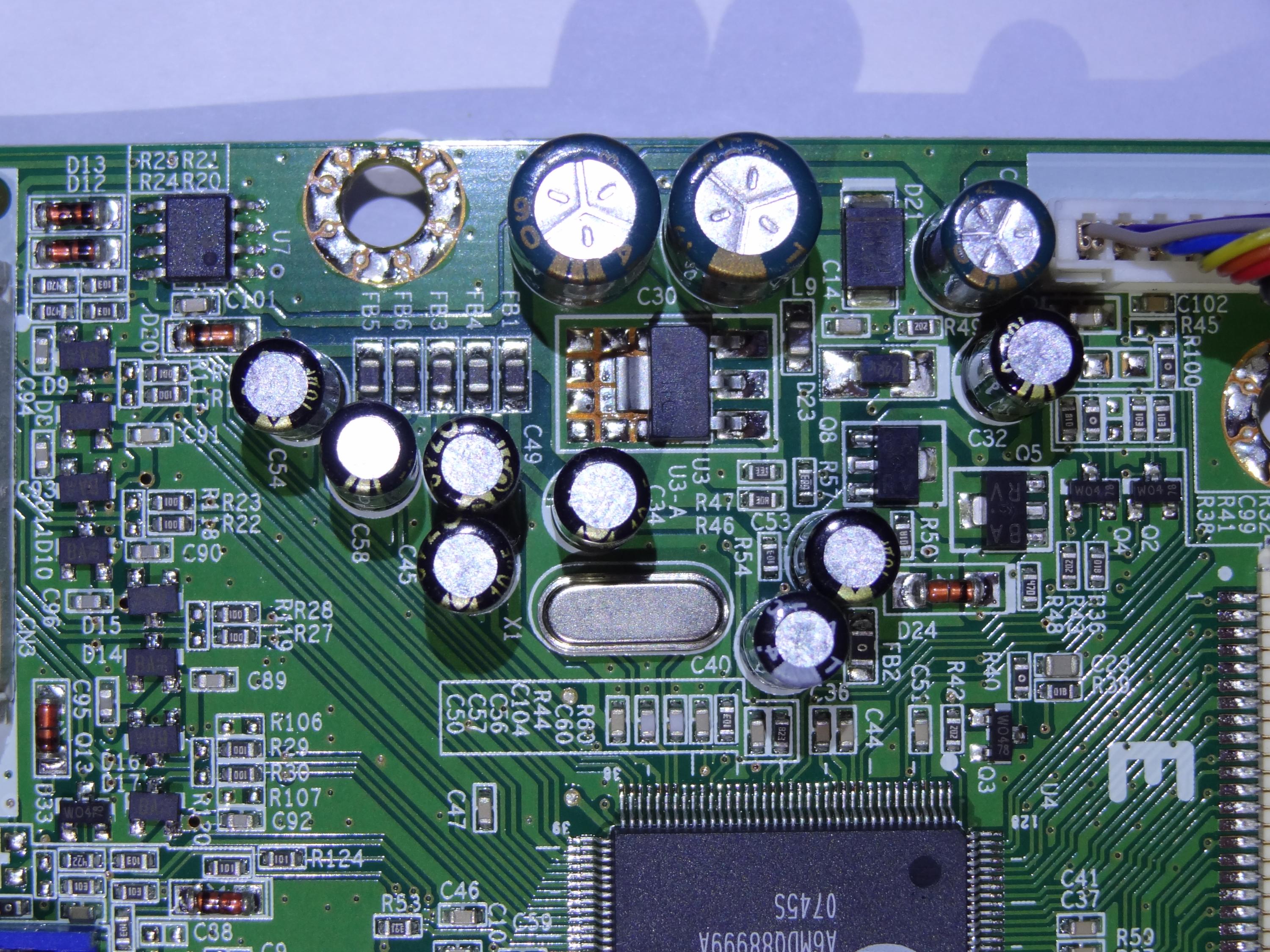

      Now on to the video card. Got several issues here. First the info/specs:
      Code:
      Video:
      36		Teapo		4.7	16	5	12?	SY		Doesn't exist???	Only one cap available at Digikey for this uf/V	1189-2183-ND
      30&31		Teapo		330	16	8	11	SC		0.120	620		P12372-ND	EEU-FM1C331		8x11	0.056	950
      15		Teapo		100	25	6.3	11	SC		0.220	250		P14413-ND	EEU-FR1E101		6.3x11	0.130	455
      76		CapXon		470	25	8	11.5	KM		NO!	410		P14417-ND	EEU-FR1E471Y		8x15	0.041	1240
      Multiple	OST		10	50	5	11	RLP		1.40	120		565-1702-ND	EKZE500ELL100ME07D	5x7	0.50	210
      1. The Teapo 4.7uf 16V SY cap doesn't exist in Teapo's SY datasheet. But that's clearly what the cap says on it. Furthermore, there is only one cap available at digikey for this uf/V (1189-2183-ND). Mouser has a few more available. Thoughts?
      2. The CapXon cap doesn't have an ESR listed in it's data sheet (KM). I believe that means it's a general purpose cap. I choose a Panny FR for it's replacement using the ripple as a guide. This OK?
      3. There wasn't alot of choices to replace the OST cap(s). Had to get away from my panny picks and go with a United Chemi-Con KZE. Again, any concerns or better recommendation?

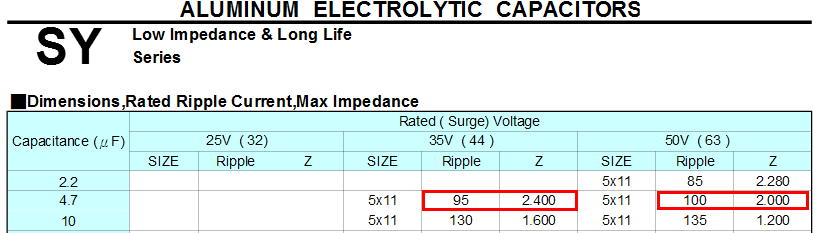

                            Here is the datasheet for Teapo SY
                            http://www.teapo.com/WebSiteFile/Pro...ct_Data/SY.pdf
                            The specs for 5x11 in the SY series are 210 for the ripple and 0.580 for the impedance, which matches the KY you chose perfectly. Good job
                            Here are some changed you might like to consider:
                            Firstly, for the PSU:
                            Those parts are 6.3x11 and 5x11, respectively. The datasheet specifies those sizes as having an endurance rating of only 2000 hours.
                            Instead, please consider the following alternatives:
                            P14375-ND
                            1189-1726-ND (6000 Hours), 1189-1546-1-ND (7000 Hours), 565-3566-ND (6000 Hours).
                            P14411-ND
                            565-4239-ND (7000 Hours), 1189-1630-1-ND (7000 Hours), 1189-2240-ND (10,000 hours).
                            And for the logic board:
                            P14413-ND
                            565-1545-ND (5000 hours), 1189-1898-ND (5000 hours), 565-3556-ND (5000 Hours), 1189-1857-ND (5000 Hours), 1189-1300-ND (6000 Hours), 565-3574-ND (6000 Hours), 565-3910-ND (7000 Hours), 565-4059-ND (7000 Hours), 1189-2268-ND (7000 Hours), 1189-2239-ND (10,000 Hours).
                            565-1702-ND
                            For this cap we need to drop from RLP's 120 ripple to around 100 and tripple the ESR to 1.5. No one makes something with such a rating and a low ESR AFAIK in this diameter.
                            1189-1852-ND (5000 Hours) or 565-1598-ND (5000 Hours).
                            You should be ok here, and it's preferable to use a longer life cap here, eventhough the ESR and Ripple aren't as great as the originals, because they probably were overrated for the circuit anyway.
                            One last thing to keep in mind: YXM series (where a 10,000 hour part is included) is not a low-ESR cap. So its benefits in terms of longevity may be negligible because the effect that a higher ESR has on a cap is more heat, so the endurance rating gets negated. You're probably better off with the 7000 hour low ESR parts.
                            YXM is probably designed for circuits that don't need that much ripple filtering but get very hot for other reasons.
                            Good luck, and please keep us updated on your progress.
                              First, I must credit 1supertech as he suggested that cap cause I forgot that you can up the voltage. That cap has been a bit of a thorn to me because it wasn't listed in the data sheet and it was driving me crazy. When you phrased the specs I took another look at the data sheet and realized how you came up with them. The cap itself isn't listed (4.7uf 16V) but it's size 5x11 is, and the specs for that size are all the same (0.580 ESR / 210 Ripple).
                              But now, having that information, leads me to think the replacement selected won't work. The KY replacement EKY-500ELL4R7ME11D has an ESR of 1.9 and Ripple of 88. That's the wrong direction compared to the replacement right (Ripple must be greater than or equal to original, ESR must be lesser than or equal to original). So that replacement cap won't work?? Or will it because the replacement cap's voltage has been substantially increased...?!?!

                                So with the first two instances where you switch from FR to ZLH and ZLJ, it has more to do with the series you changes to than the increase in voltage. 5mm and 6.3mm caps within the FR series are all 2000 hours, but once you get into the 8mm range, it goes to 6000 hours and up. ZLH starts at 6000 hours, regardless of the diameter, and then goes higher. ZLJ is a good example of what was stated previously. It starts at 6000 hours, regardless of the diameter, but even within the same diameter, you gain 1000 hours if you use a part that falls within the voltage range of 10-50V.
                                I can see where you got confused here. SY's datasheet doesen't seem to follow the same rules with regard to diameter and ESR/Ripple ratings as almost all other datasheets do. O the figures you're getting are from the first page, which don't have a 16V 47uF part listed, but list other 5x11 parts at those specs you mentioned.
                                Now when you scroll down to the second page, you see this:
                                So, considering that the 50V variant is 100 ripple and 2 Ohms (and yours is 16V), KY is well within spec here.
                                Are we going down in Ripple / up in ESR to get longer life rated caps vs using caps with better specs than the original but a short rated life???? (Also because as you mention we can safely do this because the original caps didn't need the specs it had so the replacements with higher specs than the original works and gets us longer life)....!?!? I definitely take your word for the recommended replacements, I'm just curious on how we're going in the opposite direction of the 'guidelines'.
                                As always thank you again for taking the time to share your knowledge.
                                For the 5mm OST RLP on the logic board, yes. If this was in the PSU, it wouldn't be a good idea. If this was on a logic board around a complex circuit, it wouldn't be a good idea. But this is on the logic board probably just providing some minor filtering for the IC. It's definitely worthwhile sacrificing ripple/ESR here for a longer life cap. And only in this case, because none of the long life 5mm caps go up that high in ripple and that low in ESR AFAIK.
                                Good luck my friend, G-D Bless, and please report your results here.
