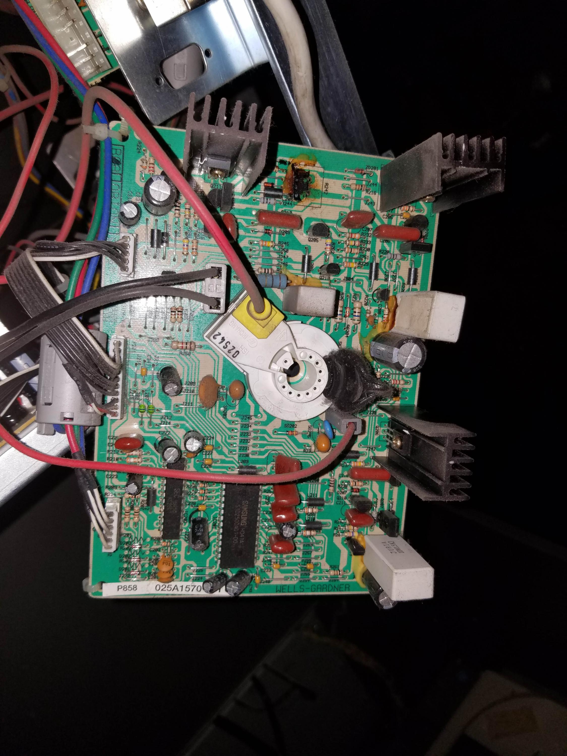

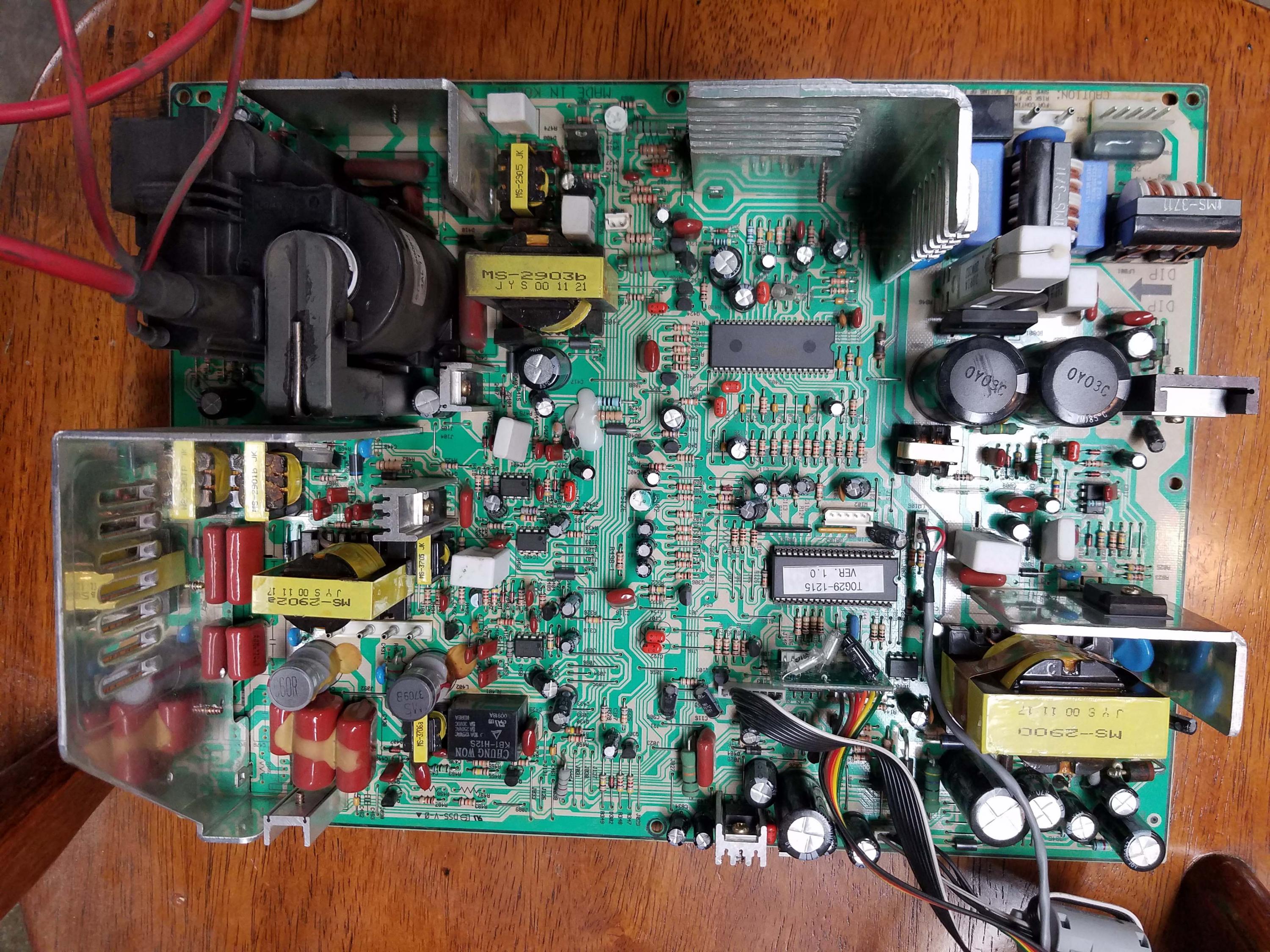

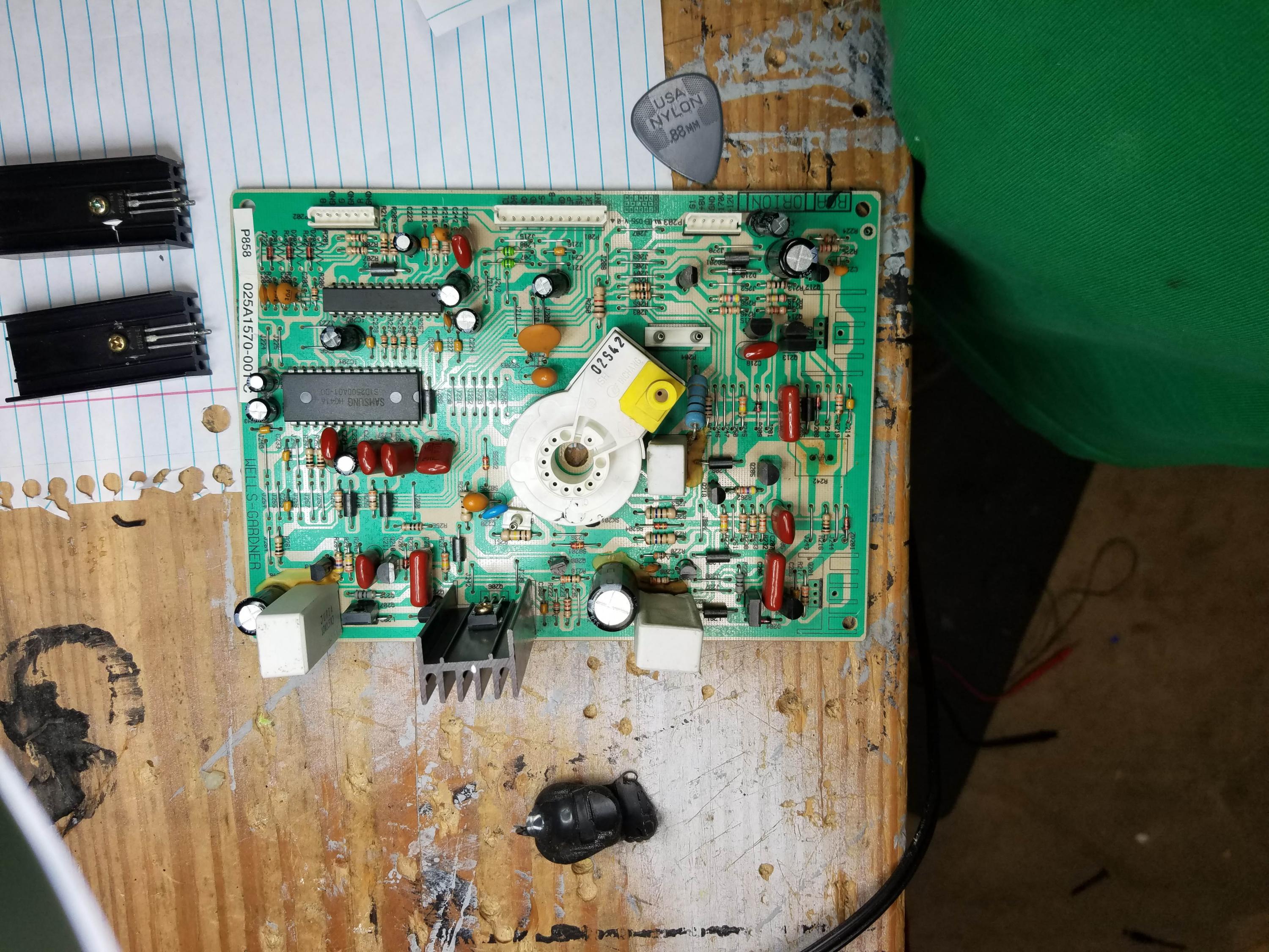

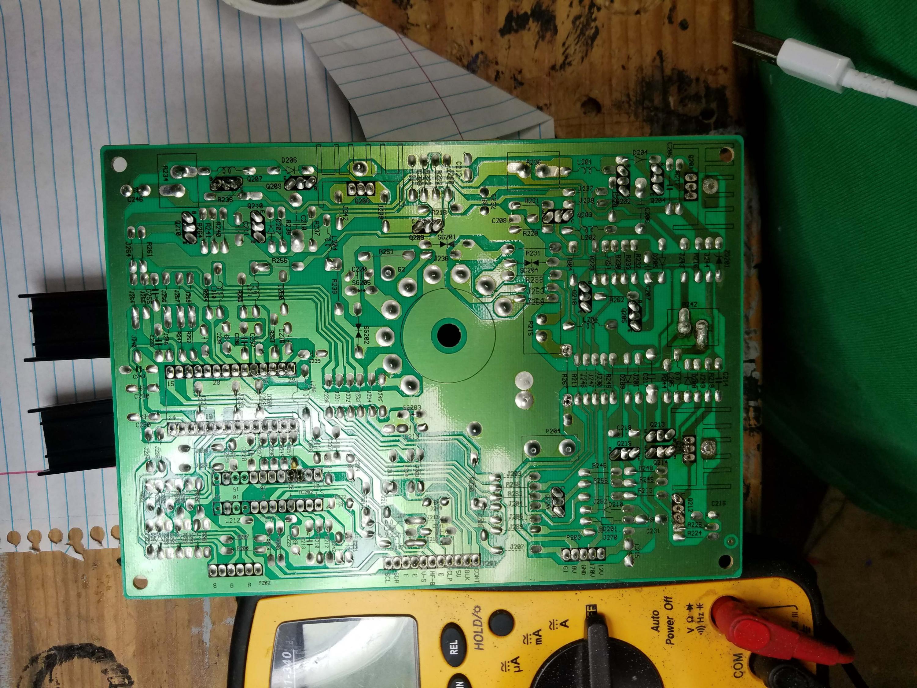

WGM2792 Arcade Monitor Resistor Burn Off On Neck Board *Need Help*
    replied
    Re: WGM2792 Arcade Monitor Resistor Burn Off On Neck Board *Need Help*
    can you meter the pins on the back of the tube,
    all combinations.
    most will show nothing.
    what we are looking for is if the gun related to that resistor is shorted to something else - such as the heater!
    Leave a comment:
  • proaudiosoft
    replied
    Re: WGM2792 Arcade Monitor Resistor Burn Off On Neck Board *Need Help*
    Originally posted by stj
    q206 has broken solder joints, the narrow chip needs completely resoldering,
    the resistor that fell out needs re-soldering.
    by resoldering i mean remove the old solder first.
    I went ahead and pulled the Big board out too. If I cant get it, I am going to send the boards out to be repaired. Here are front/back pics if it helps anything
    Last edited by proaudiosoft; 09-02-2016, 09:38 PM.
    Leave a comment:
  • proaudiosoft
    replied
    Re: WGM2792 Arcade Monitor Resistor Burn Off On Neck Board *Need Help*
    Originally posted by stj
    q206 has broken solder joints, the narrow chip needs completely resoldering,
    the resistor that fell out needs re-soldering.
    by resoldering i mean remove the old solder first.
    Yes, You are correct about q206, I am aware of the joints at that Transistor/sink. I believe it from recent handling and checking parts for solid mounting. And I know the Resistor needs re-soldering as well, I will make sure to remove the old first. I am afraid the trace on one end of r242 is trying to pull away from the board as well.
    I would rather try to figure out the issue before making all the final connections. Wouldn't this be a good idea?
    Would having a shorted q201 cause r242 to heat up? thx
    Leave a comment:
  • proaudiosoft
    replied
    Re: WGM2792 Arcade Monitor Resistor Burn Off On Neck Board *Need Help*
    Originally posted by stj
    so q212?
    Oh left that out, q212 looked ok as far as I can tell too. About .658 B2E / B2C and open E2B and C2B
    Last edited by proaudiosoft; 09-02-2016, 08:41 PM.
    Leave a comment:
    replied
    Re: WGM2792 Arcade Monitor Resistor Burn Off On Neck Board *Need Help*
    q206 has broken solder joints, the narrow chip needs completely resoldering,
    the resistor that fell out needs re-soldering.
    by resoldering i mean remove the old solder first.
    Leave a comment:
    replied
    Re: WGM2792 Arcade Monitor Resistor Burn Off On Neck Board *Need Help*
    so q212?
    Leave a comment:
  • proaudiosoft
    replied
    Re: WGM2792 Arcade Monitor Resistor Burn Off On Neck Board *Need Help*
    Originally posted by budm
    Picture of the bottom side of the board? You should also remove the black stuff and the glue off the board so we can see the Green paint lines on the top side of the board.
    Here Are pics of the front and back of the board, I removed the glue and black junk around r242... I have a few transistors unsoldered and a resistors with a leg pulled out...
    Leave a comment:
  • proaudiosoft
    replied
    Re: WGM2792 Arcade Monitor Resistor Burn Off On Neck Board *Need Help*
    Originally posted by stj
    r242, then looking at the schematic,
    check d208, q211, q212 for shorts.
    also, check the resistance of r215, and r267 in the heater circuit.
    r242 is measuring 1.333k, d208 test good, q211 looks good to me, its npn right? E C B is what sheet i found said.
    r215 reads 2.5 ohms (i think its marked 2), and r267 reads 1.1 ohm.
    Interestingly, i accidently wrote q201 down instead of q211 at first, i tested it pulled and got readings everywhere, looks bad. 201 and 211 are c35502e resistors. I am going to take pics of the board with glue off as Budm requested too... Hope this gives you more insight
    Leave a comment:
  • R_J
    replied
    Re: WGM2792 Arcade Monitor Resistor Burn Off On Neck Board *Need Help*
    That resistor is for the blue crt drive, even with it out you should get a picture, just missing blue. so I suspect once this fault is found there will be another
    Leave a comment:
  • proaudiosoft
    replied
    Re: WGM2792 Arcade Monitor Resistor Burn Off On Neck Board *Need Help*
    Originally posted by stj
    r242, then looking at the schematic,
    check d208, q211, q212 for shorts.
    also, check the resistance of r215, and r267 in the heater circuit.
    Will check and let you know, thanks!
    Leave a comment:
  • proaudiosoft
    replied
    Re: WGM2792 Arcade Monitor Resistor Burn Off On Neck Board *Need Help*
    Originally posted by budm
    Picture of the bottom side of the board? You should also remove the black stuff and the glue off the board so we can see the Green paint lines on that resistor.
    ok, budm, will do when i get back from dinner
    Leave a comment:
    replied
    Re: WGM2792 Arcade Monitor Resistor Burn Off On Neck Board *Need Help*
    r242, then looking at the schematic,
    check d208, q211, q212 for shorts.
    also, check the resistance of r215, and r267 in the heater circuit.
    Leave a comment:
    replied
    Re: WGM2792 Arcade Monitor Resistor Burn Off On Neck Board *Need Help*
    Picture of the bottom side of the board? You should also remove the black stuff and the glue off the board so we can see the Green paint lines on the top side of the board.
    Last edited by budm; 09-02-2016, 05:12 PM.
    Leave a comment:
  • proaudiosoft
    replied
    Re: WGM2792 Arcade Monitor Resistor Burn Off On Neck Board *Need Help*
    Originally posted by stj
    what resistor is it on the pcb, so i can look at the schematics.
    It is resistor r242 (on Neck board Black spot in photo)
    Leave a comment:
    replied
    Re: WGM2792 Arcade Monitor Resistor Burn Off On Neck Board *Need Help*
    what resistor is it on the pcb, so i can look at the schematics.
    Leave a comment:
  • proaudiosoft
    replied
    Re: WGM2792 Arcade Monitor Resistor Burn Off On Neck Board *Need Help*
    Update, The resistor I soldered back in desoldered it self and came out again. grrr. Something is definitely making that resistors joints heat up to the point its falling out. Any and all help appreciated.
    Leave a comment:
  • proaudiosoft
    replied
    Re: WGM2792 Arcade Monitor Resistor Burn Off On Neck Board *Need Help*
    Originally posted by R_J
    Do you have the any of the voltages on P203? +8 volts is for the heaters, if you don't have it, check back to the power supply on D811 and R858
    Yes, I have +8.63v dc at 203, also 12.3v, and 69v but still no glow?
    Last edited by proaudiosoft; 09-02-2016, 01:34 PM.
    Leave a comment:
  • R_J
    replied
    Re: WGM2792 Arcade Monitor Resistor Burn Off On Neck Board *Need Help*
    Do you have the any of the voltages on P203? +8 volts is for the heaters, if you don't have it, check back to the power supply on D811 and R858
    Leave a comment:
  • proaudiosoft
    replied
    Re: WGM2792 Arcade Monitor Resistor Burn Off On Neck Board *Need Help*
    Could IC201(video amp) cause the tube to not even glow if it failed?
    Leave a comment:
  • proaudiosoft
    replied
    Re: WGM2792 Arcade Monitor Resistor Burn Off On Neck Board *Need Help*
    Originally posted by stj
    check between the transistor leg for shorts, although i suspect you have other problems - the heater is not related to gun-drive.
    The Transitor is a c3502e. it appears that it is a npn type from the data sheet i found online. E C B.
    I get .682 base to emmiter, and .679 base to collector.
    emmiter to base and collector to base shows open. from what I can tell its good.
    what should I do from here?
    Last edited by proaudiosoft; 09-02-2016, 11:43 AM.
    Leave a comment:
    by momaka
    03-15-2023, 10:17 PM
  • ttmi100x
    HANNSG Hi221 -- 2 secs to black feat. CCFL flicker & "burn" marks on power board
    by ttmi100x
    Greetings everyone,
    I have a HANNSG Hi221 monitor that exhibits two seconds to black issues (backlight goes off, display is still on as confirmed by shining a flashlight on it) with some additional oddities...
    The monitor failed on me with a standard "2 seconds to black" some time ago prompting me to initially replace most of the electrolytic capacitors (some of them were bulging/leaking).
    Things kinda sorta worked for a night, then the problem returned along with some flickering and "buzzing" noises.
    Upon closer inspection...
    07-31-2024, 06:36 PM
  • Safrilhg
    Look for the resistor value in the BenQ G922HDAL monitor's power supply
    by Safrilhg
    Hello guys, I had a problem where I didn't know the value of the burnt SMD resistor in the power supply circuit of the BenQ G922HDAL monitor.
    In one of the parts, there is a burnt SMD resistor which leads to the LD7560GS IC as shown in the picture below.
    How to determine the appropriate SMD resistor value for this condition? Thank You...
    11-06-2023, 12:43 PM
  • redbaron1007
    Arcade PSU blown resistor ID
    by redbaron1007
    I'm working on one of the PSU's in my backlog today that came out of an NBA Jam arcade machine a year or so ago. The PSU is a Pan Yes brand with a model number PY-TV-C. From what I remember the 12v rail wasn't outputting anything. I opened it up and was reminded that the resistor at R28 had blown it's shell off and I have no idea how to ID a replacement for it. (see pictures) The color bands that are still intact a little are brown, black, missing band/bands, and what I'm assuming is silver. When I check it with my DMM it's reading 100ohms exactly but I don't know if that's what it's supposed...
    01-06-2023, 04:13 PM
  • wattage
    AOC AG493UCX 49-inch monitor - Firmware request
    by wattage
    Hello Badcaps Community,
    I purchased a preowned AOC monitor that is not working and out of warranty. It was sold as not working. I am looking for guidance on self-repair. In particular, I am after the firmware for the monitor. At the end, I have included monitor model information and links to pics and vids of the issue.
    The problem is that it will not display a picture on any of its inputs. And the on-screen menu does not appear. The power button works properly. It powers on with the remote as well. But the on-screen menu does not appear, even when not connected to any...
    07-13-2025, 04:41 PM
