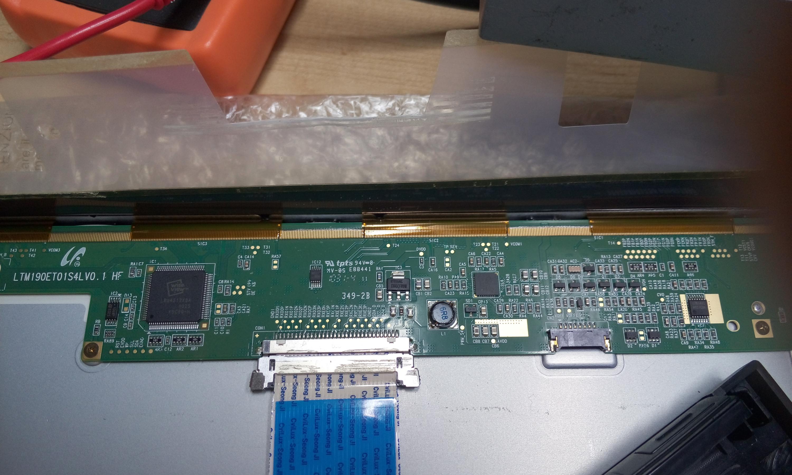

    I got this Samsung B1940 which got the following symptoms.
    When I connect to a pc and turn the video on the blue LED turns on firmly, but screen is blank, actually I should say the screen is white. Same problem with VGA and DVI port.
    If I wait let's say 5 minutes the video starts blinking, I guess because of standby.
    I opened it up and couldn't see any visible problems; I measured all the caps with an ESR meter and the majority are in the 0.0x ohms range.
    I measured the voltages on the secondary and they seem fine too.
    With power button of the video turned ON:
    B-Dim: 3.257V
    +13V: 12.71V
    GND: 0V
    GND: 0V
    GND: 0V
    +5.1V: 5.12V
    +5.1V: 5.11V
    N.C.: 0V
    O/F: 3.083V
    With power button of the video turned OFF:
    B-Dim: 3.261V
    +13V: 13.27V
    GND: 0V
    GND: 0V
    GND: 0V
    +5.1V: 5.12V
    +5.1V: 5.11V
    N.C.: 0V
    O/F: 0V
    I looked at the logic board and couldn't visually detect problems there, all SMDs which seem fine.
    Could someone please tell me what to check next?
    Thank you very much

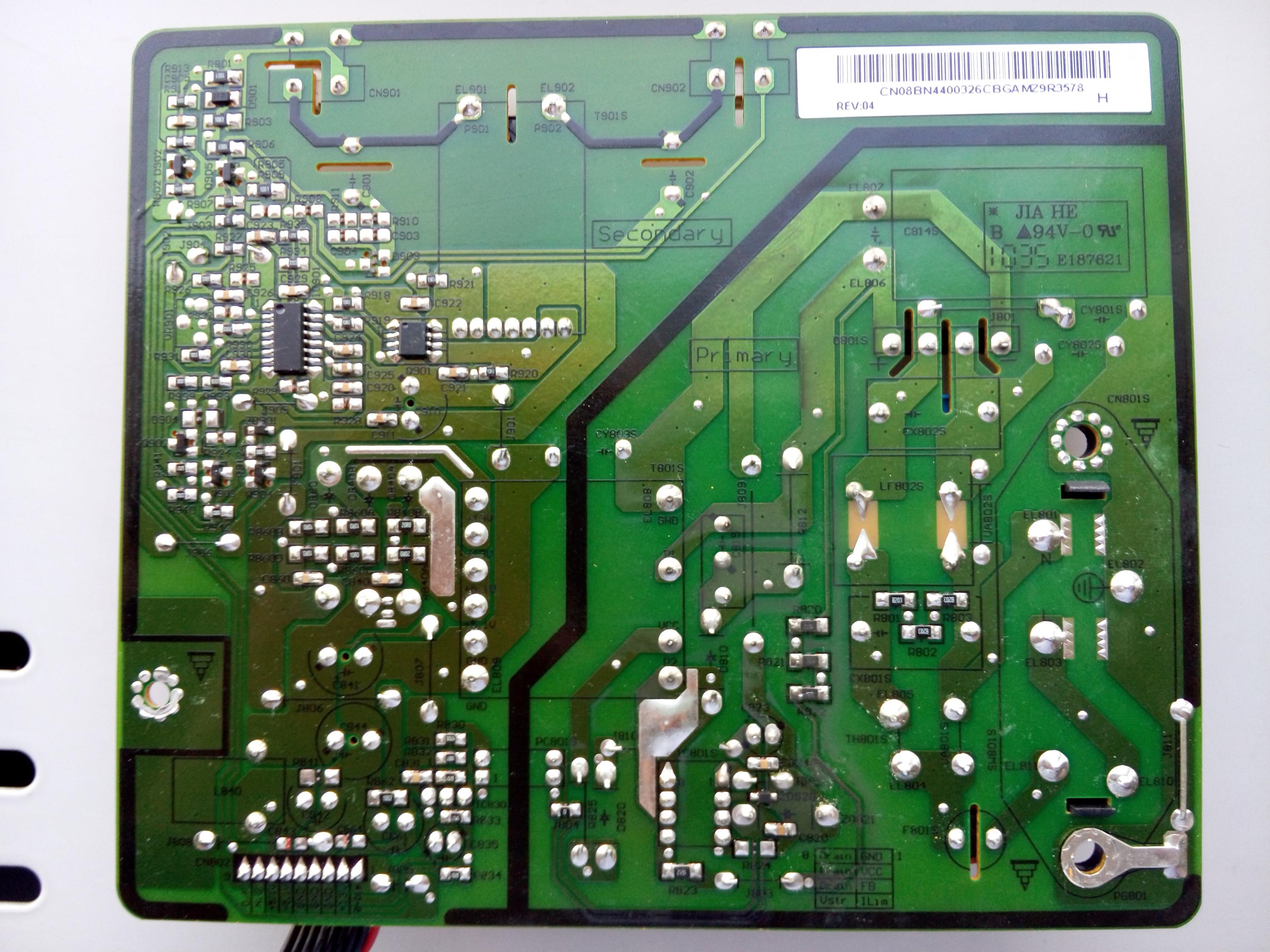

    Re: Samsung B1940 blue LED but blank screen
    The Voltages and the signals are fine.
    Fuse F901 OK? It supplies B+ to run the Inverter circuit so it should have 13VDC at both ends with ref. to GND.
      Hi budm,
      I managed to measure both ends of F901: 13.31V
      So are you telling me that power board seems fine? Maybe I should look elsewhere? in the T-Con board maybe (never troubleshot such a board before)? The main symptom for this lcd is a white screen.

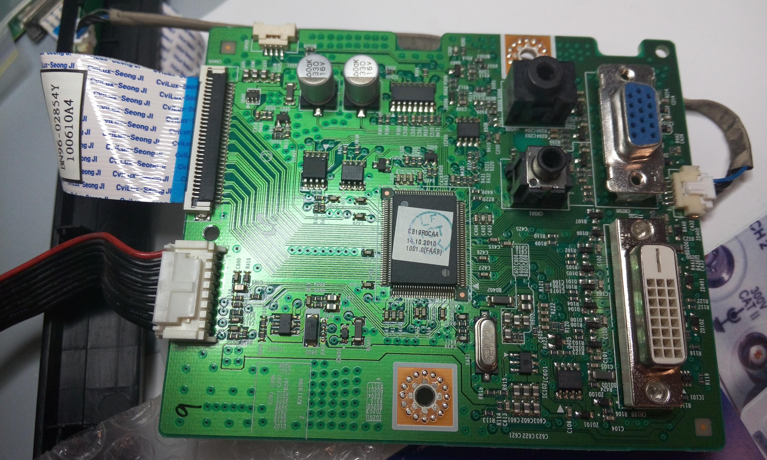

        One thing that I didn't mention is that this video has got integrated audio. So one thing that I can check is if sound at least comes out of it, so maybe I can rule out power supply issues. Let me try and I'll post the results.
        • robcar
          • Nov 2015
          • 26
          • Italia
          So, I wasn't able to hear audio, don't know if it was because I was missing something macroscopic...

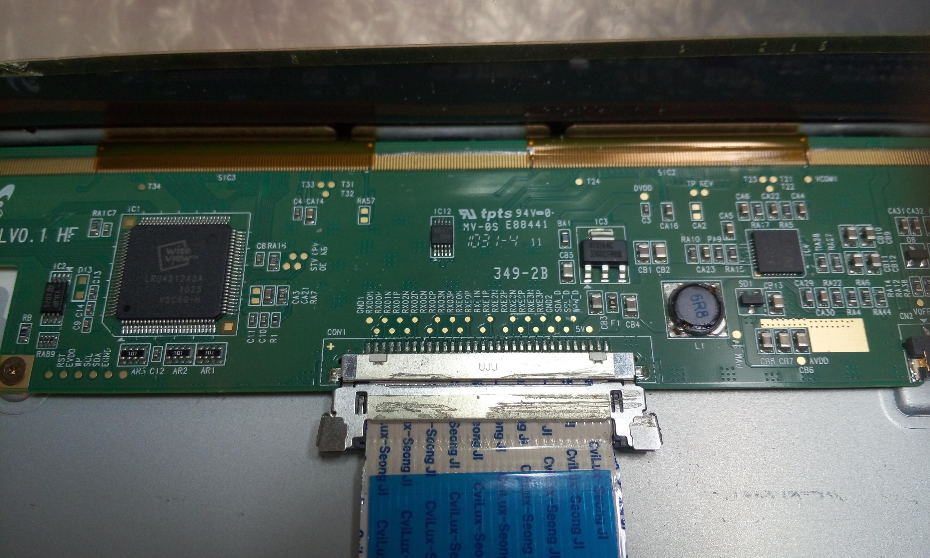

          Anyway I attach other pics, one of the digital board and two of the T-Con.
          I was able to do measurements on the T-con contacts, just above the flat cable (I guess LVSD something ).
          Here they are:
          GND1: 0V
          RX00N:1.361V
          RX00P:1.130V
          RX01N:1.365V
          RX01P:1.132V
          RX02N:1.337V
          RX02P:1.150V
          RX0CN:1.259V
          RX0CP:1.289V
          RX03N:1.361V
          RX03P:1.127V
          RXE0N:1.363V
          RXE0P:1.139V
          RXEIN:1.364V
          RXEIN:1.136V
          RXE2N:1.344V
          RXE2P:1.162V
          RXECN:1.256V
          RXECP:1.289V
          RXE3N:1.358V
          RXE3P:1.132V
          GND2: 0V
          SDA_D:3.76V (cool: I2C bus )
          SCL_D:3.84V (i2c clock)
          WPN_D: 0.44V
          5V: 5.10V
          Now I have to go BUT it seems like F1 on the T-Con is broken! It is located just above the T-Con connector, on the right. So I'll have to check it further when I come back.
          • robcar
            • Nov 2015
            • 26
            • Italia
            So F1 on the t-con was blown. I managed to order a bunch of 3A SMD 0603 fuses, to desolder the blown one with ChipQuik and to solder one of the new teenie-tiny bastards.
            Then I made some measures; continuity was fine across it and also between the lead facing the flat cable of it and one of the legs of IC3 shown in the third pic.
            So I connected back everything again: nope, still white background, even if I got brief flashes of black. Disconnected cables, made measures: new fuse blown...
              ic3 is a 3.3v regulator please check all pin in IC3 to GND.mybe IC3 damaged or IC4 and IC1 vcc shorted to gnd.
              • robcar
                • Nov 2015
                • 26
                • Italia
                Thanks for the tip; IC3 is fine, but CA16 is shorted. That one should be a cap.
                Now the question is: how can I tell its value? I guess I cannot...
                      Thanks,
                      so it happens that CA16 wasn't itself shorted. After having removed it the pads underneath are shorted. And I figured out there are many more other caps that appear shorted to ground (sorry folks, I'm such a newbie and need to learn), namely: CA5, CB6, CB7, CB8. Then a pair on the left around the big chip. So it appears clear to me that there's a short somewhere, but where?
                      @boyebaran: hot air sucks, I have a station that just doesn't seem to work. I found
                      ChipQuik easy to use, even if bloody expensive.
                          Are you positive that T-con blows new fuses?
                          Here's what I want you to understand: there may be short on the rail somewhere, and it blows your fuses and reads low on ohmmeter,
                          BUT
                          there may be one component along that rail which normally reads low on the ohmmeter and makes confusion.
                          You need to clarify how do you measure for short, using continuity on your meter, ohm setting or diode setting. That's why I'm writing this.
                          If you're positive on short, you can try what boyebaran suggested:
                          You could take desktop PSU or something similar and inject voltage to shorted rail. Voltage should be close to max voltage that rail is designed to withstand for best results.
                          Once you injected voltage, you feel with your hand for component which is the hottest, and that is your shorted component. However, for obvious reasons (too high V could kill many of your components), you have to know what are you doing before trying this.
                          Another, harder way would be to take sensitive ohmmeter and measure along the shorted rail. As you approach actual shorted component, the resistance will be slightly smaller and smaller. Patience required, ofcourse.
                          The actual reason why I brought BL up is that you haven't made clear if you have white screen as in white pixels or white screen as in screen to bright to see anything because of too strong backlight...
