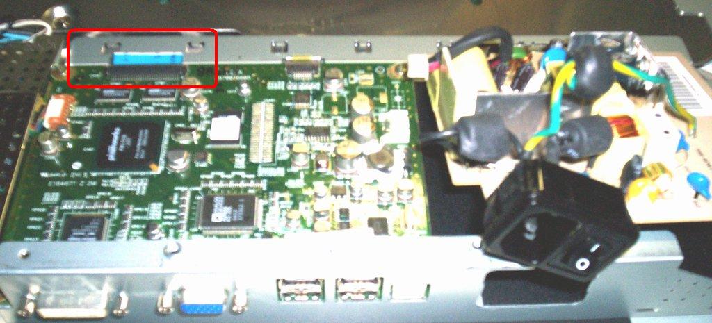

                  Re: Bad Viewsonic LCD monitor

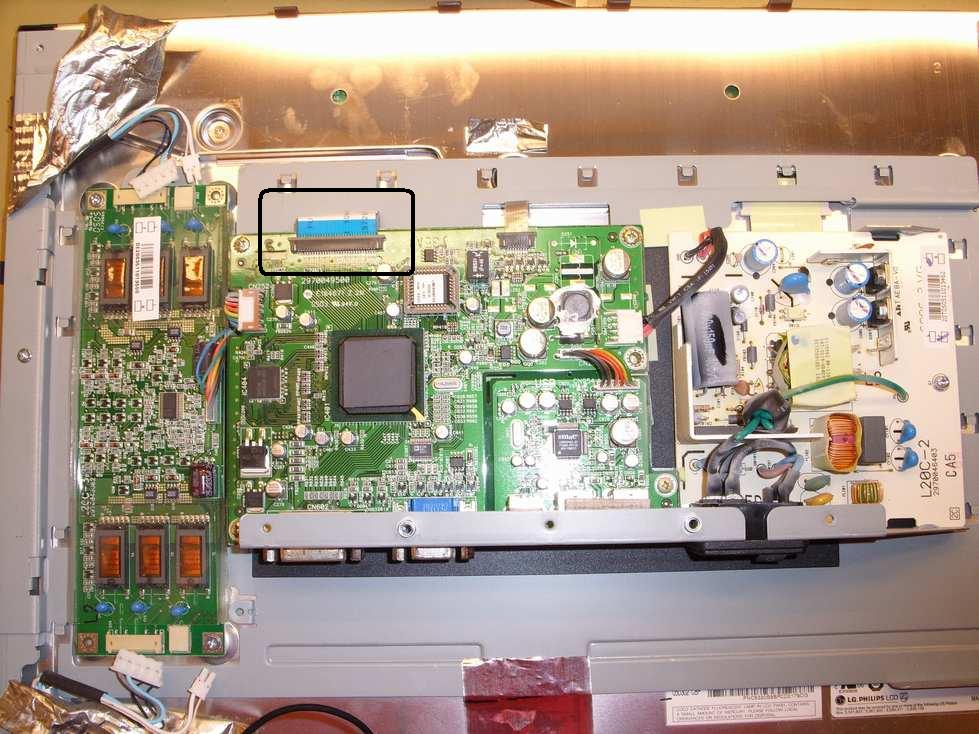

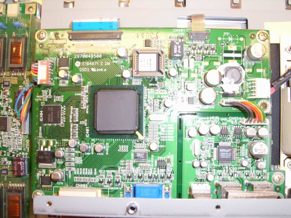

                  Hi y'all again. Finally managed to open the thing up. Didn't see any obvious signs (for me that is) of what the problem could be. The only thing that struck me was this white powder in the power supply section, is this normal?
                  See attached pictures and let me know if you find anything weird on them.
                  Thx all!
                    Thx all!
                    I personally use a VP201b and have two VP211b with cracked screens (one of them with a bad inverter, and I have not checked it since the screen is broken anyway), and none of them had that powder. FYI, the PSU and inverter are exactly the same between them. The lamps I don't know, but the controller/VBoard is different (20.1" --> 21.1").
                    If you need pictures, I can post them. I have the boards around here.

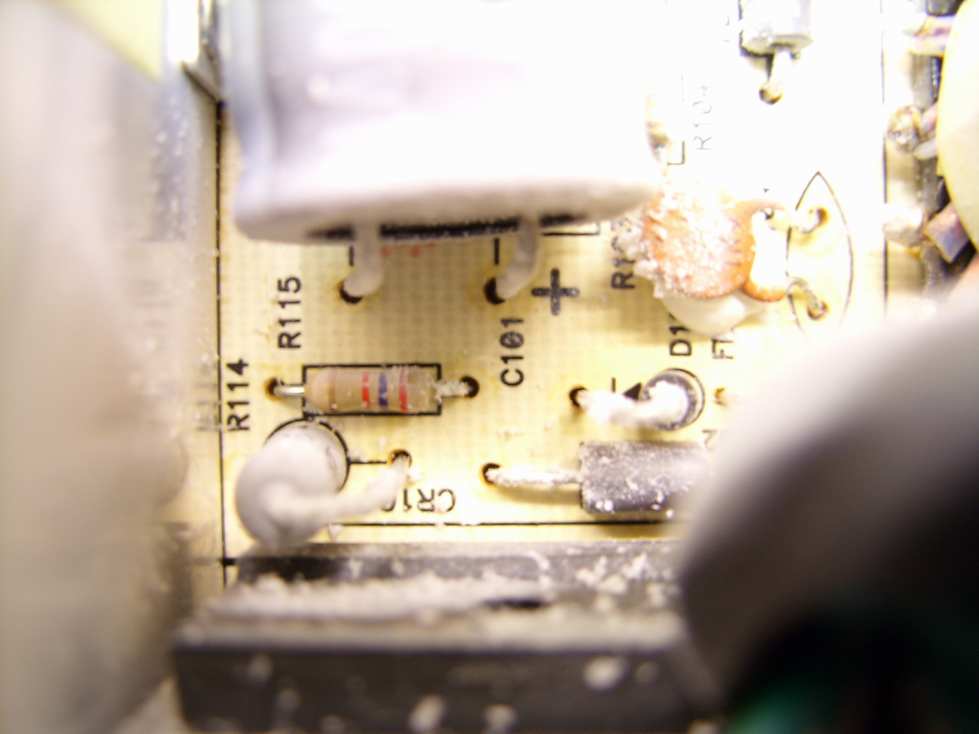

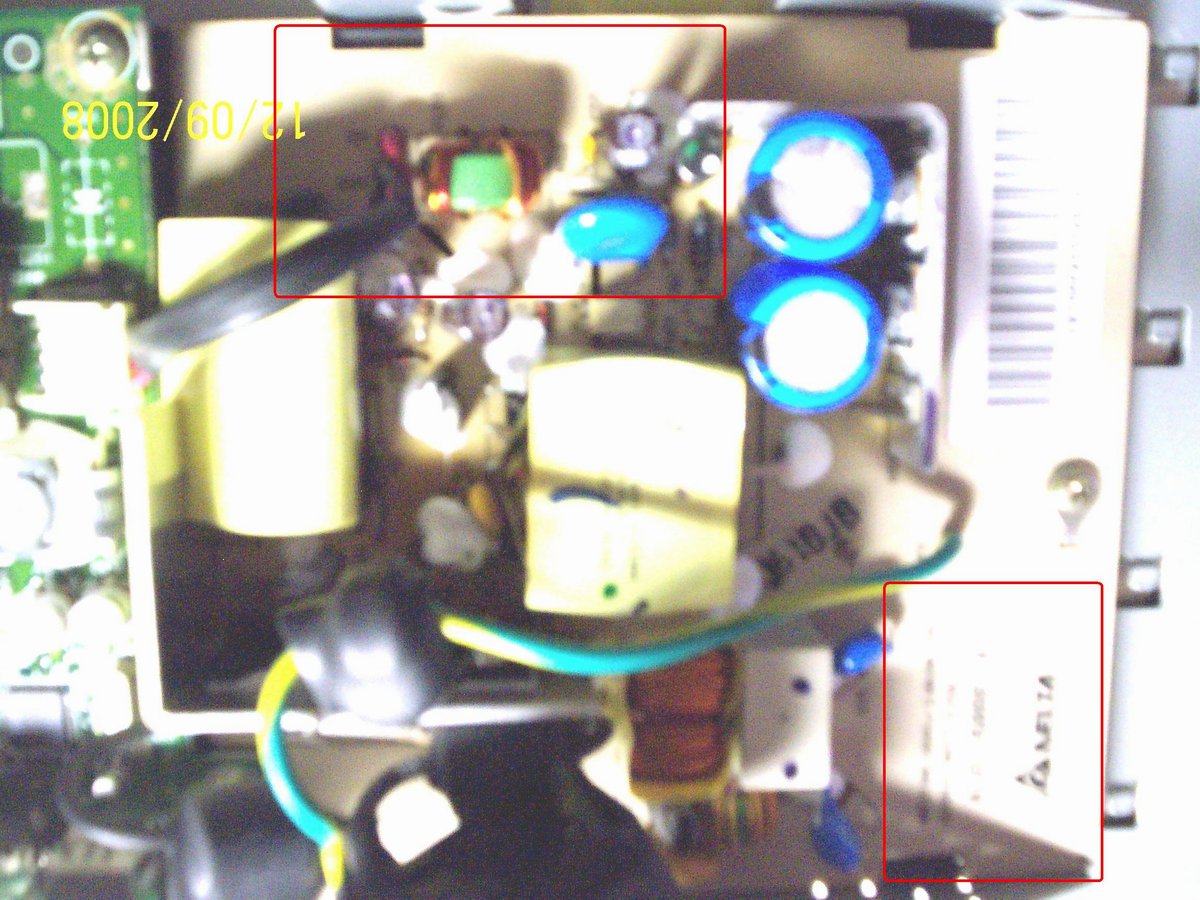

                      I've looked a little more into this and it seems that the powder comes from the thermal paste applied to the transistor marked in the image below. Is this a normal reaction of thermal paste? Is it from heat, or what do you think?

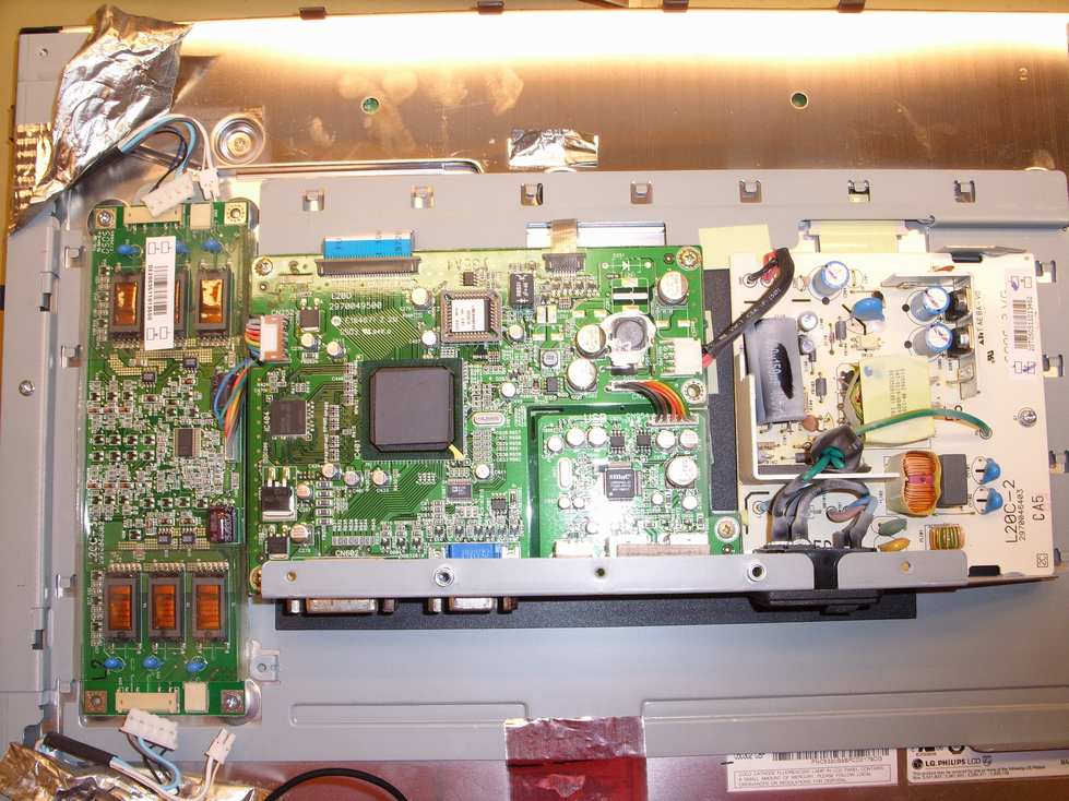

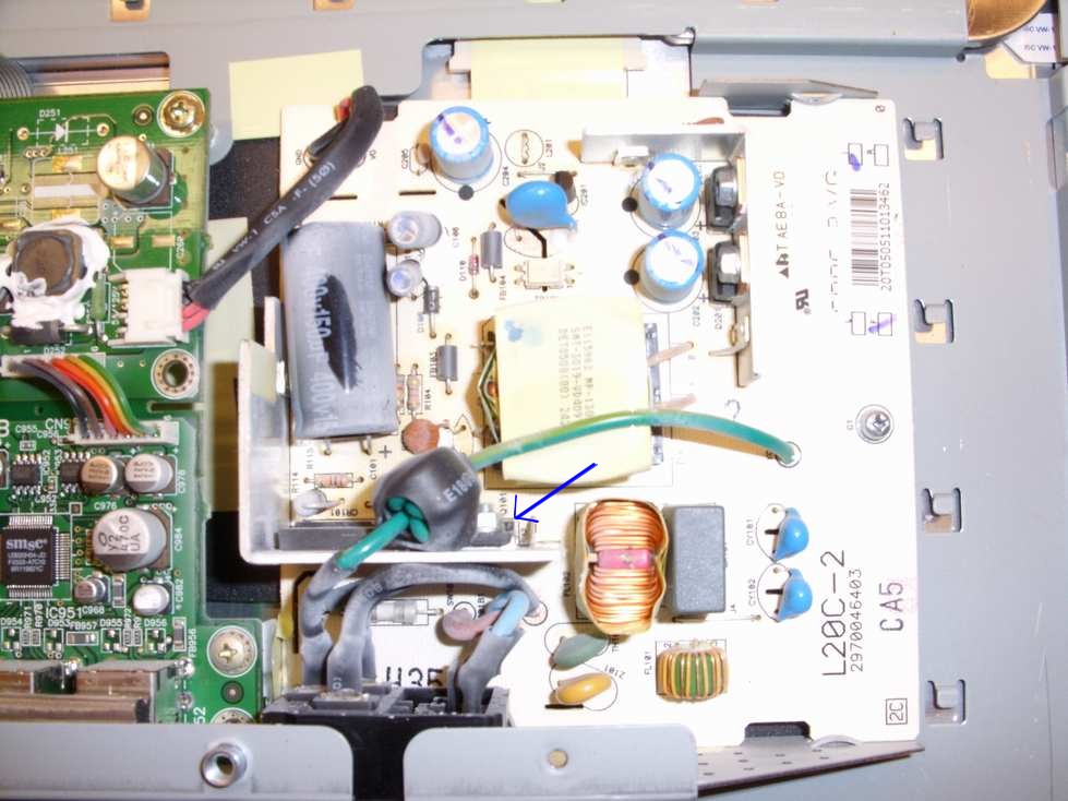

                      • EGuevarae
                        • Nov 2008
                        • 1336

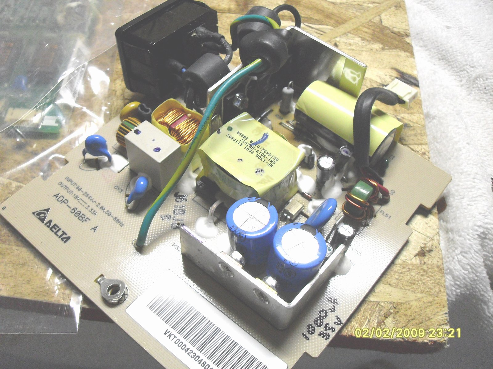

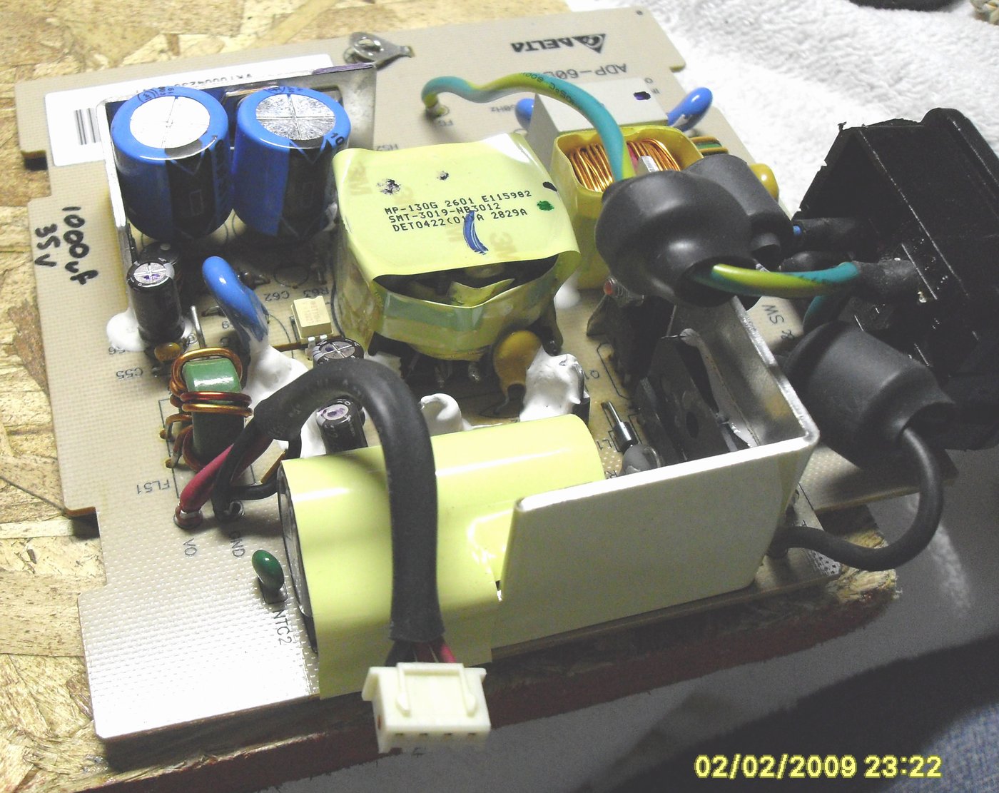

                        Looks like we have the same monitor, yet different inner components.
                        Look at the pics of my PSU. It has only two "big, fat" caps (1000uf 35v).
                        Also, the transistor layout is different. As you can see, I don't have the "white powder" problem. Look at the pics. I think that the connector referred early in the thread is the one I marked in both your boar and mine. I've seen that problem on Dells (E171FP) and Proviews (716s/776s - My wife is using one of those "loose connector" kind of monitor, and so far, no problems in two months), and even on a Polaroid 19"LCD I got on eBay that "had bad image" and ended up just being a remove and reseat op on that ribbon.
                        Maybe if you remove, inspect (clean) & reseat the ribbon, your problem will be gone.
                        Not too much connectors to check either:
                        • DC input from PSU
                        • I/O from USB daughterboard (in your case. My board does not have that card as a separate one)
                        • I/O from front panel controls (narrow flat ribbon to the right)
                        • Inverter I/O
                        • LCD Panel I/O (Wide flat ribbon, on the left)
                        The left ribbon might be the culprit.

                          To me it looks like we have the exact same layout, the only thing with your pics is that they are taken from different angles, or? And that your big capacitor is hidden under some kind of plastic cover...
                          • EGuevarae
                            • Nov 2008
                            • 1336
                            If you are talking of the big fat cap on its side (the one with the wiped powder ot the top), It is the input cap, and mine has it, as you said, covered in plastic. But I notice a small difference in the boards (besides yours being a Delta L20C-2 and mine being a Delta ADP-60BF A). In my case, I have two 1000uf 35v caps, then an inductor, and your board looks as if it has three 1000uf 35v. Also, the layout of the main board is different, regarding the USB hub portion mainly. Just a note because they are the same model but different on the inside. As for size, they look to be interchangeable with either my PSU or my Main Board.
                            Did you try to remove and re seat the ribbon?

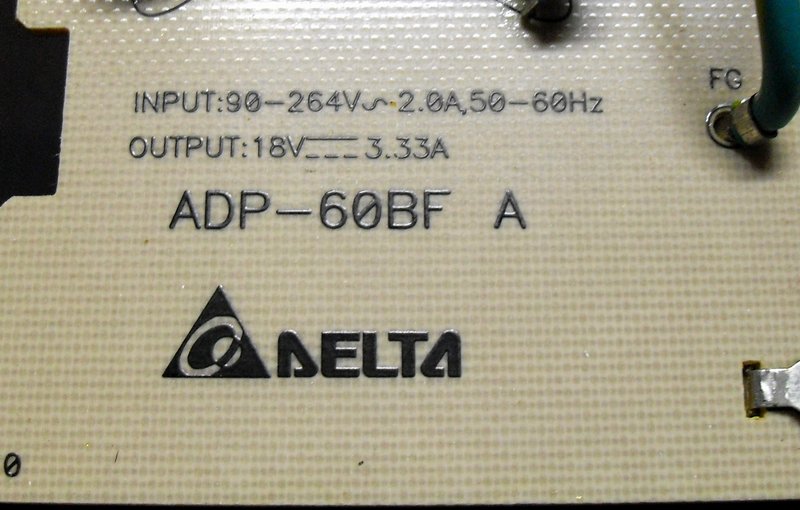

                                  • EGuevarae
                                    • Nov 2008
                                    • 1336
                                    Crazy Idea.
                                    How difficult and expensive would be for you to get your hands on a 18v 3.5/4 amps adapter?
                                    That is the PSU's output to the main. You could inject the voltage from the adapter to the board and see what happens. You would not exceed the V needed for the board, and provide the 3.33amps needed. Someone around here correct me if this is a bad idea.

                                      I've been fighting with the 21" version of this monitor (VP211b). It was a freebie I picked up locally, probably a discard by a company upgrading their computers.
                                      The initial symptom was a black screen; the power LED would turn green if hooked up to a working computer, but the display was black. When I opened it up I noticed a white deposit on the back of the case above the power supply. It looked a little like frost. After a LOT of struggling (I hadn't found this site yet) I discovered that F1 on the inverter board had blown. Replacing it brought up a stable display, so it gets hooked up to a computer for an extended run.
                                      Just as I was patting myself on the back (about half an hour later) I notice the display is jumping side to side - only one or two pixels, but ??? After another 10 minutes it has gone completely - breaking up so the top half of the display is on the bottom, the 'No signal on DVI-D' icon is appearing and disappearing, etc.
                                      When I found this thread the 'substitute power supply' idea triggered what few remaining brain cells I retain. Through perfectly legitimate channels I have a Kensington 120 Watt portable power supply. And with the N3 tip it puts out 18 volts.
                                      The monitor has been working well for the past 2.5 hours. It is very stable on both analog and digital inputs. SO now it's time to figure out what is going wrong with the power supply.
                                      One curious thing I noted. Initially I tested it without any signal input. The current drain (from the Kensington) was .88A with the 'no signal' icon on screen, .18A when it went into standby. I just checked again and it's drawing 2.45A with the DVI input active. Is there any chance this is due to the CCFLs dying of old age?
                                      Thanks for any suggestions; this is a great site.
