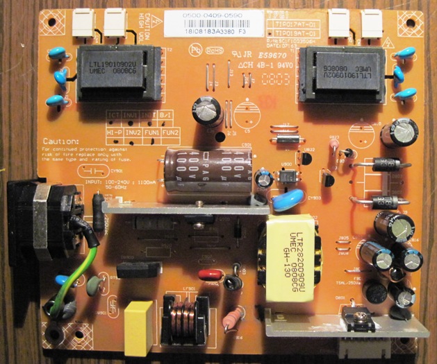

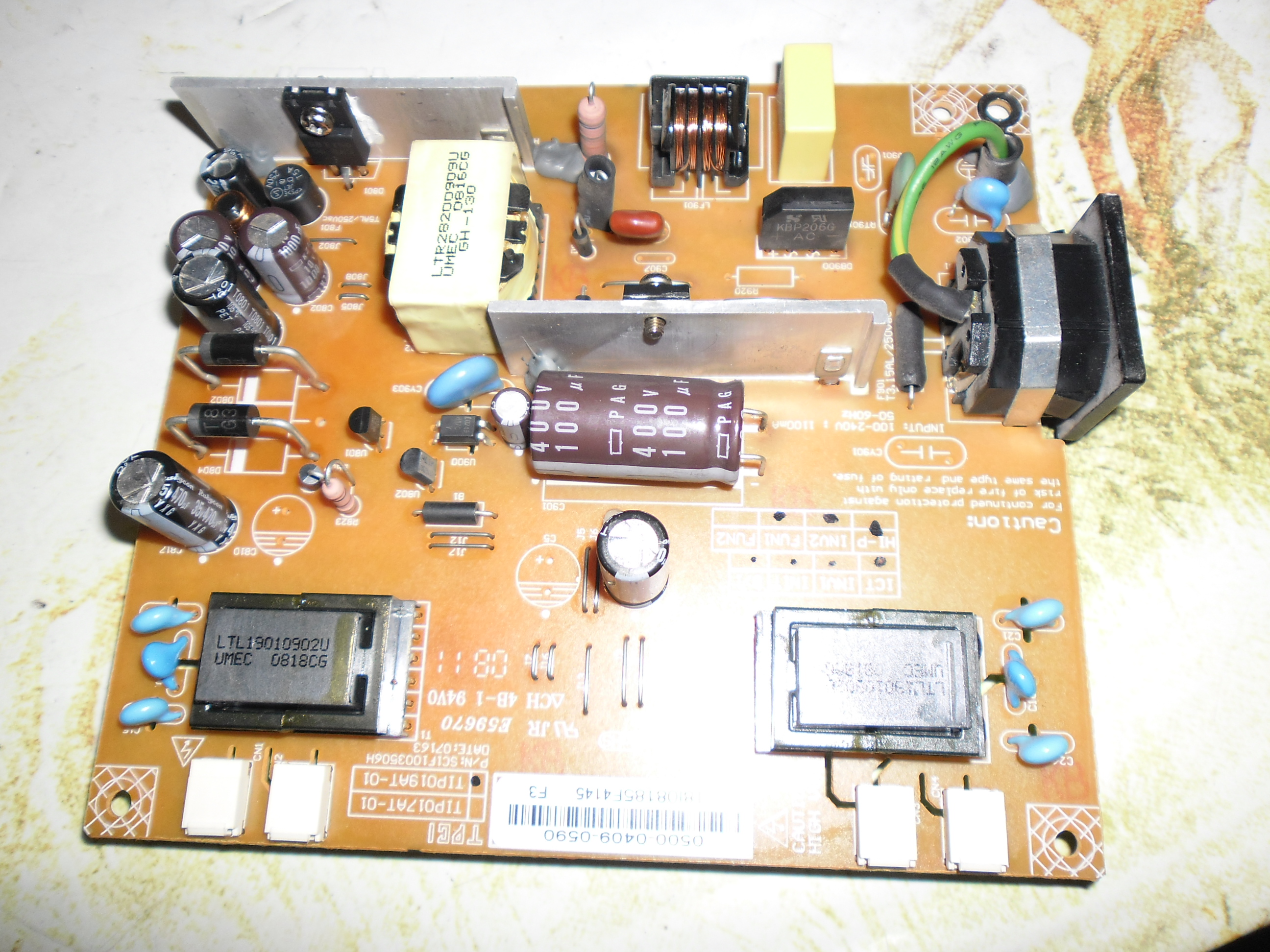

    This time i have a monitor which don't power on or stand by.
    PSU - tip019at-01
    Checked:
    STK0765 - not sure how to test mosfets (put com to source and then charge gate then red probe to drain - gives 1.500 for a sec.) so i'm not sure if it's OK
    SBT150-06 - Readings 135 ohms on the two anodes (i think it's ok)
    LD7575PS - VCC is 11.25V no shorted legs
    Both fuses are OK
    The output is 5.0V
    There is voltage to the main board and to the button board but there is no power on or stand by
    Checked the button board led - OK
    I don't have schematic for the psu...
    Thanks, again for your kind help and support !
    Best regards, ragis

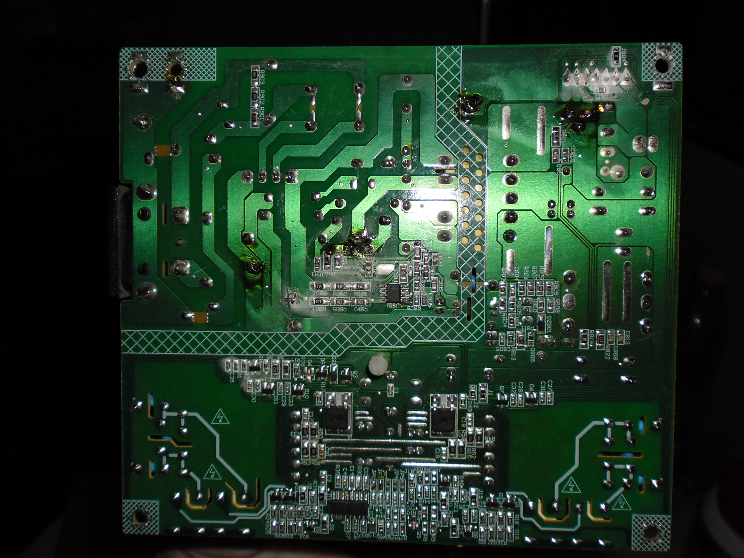

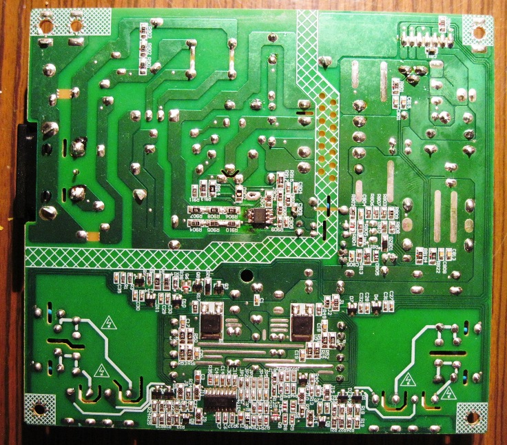

      Sorry for the photos, here's new ones
      On pin 3,4 - 5.10V
      pin 1,2,5,6,7 - 0V
        • 30979
        Re: ASUS VK191S - no power
        there are a lot of cracked solder joints on that - and i'm not refering to the flux covered resoldered pins.
          The solder joints are ok, it seems like that from the flux i used around the pins
          But i can resolder them if you think there is a problem, could you be so kind to show me the cracked ones ?

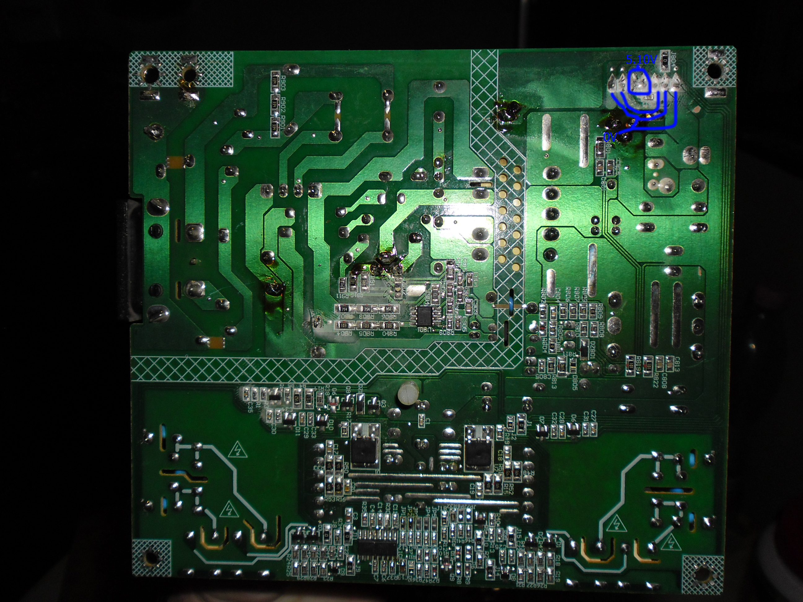

                i still see bad solder joints - NOT THE ONES YOU DID.

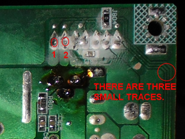

                  You can test the power supply/inverter board by itself.
                  I can see three small control line traces, two I can see, the third one I cannot see.
                  I suspect them to be BL-ON, PWM-DIM, ANALOG DIM.
                  You can disconnect the logic board from the power supply board, then solder 1K resistor between # 1 and the 5V pin, then a second 1K resistor between #2 and the 5V pin to see if the backlights will come on the second you plug the monitor into the AC outlet, if not add another resistor between # 3 (which I cannot see due to cruds on the pins) and the 5V.
                  The surge may have come through the Video connections.
                  • ragis
                    • Mar 2013
                    • 51
                    • Bulgaria
                    Ok, so i added 3 1K resistors to the 3 pins and then without logic board i plugged the monitor in AC and the backlight started blinking.I think that means the inverter is OK.But why it can't power on the monitor and even go to stand by mode... What can i do now ? Thanks again for the help to check the inverter
