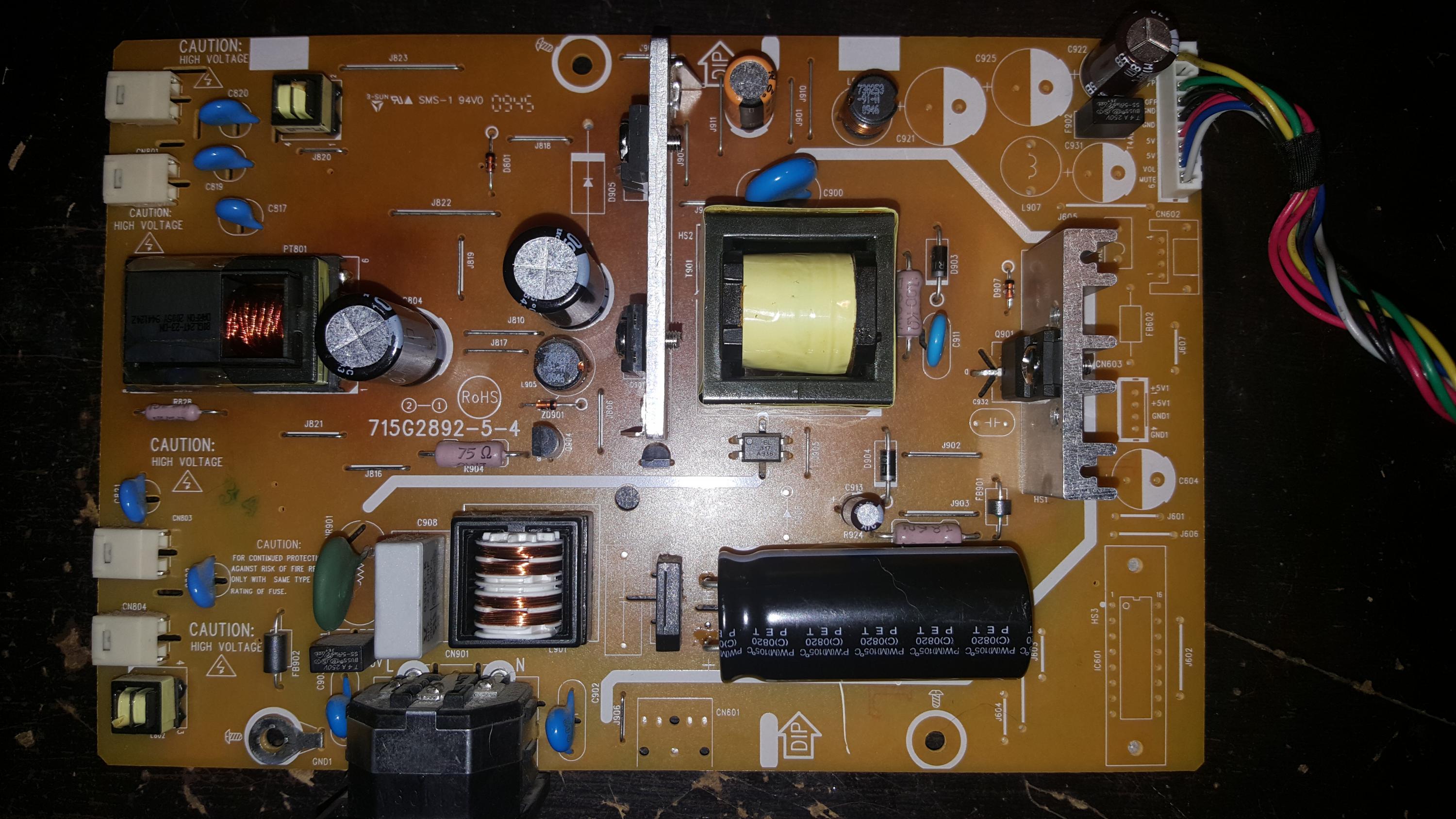

    AOC 2236Vw (TFT22W90PS) Blue power light flashing, no video
    I have a AOC 2236Vw, Model TFT22W90PS
    The monitor refuses to power on. When I plug the power cord, the monitor's blue power light turns on, then after about 1 second, I hear a faint "tick", and the power light shuts off.
    I disassembled, and found "Elite" brand caps. None looked out of the ordinary, but I replaced them anyway, with Nichicon VZ series I had laying around. One cap I did NOT replace, was the orange cap labelled C920, an "Elite GP" series which I couldnt find a datasheet for a suitable replacement.
    Replacing caps had no effect.
    I also suspected the CCFL lamps may be bad, so I plugged in a couple of spares out of a Dell monitor.
    Replacing CCFL lamps had no effect
    At this point I'm chasing my tail, I don't know what else to look for. The board is heat-checked around the inverter transformer, but I see no other signs of damage.

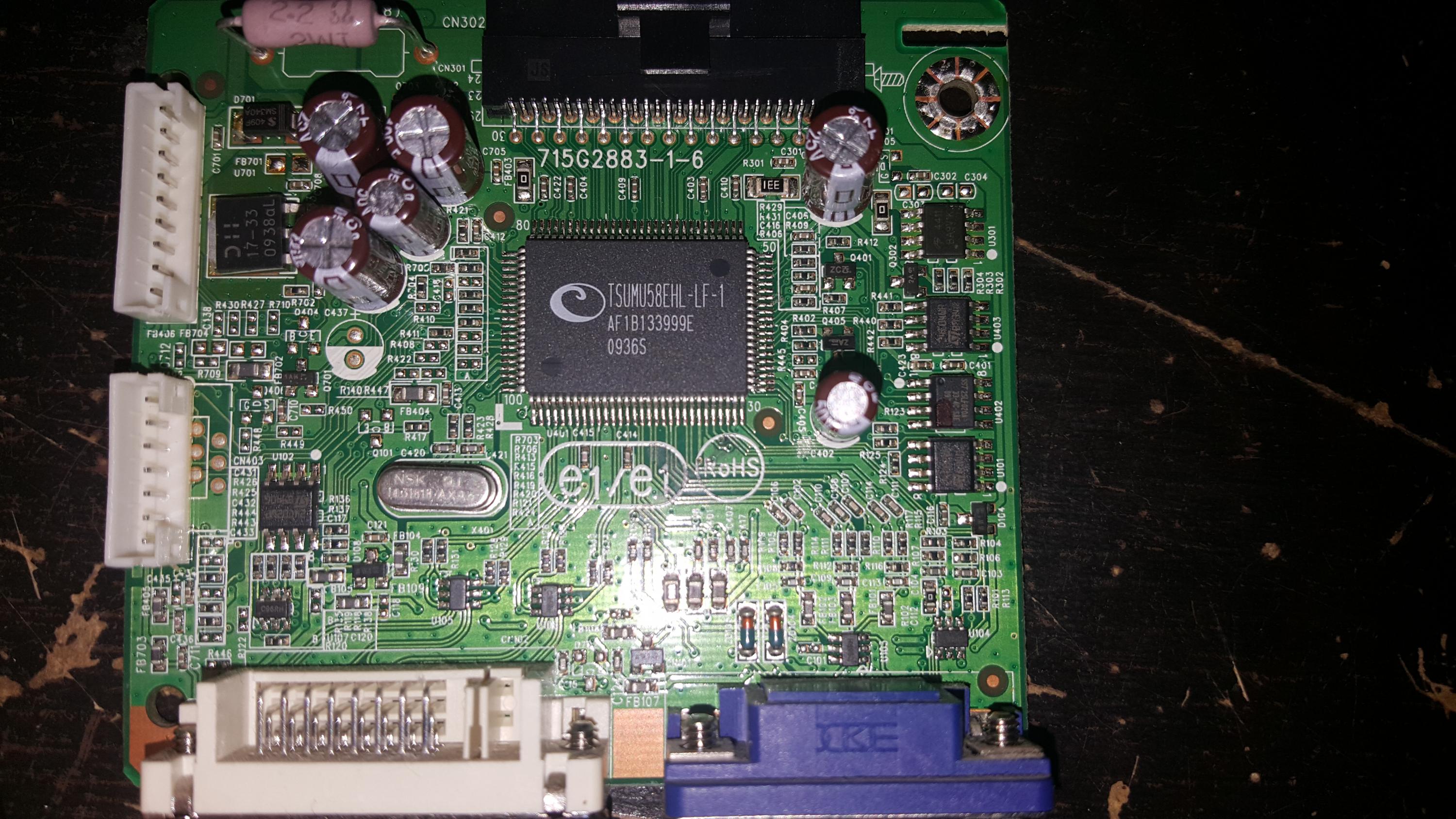

    This looks like a very common design power supply, and the logic board looks identical to ones out of many threads I've read.
    Any suggestions to what I should look for next?

          Re: AOC 2236Vw (TFT22W90PS) Blue power light flashing, no video
          Q805 & Q806 Resistance check (Source-to-Drain)
          Q805
          Pin 1 to common drain = short, 0 ohms
          Pin 3 to common drain = short, 0 ohms
          Q806
          I'm inferring from the other thread that these shorts would overload the power supply. Are these components the cause?

            well, it appears that the shorted mosfets are no longer shorted once I removed them from the circuit.
            • fuxxy
              • Jan 2013
              • 318
              Removed backlight driver FETs Q805 & Q806
              Power supply starts up, steady 5V and steady 16V output. (no backlights, obviously. Image is displayed on screen when lit with flashlight)

                Reinstalled FETs Q805 & Q806.
                Installed a 4.7Kohm resistor between backlight driver IC801 "timer" pin 12 and GND to disable shutdown. Original symptoms persist. Backlights flick momentarily before PSU shuts down.
                • fuxxy
                  • Jan 2013
                  • 318
                  Removed 4.7K ohm resistor. Removed backlight IC801 completely.
                  Power supply does not start up at all. No 5V or 16V output. (5V rail provides ~3V unsteady voltage)
                      With Q805 & Q806 installed, I get
                      Q805
                      S1 to drain = 1.4 ohms
                      S2 to drain = 0, dead short.
                      Q806
                      With Q805 & Q806 removed from circuit
                      Chip Readings:
                      Q805
                      S1 to drain = Roughly 10 MegOhms, and falling
                      Q806
                      S2 to drain = DMM reads "OL", open circuit
                      Board itself:
                      Q805
                      S1 to drain = Open
                      S2 to drain = Open
                      Q806
                      S1 to drain = Open
                      S2 to drain = Open
                      (this is understandable, on this board the common drains on each FET connect only to each pin of the inverter xfmr, nothing else)
                        So both MOSFETs (Dual-MOSFET P-CH/N-CH) are shorted out!
                        Chip Readings:
                        Q805
                        It is bad, shorted.
                        Q806
                        It is bad, shorted out.
                        The transfomer is driven by full-bridge setup, that is why it uses 2 dual-MOSFETs (N-CH/P-CH).
                        This will cause the power supply to go into startup/shutdown cycle when the current draw is too much.
                        • fuxxy
                          • Jan 2013
                          • 318
                          Would anything else on the board cause the shorted MOSFETs? Should I keep looking for a root cause, or replace the MOSFETS and call it fixed (If it works afterwards)?
                          I'll start looking for compatible replacements and return, thanks!
                            More likely the MOSFET just failed due to bad filter caps, as you can see the board around those two MOSFETs have dark color due to the heat from the MOSFETs.
                            Get the new MOSFETs and try.
                            • fuxxy
                              • Jan 2013
                              • 318
                              Replaced the two MOSFETs, and display works normally! Thanks for the help, budm.
