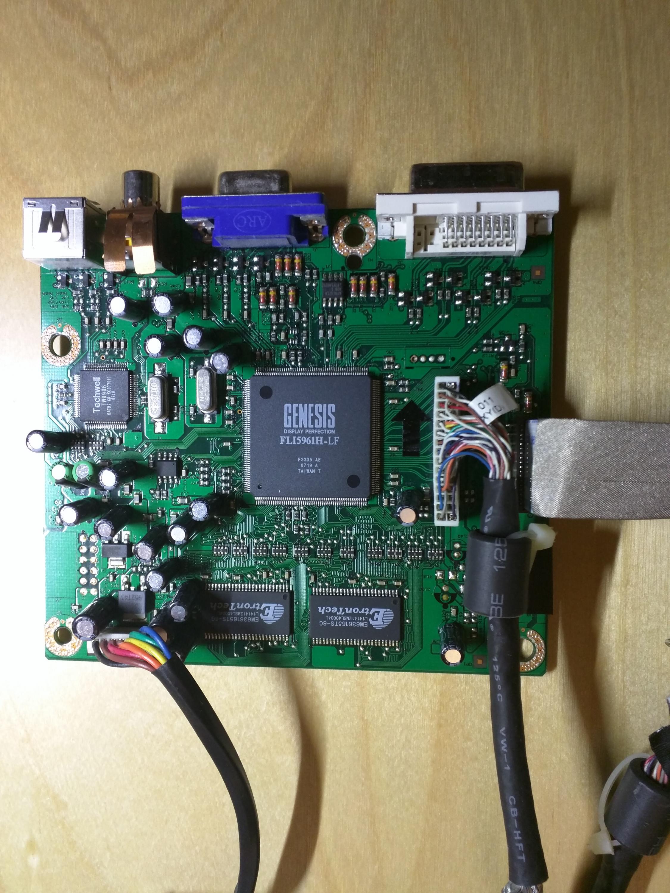

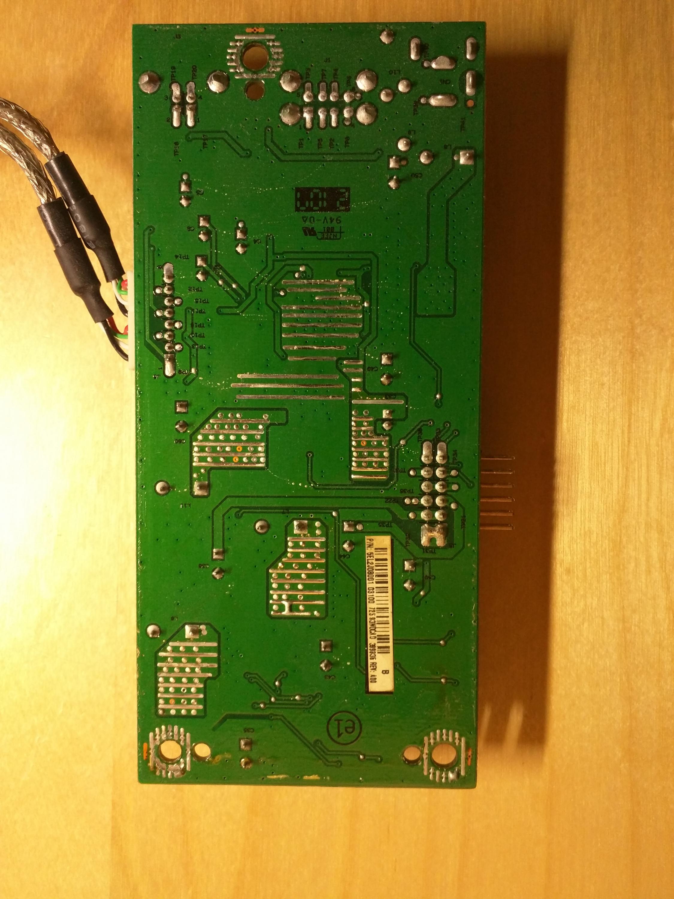

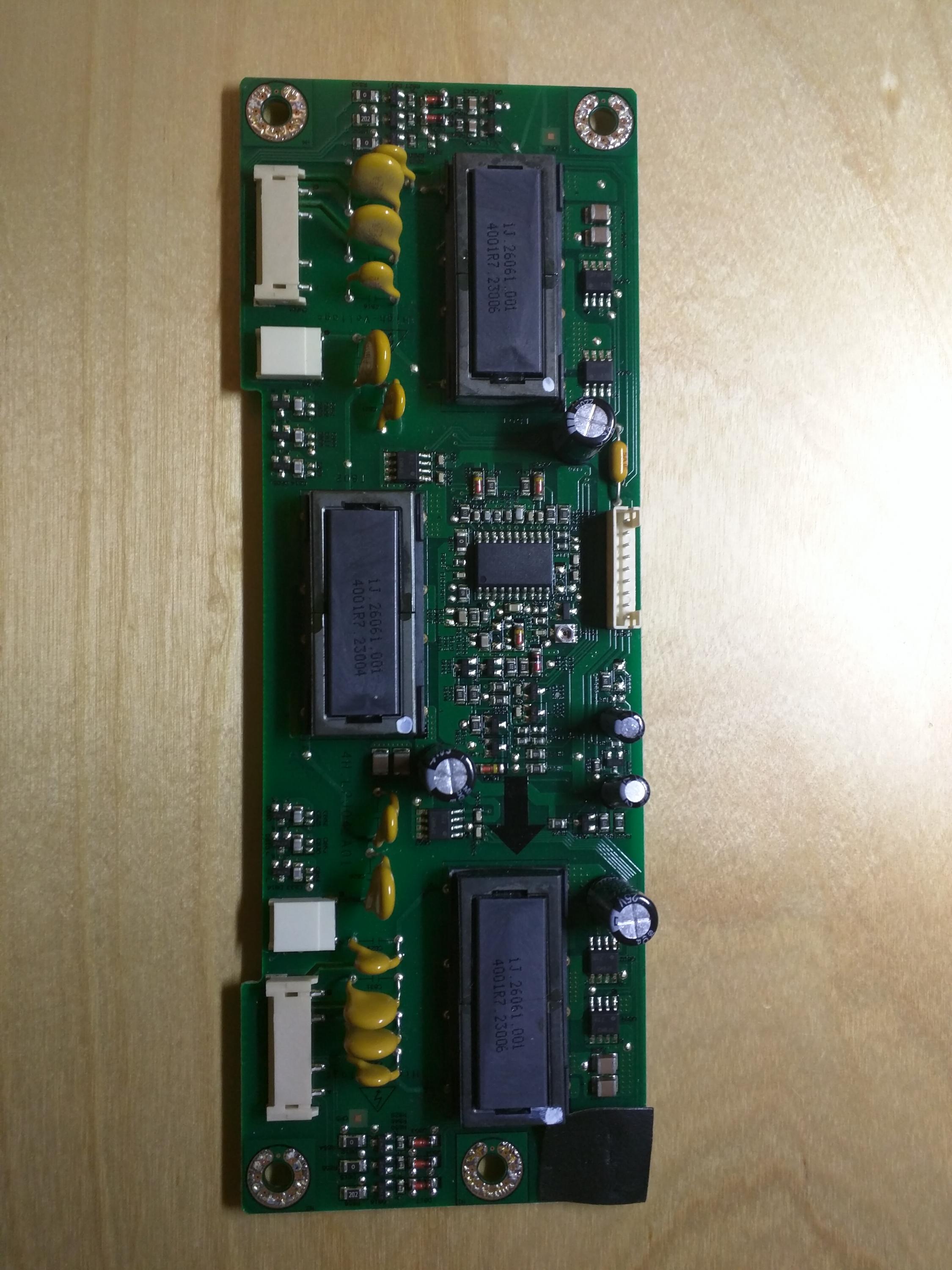

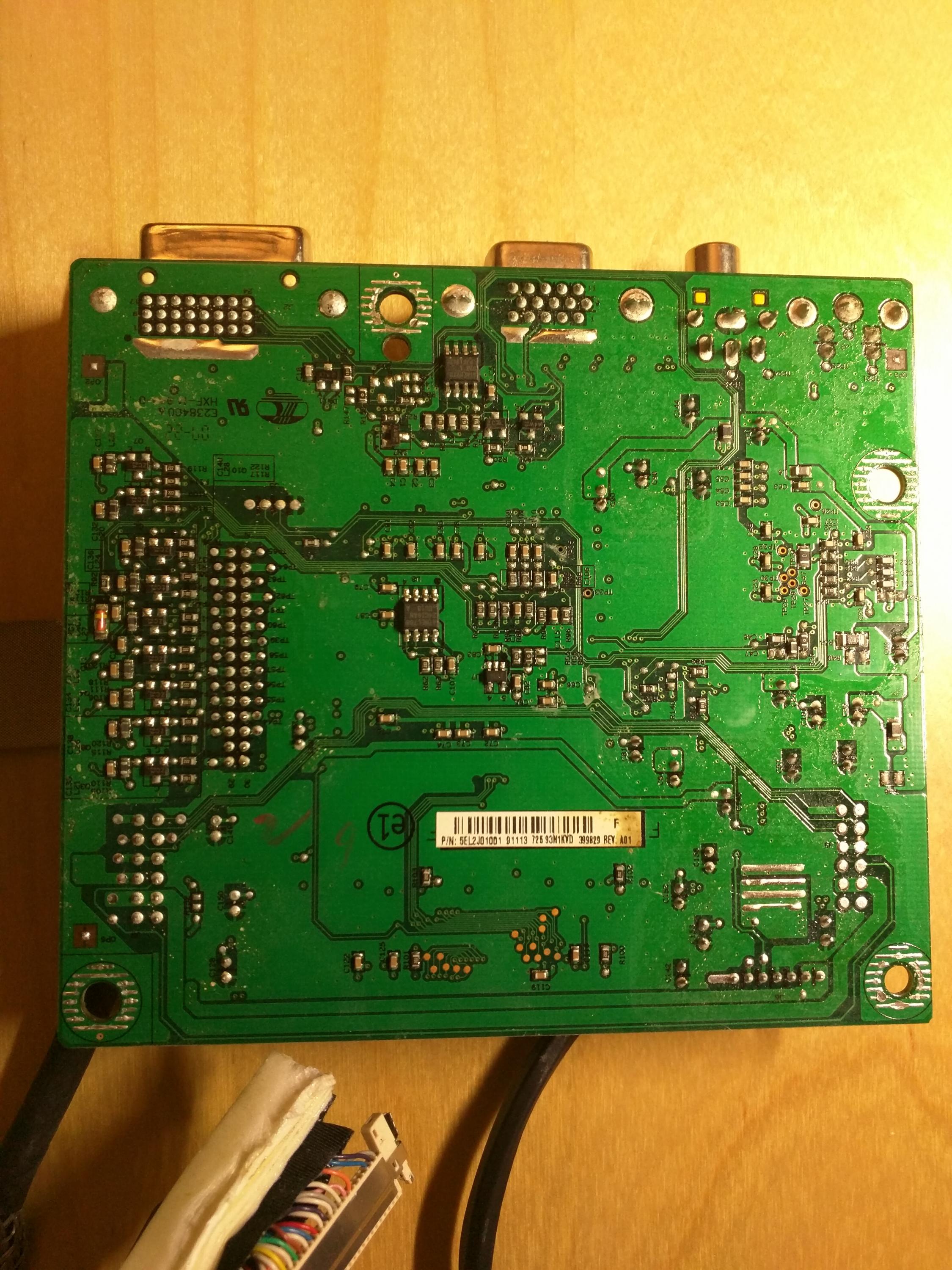

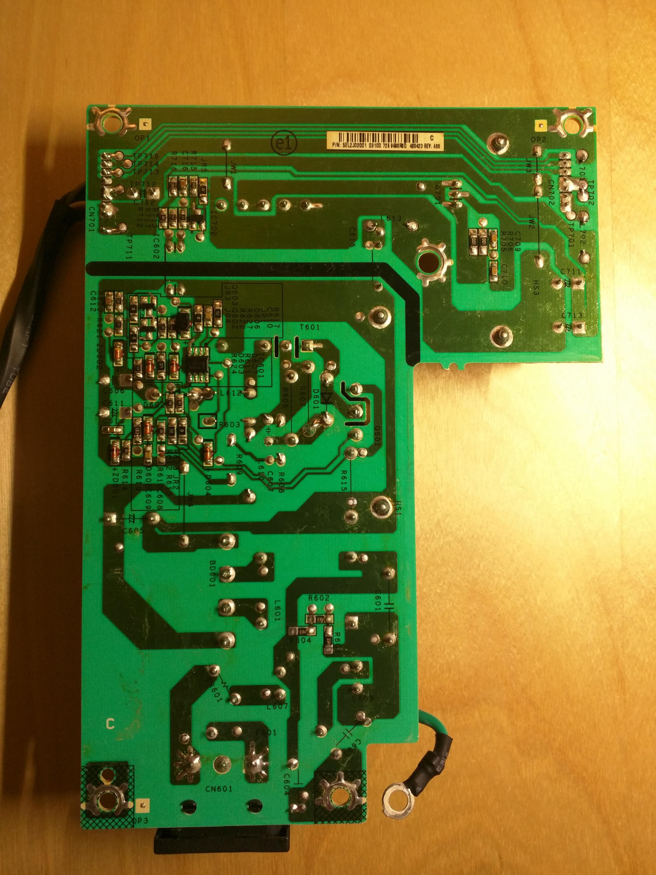

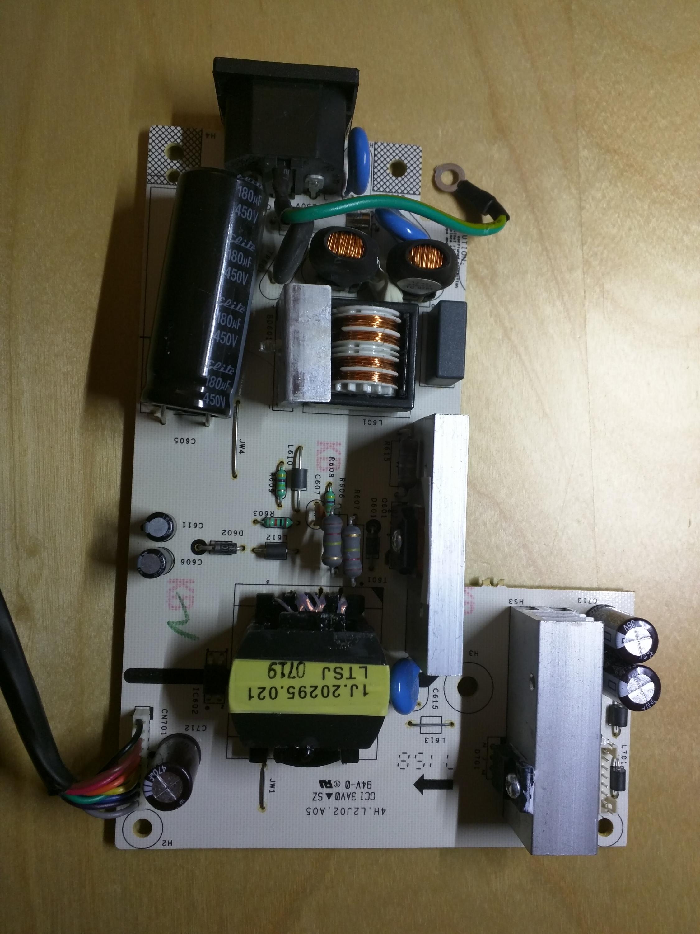

    I have a broken Dell 2007WFP. It powers on, then starts to show the dell startup logo, then shuts off. It does this repeatedly, and the time it spends on/off seems to vary quite a bit. It does this both with and without a computer plugged into it (and when it is connected to a computer, it leads to a continual cycle of monitor connected/disconnected alerts).
    It is shutting off fully (power light off) not going to standby (power light orange).

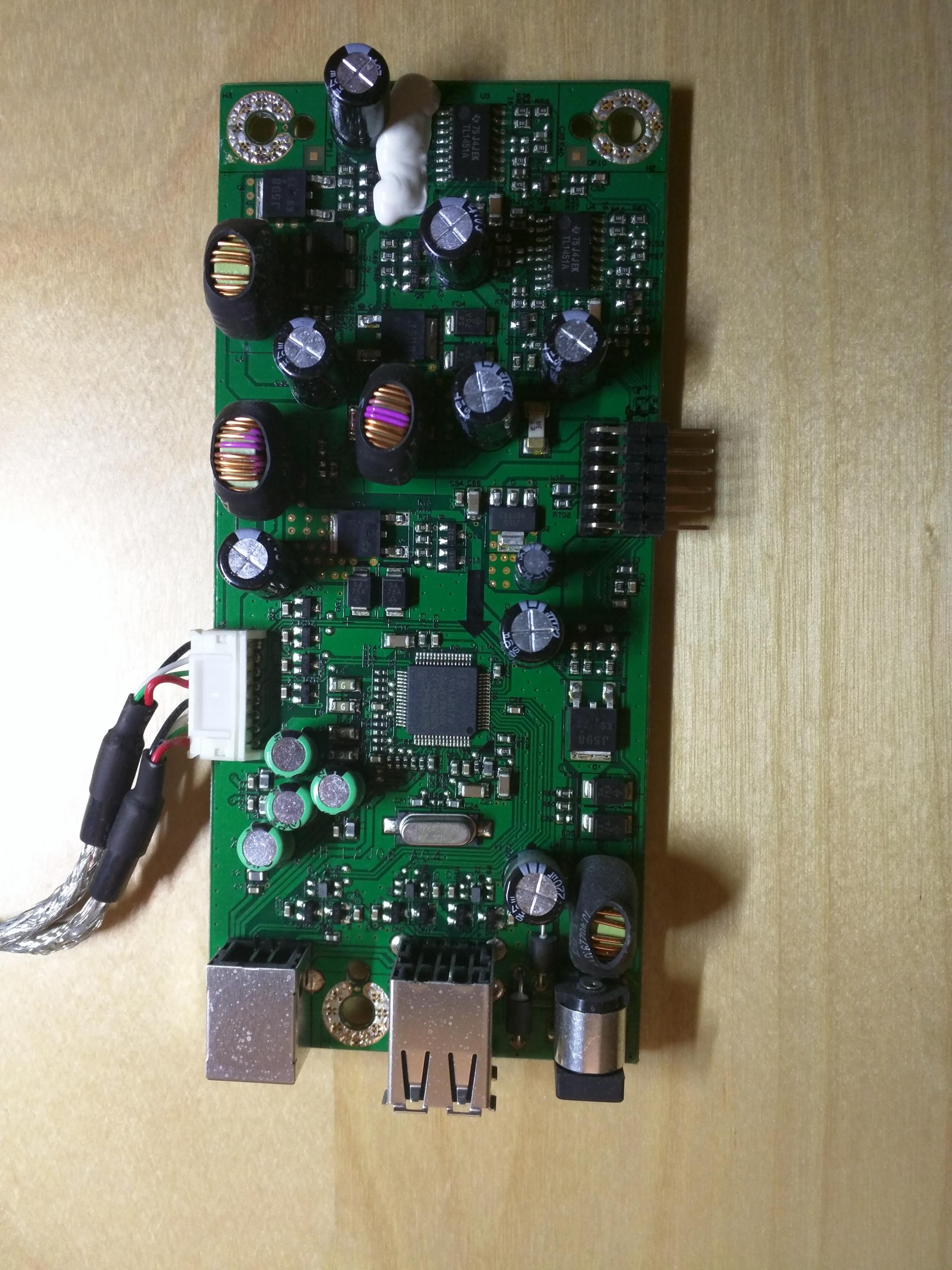

    I've attached photos of the circuit boards to this post.
    First two are the inverter, then the power supply, then video board, then USB board.
    I've read through most of the other 2007WFP threads here than I can find, but I'm not entirely sure where to go from here.

    There is 19V being supplied to the inverter, both when the monitor is on and off through its power cycling.
    I also took some measurements at the pins which connect the USB board to the video board, I'm not sure if these are at all useful. The following measurements correspond to looking at those pins from the bottom of the video board (top left to bottom right):
    0.03 0
    3.3 3.3
    0 0
    3.3 5.1
    11.9 11.9
    19 19
    Notably, when the monitor flipped off, these measurements went to:
    1.24 0
    1.48 1.65
    0 0
    0 0
    0 0
    19 19

    Re: Dell 2007WFP help
    This is just a always on 19VDC single power supply.
    So are you saying that when the monitor is plugged in but the power switch is not activated the 19VDC to the inverter is going up and down or it is steady?
    This board: https://www.badcaps.net/forum/attach...8&d=1461731707
    It takes the 19V input and down converted to various low Voltages to run other boards and circuits.
    You may want to read this thread regarding to bad resistor under the white glue on that down converter board.
    https://www.badcaps.net/forum/showth...ight=DELL+2007

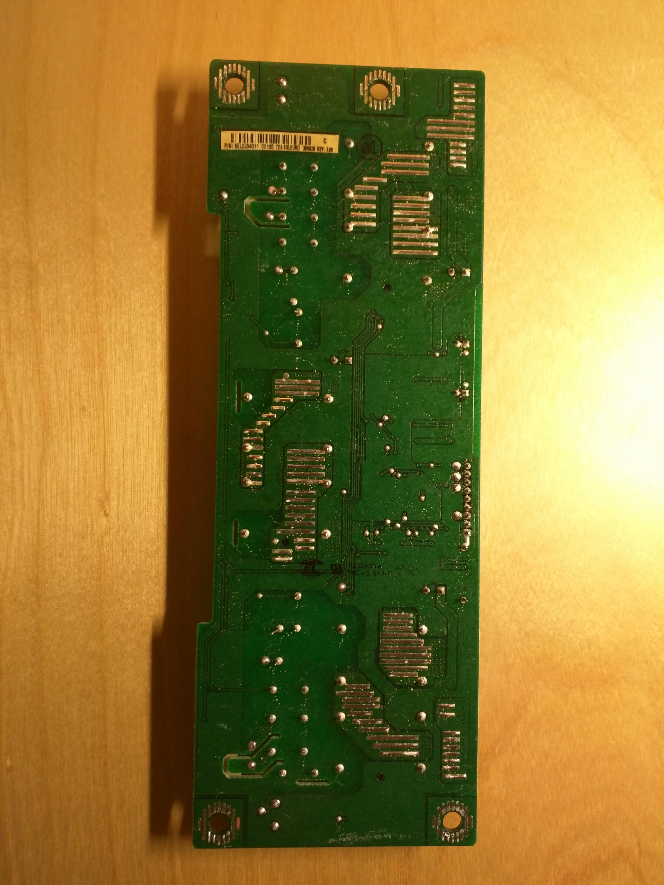

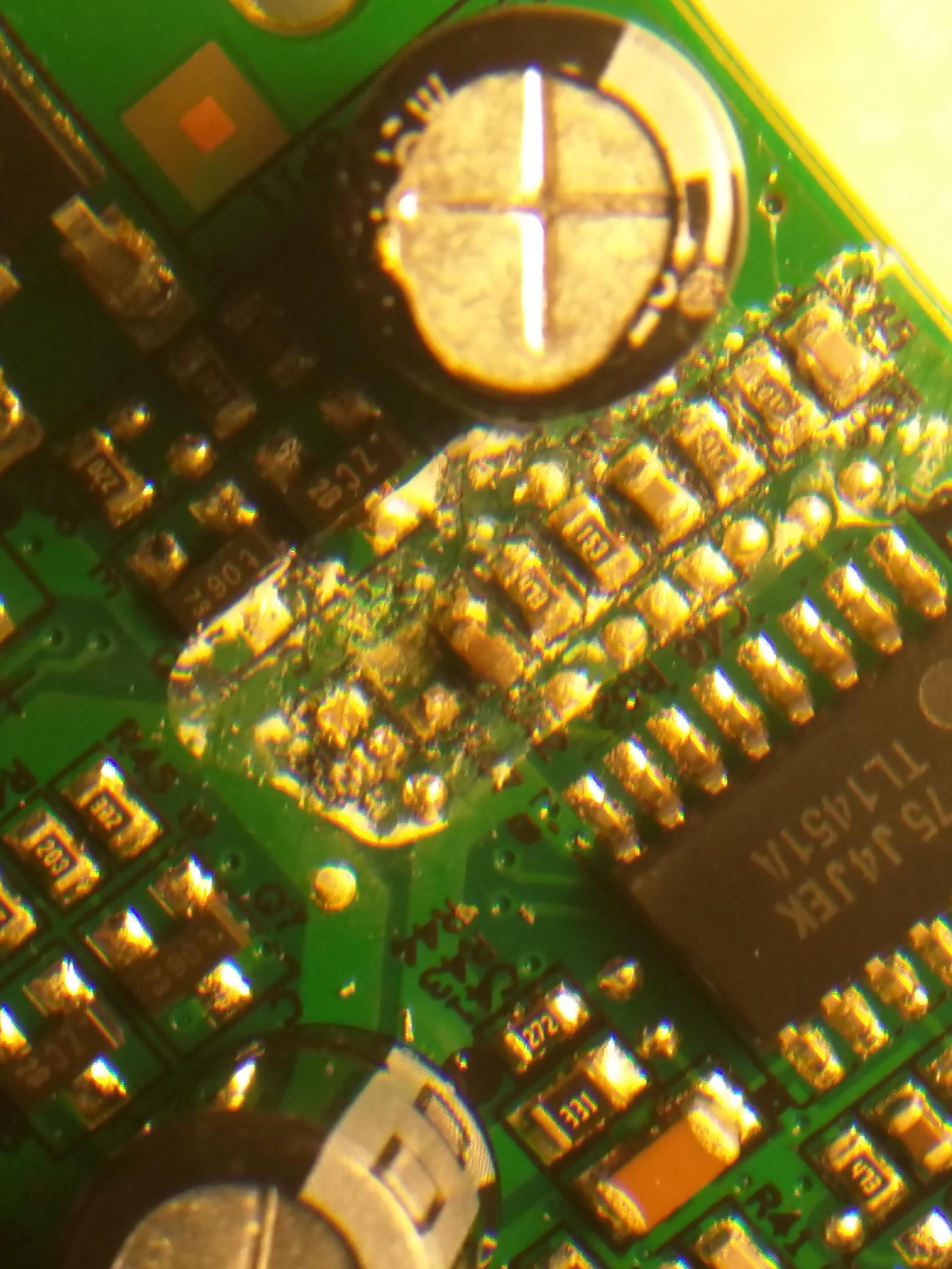

      I peeled off that white glue and tried to measure the resistors, but I can't seem to get the pads clean enough to get a good contact with the meter. Any suggestions on getting rid of all of it?
      Should I just desolder them and test them off board? I have a hot air rework blower, its not really a problem for me to do that.
          All of those resistors except the 2.7k read the right values. The 2.7k reads open.
          New problem though: I managed to screw up desoldering the 2.7k. The 2.7k came off fine, the resistor one above it I managed to accidentally shift, and one of the pads came off with it (I still have that resistor).
          Any idea where that missing pad connects to? If it connects to the cap beside it, that's really easy to bridge.
          If I did kill the board, I'm not too disappointed. I was expecting to need to buy a new monitor anyways, but it would be nice to get it to work.
          I know its not the best photo, I'll try to get something better later today, but I don't really have anything good for photographing stuff that small.
            If you clean off those flux or what ever in that section then we can see the traces better.
            • lnsulans
              • Apr 2016
              • 13
              I fixed it. I bridged that cap with a blob of solder to the resistor marked 473 (the one up and to the right of the cap in the photo I posted in my last post), and replaced the burnt out 2.7k with a new one. It works now.
              Thanks.
