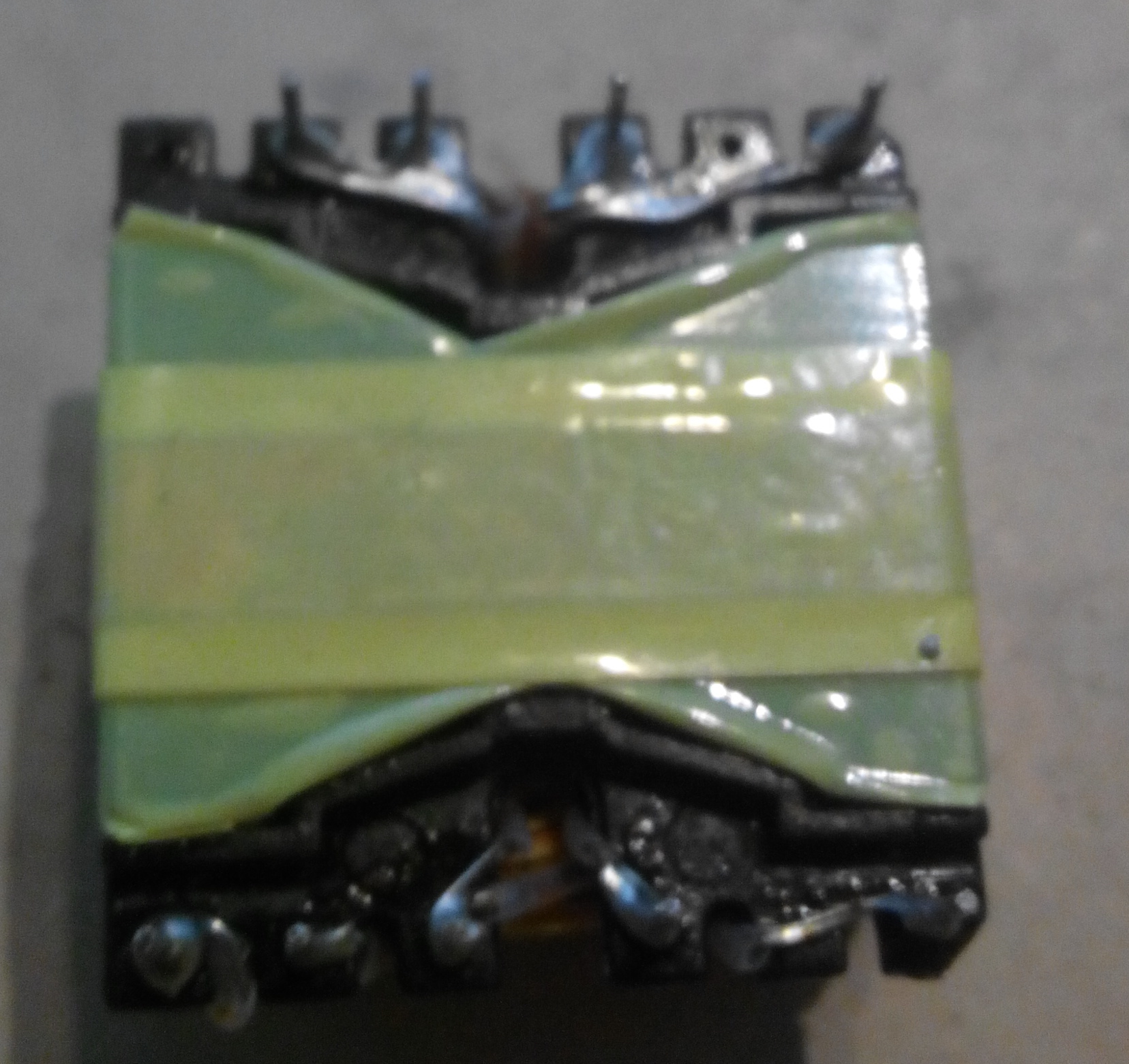

    I measured the power supply, 5V is ok, but 12 V and 19 V reads 0 V, just plain dead.
    So i measured the caps and diodes, they are fine. So then I looked at one of the transformers, the resistance between the conductors on the secondary is 0.2 ohm, so short circuit.
    How do I find a replacement transformer, I really don't understand the markings.

    I doubt if it is really transformer, the DCR in the primary side will be really low Ohms.
    The question is, do you have PS-ON to turn on the rest of the power supply section I.E the PFC Voltage booster and the 12V/24V section that you think you have bad transformer?
    BTW, the fuse would have blown big time plus also damage the power MOSFETs.

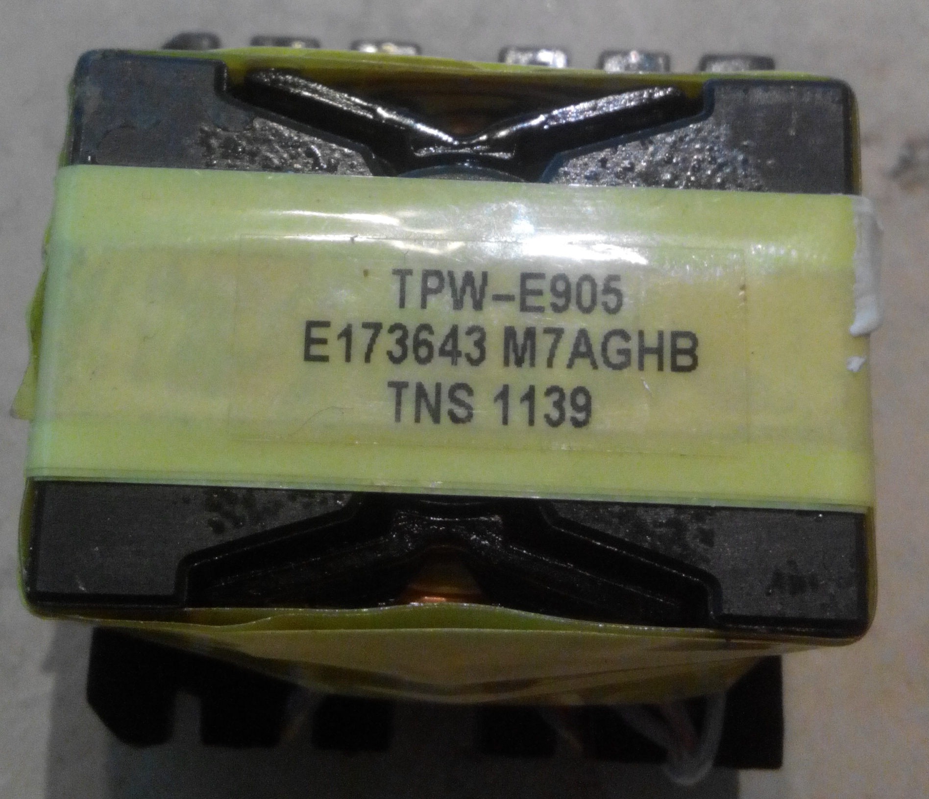

              No, that is normal; put it back!
              The resistance (i.e. impedance @ 0Hz) is expected to be low but the impedance at its operating frequency (many kHz) will be fine. If the transformer were open circuit you would diagnose that with a multimeter. If it had a short, then as Bud said, it would be visibly toasted and blown loads of other stuff including the fuse.
              I suggest it is either:
              - the PSU has been signaled to turn off by the control circuits as Bud suggested (check "ON/OFF")
              - a problem with the 12V regulator. Investigate this with a multimeter after ruling out the above.

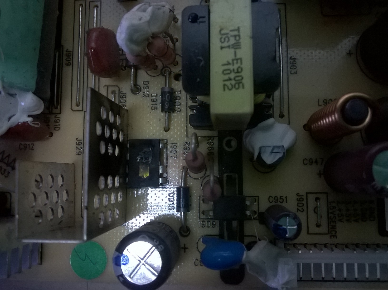

                Original post is one year old, cmg.
                Regarding IC I907, if PSU is a Tatung TPS-10036-LA1, then it's a Power Integrations TNY279PN (DIP-8 with pin 3 removed).

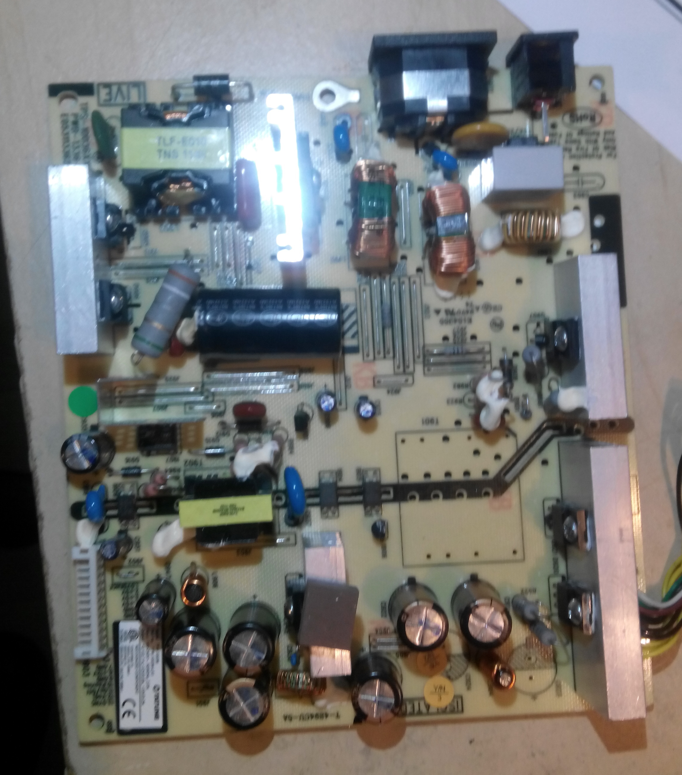

                  Hi, I'm also trying to fix this PSU. My problem is that the PSU stops itself after a couple of minutes (when cold).

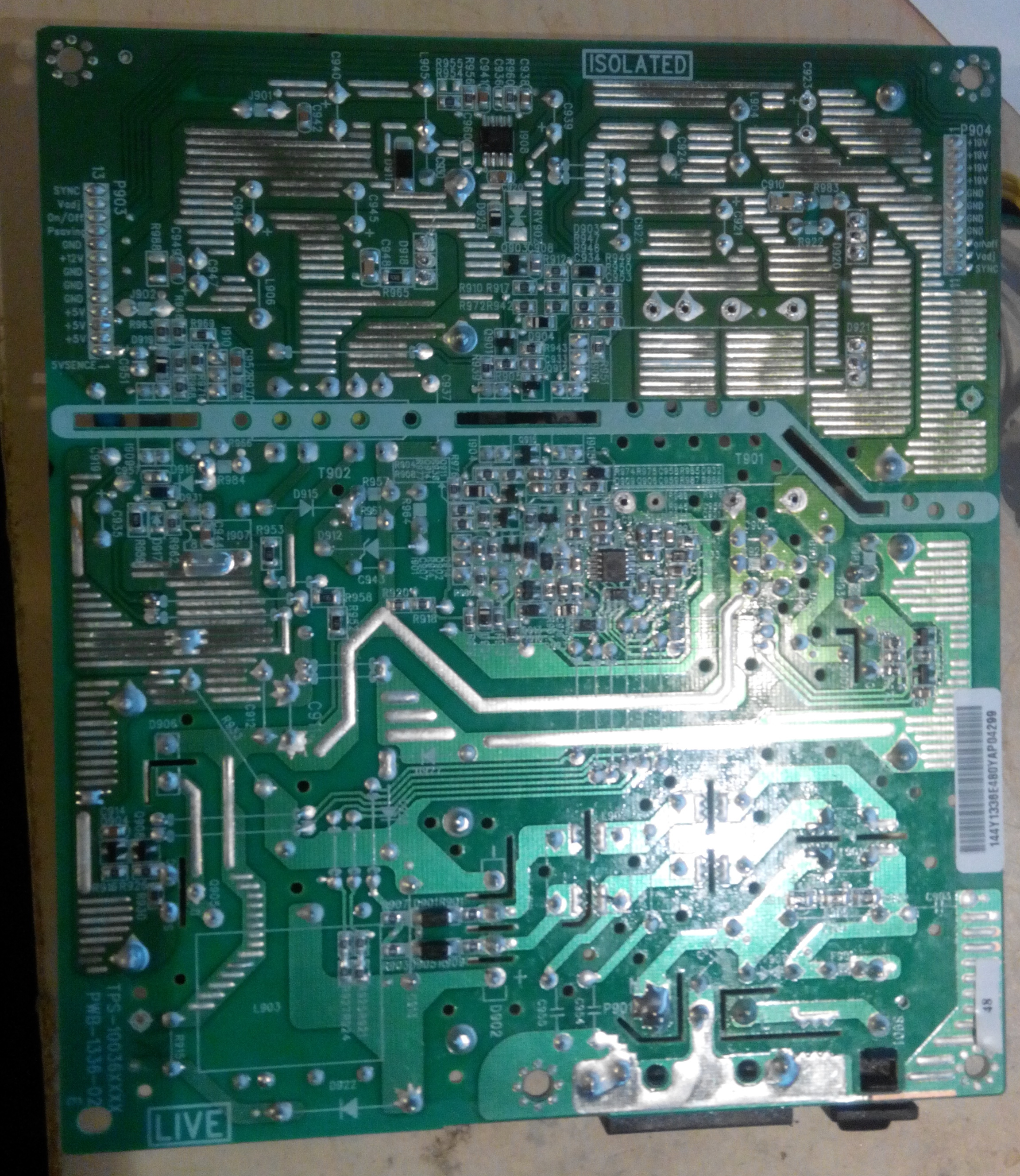

                  I've investigated a bit the PCB trying to understand the schematic, and there are 2 parts in this PSU:
                  - one converter built around the TNY279PN to generate the 5V (should be always on)
                  - one converter built around the CM6807 to generate the 2 other voltages (12v and 19v) and is activated when the 'powersave' pin is put hi (and there a minimum of current sunk on the 5v rail; it won't start if nothing consumes current on the 5V output).
                  Note that the schematics of the Tatung PSU is (as expected) very close to the application circuits found in the datasheets. The main difference is that the TNY279PN sits behind the PFC mosfet controlled by the CM6807.
                  My problem is that when both the controllers are running (thus producing the 3 voltages), if I sink current on the 5V rail then the CM6807 seems to put himself in an overload condition (not sure if it's an overtemperature or an over current detection), and stops the PFC switcher, so the 400V DC drops and the TNY279PN enters the Line Undervoltage condition and stops itself.
                  After a while (maybe 20 to 30s) the PSU restarts.
                  What is a bit odd is that if I don't start the CM6807 (keeping the powersave pin low), I can sunk as much current as I want from the 5v rail (could go up to 3amps).
